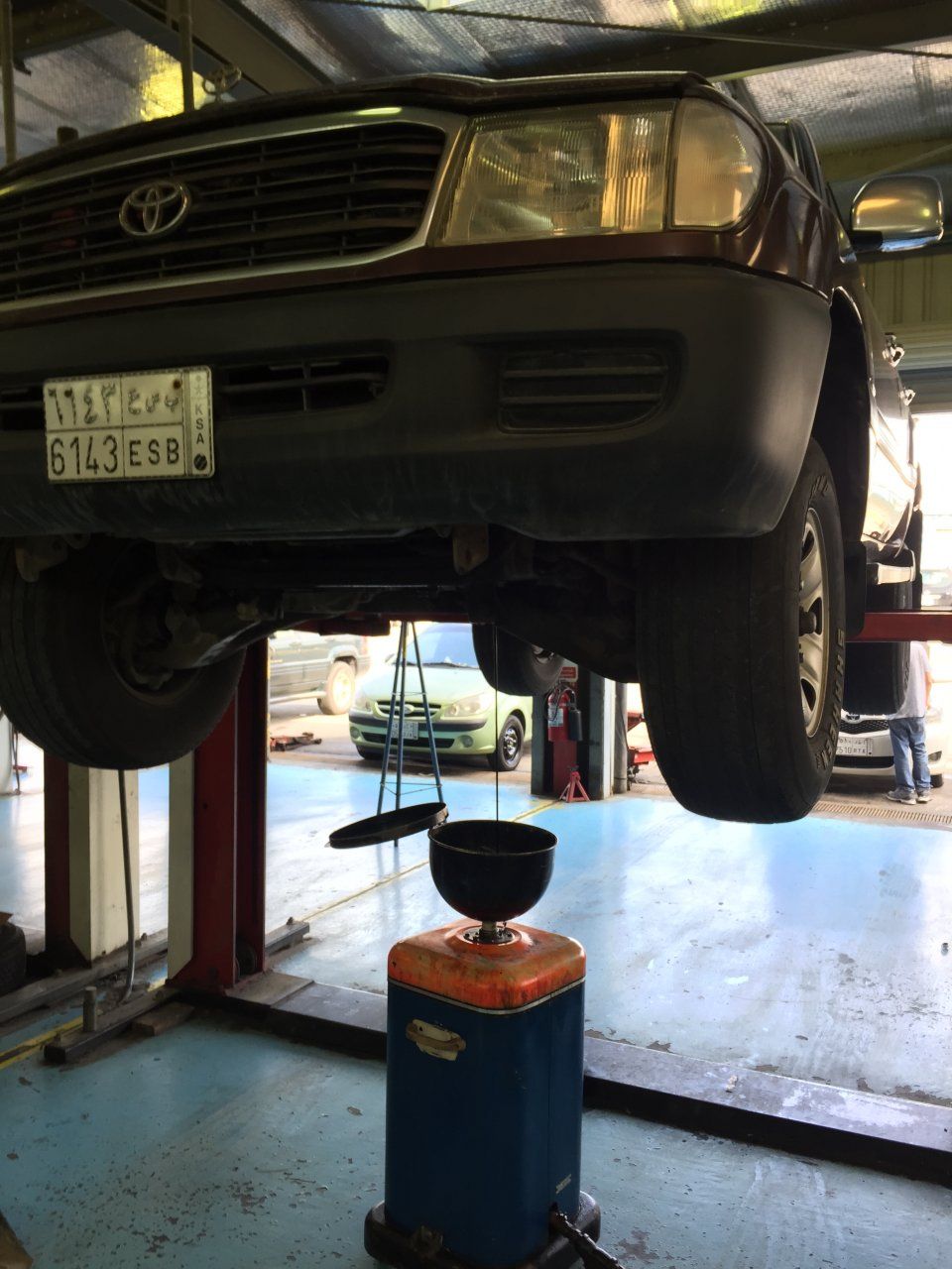

Finally got back into the truck. Since fluids aren't available on compound I had to order them through the shop.
Did an oil change and converted to 5w30 synthetic. I'm sure the truck ran 10w30 or higher for years due to the hotter climate. Going to need the lower temp stuff for Canada!

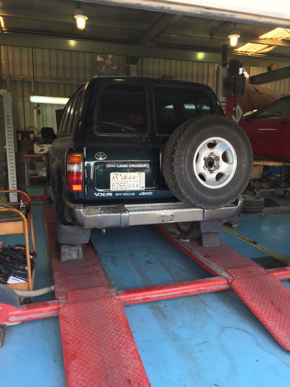

There was a neat 80 a couple bays over. 5 speed, barn doors and carb'd 1FZ. Interesting.
