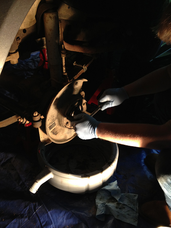

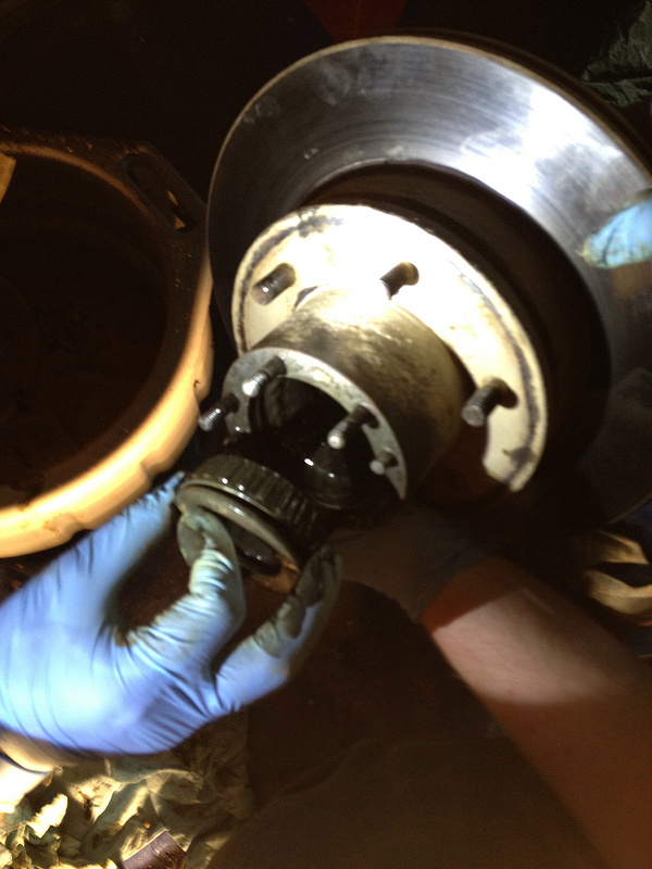

So after removing the rotor, you find this dirty dust shield with a little metal ring thing in front.
It took me a little while to figure out that i needed to take these stupid little pins off the brake line before i could get the dust shield out of the way.
(Anyone know what this circular one in the first pic is called? My herculean strength snapped it in half on accident...)

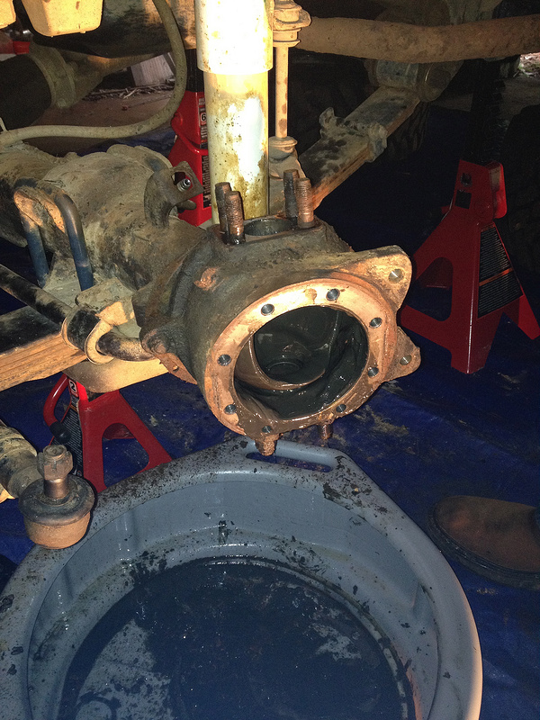

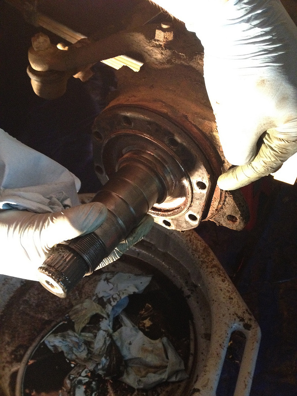

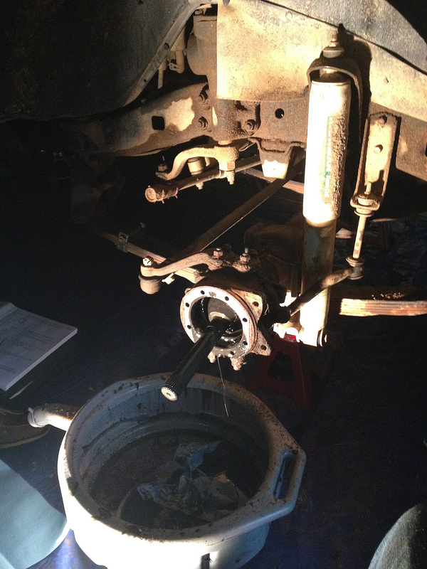

Guess what happens when you hit this spindle...
...It barfs up a nasty mixture of grease and diff fluid, duh..

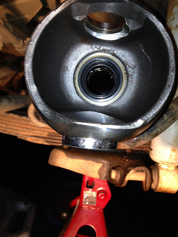

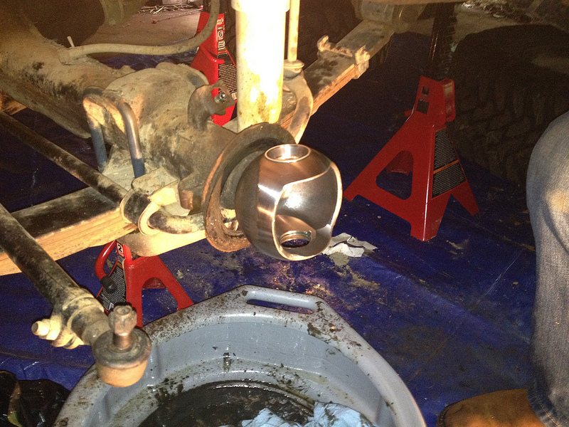

Bare knuckle sort of cleaned up.
Aidan, my younger brother, in our "painting booth".
That damn bearing race acting like a little bitch not wanting to go home.
Knuckle Housing painted and installed, steering arm connected, ready for the axle to be packed and slammed into that bitch.

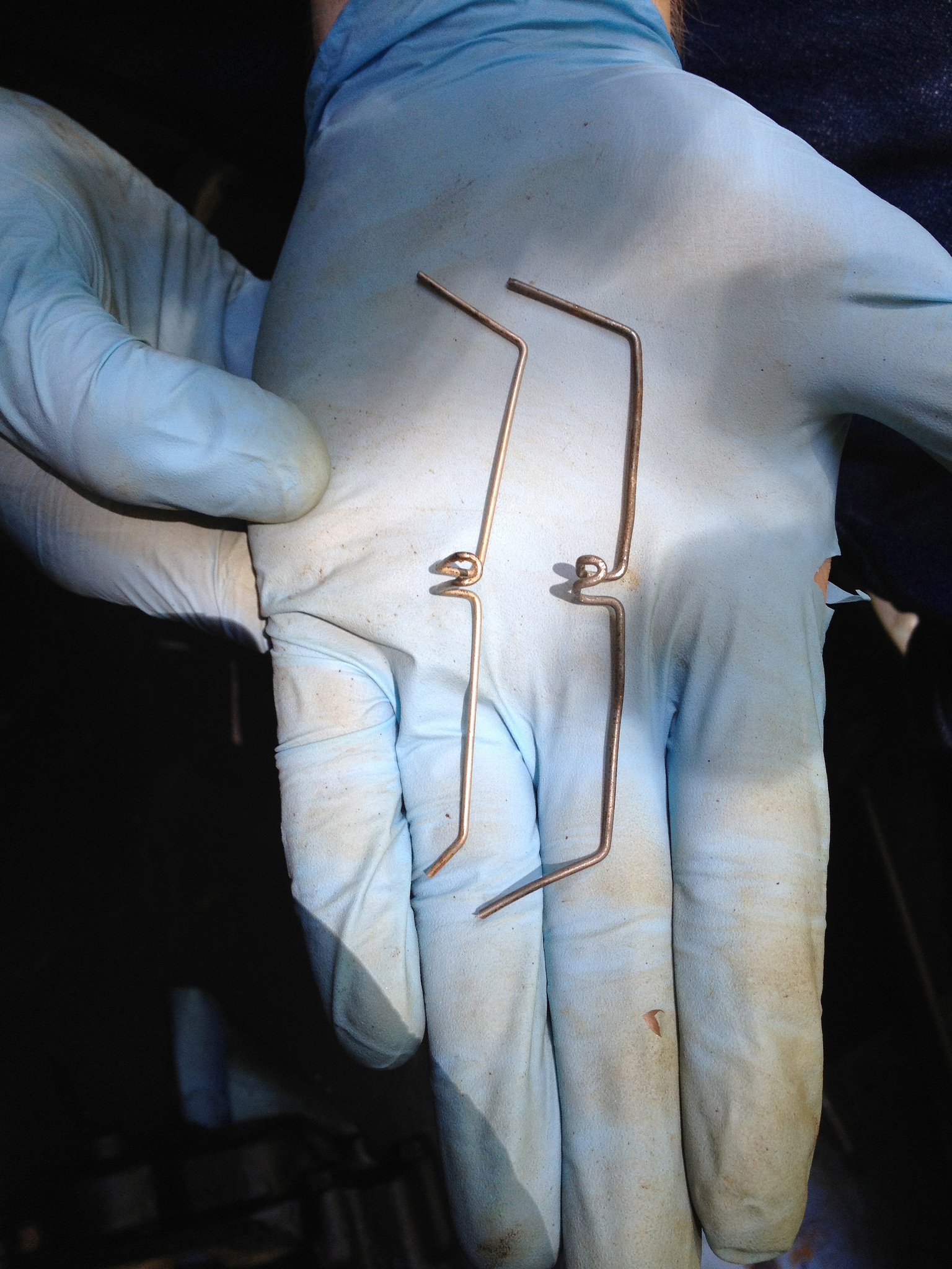

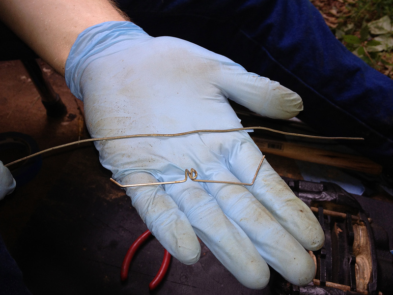

During this time we decided to try and figure out how to change brake pads. so we took all the springs/pins out swapped in the new pads and got it all ready to put back on... until we realized that the side spring retainer thing had snapped right near the bottom... I thought, "this one stupid little piece of metal has stopped my entire operation :frown:... until Aidan found this piece of wire in the barn.
5 minutes later...
YAAAAAAAAAAAY!!!!!!!!!!!!!!!!!!!!!!! I was actually a little surprised Aidan would have been able to bend it exactly right like that.

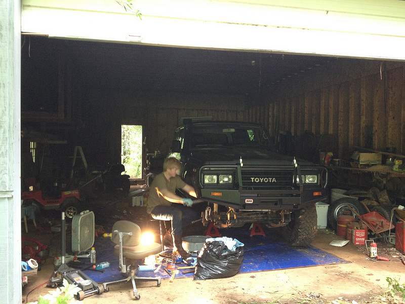

The barn, its a little dark and dirty: full of spiders, mice, bats, cave crickets, etc. But its gonna be where we work on the cruiser from now on cuz its PERFECT!!
(dont mind the jeep, i was young...)

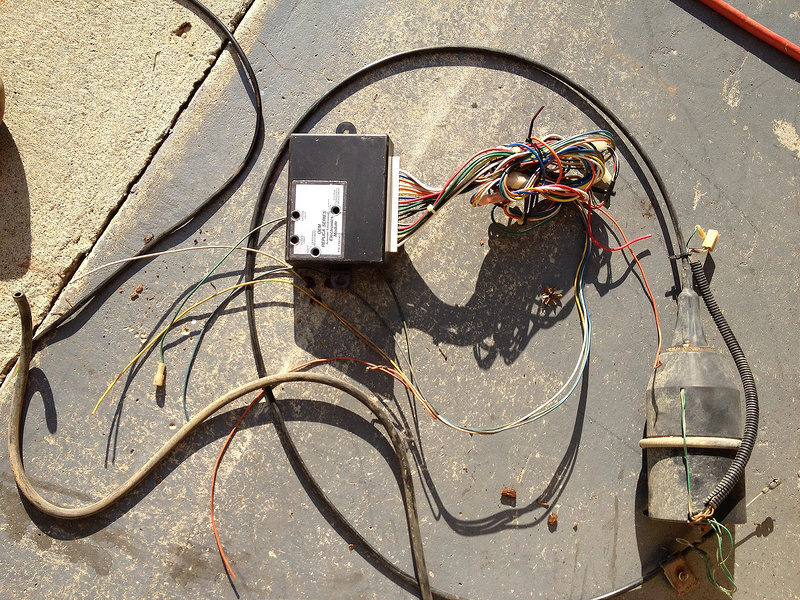

Check what came in the mail today. slcfj62's ultimate headlight harness :D
Thanks Eric, this thing is SUPER well made.
