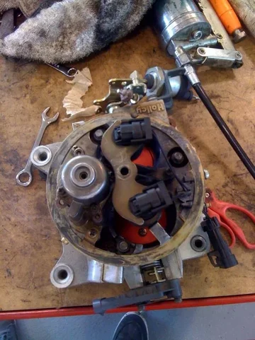

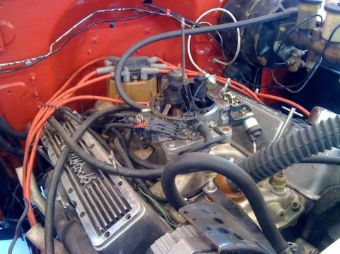

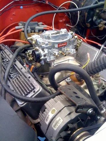

pulled the tbi off today- changed out the fuel pump, put in an inline fuel pressure regulator, and threw on the carb.
I know, its not a qjet- but the way things are looking right now it is going to be doing alot more driving on the pavement than on the trails so fuel economy and drivability are the most important. Ill be putting a piece of fuel line inbetween the bowls so that off camber situations won't be much of a problem (so I've read)...
tuned it up. power timed it to 12deg. no pinging and tons of power. its like a whole new engine I never knew existed :cool:
for those of you who followed this build - you know how exciting it is for me to finally have her all dialed in! Can't wait to get rid of the daily and drive full time.
a few crappy pics for now and video once I've had some time to iron out the remaining trim details next week sometime.
before: TBI
after: 1406
good riddance:
