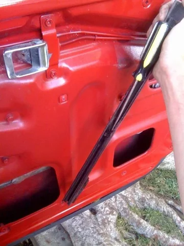

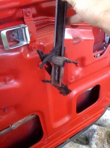

Installed front window glass today. By the time it was over, I had (have) a nice collection of cuts and scrapes on both hands. Left my work gloves in a friends car. The upside- now i could take out and put back in the door glass without any questions....
PITA: OLD DRY WINDOW RUNS
ME: 1 RUNS: 0

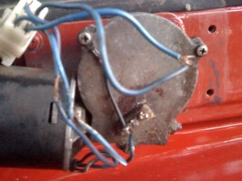

WIRING QUESTIONS:
Anyone know where the wires are supposed to go?! Link to diagram or description?
wiper motor wiring issue solved via external thread. thanks rock2una.

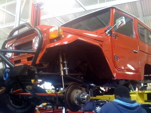

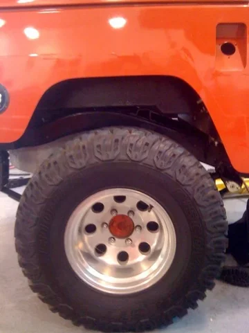

new springs are in:D. with the rig in the air the springs hang 2.5" lower in the back and 2" lower up front.
LIFT HEIGHT:
I'm an idiot and forgot to measure the frame to ground prior to the spring change so I don't know how much it actually changed but it looks to be atleast an inch higher up front and two in the back....the rear tire clearance, (see ****ty iphone picture below) is way better now.
RIDE QUALITY:
better. quite a bit better, but still too stiff. I think at this point two things are going on 1) the springs need time to break in. 2) my shocks are too stiff (and rear's are potentially shot...?) I'm going to take the shocks off tomorrow at the shop and see how it rides without them- easy test, if it is much smoother w/o them then I need to re-valve the fronts and get new rears, if it is about the same then the shocks are fine and the springs need to be broken in. I'm tired of being bumped around.

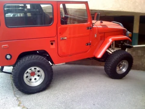

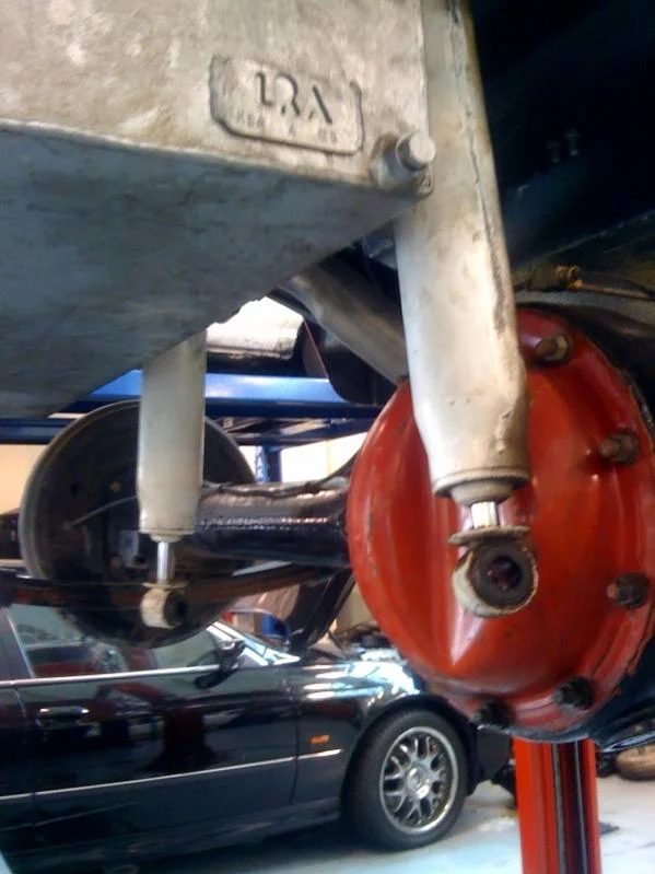

never really thought about it, but unless I use a lift/dealer car ramp, there isnt really any place in the city to test flex... got a little creative in an alley in santa monica....quick before the neighbors notice or the wall collapses. will take it onto a ramp tomorrow at the shop and see what it can actually do.
also, i'm pretty sure the shocks shouldnt stay compressed like that.... or am I just imagining things....? but even if they were bad, that would only make things LESS stiff right?

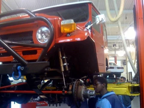

Made a HUGE discovery yesterday.
While it was up on the lift I was walking around, looking at the new spring angles etc trying to figure out if I had done anything wrong or if it was just a matter of time before the springs break in....
Well, turns out when I ordered my front 7100's they sent me the wrong, (VERY WRONG) valving. 400/100 :eek: Not sure how I didn't catch that when I was putting them in, but that would explain alot.
Called up bilstein and they said that with that stiff of a valving it would have the power to essentially lock up my front springs IE bumpy ass ride.
PHEW- atleast now I can relax about the ride quality. Ordered new 255/70 valving for $30...(though I think I may just sell the 7100's and swap them out for 5100's all the way around.) Then I will be able to let nature run its course and wait for the springs to truely break in a bit.
You guys have any experience with different valvings? The guys at bilstein said that the stock FJ40 valving is 255/70 and that is what they recommend all the way around. Also is the valving that the 5100's come with.
attachment.php
Shocks will remain compressed like that. Remember, when they came in the box you had to pull them apart to mount them. Basically all they do is dampen the bumps thru vavling - like a transfer of liquid between chambers. Unless they are coil over, they don't do any pushing back of their own (like a straight guy in prison - he doesn't push back)
If they are bad, you can manually compress them or decompress them more easily (when they are off the truck of course). They can make your ride bad though. If you do not have the appropriate travel (including length or valving), they will not move back and forth enough to dampen the ride and all you will feel is spring bounce. I had a set that was way too long on a VW Baja with very stiff valving and it was like riding on rails.
If that all makes sense. Given that your valving on the Bilsteins was funky, I think you will discover a much better ride with the new ones installed. Bigger is not always better.
