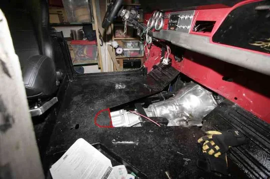

Ok so I just realized that there arent an pics on this page, so heres an update of the cutting the tub situation.
A pic of the area to be cut out so that it can clear the t-case:
