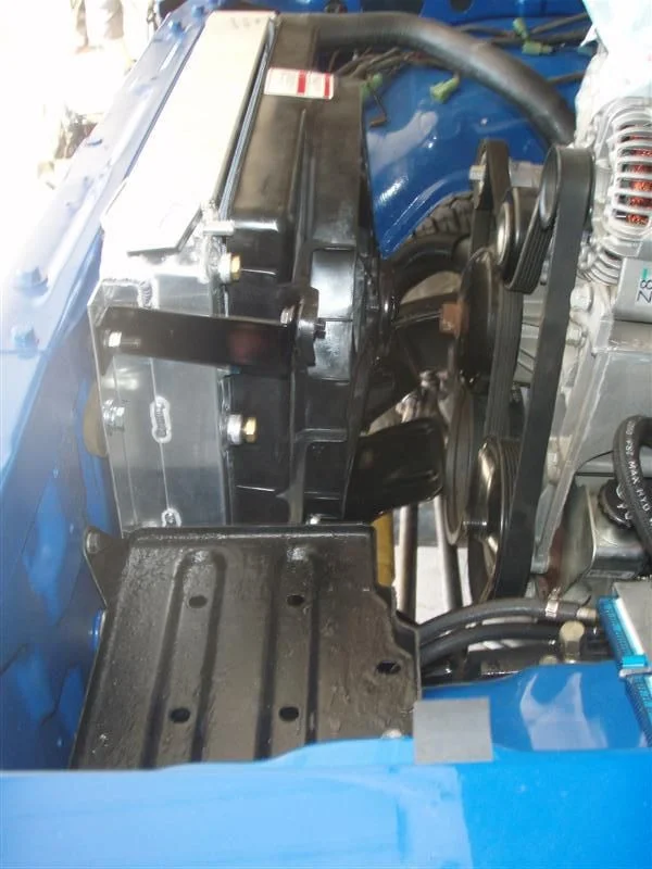

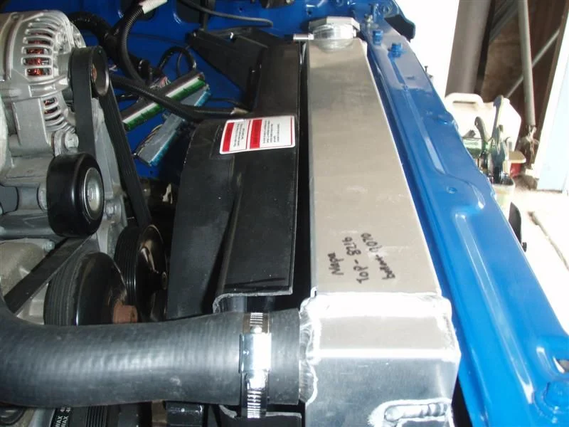

x2 on WENCO I have used them a few times they are top notch. Post the pics of the Fan I want to see your fab skills.

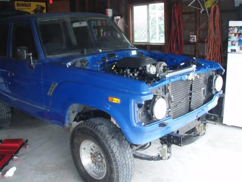

Ok here are some more pics....

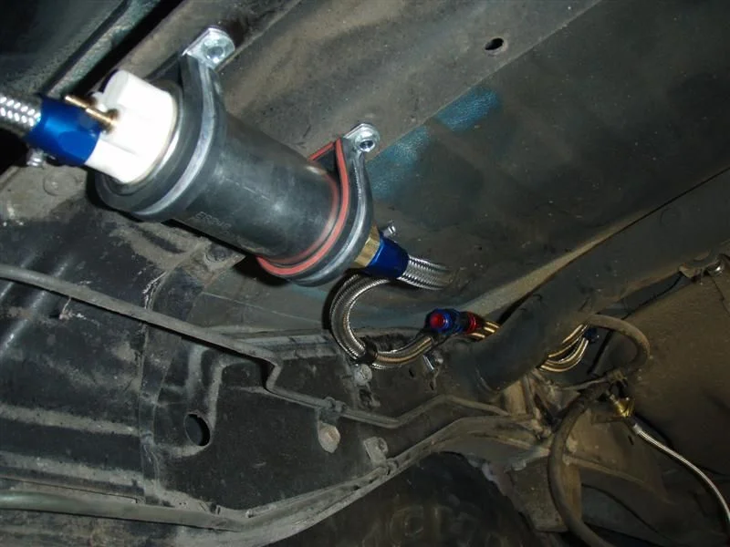

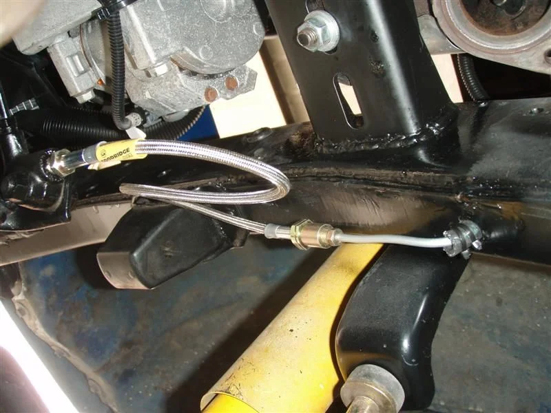

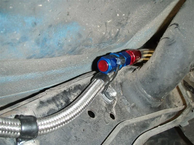

Damb Manu! that truck looks nice. Super job on the fan and fuel lines. I am 99% sure you need to turn the pump around the other way. I'll call you later this week, I may be able to come by on Saturday if you will be around.

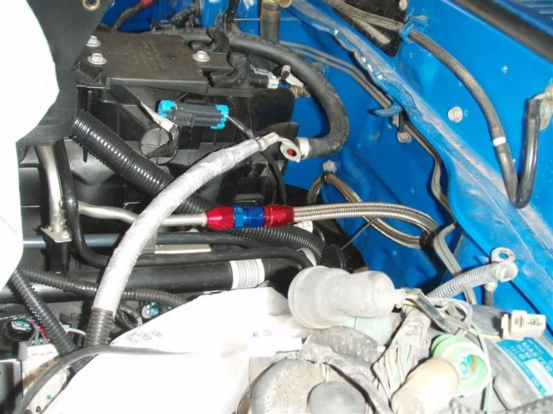

Here is the part # that is on the cable that runs from the TAC module to the gas pedal
GM #15233969
I ran the # through gmpartsdirect.com and it came out to ~$33. That's where I ordered these parts from.

GREAT PROGRESS!!! Very nice work on the fan shroud. I like the brake lines as well. So are you going to drive it when you are done or just sleep with it?? :hillbilly:

Why can't I use the LC Canister?
You think the ecm would throw a code..?
I havent bee able to get a canister evap.

The attention to detail is her doing..........

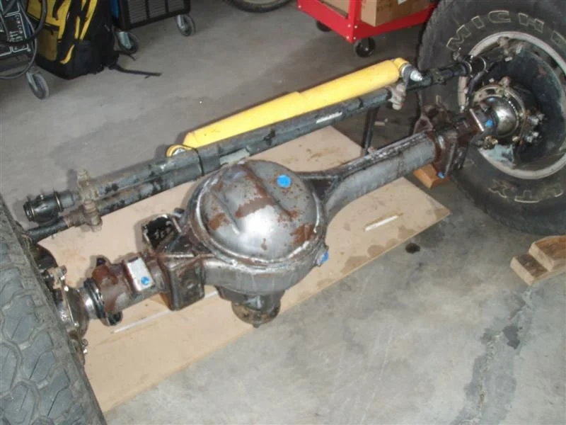

Got my rear drive shaft today...and its going in mañana....

Thanks for the part number......
Now, do you have a part number for the fuel canister ???

I got mine from the local GM parts counter. If I can remember tomorrow during the daytime, I'll see if I can find a number on it (it was around $30-40). I just got a late 1990s one that had two fittings on it.

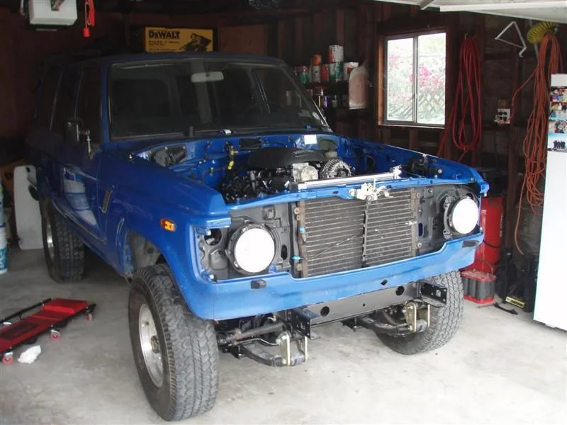

less painting, more vortec!!!! :D
very clean.... You're going the extra mile in a lot of areas, looks good.
Ok... enough chatting... get back to work! Just kidding... you are doing a great job with the truck Frank.
And Dynosoar, thanks for coming over and helping out. Thanks to everyone that has given any input/help on the truck... it's almost finished =)

what kind of radiator are you running and what type electric radiator fan..?
