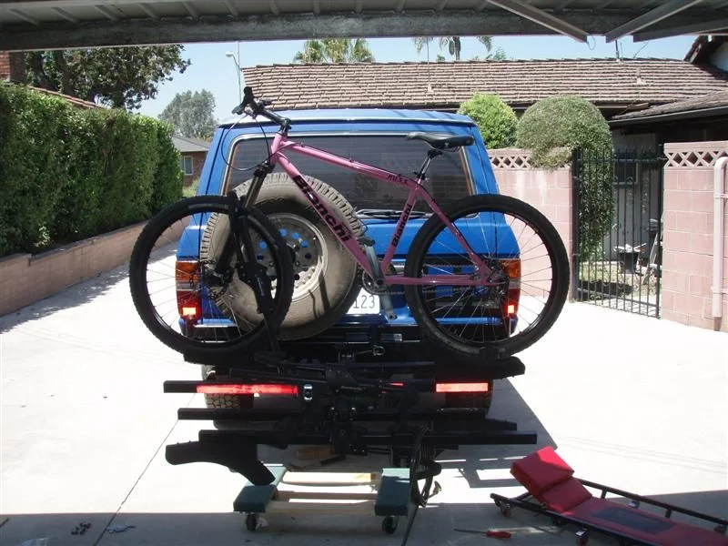

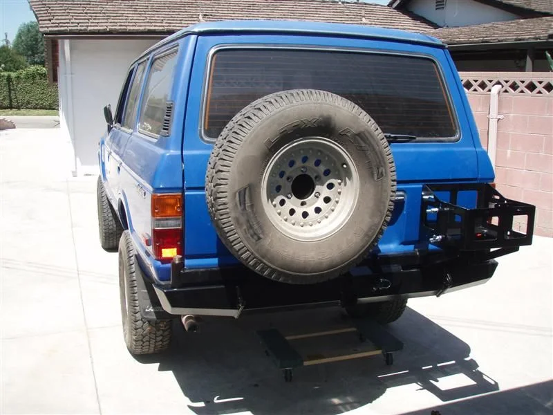

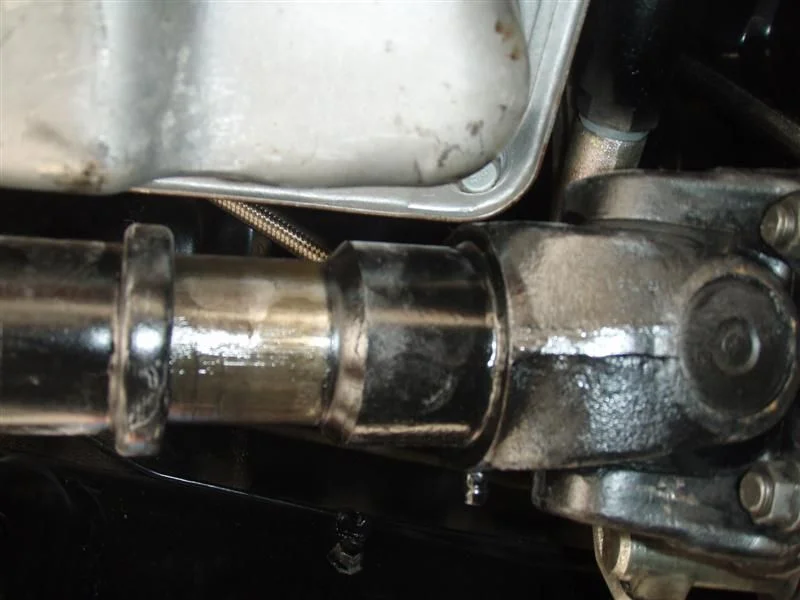

ok guys got lots done last saturday and finish the knuckle job ....as everyone stated.. it was messy but rather simple..... Since I had been waiting on FIS to sent back the harness I got bored and decided to bite the bullet on a rear 4+ bumper... I like it a lot !!!

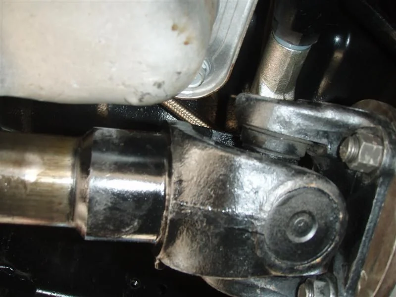

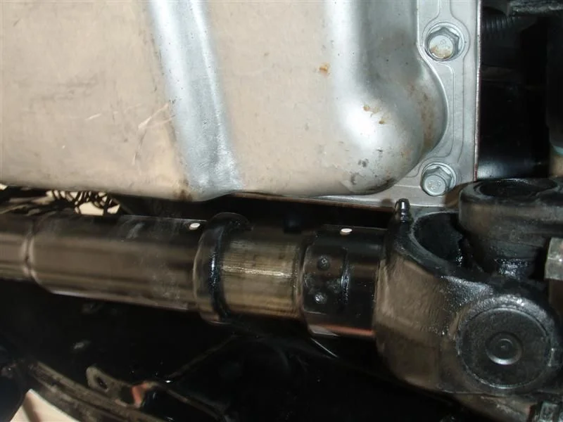

I was able to get the front drive shaft without any adapters
Here are some pics...

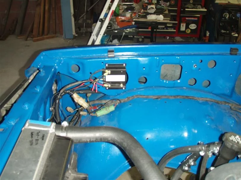

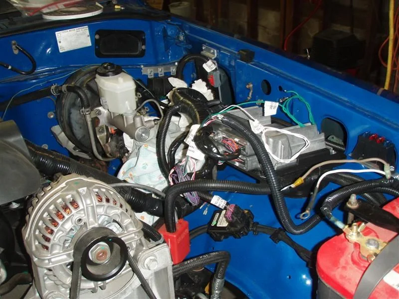

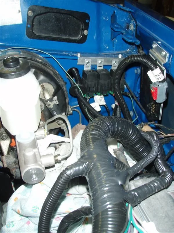

gotta lots done with the piping and electrical... got the harness back from FIS :bounce::bounce::bounce: and got it installed with some grinding and some drilling.
TAC module is shown above and will try to fit the DBW pedal this week...

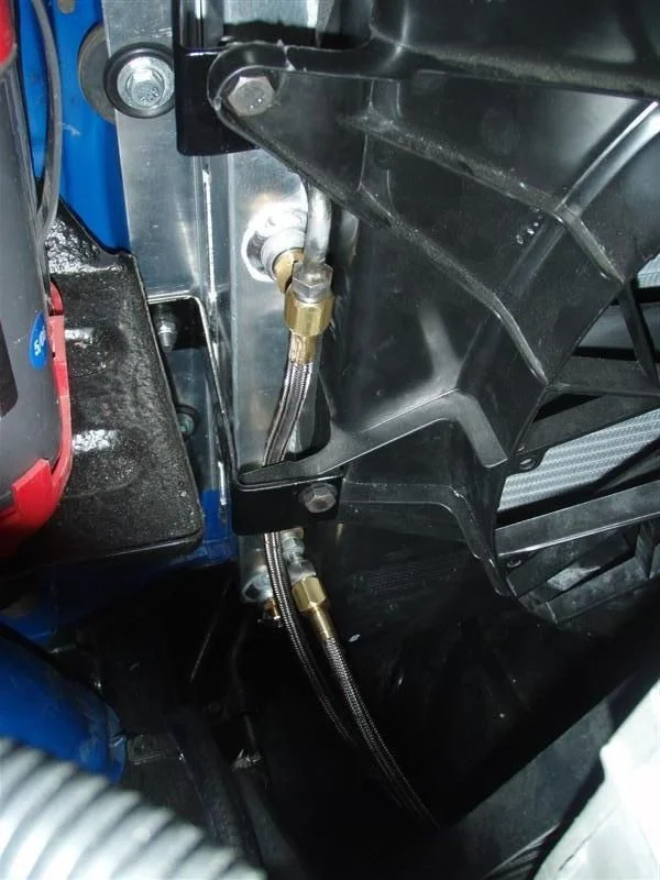

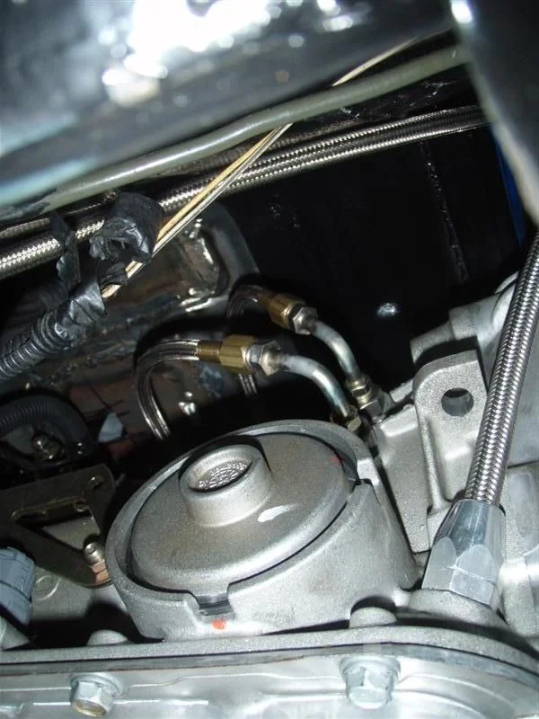

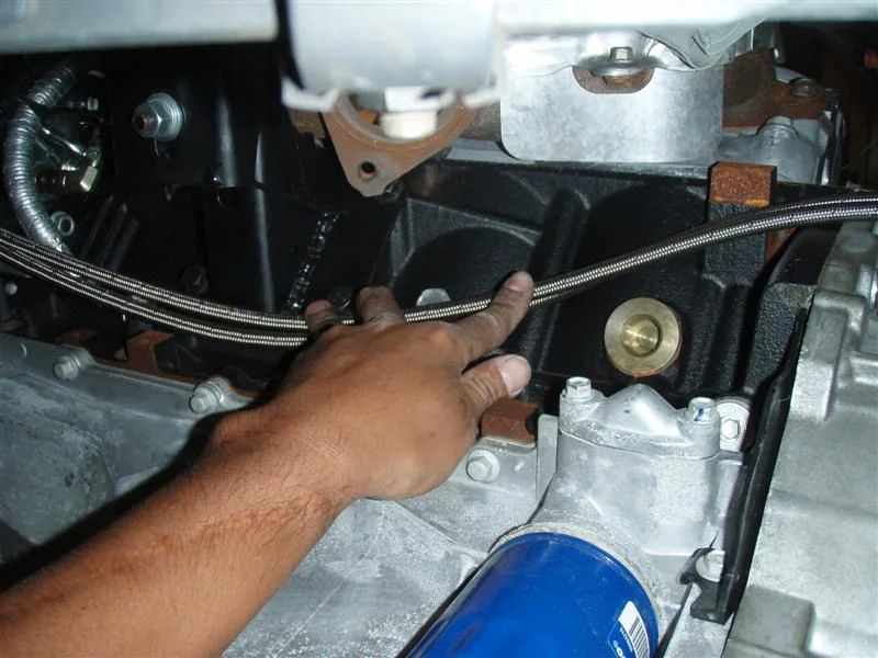

Here are some pics of the tranny lines.
I also replaced the Master Cylinder and upgraded to the 4 runner brakes....

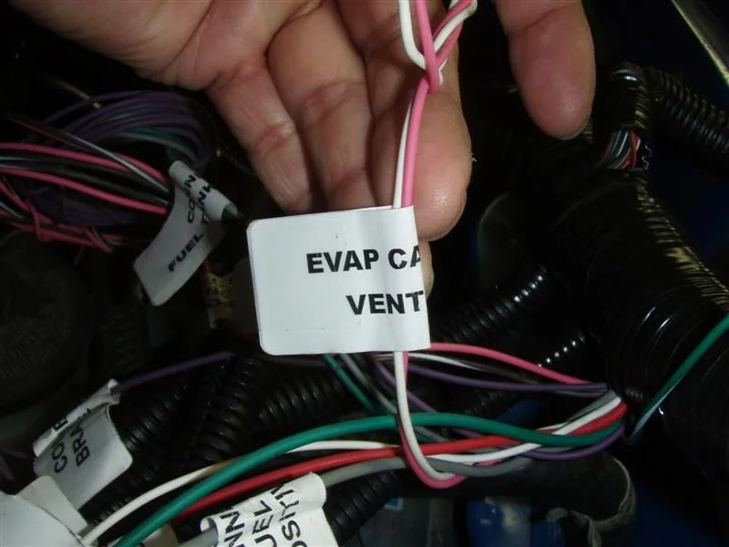

Randy question for yah....
My harness has this two wires for the evap canister.. and I dont know where they go since the canister I got has no electric connection.. the purge valve is already plugged into the harness.. so Im at a loss with this two wires.....Am I missing some kind of connector or plug ?

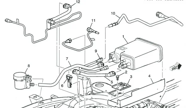

I went through the trouble of getting the OME canister and just check with the dealership today to see about the 3rd (yeah there is 3 vacuum ports on the canister) right side goes to tank middle goes to purge valve and the left goes to the fuel tank evap control (solenoid)....wich I dont know if that is where the two electrical wires plug to..
Here is a picture its item #8 GM PART # 19152349 acdelco 214-2082

Good research those two wires go to part #8 “evap canister purge valve solenoid”
It should be installed near the canister. Lucky for me I was able to use the existing vent plumbing off my fj62. But I did run new wires to the solenoid. Nice clean job on your install.
