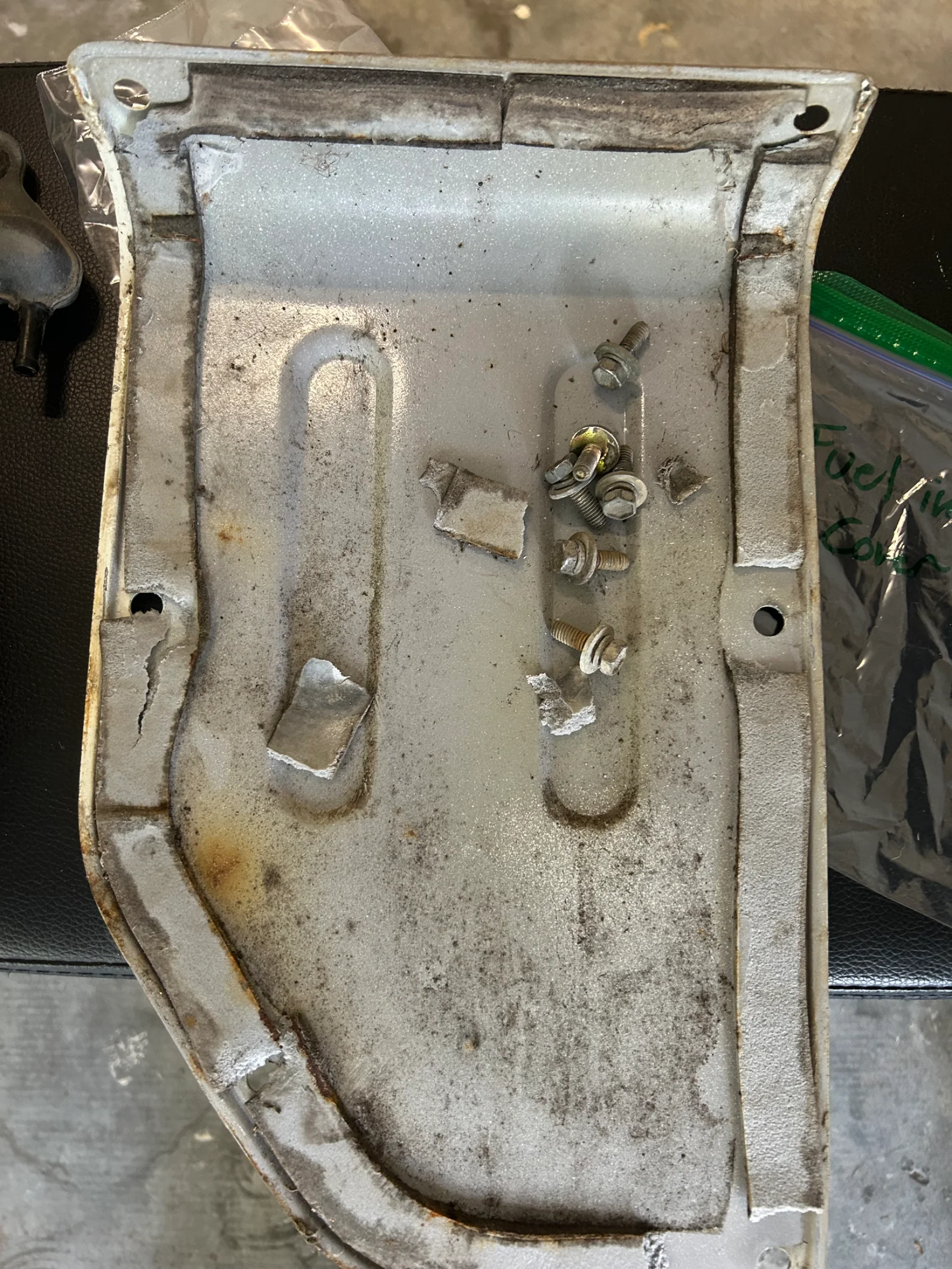

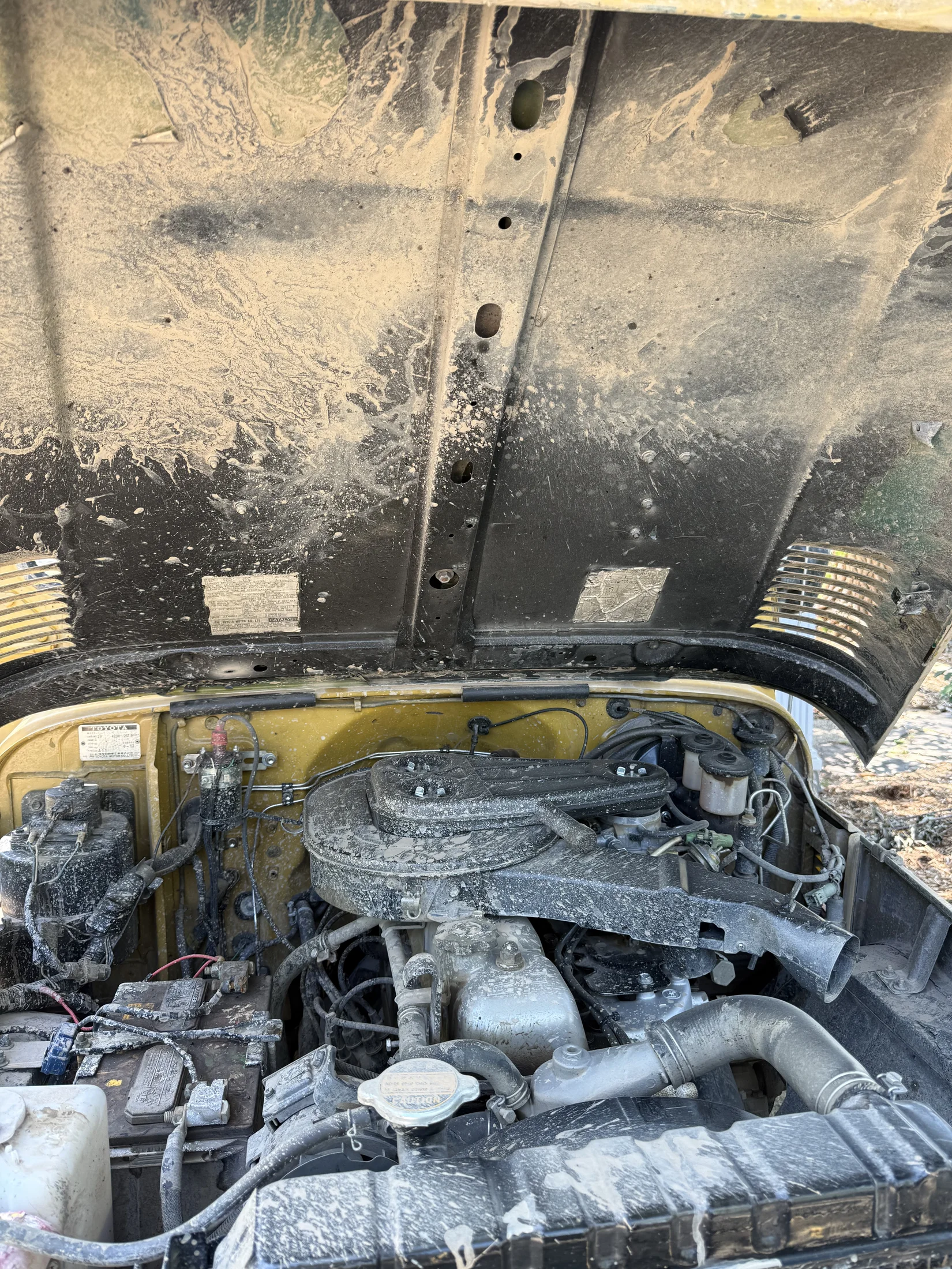

When you went through replacing the gas tank and associated parts did you have to replace this foam tape material on the fuel separator and fuel tank inspection covers? Looks like it’s there to prevent rattling. Trying to see if anybody has replaced it with similar stuff as mine was pretty shot.
I didn't but I think that will be in my future for sure when I do more interior work. I will most likely be like you and seek out suitable material.

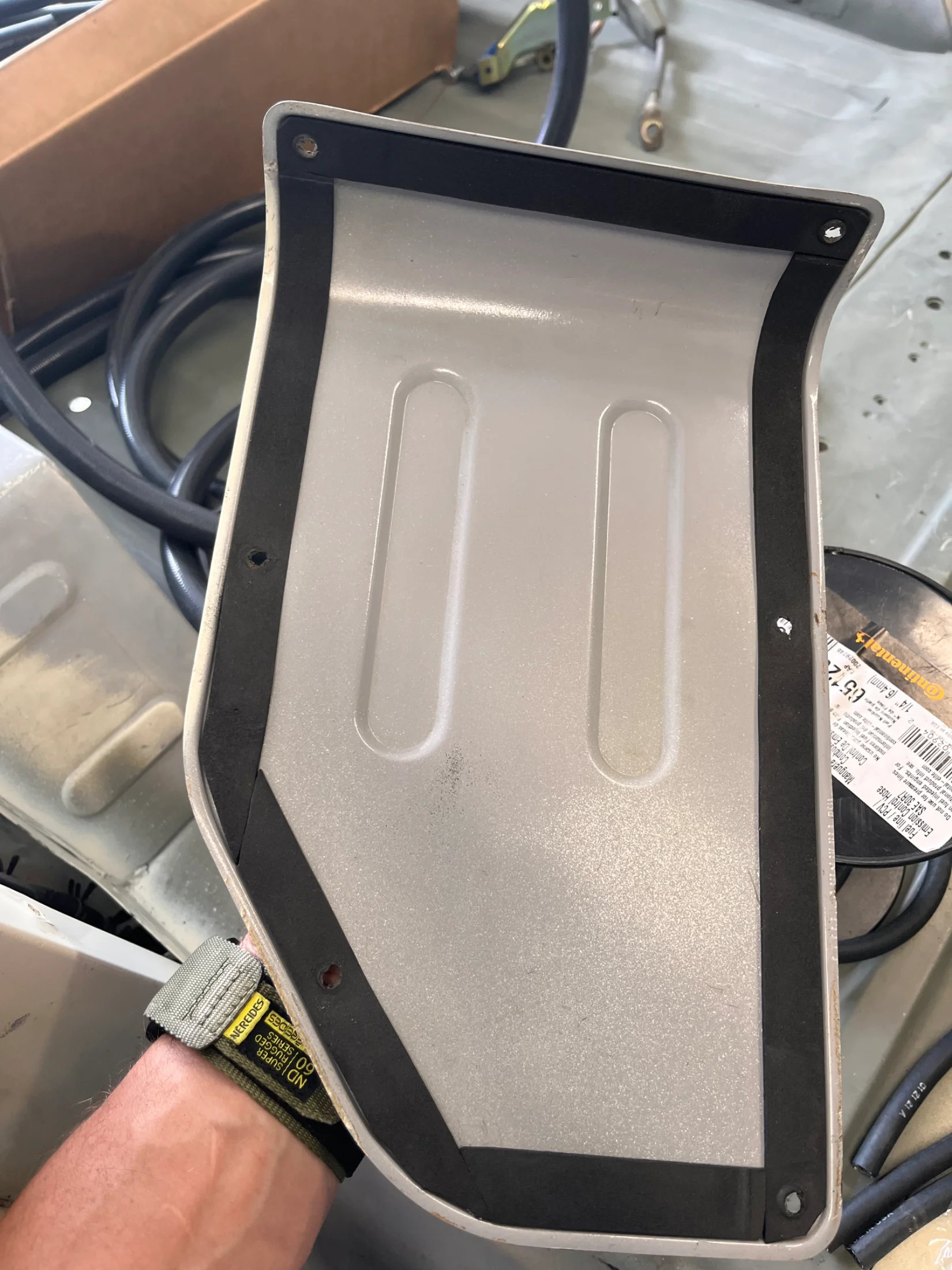

That doesn’t look original. Mine was one piece and black. I replaced it with some 3/4” by 1/8” black weatherstrip. I had it on hand already because I used it for the shift plate cover on the transmission hump.
