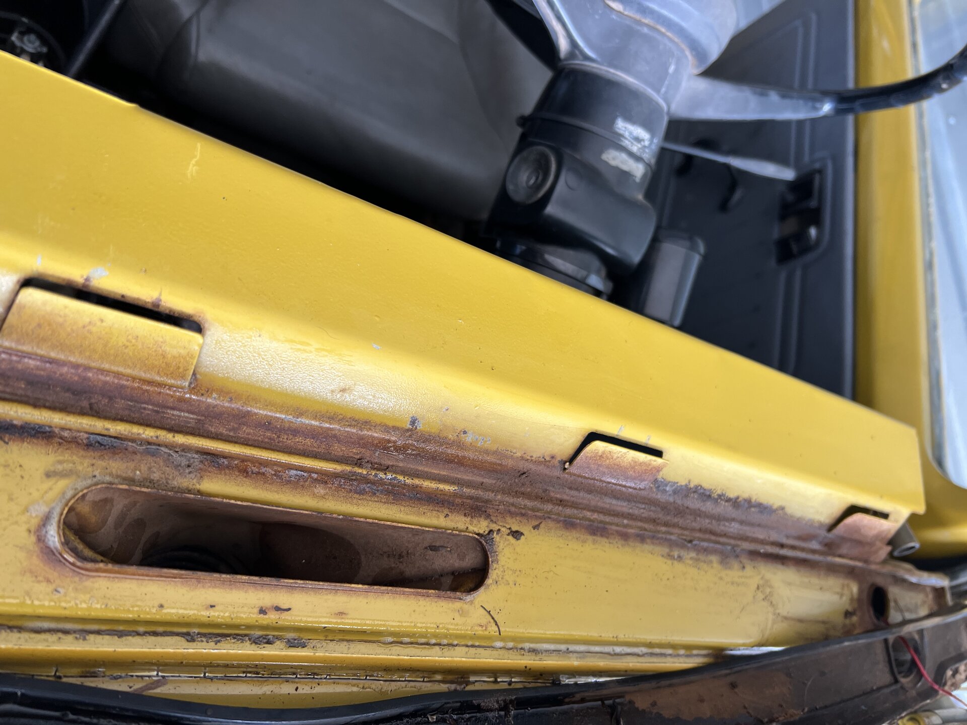

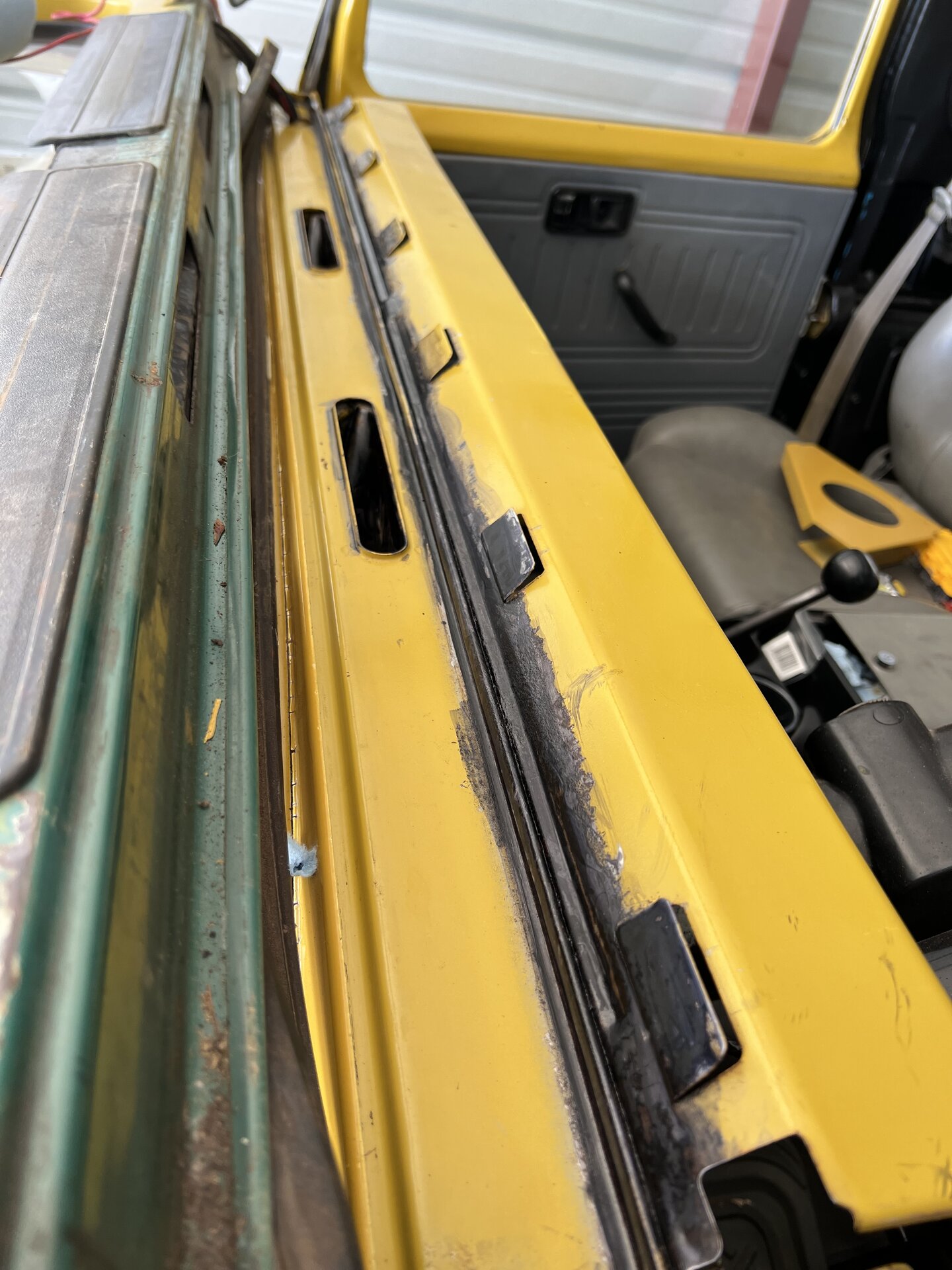

Decide to take on the rust below the dash pad and windshield frame. – die grinder & hand sanding what I could, then painted on Rust Converter x2 with a tiny brush – let it cure – [epoxy primer for bare metal and Rust Converter, light sanding and repeat]. Today, 3 coats for that rattle-can-resto. Not a bad job of color match. oops didn't get a photo when done. Oh well.

They chem dipped to strip paint vs sandblast, welded in patch metal, and primed it for me to paint.
Now I need to paint and rivet it to the roof then work on the rust in the drip rail and the bolts that broke off in the roof drip. Maybe get a headliner for it while it is off and just be done with a project for a change.

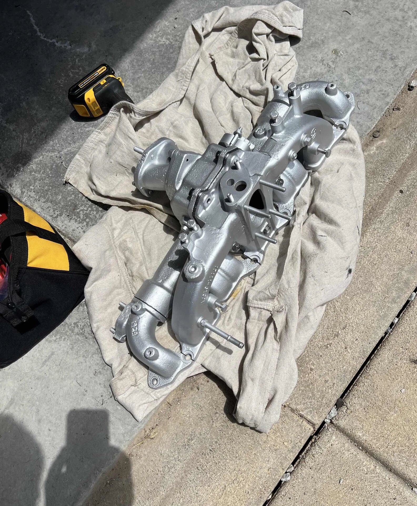

So while I was on travel last week, I decided to get some bling going too. Pick up the goods from powder coat this am - (got the call yesterday it was ready - so that is why I called in well). Valve Cover, Air Cleaner, parts of the linkages, and also got the intake/exhaust ceramic. Put on new valve nuts too.
Got all put together - to test out one of the two carbs (the 77) - I secured a spring that was missing - the other may wait until the weekend to trouble shoot. Was fun to drive a few miles. Will post what I am seeing with it later in the week.

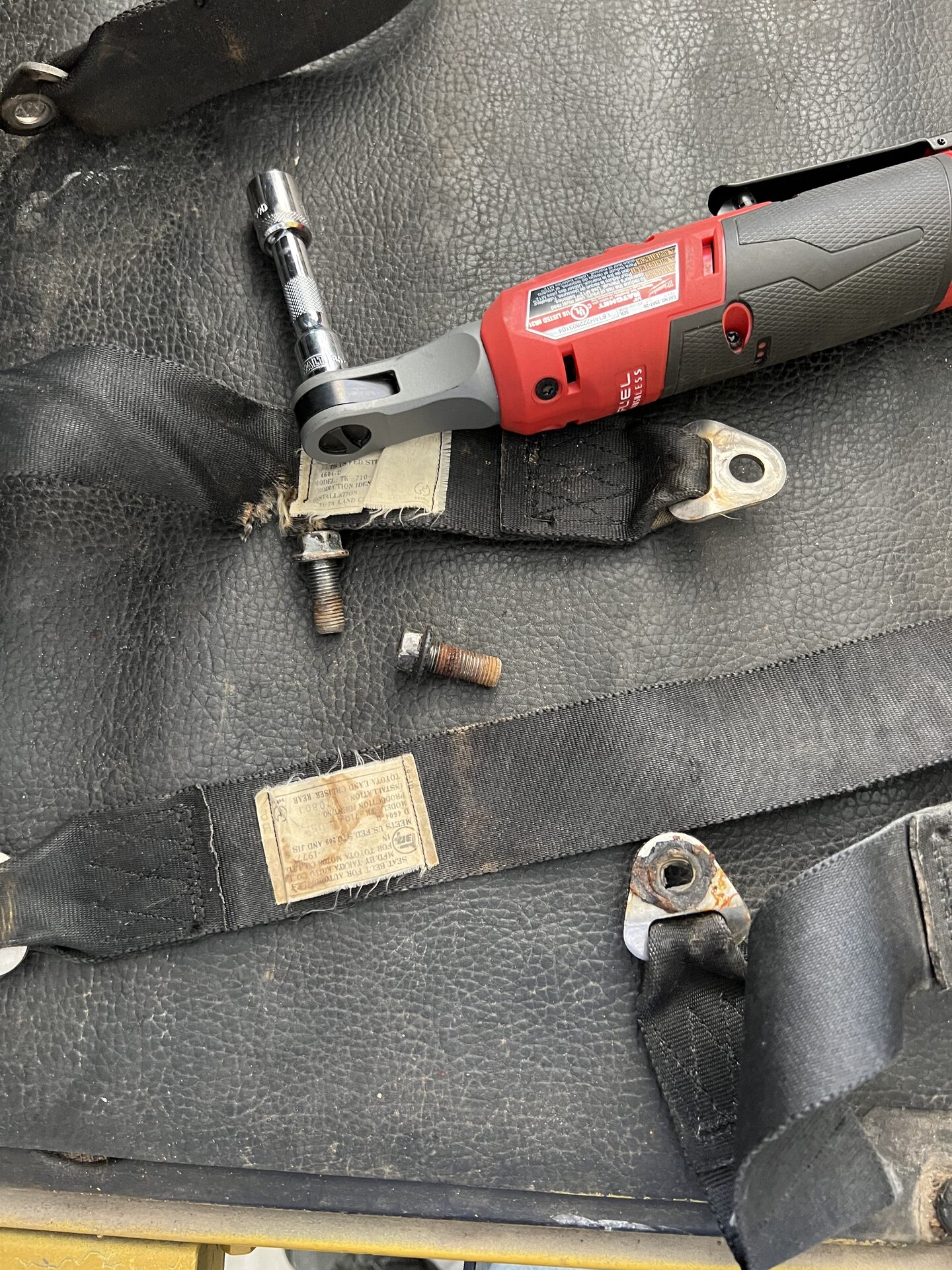

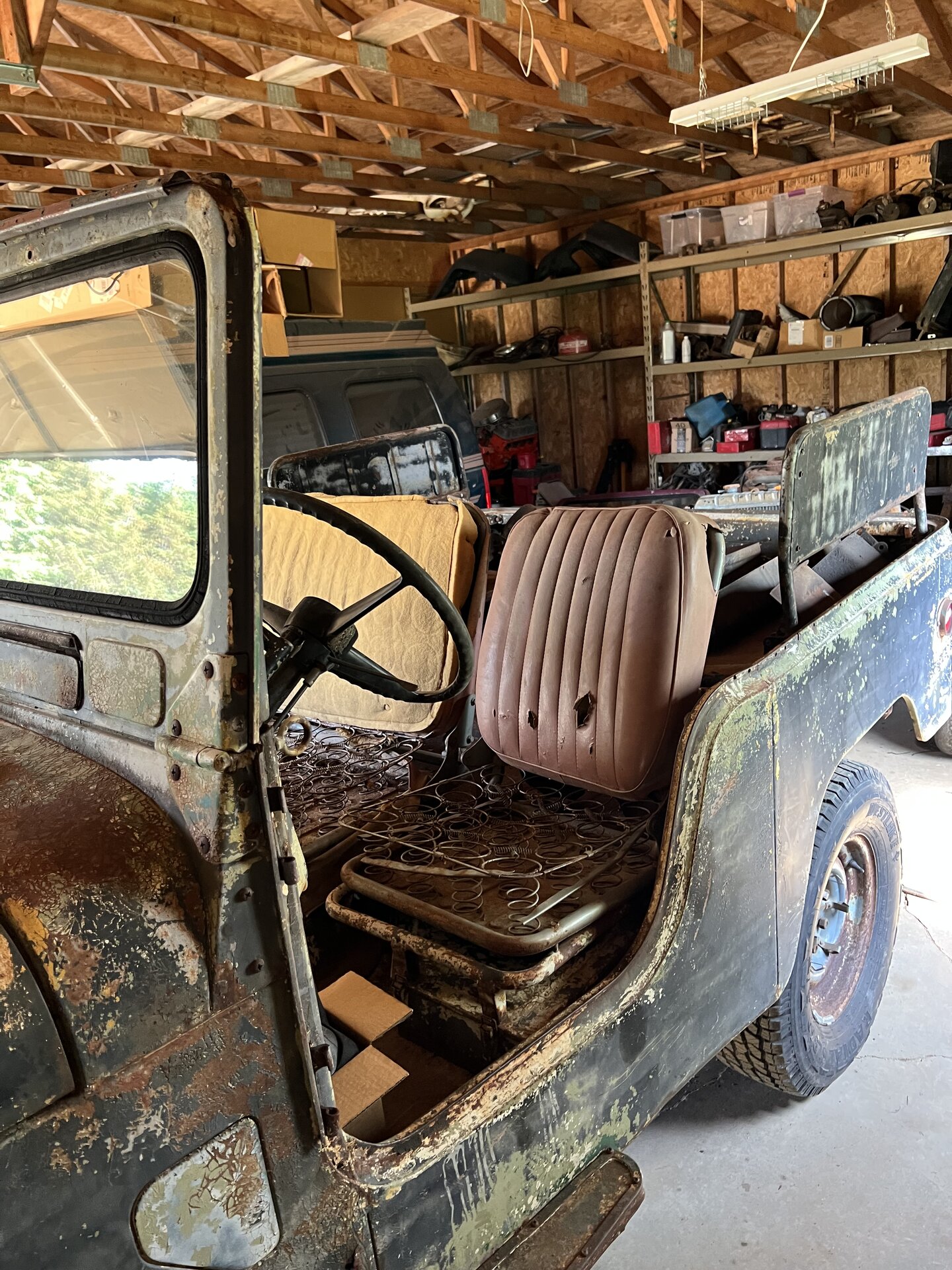

Lots of little stuff over the weekend – The seatbelts were frayed and colors mismatched – yes part of the charm and history of this version of Adult Legos but the OCD is strong.
Sent them out to get restored. They sewed the old tabs on the new belts.

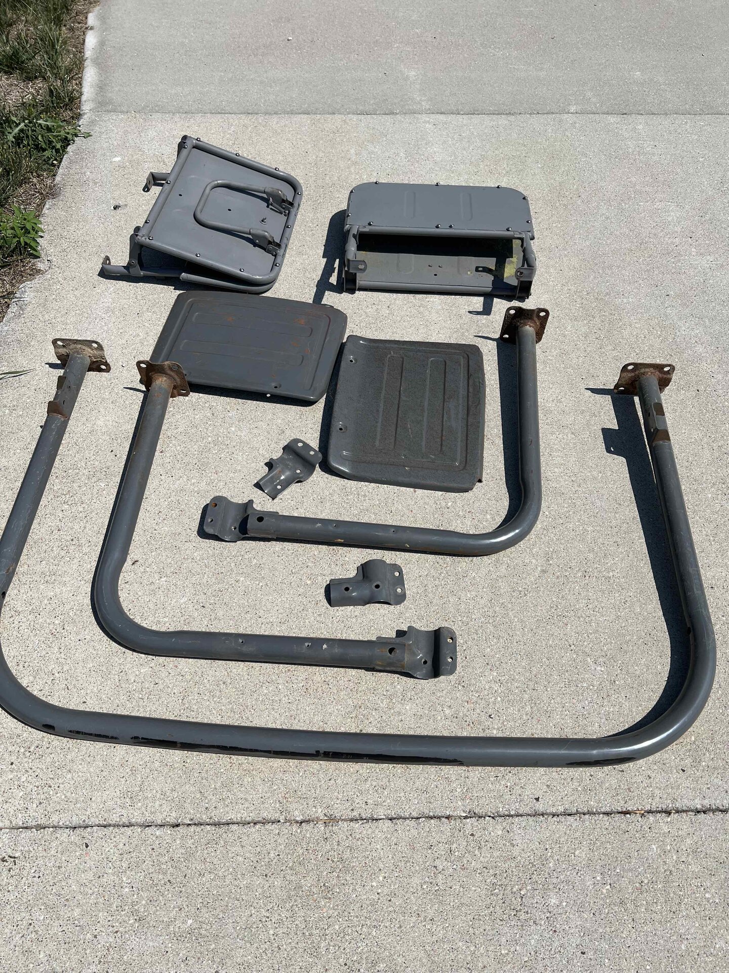

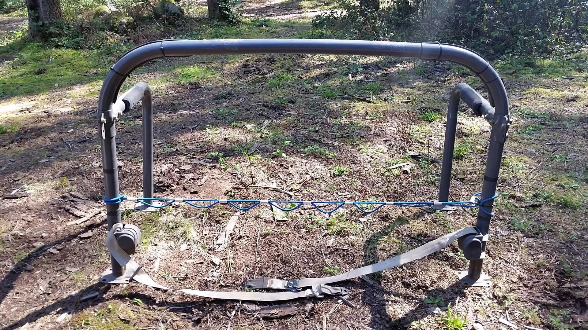

One thing I was wondering, as I’m thinking about going without the top this summer, is where the retractable part goes when the sides are off? I figured out I don’t have the correct roll bar. (should be a bracket on the roll bar closest to the seats that the retractable part attaches to).
I have a few feelers out there. I see some aftermarket solutions too if the feelers don’t pan out.

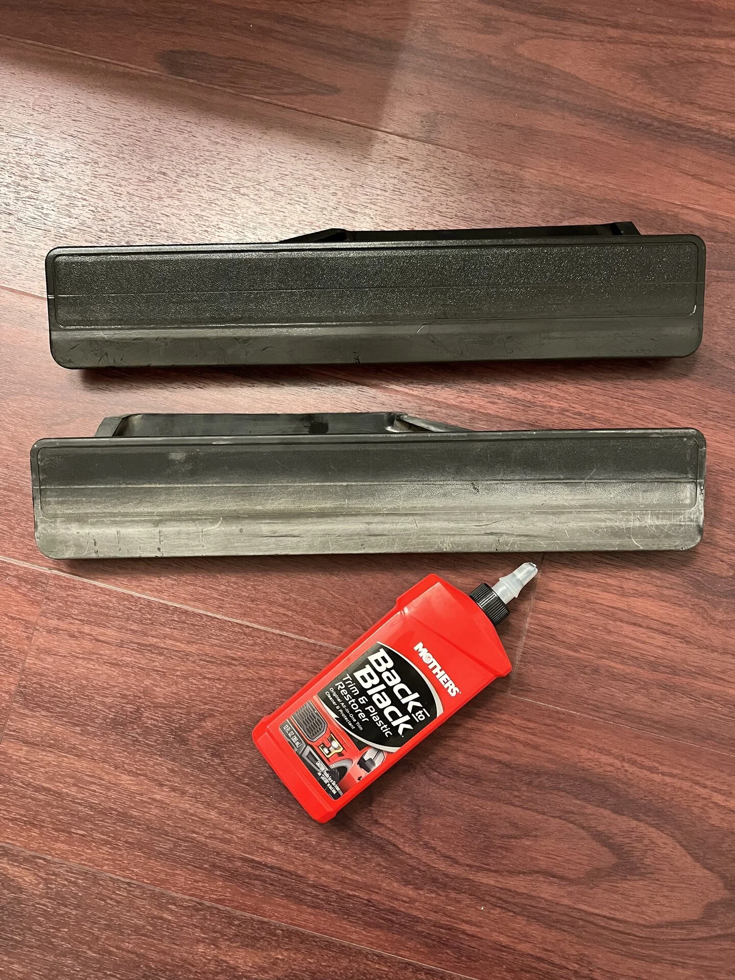

Polish the knobs and enjoy the short-lived victory. Also the vent shields or whatever the proper name is.

Decided to dig into the OEM seats in have and see about restoring them. Well one at a time. Spent time figuring out how they come apart. I did take the rear seats all the way out. I’m going to clean them all up too. I'm going to get the rear seat frames powdered. I think i found the period correct grey the seat frame, front set back cover, and the roll bars are colored (why I am doing one). Also get the seat bottom to powder too.
The tracks are really hard to roll/slide. Getting them to slide easier is like asking the sun to rise from the West. Lots of years of gunk in the tracks etc.
The cushion on the back is looking good, so I got that going for me.

made a bling drip the other day with the correct roll bars, seats, etc. Going with "Traffic Grey B" powder - think it is close - enough for me - and it will all be the same color (which I really prefer).
Pict of powder chip and seat back. Not sure when will get done - Then will get the remaining colors done if truly will be out for a while... will see what next weekend brings.
