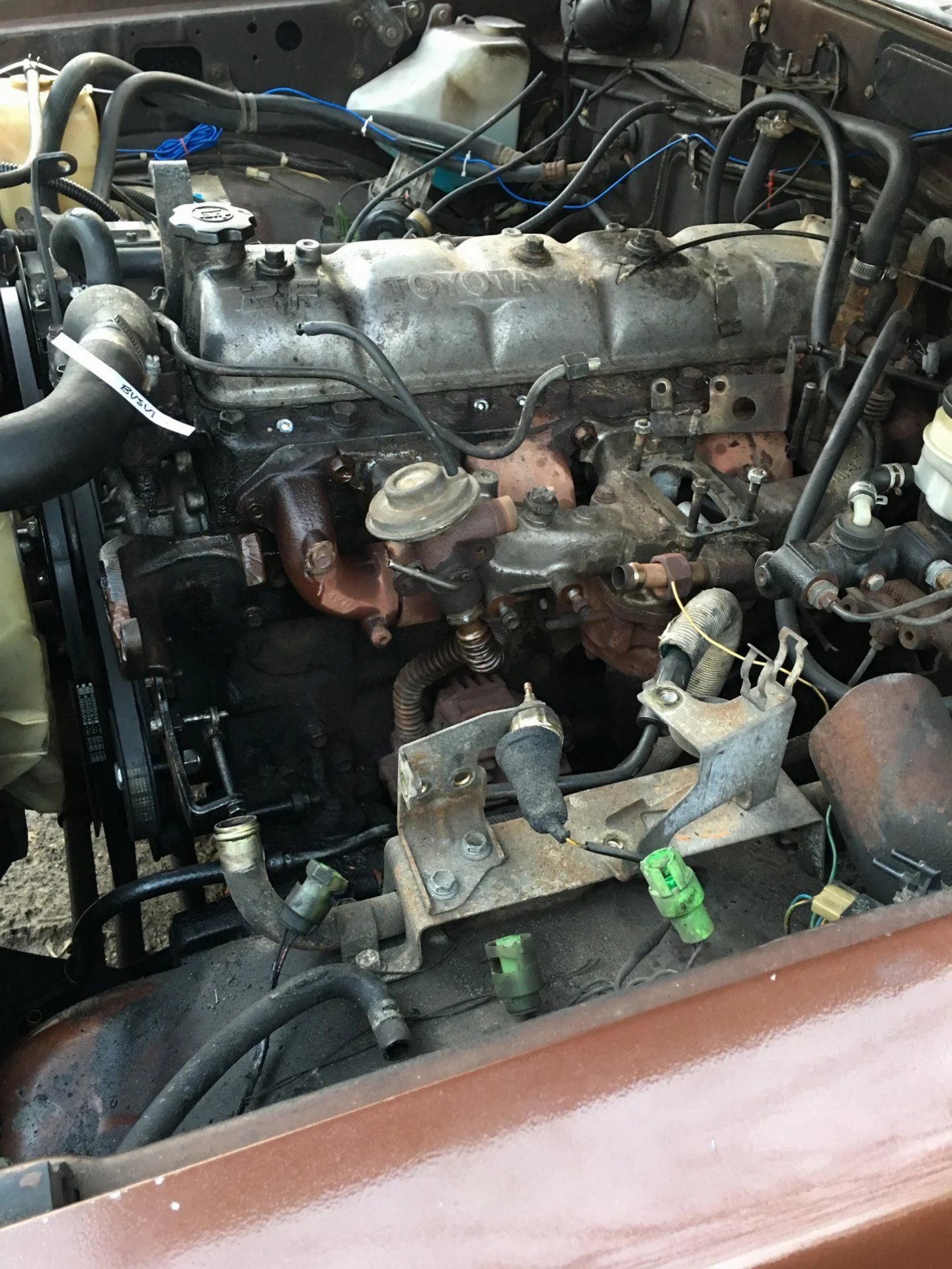

Need some help.
In the middle of my DeSmog. Trying to Remove the EGR System but how the hell do you get to the J pipe coming into the bottom of the of the manifold? Im assuming this is the pipe coming out of the back of the EGR Cooler attached to the block? Without a car lift I don't see how I can get to it from the top, cant get under the car currently.
Here is where I am at so far.
Also the JimC @FJ40Jim @orangefj45 cap and plug set comes with 6 allen head screws for the air rail hose, it also comes with two larger ones...What are they for?
Any help is appreciated.

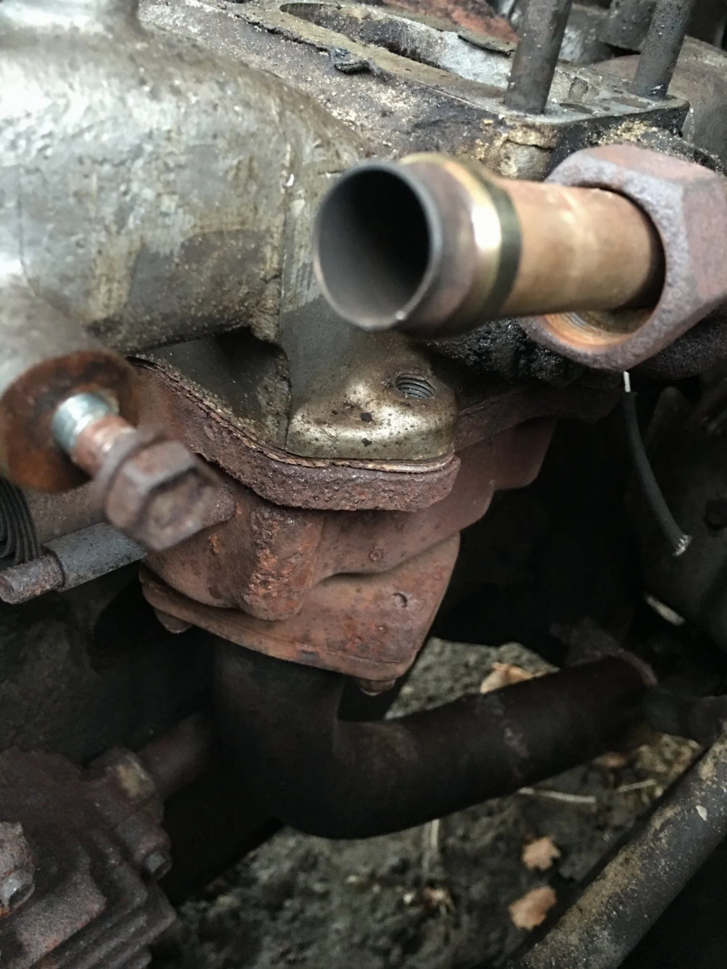

A little update i am mid desmog, taking my time. I have everything removed except the manifold. Wanted to lean on some that have done it already see what else i may want to do while i have all this room to work with and half the side out.
I am planning to do the exhaust manifold gasket, i have all the Jim C kits to block off EGR etc. My engine has 197k original miles on it seems to run great minus lots of vacuum leaks missing valves etc. Thinking removing the valve cover polishing it up getting a valve adjust while im in there.
Couple of questions the bolt holes for the EGR Cooler should i seal them with something silicon, another bolt? Also the Bolts for the EGR valve to manifold piece silicon or JB weld bolts back in?
Here are some current shots.
Any other suggestions are welcome, im stuck with the manifold in there because i thought i could get it out the EGR portion without removing exhaust, but will have to get the truck in the garage to get under it and remove the exhaust.

Remove all the egr stuff. You don't need to remove the exhaust, or manifold. Remove EGR inlet and install man a fre block off plate with the Pcv Nipple. You can keep the original pcv inlet to the manifold (that you have pictured) but you need to plug the hole air tight. Look at the last pages of Jim c's thread "desmog components." To see pictures of what to do with it.
Get under the truck and you can remove the exhaust portion of the EGR using extensions on a ratchet. Then install the block off plate you had.
The pipe that comes off of the exhaust into the bay can be cut and welded shut, or you can do the "hillbilly fix" which is described in the desmog guid (put a bolt in there)

Ya I knew I didn't have to do the manifold but have the gasket already so going to replace it. However I could get the flexible pipe to the cooler off the EGR valve siezed shut so having to remove manifold to get it all out anyways.
What's going on with the valve shouldn't matter since it's coming off. one of the bolts snapped? Spray pb on it for the next couple days, torch it, and grab a screw extractor set. You can leave it there as well. Removing manifold you need to reinstall correctly, and unless you think your manifold is leaking you probably shouldn't touch it.
All of the EGR related bolt holes are dead end holes. They don't go through to anything. You could screw short metric bolts slathered in antiseize into the empty threaded holes to keep the threads clean if you ever think you'll need those bolt holes again.
