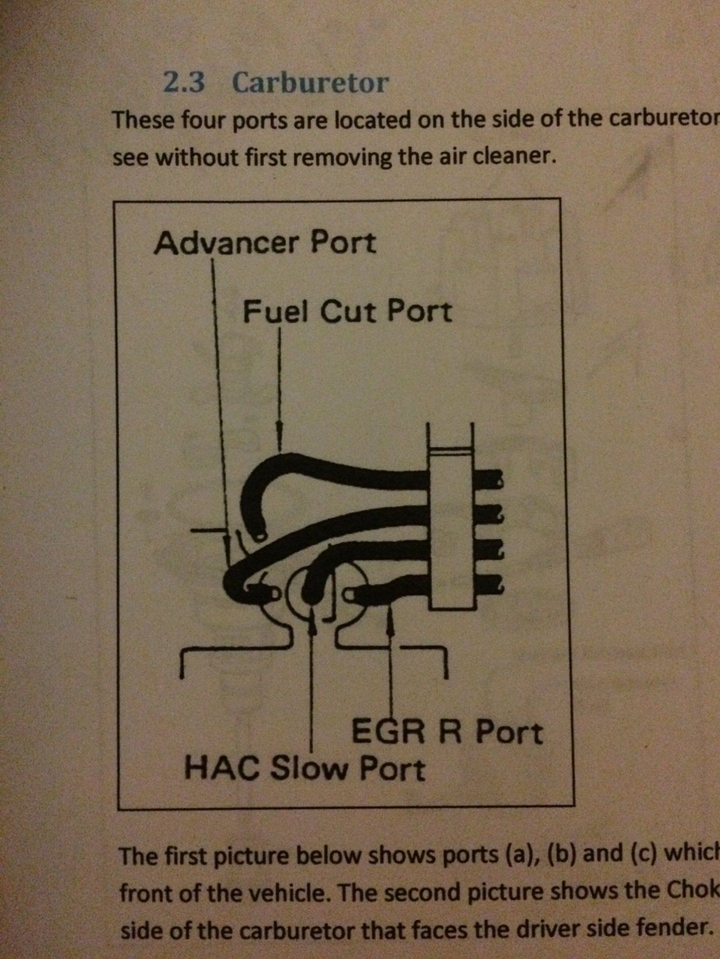

Which one of these 3 ports is the correct one for the advance on the distributor...?
That picture is super hard for me to see well but the advance on the carb is the short one furthest to the firewall almost out of sight.
OK... Wow there is a lot of great info and knowledge here. I wanted post the diagrams I marked up and used, I believe them to be accurate and they certainly helped me shed some light on things (for myself). They were marked up using info from this thread and others.
I hope it can help some of you, too!

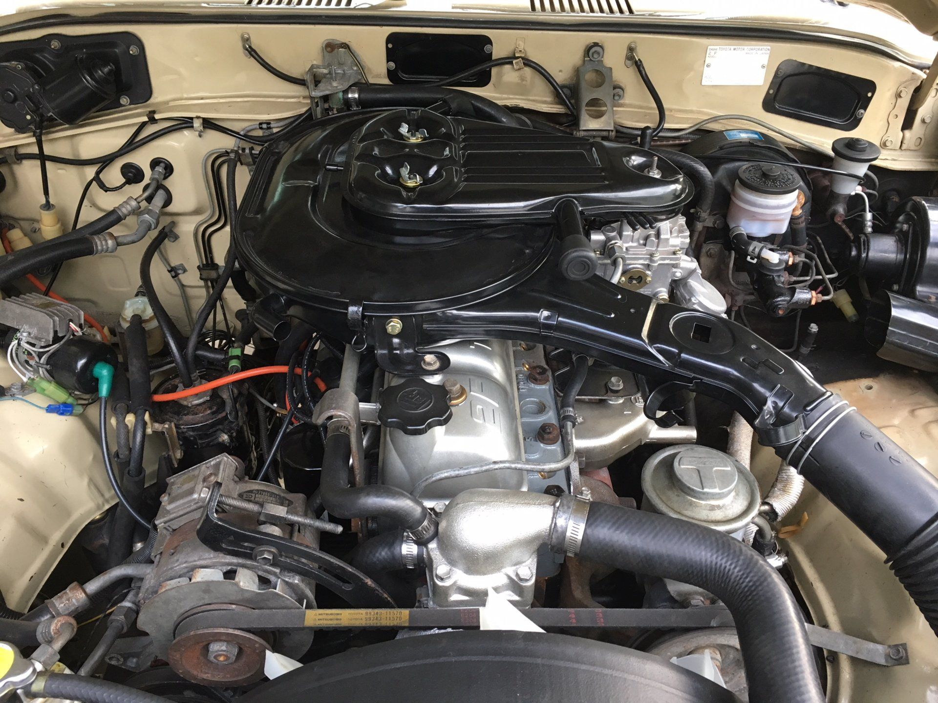

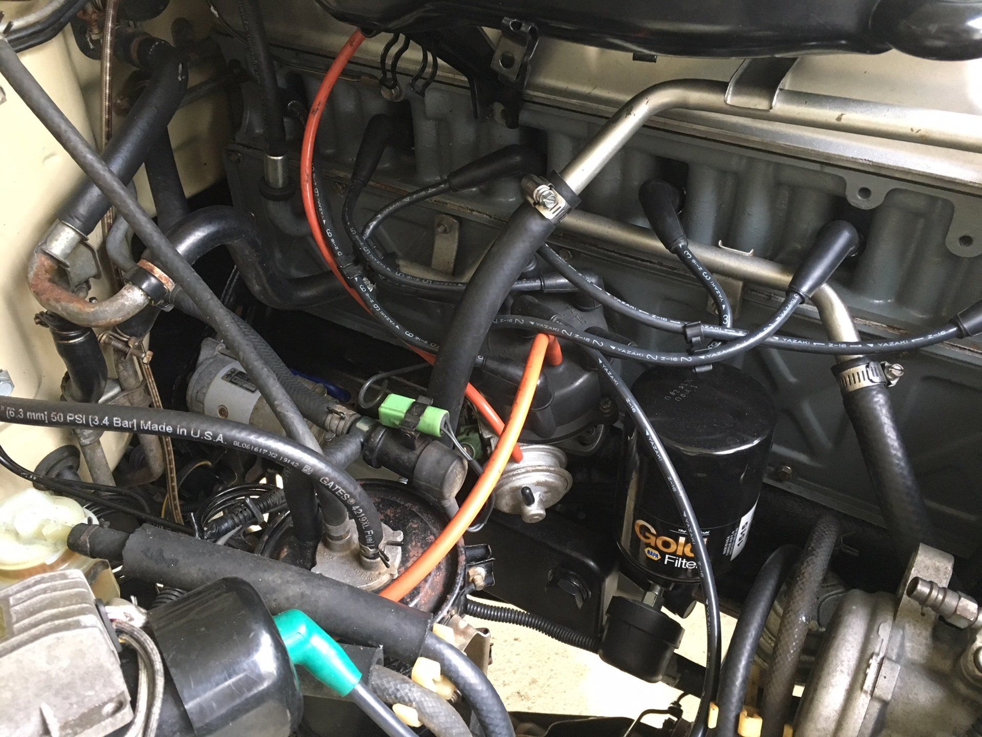

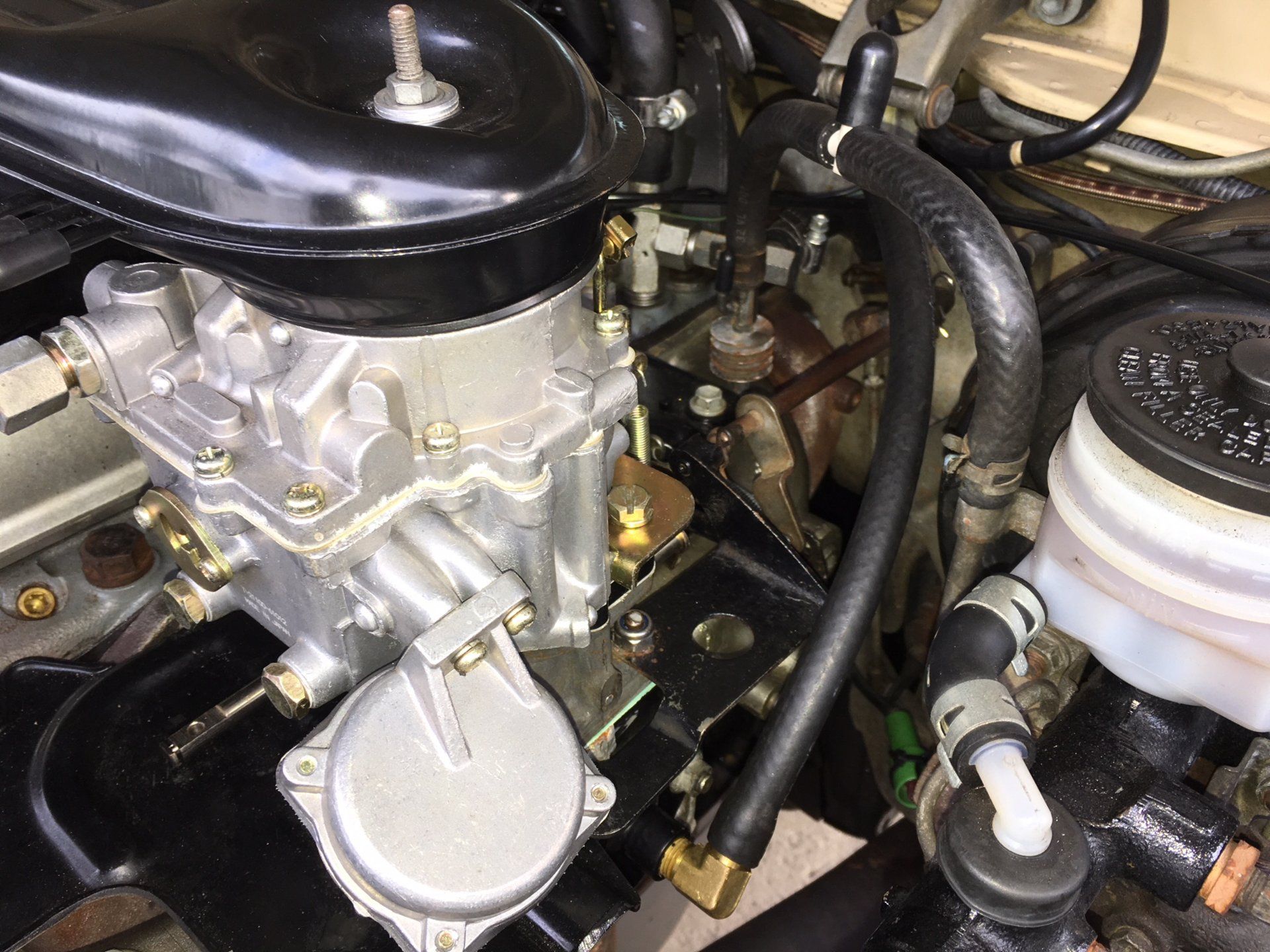

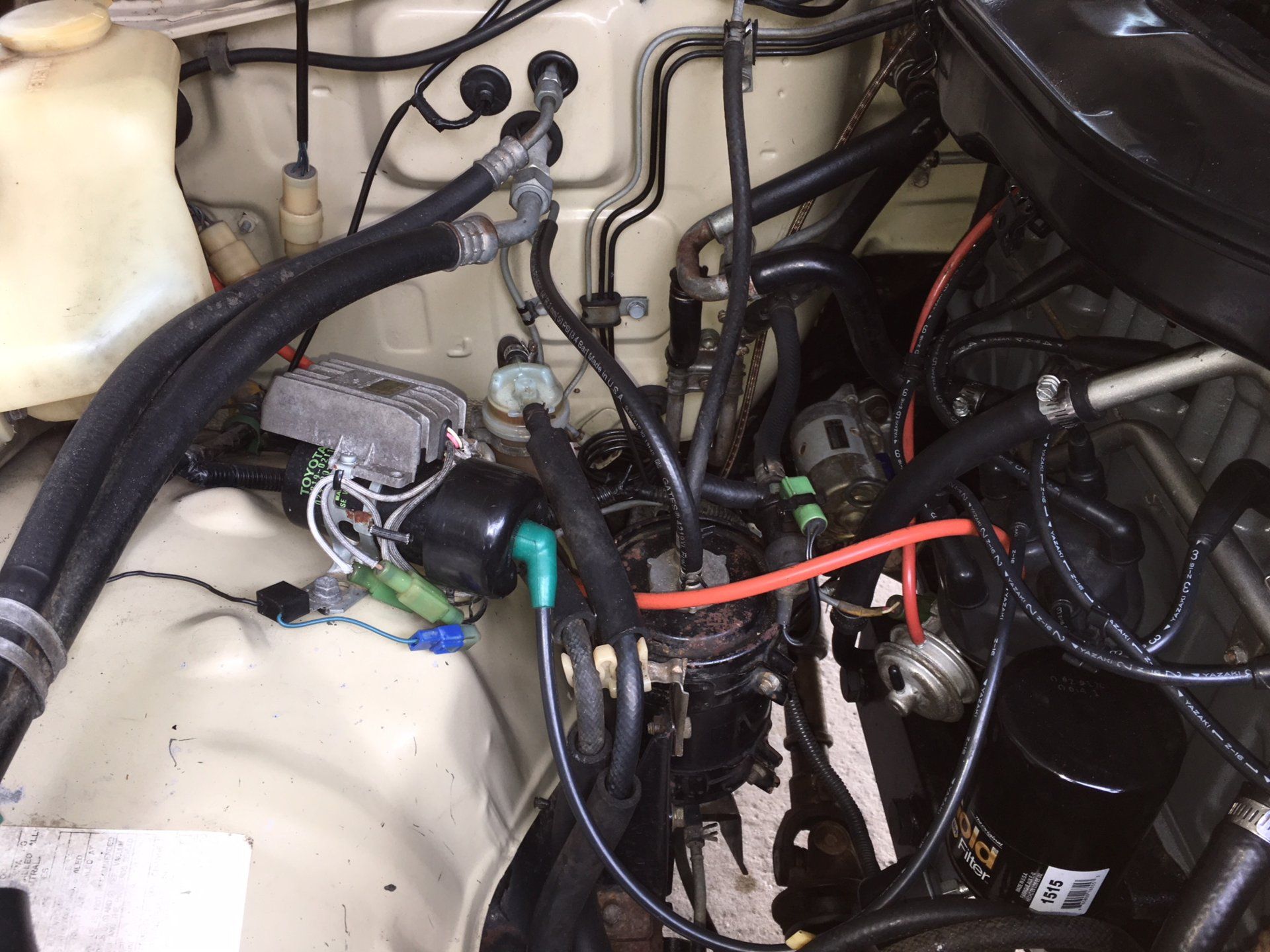

Just finished cleaning up a messy desmog by the PO. Used to have a Holley carb that I replaced with an aftermarket City Racer carb and added a stock air cleaner. Removed old rusted cat, replaced with 2.5' straight pipe and new muffler with exhaust exit out side behind rear wheel.
Also , I saw a post by @FJ40Jim that recommended switching the vac advance to the secondary if at sea level. That seemed to help considerably with the engine pinging and runs a little better now. Set timing to 10*
The truck drives nicely and pulls strong. Only issue I seem to be having now is a slightly rough idle with an occasional skip or stumble but nothing major. Also, occasionally I get a slight bog down in 2nd gear at 2500 rpm. I've never driven another FJ60 so I have nothing to compare it to.
Below are some pictures. If anybody has any recommendations, please let me know. I can take more pictures if needed.

If you want your vac adv on the secondary port you’d need that red hose to the outer port on the pot. The inner port is the primary and if your set at 10 plus the inner at 13 naturally, it would seem to me that your too advanced. Have you checked both w/ a mityvac to be sure they even hold vacuum? Often the inner port is the one that’s fried too.
I see that now. I think I misunderstood one of the posts on here discussing the primary and secondary. Although it seems to be running better they way I have it with no more pinging. I haven't checked to see if they hold vacuum. I'll have to get a mityvac.
Take the cap off the diz... then It’s possible you could put a stretch of silicone hose on the port and suck on it hard. If you see movement of the governors then the diaphragm isn’t blown, if not then it is... but thats only if you’ve got a good set of lungs on you. Definetly not a tried and true test.
