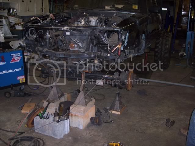

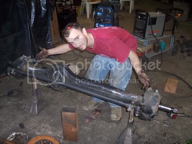

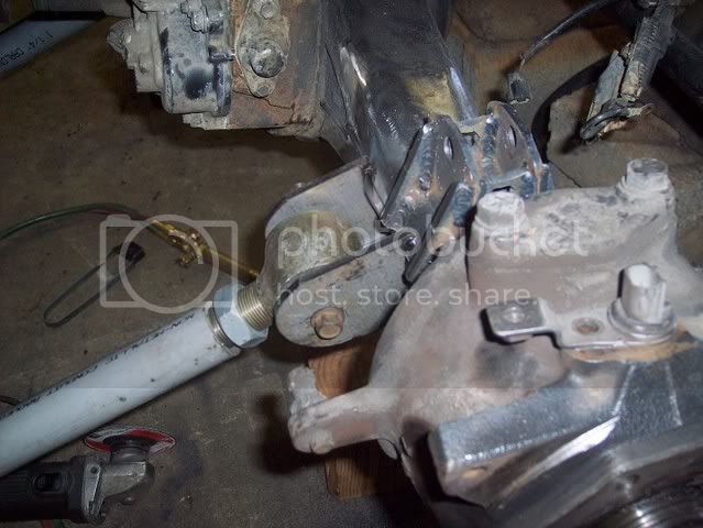

It turns out that you can flip the tierod on a -80 series axle to the front by reversing the trunion bearing plates and cutting the steering mount off the opposite side(it hits the caliper). I'm running full hydro now so I don't really have a need for the steering arm anyway
Because I know everyone loves pics of trucks on cinder blocks

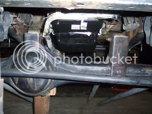

Back Under the Truck(Look at how close everything is...yeah, thats a T100 oil pan)

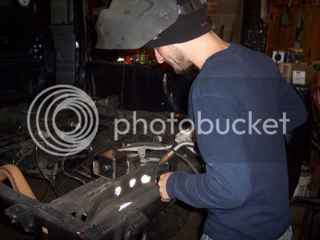

Tonights Progress:
1. Get upper mounts designed and built...

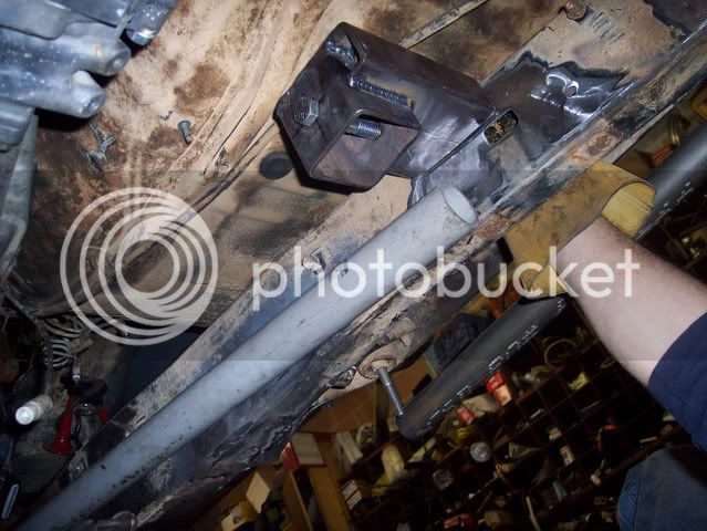

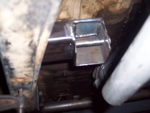

Here is the pass. side upper mount(it clears the d-shaft) This is the view from the bottom and no it isn't finished.

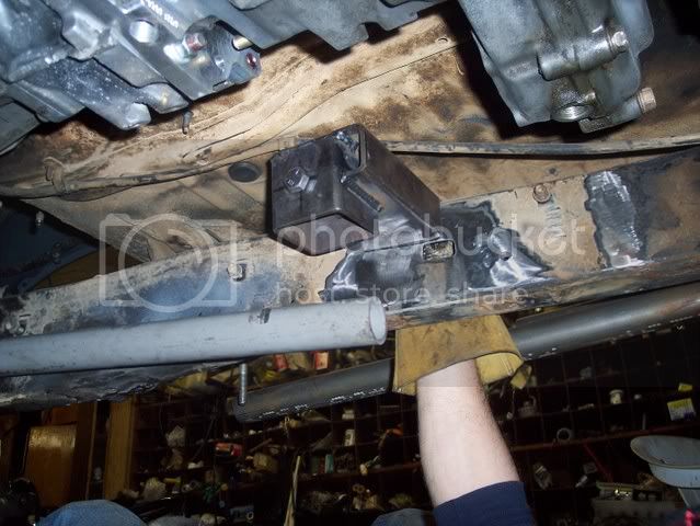

From Front

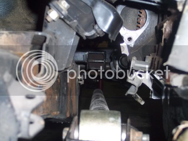

Looking up(no guessets yet)
Looking Forward from rear
