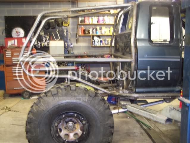

I think the cab adds a real nice look to it. Makes it look like a truck on steroids rather then just a bunch of tubing. Just my 2 cent.

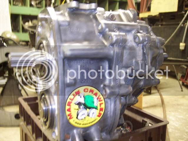

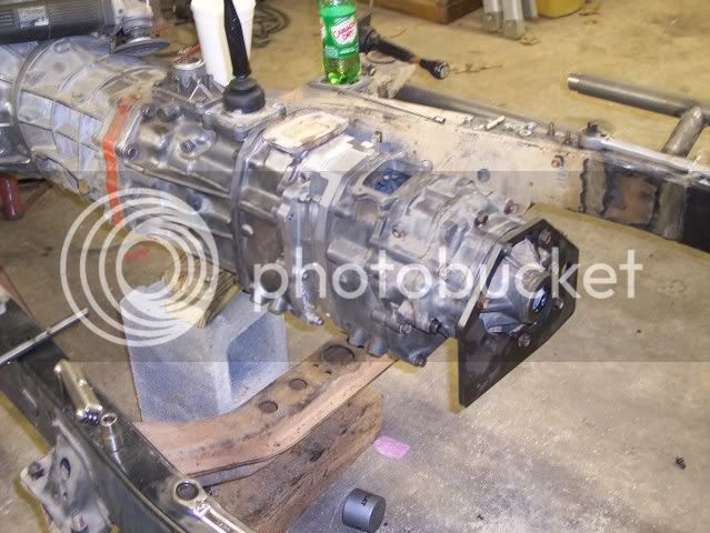

Mo' progress!...I got a case gutted tonight(finally) and I mounted it to the drivetrain. I started figuring the t-case x-member and the front suspension.

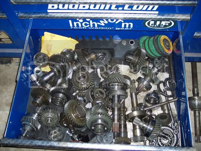

I also got a 21-sp 4.7:1 case built for a guy in our group
I sell these if you are interested...$500 and your old case...there can be alot added to them if wanted too
21 or 23 sp 4.7:1 t-case $500 and your old case or a core charge
add 3x drilled flanges
add B Long 4340 output shaft
add MC HD shift springs
add Twin stick
add lowpro drain plug
add complete new bearings
add dual case adapter
and the list goes on...

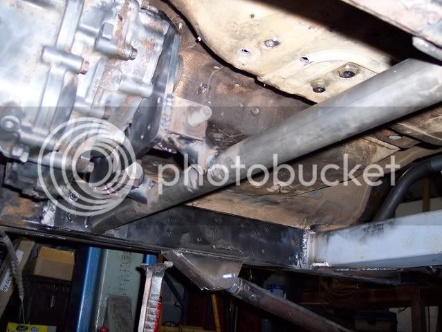

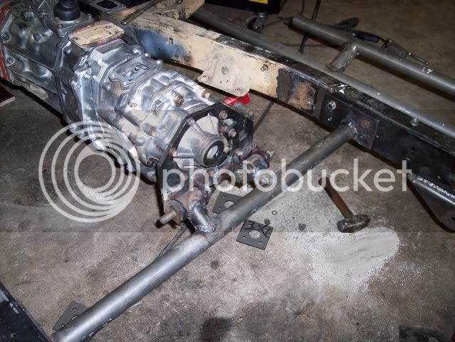

1. I got my t-case x-member built
1 3/4 DOM tubing.....BIG poly bushings(3/4" bolts)
Need to finish welding the bottom of it

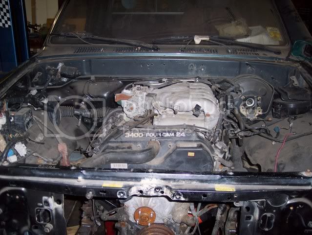

2. I flipped where the exhaust dumps from the pass. side to the d. side(I used all stock pieces!)

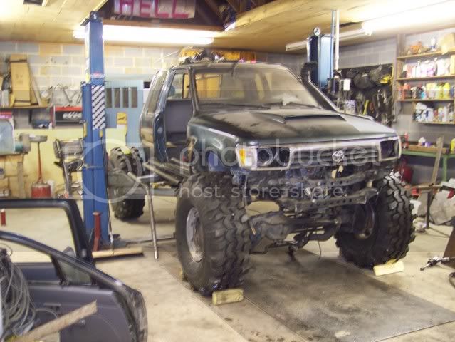

3. Cab is back on the frame
engine bay

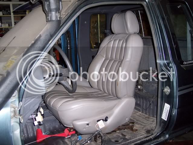

4. Got some seats
2002 WJ 8-way power adjustable, heated leather seats
Now for the problems I encountered

2.Seats
The seats are waaayyy comfy, but the are too damn tall. My head rubs the top of the cab.
THE FIX: Cut the brackets and drop them down as much as possible.
I already figured out how to get the 8-way to work but I'm going to have to go back to the yard where they came from and rob the heat button. The heat has 4 wires that work it so I need the multi-switch to make it work.

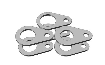

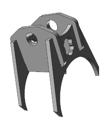

these are bad....coil-over mounts....$20.00 ea
And the upper mounts $9.00 a pair (I can get my laser guy to cut these)

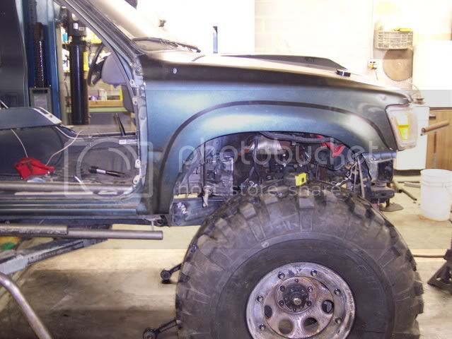

Thats really starting to look good, are you going to have enough clearance around the front gaurds?
Sawzall :cool:

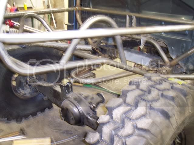

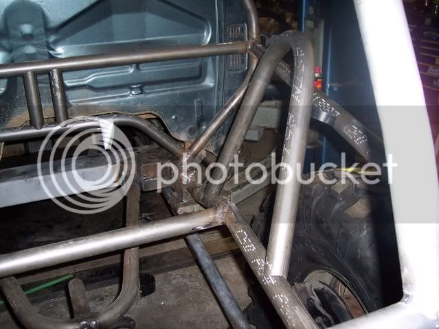

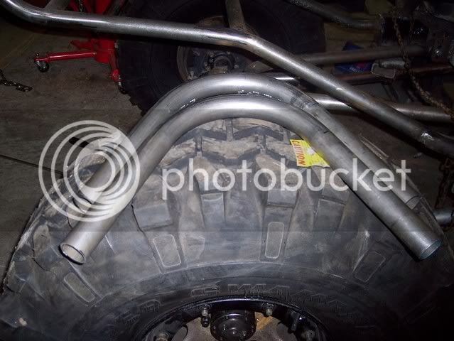

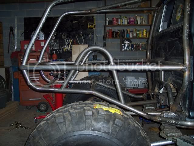

OK...got new coil-over hoops now...It turns out that my coil-overs sit at 34" at ride height 5.5" up travel in the rear (I don't think I really need anymore as of yet but that may change soon)
BEFORE
AFTER
The coil-overs are going to be mounted to the inside of the hoops and I'm going to cut and notch some tube to attach the hoops to the outer rail so it has some more support there also

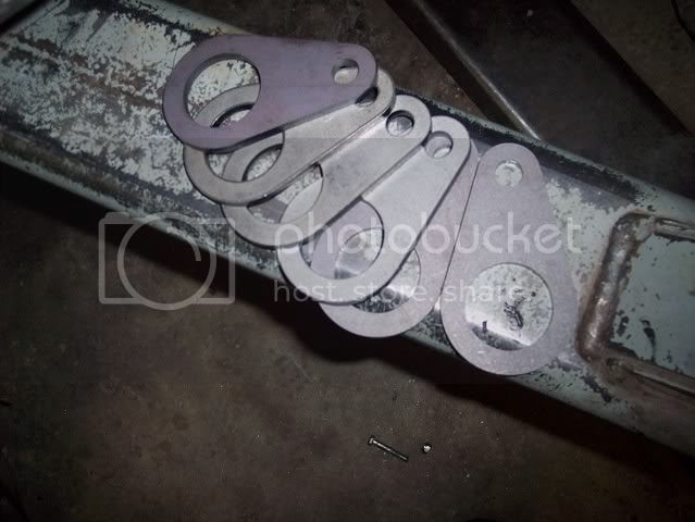

2.I also got my coil-over tube tabs....these are so I'm able to bolt my shocks in place...I still need to order my lower brackets from Ballistic Fab so I can mount them up and get them semi-out of harms way.
