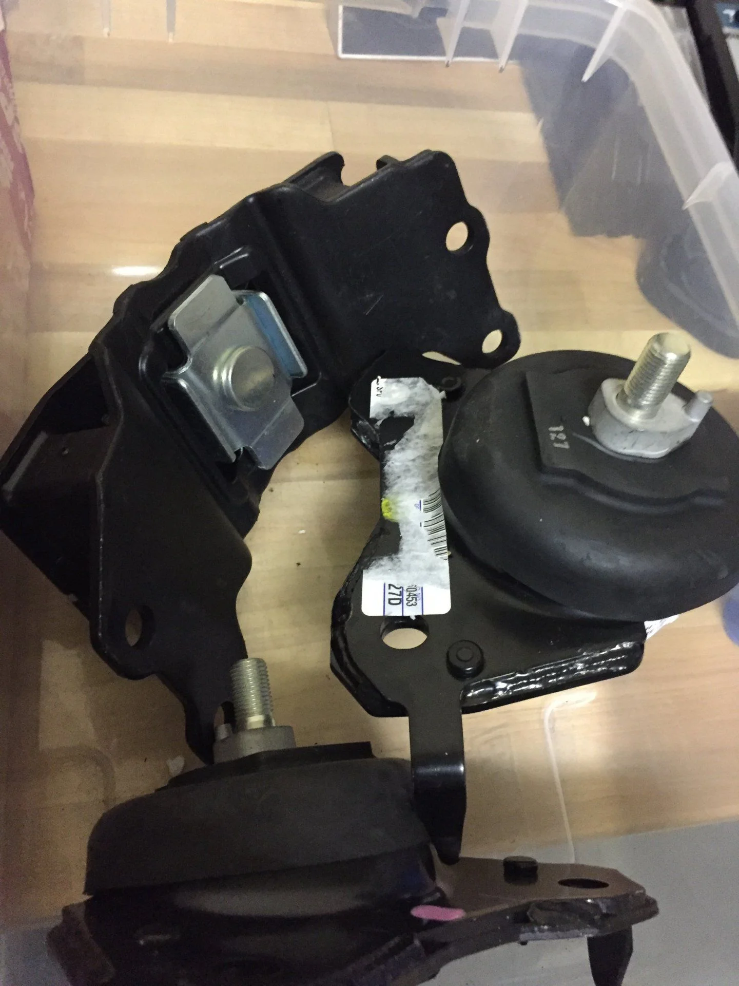

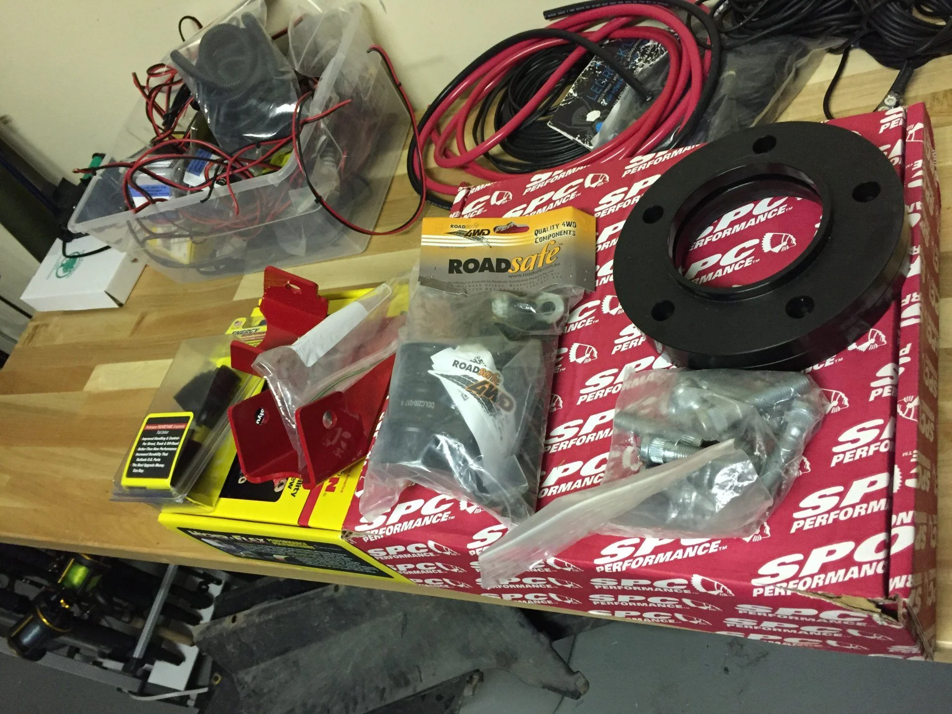

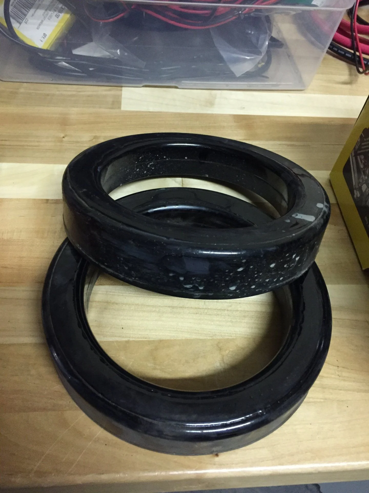

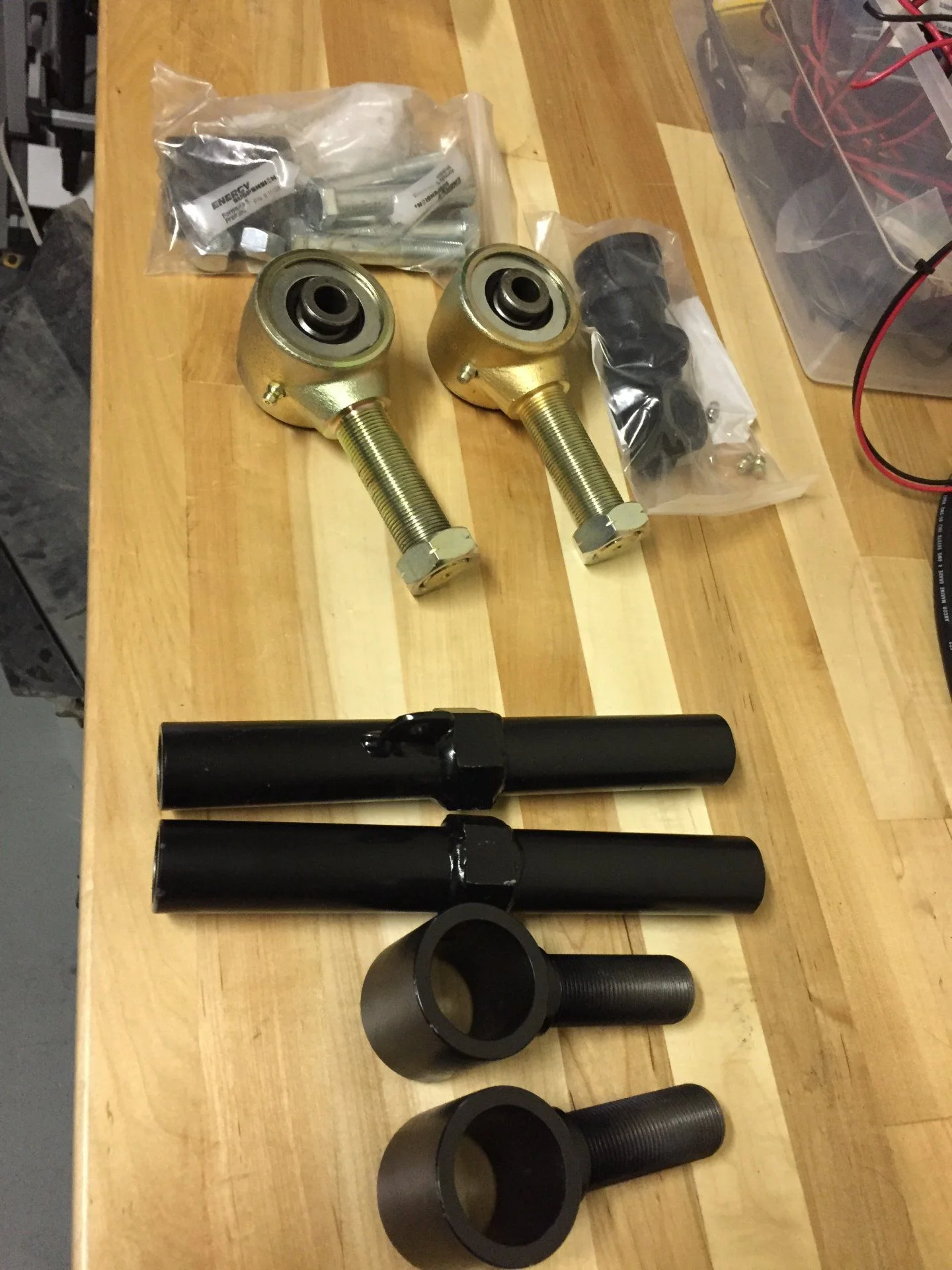

the rubbing with the 37's is mostly livable - and I expect with the front coilovers set up another1 1/2" and the rear up a 3/4 inch I should be able to fully flex. Picked up new bumpstops front and rear ( energy Susp) and SPC arms, plus a set Trail Tailor rear UCA's and LCA skids that I had PC'ed. Also going to finally install the new tranny and trans mounts that @beno sourced...... working to chase a light driveline vibration still - so have a new rear Driveshaft enroute.... will be using 20mm OME rear spacers to make up the balance.
the front KDSS rubbing issue issue I suspect will be fixed with the SPC's and moving to 15MM spacers .... and The Diff Drop kit came in today via air freight.

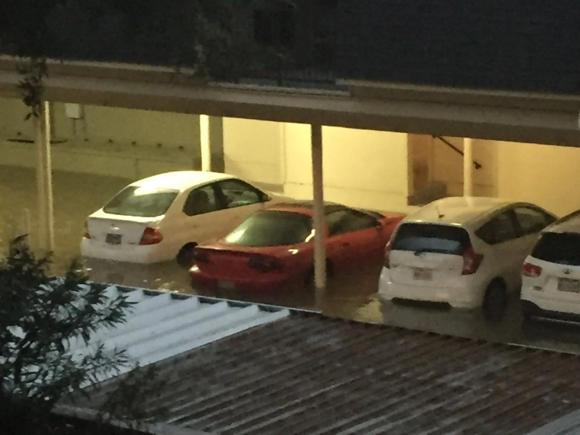

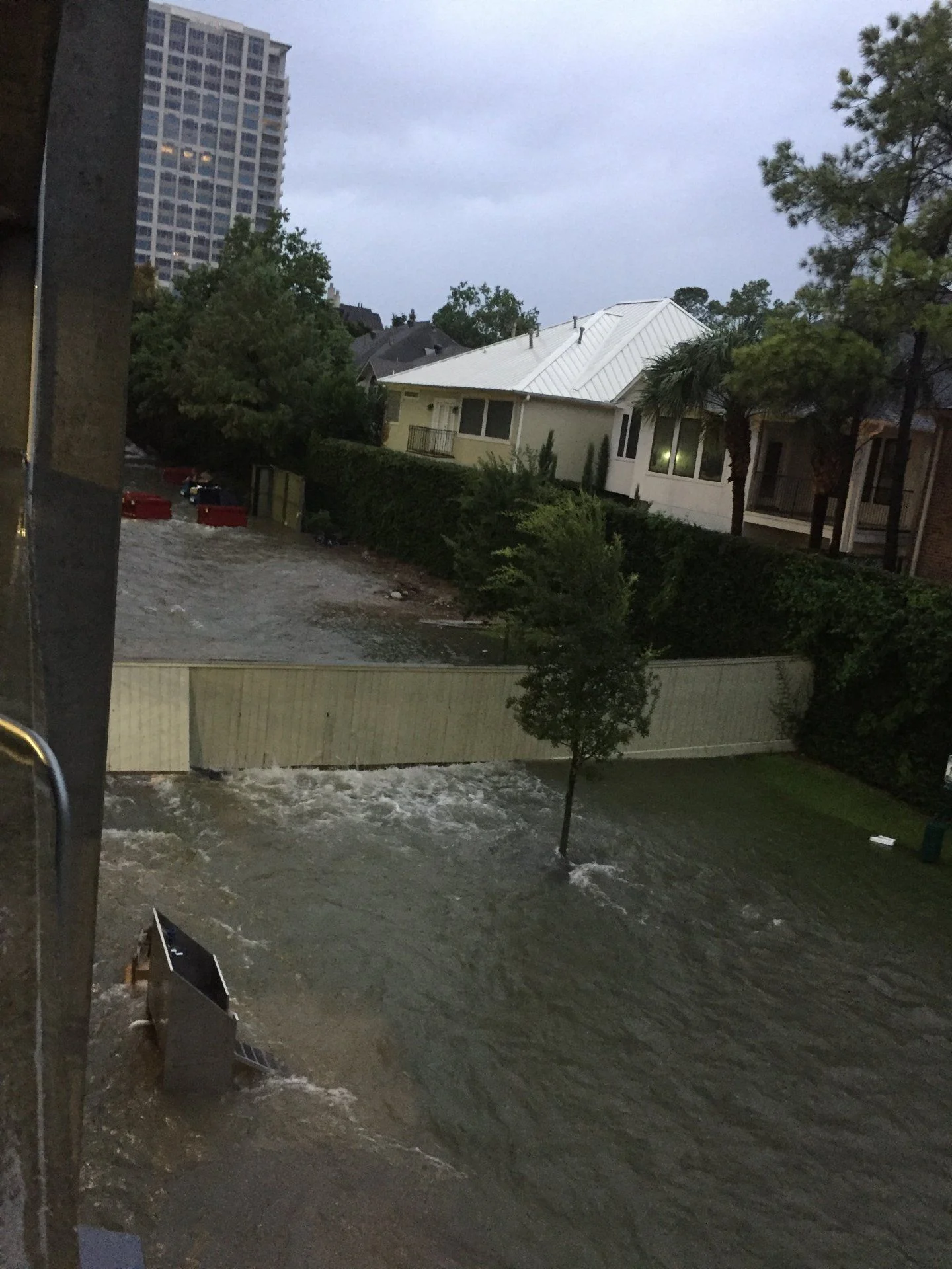

fairly dry here where I am, but sad to see alll the damage and rescues..... went out to help a friend after he stalled his car in 3 feet of water - will be changing the diff fludis next week.... or at least examining - not sure the diff extenders didn't get covered in the engine bay....
Amazed to see the folks who didn't even think to park their cars in an elevated garage...... driving around I must've seen a hundred flooded cars.....

Amazed to see the folks who didn't even think to park their cars in an elevated garage...... driving around I must've seen a hundred flooded cars.....View attachment 1525301 View attachment 1525301 View attachment 1525302
