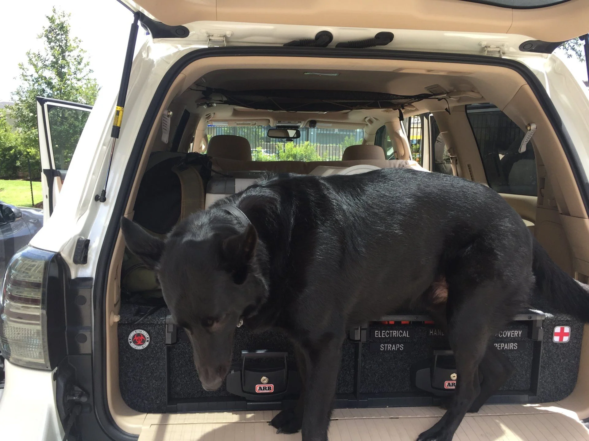

I LOVE the drawers ...... perhaps second favorite mod.... to the headers/exhaust. they are jsut really well built and allow me to carry way too much of the stuff " i just have ot have" and kepp it secure and safe.
Not sure ARB has a huge advantage over the lesser known, and was really impressed with the Goose gear stuff but that is another level up...
the sliding top really makes the fridge much more accessable as well. in fact I'd do sliders on both if I was going to do it again for the incremental $$...
and they get a HUGE thumbs up from the wife..... and the dog loves that his bed fits right over them perfectly with 2nd row folded down and the fridge in ..... they do take up alot of room if you have kids or haul stuff on a regular basis...
I had a light rattle in one but I did Rattle trap on the metal sides and that totally fixed it.

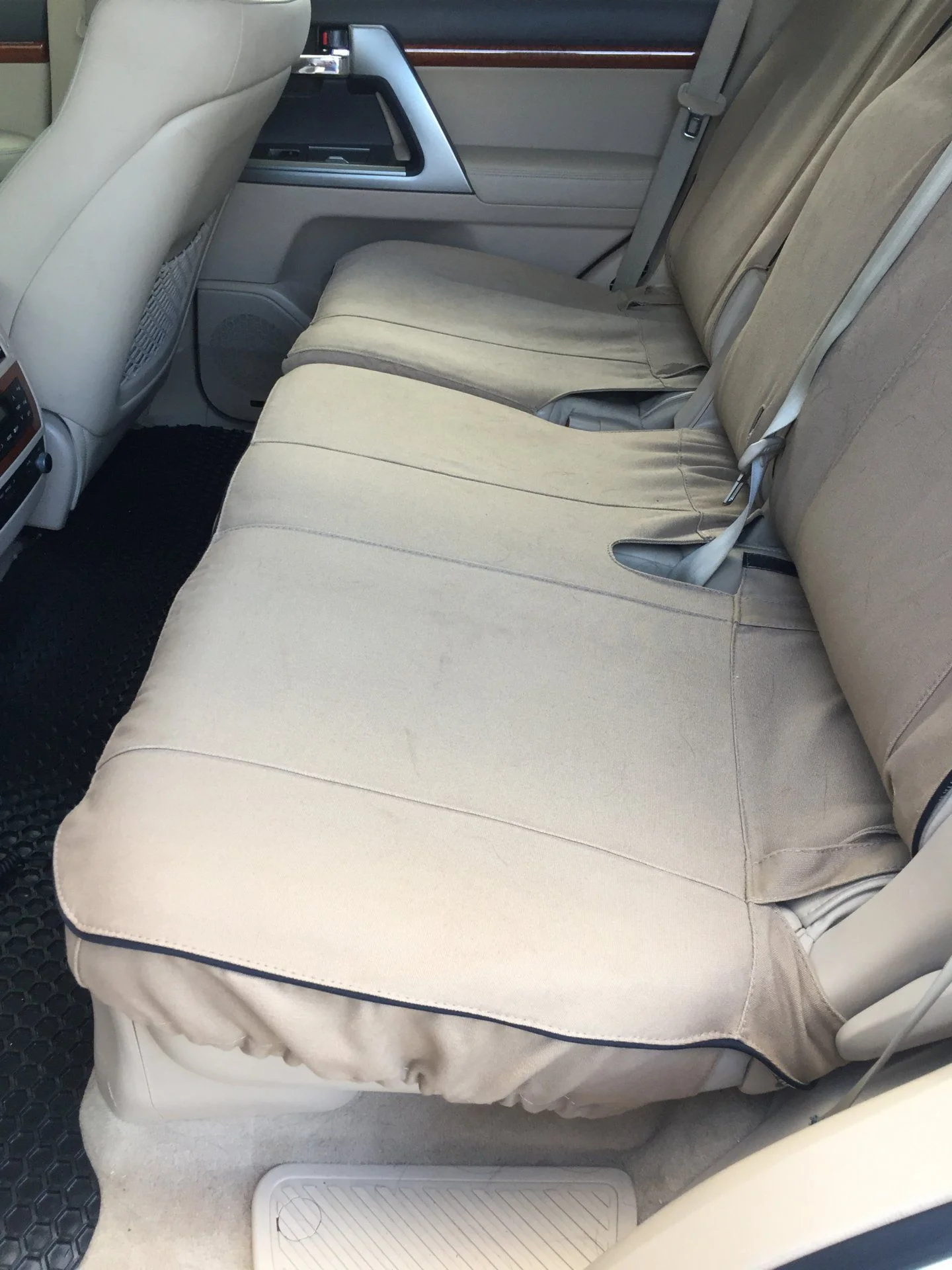

Escape gear seat covers for the rear seats - german shepard approved... ! very nicely sewn and fit really well.... might order a set for the fronts for the winter - summers in TX require the ventliated seats....

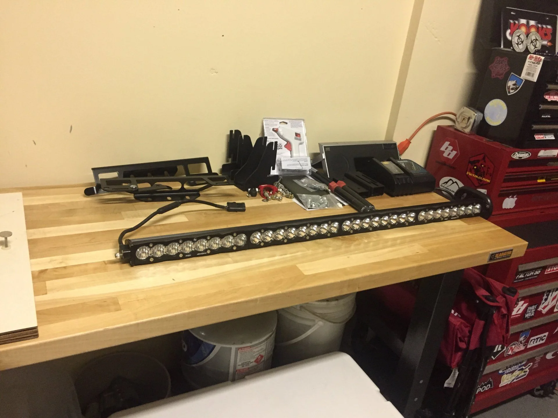

and a new baja S8 40" LED bar - the first one somehow got water in a few cells..... BD replaced it with a whole new one, no questions asked - exactly why I invested in their product..... like the VisionX lights I run they stand behind their stuff 100%....

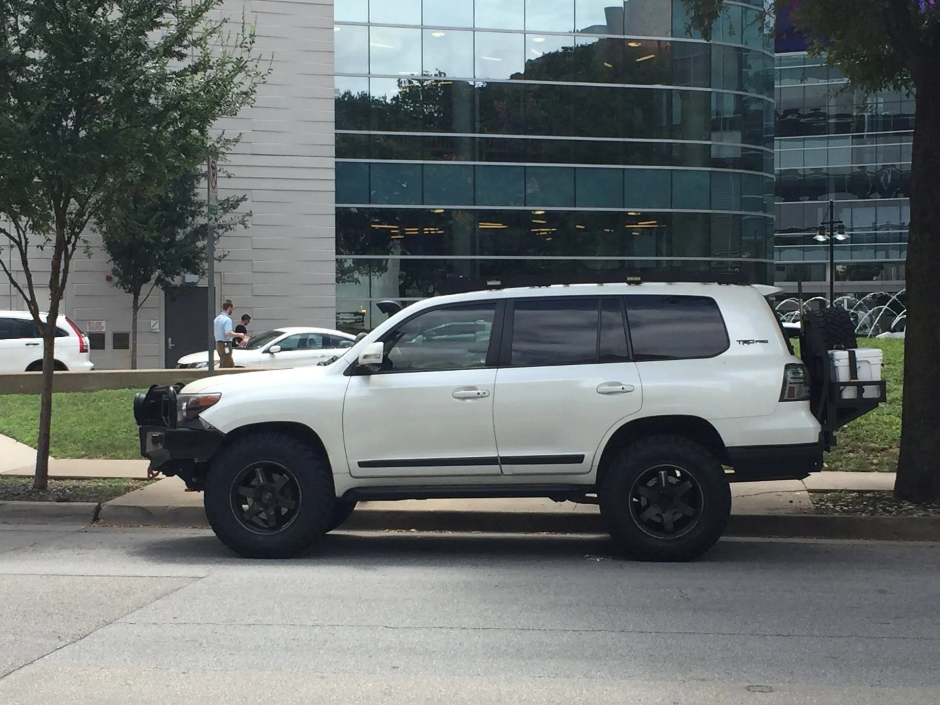

cut a bit more fender liner this morning before heading off to the airport - almost no rubbing now other then hard lock against the KDSS.
hoping all the parts arrive by next week so I can get her finished and determine IF the 3/4" body lift will be needed...
with 600 miles on the Nitto's I have to say I'm impressed at how they run - 38lbs seems to be the right pressure for ride quality.

The truck looks really cool, but it doesn't look like you have any uptravel at all especially if you put bumpstops in which you likely did/should have. What's the goal with the 37s? I hate to be that guy, but it almost seems like you should have gone with something like a JKUR with the type of mods you're adding to the 200!
Thanks for the note on the tire pressure - they were at 34lbs cold - moved them up to 38, but much of the bulge was due to the angle I suspect.

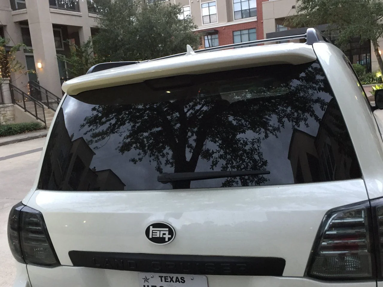

Got the TEq emblem that they painted on last night..... much better.View attachment 1358411
I'll post up better pics once she's cleaned up -
Where did you get the black land cruiser badge!?!?!?
Blasphemy
haha - agree 37's are for sure the limit on the truck, but the travel is still there... the nose needs to go up another inch plus to get it in the right spot but waiting to get the diff drop in before i turn the coilovers up... other then a bit of scuffing on the body mount brace on hard turning the tires move fully... and with the tundra front arms the marginal loss of uptravel due to the larger bumpstops is minimal...
that said I'm debating dropping to a slightly smaller tire just due to clearance.... an inch makes a lot of difference in where she fits for parking.
as for the Jeep reference.... yes- tried one of those after 11 Toyota's .... I did a fully built Metalcloak JKUR but it was souless, albeit very capable.
the LC meets the need for ability to cover ground, be reliable and carry all the stuff I want easily plus a large GSD...
cheers
