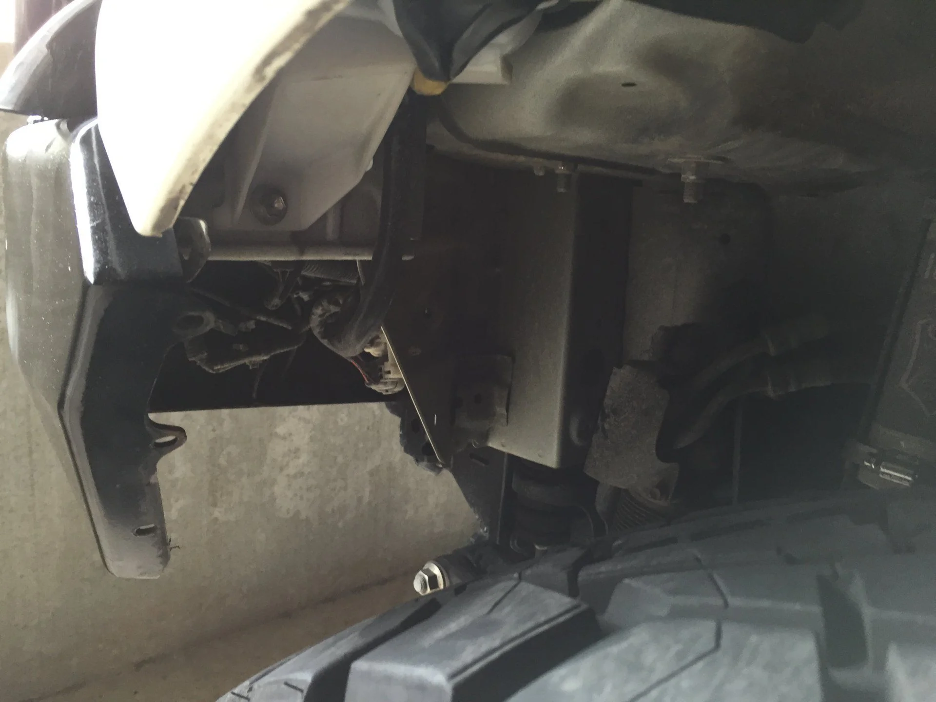

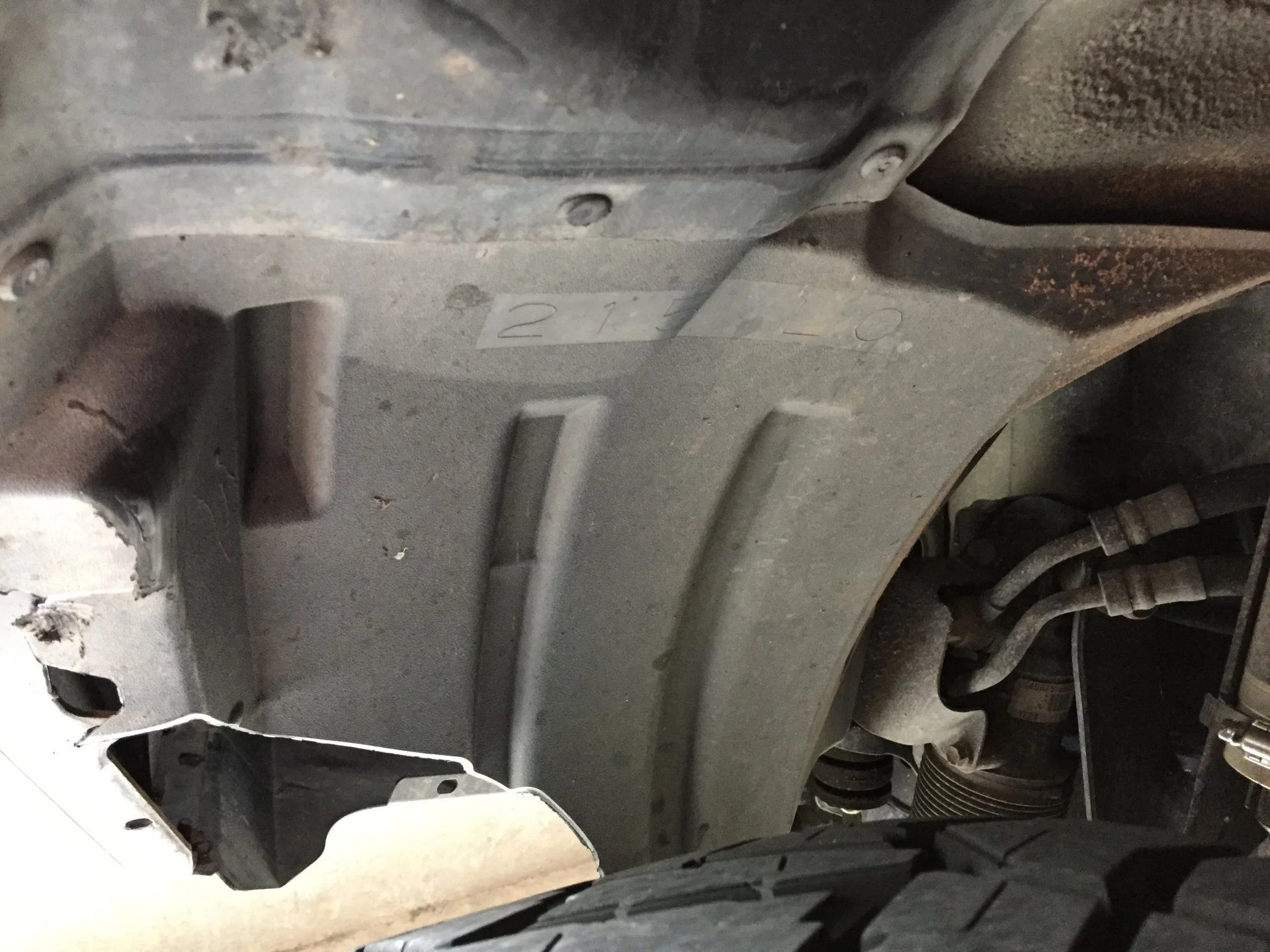

Cleaned up the rest of the rig and decided to cut out a bit more fender liner & pull the lower removable bumper panels on the Dobinson to allow for more room.... was surprised at how badly they've rusted and cheap the hardware was..... that said the actual bumper is still in great shape. I cut it at the seam so it's fairly rigid what's left and will debate putting some 3m rubberizer spray-on in there....

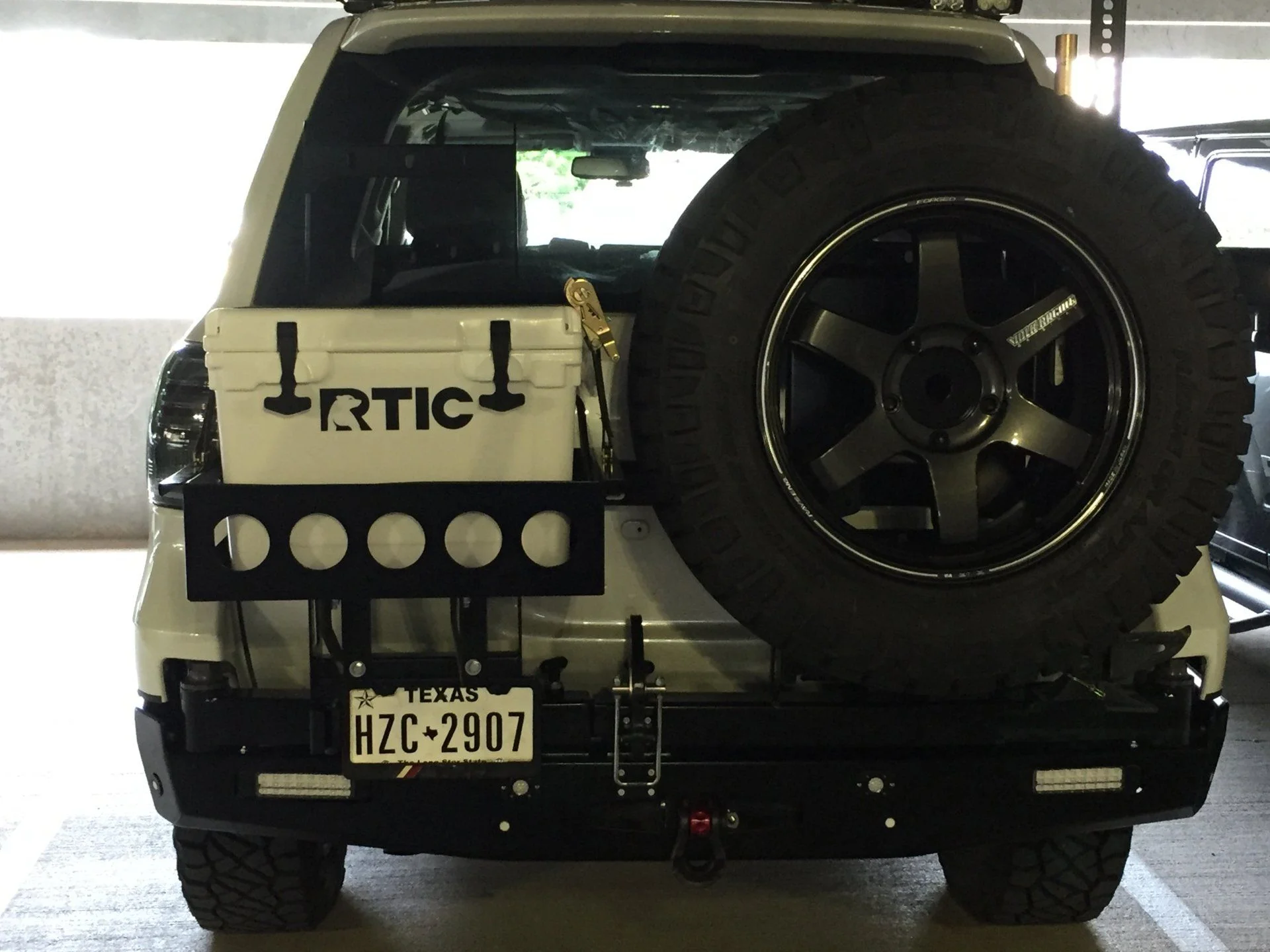

I also used some Taco Marine padded tape to line the inside of the rear basket - both around the top and bottom of the inner lip - and across the bottom - think ultimately I'll do a piece of starboard in there.... the can are nice and snug one that's done ( did a few strips between them as well) and changed them out ot test fit the Mini-cooler for a bit....

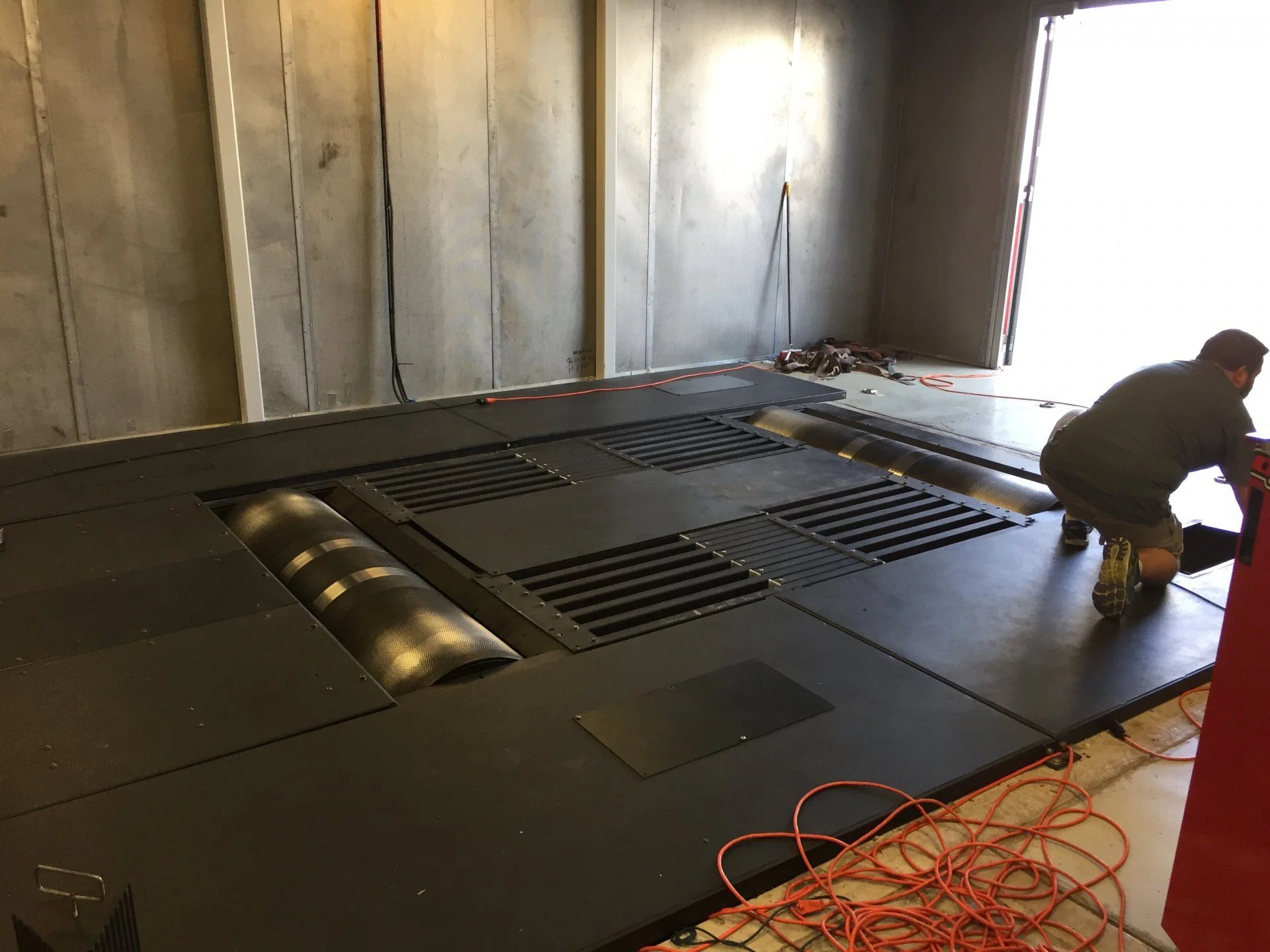

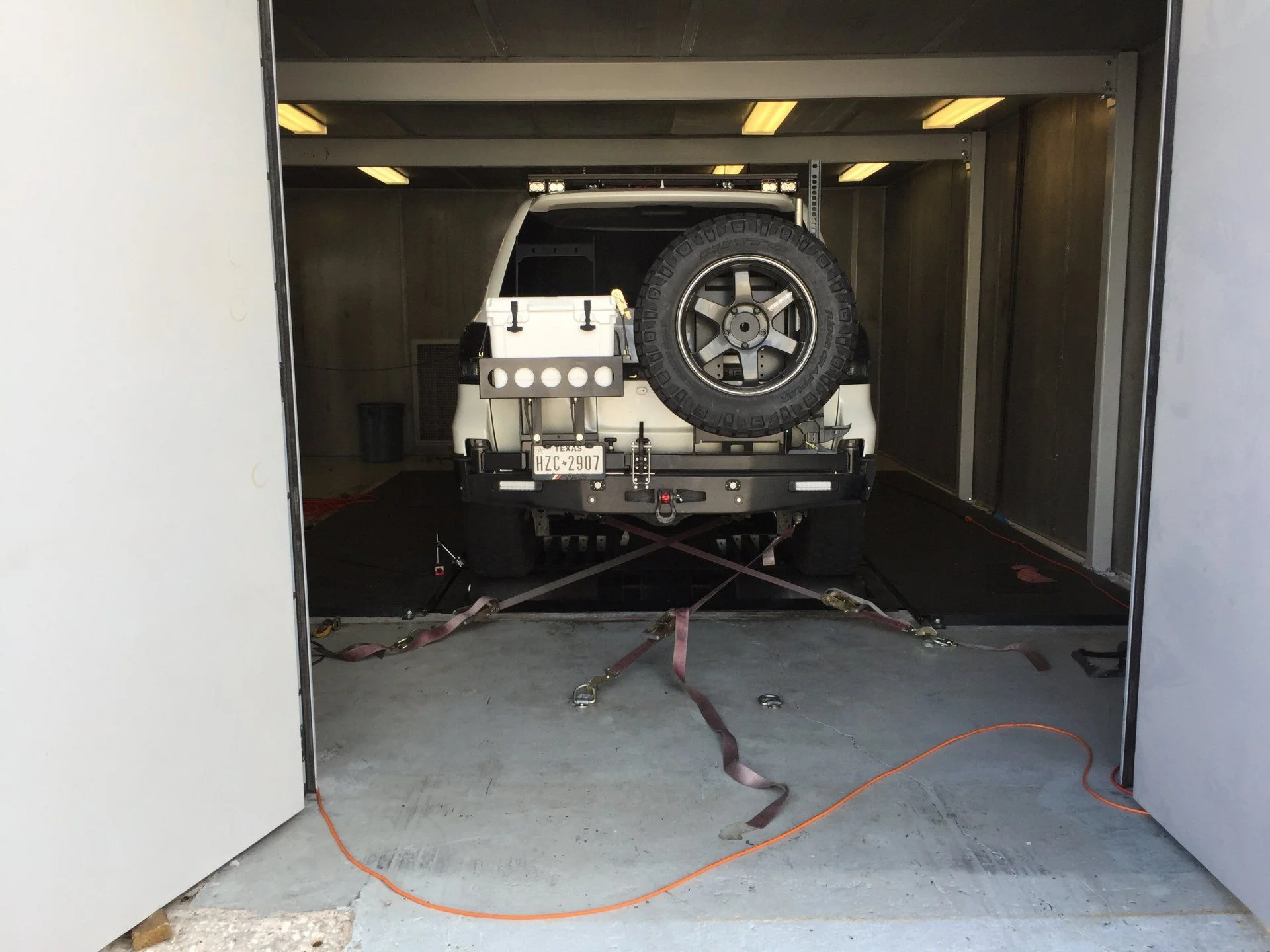

from the front..... after snapping 2 straps it was a bit un-nerving wondering if it'd go thru the wall........ Kudo's again to EC for fitting her in...

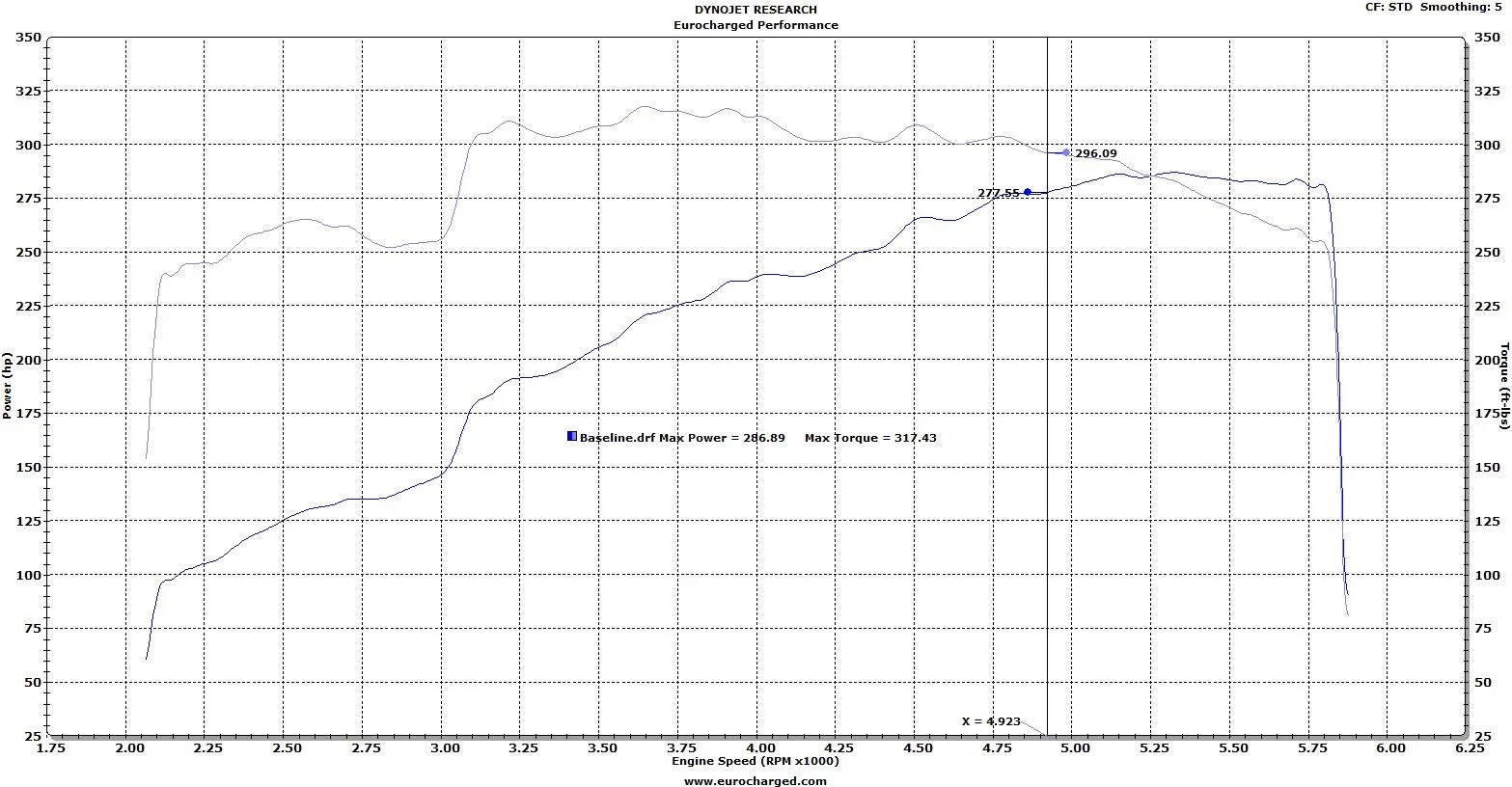

Will have the sheets in the am. but I'd like to use them to jsutify the Sc'er - the numbers are solid given the conditions. When they did my E63 their numbers were 8% lower then when I had it dyno'ed on FL on the same setup.
new sneakers go on tomorrow.... hence the rush to get her finally on the dyno..... 37's and another inch plus of lift wouldn't fit !

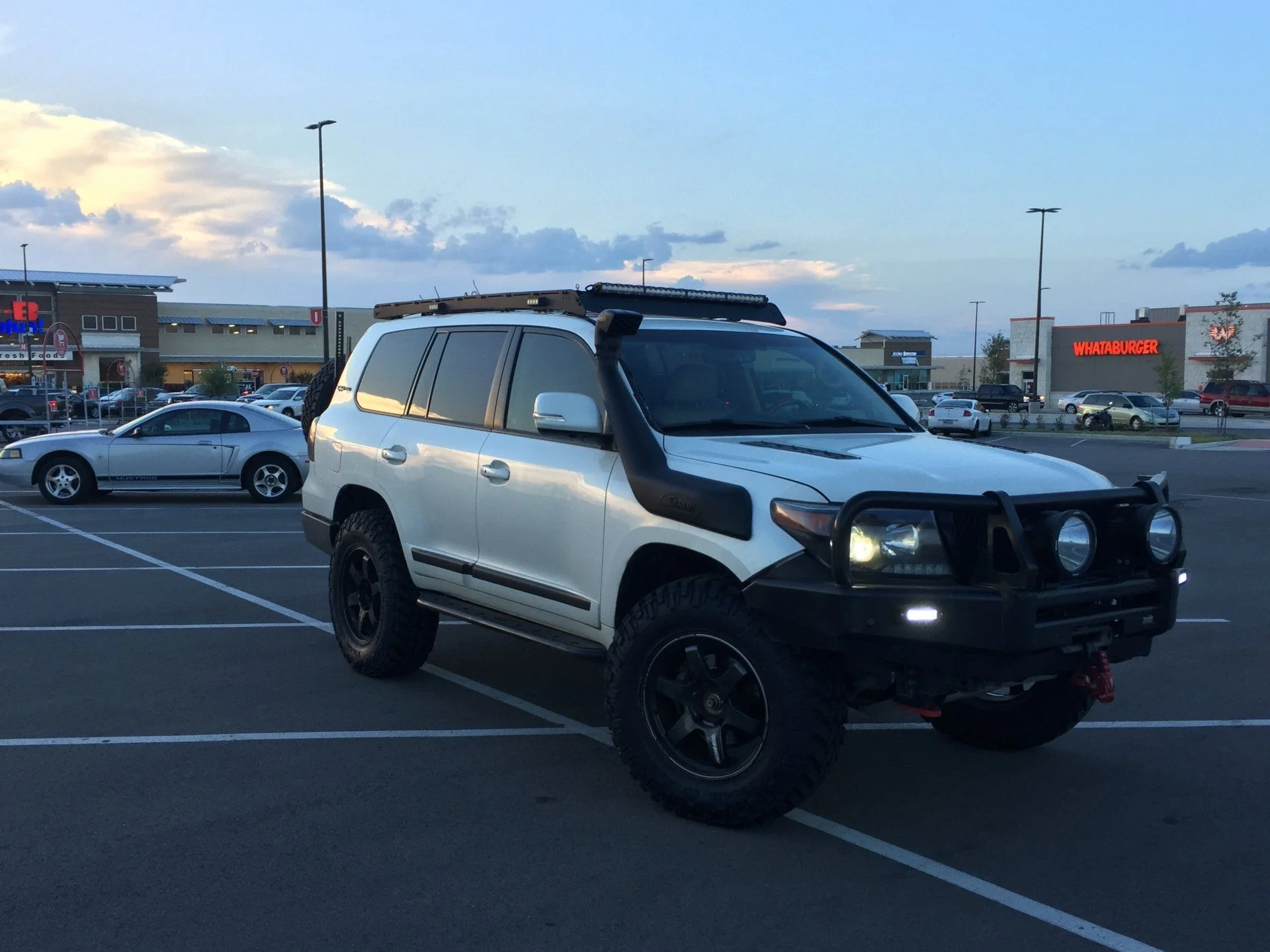

37's are on......... it's snug in the front so ordered up the SPC arms to get the wheel forward a bit- and will dial up the coilovers and trim .......
pics once they get her off the lift. for sure 11.50's are the widest that will fit with the tundra rims and allowing full travel, even so I'm ordering some larger limiters front and rear to be safe.

numbers uncorrected aren't stellar - but hard to know the gains for the headers and exhaust in total without a baseline which Kooks didn't get. Not sure what the driveline loss would be - but I'd assume at least 35-40% ? Thoughts from those with more experience ?

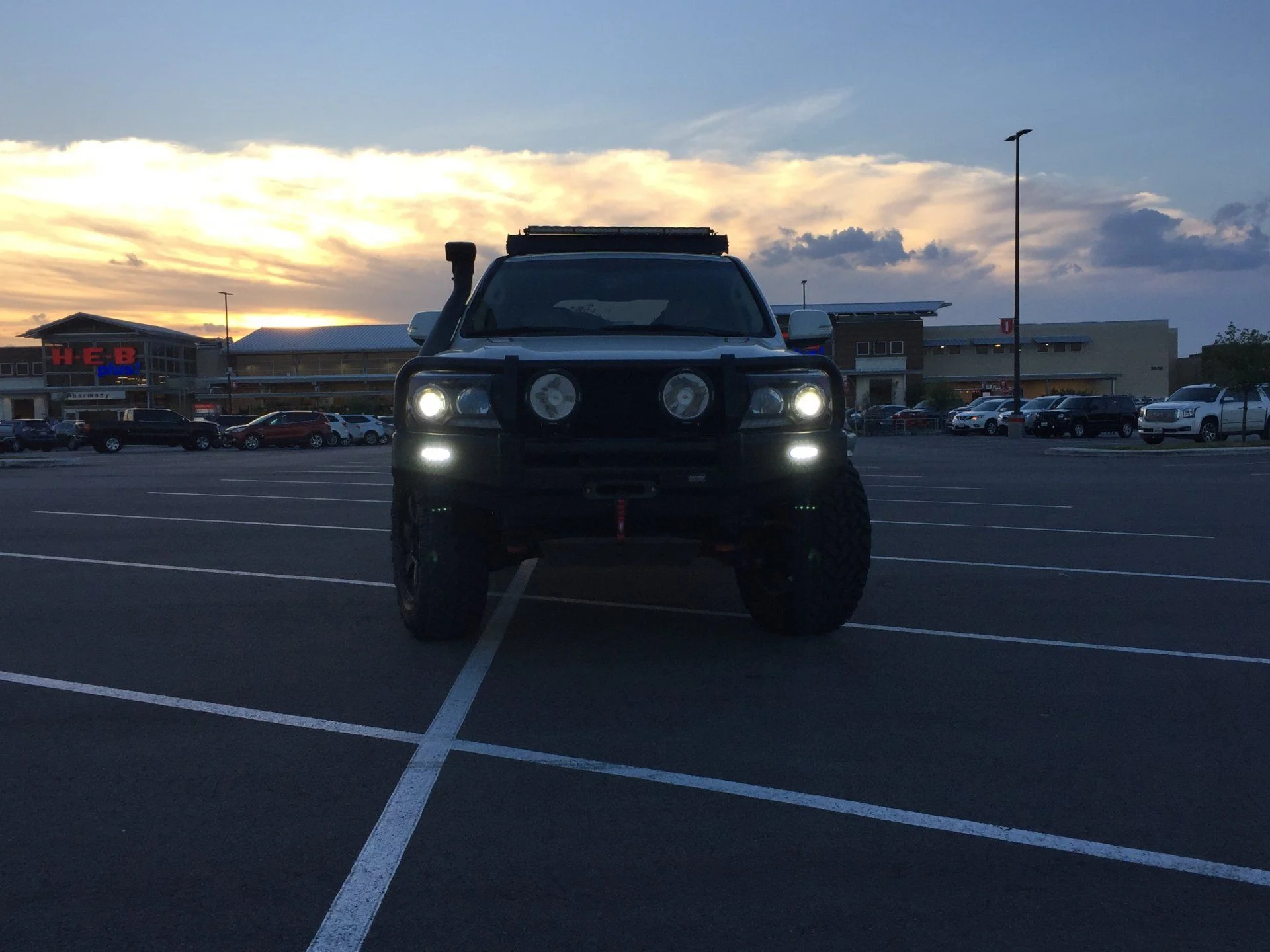

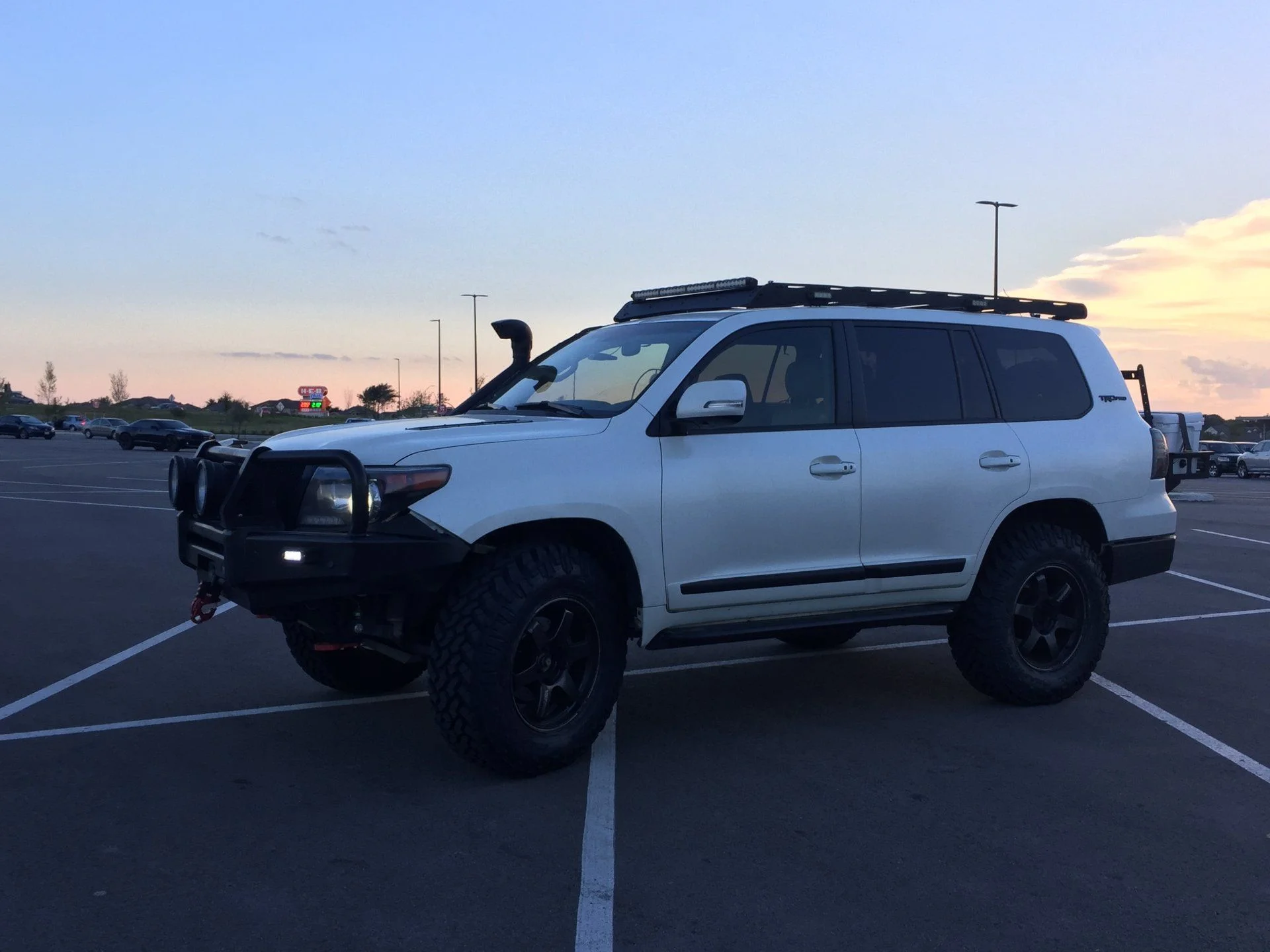

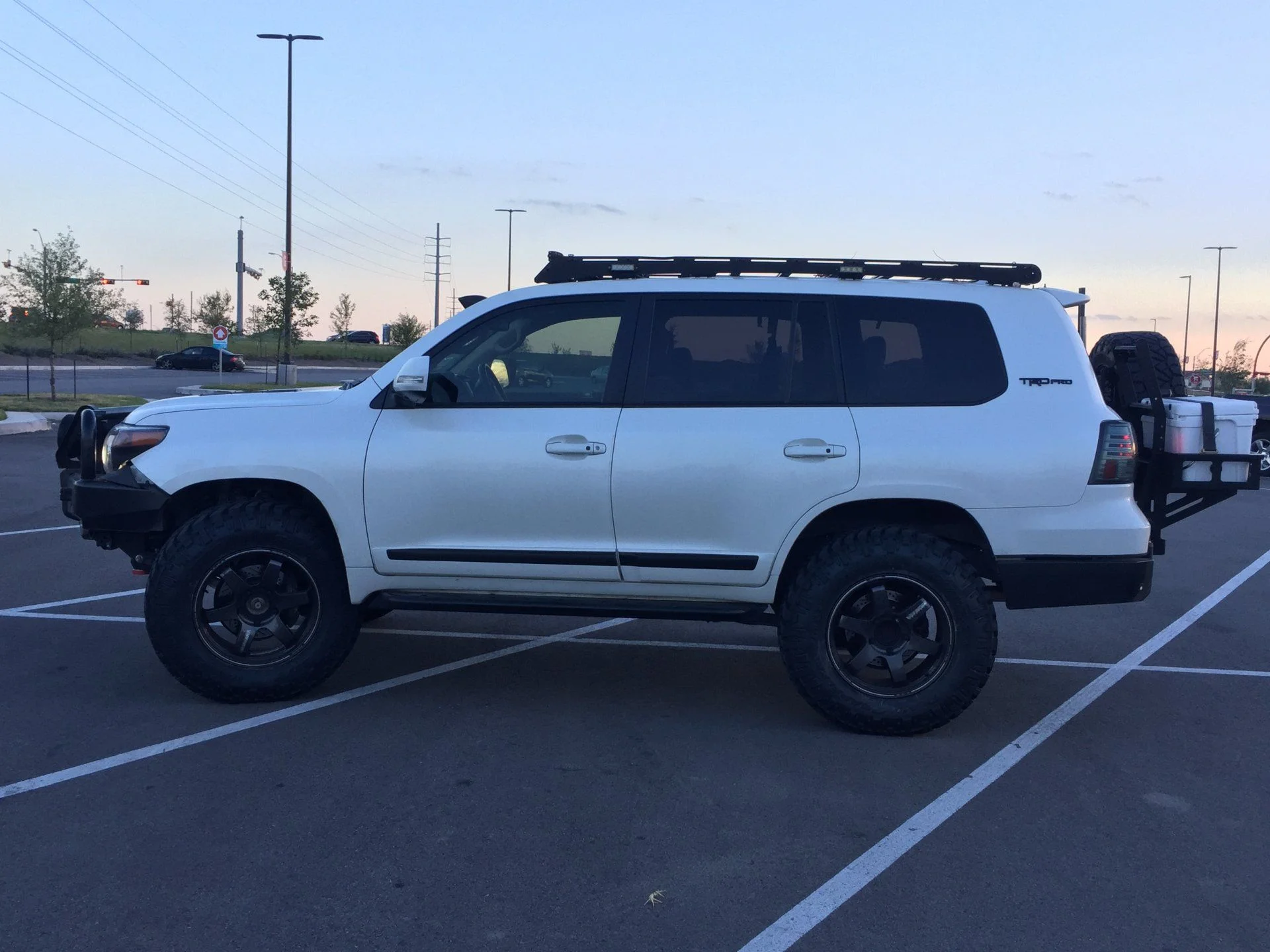

but already have 500 + miles on them today and am very impressed ..... had to cut a bit more flare and liner and can see that the fronts will need to be both moved up via coilovers, and SPC arms ( ordered from Ben @slee today) ... and I'm going to both roll the front fenders and go with 18mm spacers in the front..... need to figure out the longer studs issue - recall that was a problem. I'll use a set of OME 10mm spacers for the rear, have 30mm if that's needed..... also ordered a diff drop to be safe, given that I'll be about 3 1/2 " of lift I suspect.
but net - very happy and it looks "proper" in proportion......the Nitto TG's are much smoother then expected but do get a bit floaty over 90.... think finding the right pressure is going to be key.... I'm trying 42 front 38 in the rear - with the Icons set to 9 in the nose and 6 in the rear.
