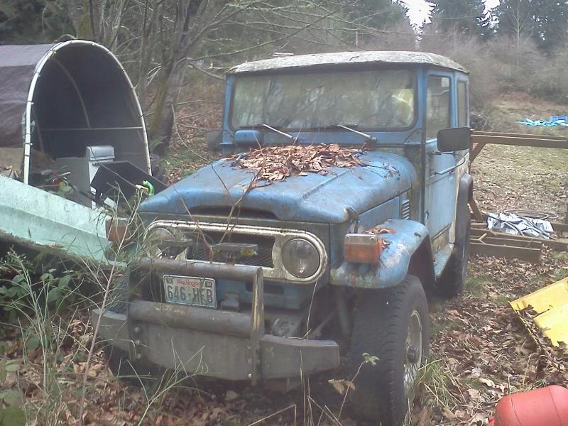

This is a great thread and a good inspiration for me to get to work on my brother's FJ40. He passed away a few years ago and the family decided his 40 would go to my son who just started his Senior year in high school. Sadly my brother never got to drive the 40 and only had it a couple of months before he passed. We have a long way to go to get "ol Blue" back on the road but it will eventually get there. Thanks for posting. :cool:

Looks like a great project vehicle for you and your son. I was lucky that the motor in my brother's truck was sound and had been rebuilt with few miles put on it.
why take the stripes off ? they give the truck a unique character
