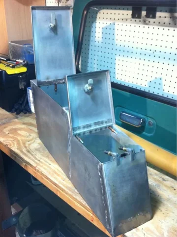

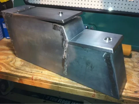

Update on center console build!
Decided on lock type and position.
Lids down you can see the locks on top.

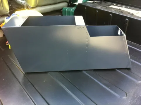

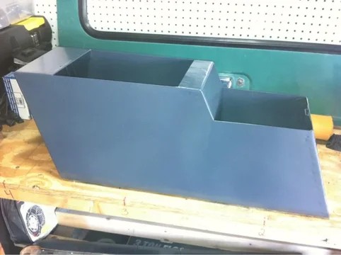

Got it apart this past fri and got it primed with dp40 at work! Will paint it this week!
Came out good!

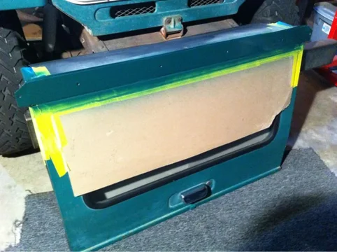

This past weekend I got around to clear some surface rust off the top of the side walls and rear hatch since my roof is hanging in the garage! Cleaned it all up, sprayed some primer and got some green back up there!
Here is the hatch with fresh green!
