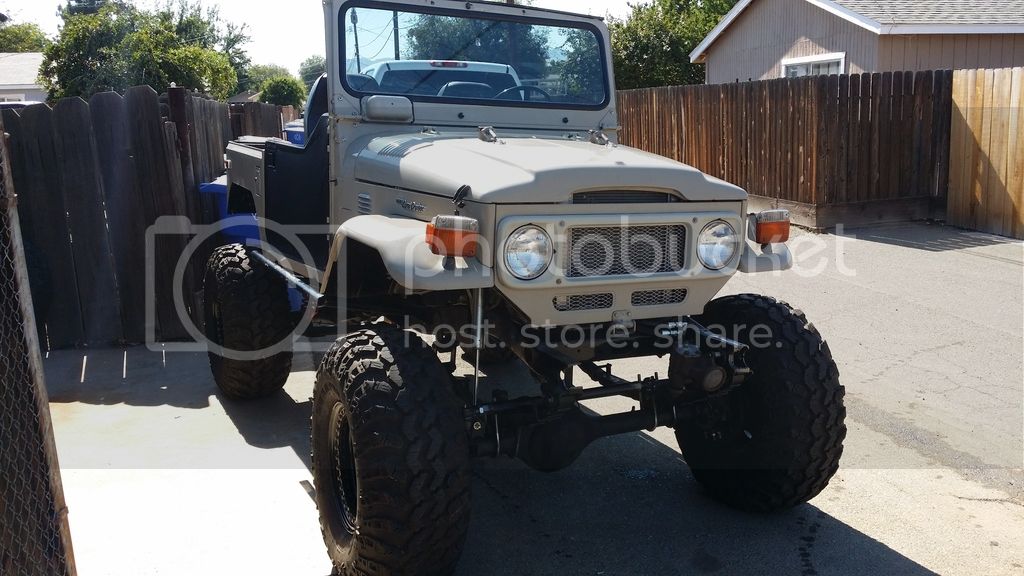

Jeremiah Proffitt just opened up his new shop, give him a call and see if he will sell you the rear 4 link kit he used to make. It was specifically for the fj40. As far as your steering is concerned, I see you have the super beef in the knuckles and tie rods. However this makes the sector shaft the weak link. A broken sector shaft on the trail would be a nightmare I would not want to face. If you did hydro assist then I would think that would relieve the sector shaft from stress if you bounced into a rock hard or something. I kept my relay rod stock, but tie rod is beefed up, so that if something happened the relay rod would bend, in which case it would just affect lock to lock steering but not toe. I could bend it back somewhat straight and hopefully get home without much issue.
Good advice, better to bend it and be able to drive than break it and be stuck. Maybe I'll install one with less strength and save this one as I do intend later to tap this box for hydro assist. Thanks for the heads up.

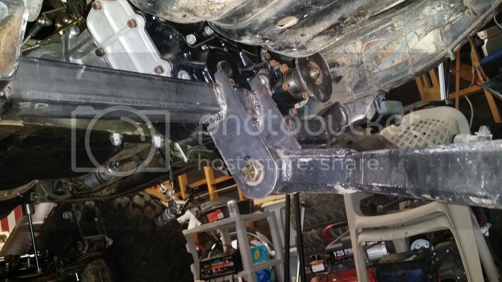

I opted to stick with the wishbone link system it currently had but had to make a new crossmember since the old one would not work after moving the transfer case back a few inches. Not a complete finish but it will get me to the new house this next week. Then in the new garage I plan to add a few gussets for added strength. I do plan to full 4 link it in the future.

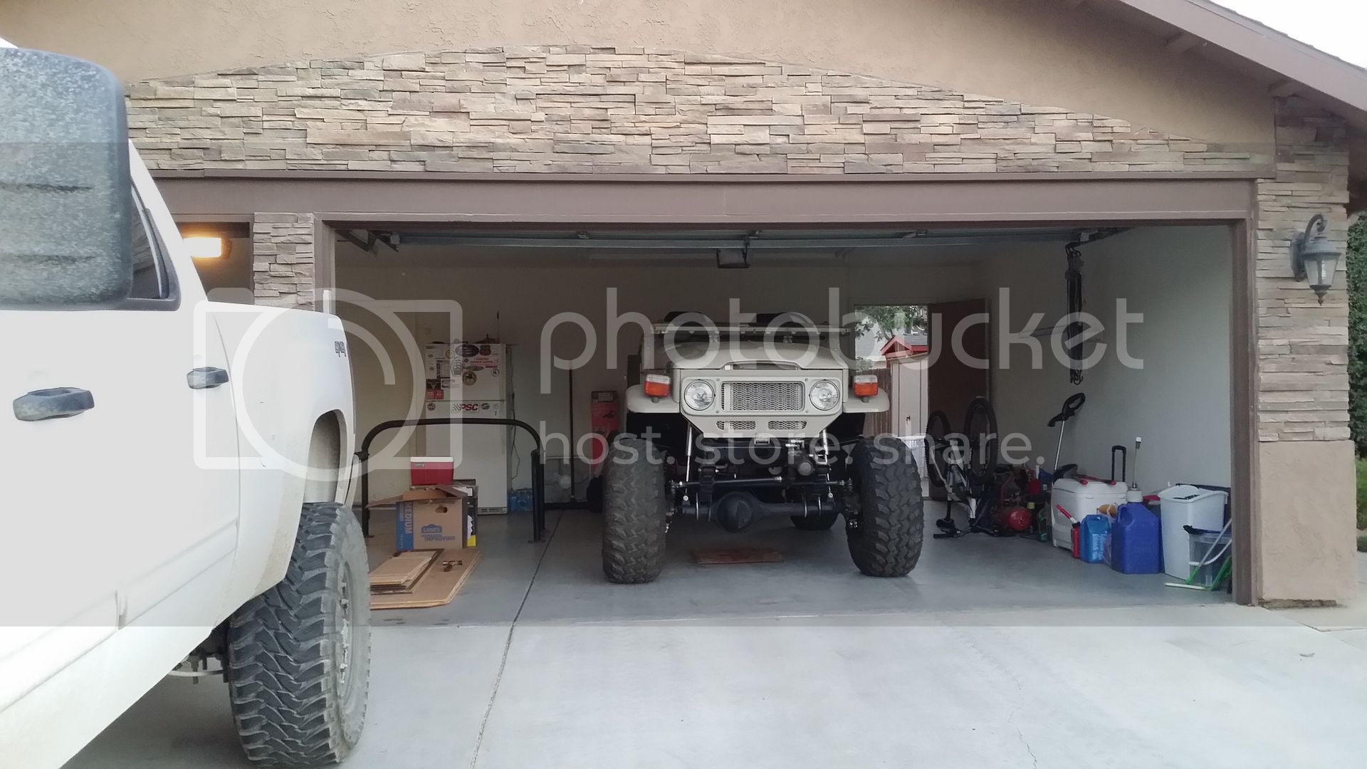

I got it on the road after fixing the transmission cooling lines and drove it to its new home! It was a whopping 2 mile drive and it broke down before I even got to the house. Coasted off the road, fired back up again and backed it in to the garage where i have been troubleshooting it since. Its nice having a garage to be able to work on it when I want.

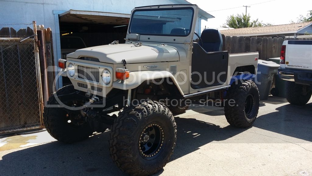

do you have some poser suspension flex pics , i bet it flex like mad
Haha, I do not. The PO is a friend of mine, some of our friends that have wheeled with it (when it was able) say it is pretty flexy. The PO has actually layed it over once, too slow to damage anything more than the hard top. I haven't had it out since I bought it. Just a few more things to go until it is trail ready but I will be sure to get plenty of pictures when I am testing its abilities.

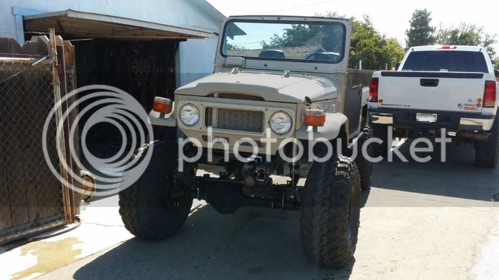

Nice looking rig?

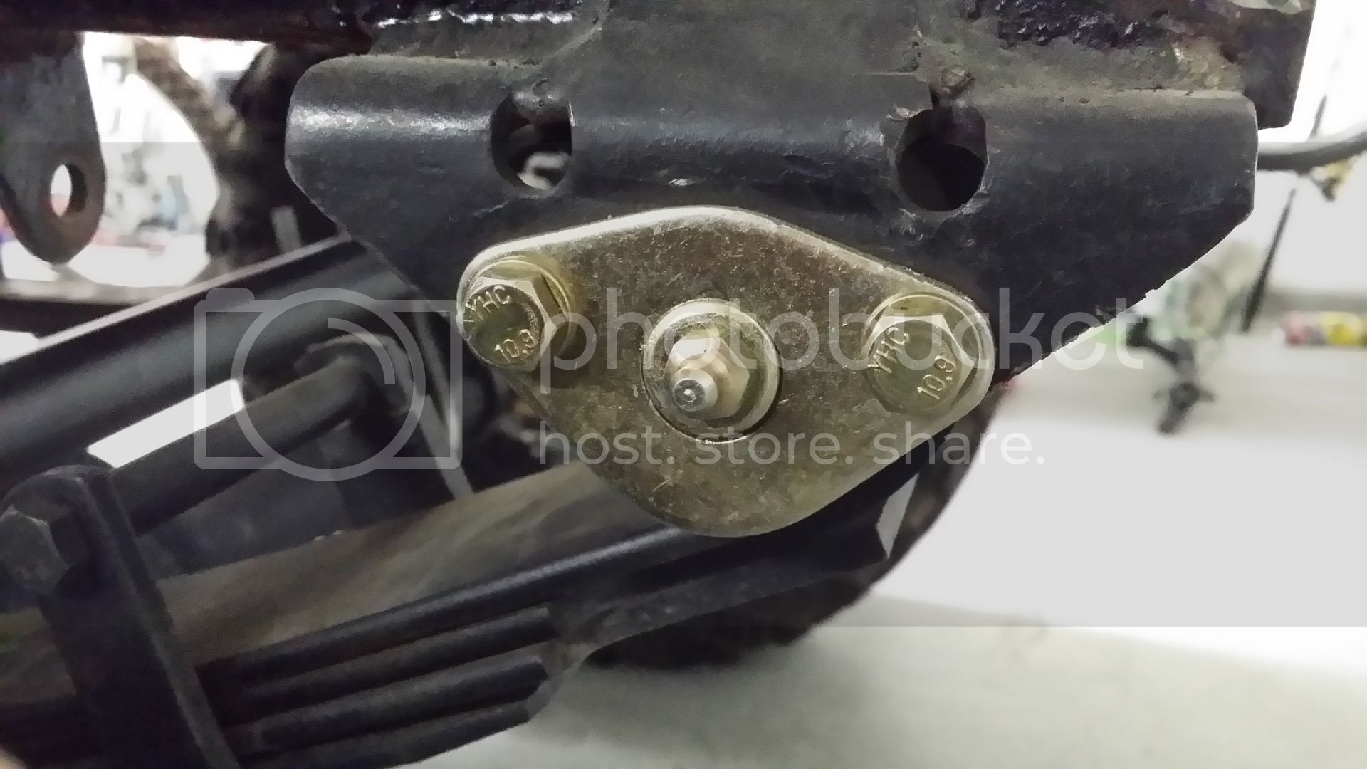

My shackle reversal looks identical to yours. Just curious, Which direction are your front leaf packs? It looks as if your packs were flipped 180 as well, giving you a longer front wheelbase.

That thing is really tall man. Low center of gravity is really important. I would lower it a bunch unless you're just planning mild trails.
Thanks for the insight, It is a very tall rig with very very soft suspension. I have not had it on the trail yet but I will be off on mild trails for the most part. I would like to (some time in the future) widen and lower it but this will be later. It is a difficult judgement call for me to keep building this the way I would have liked to or keep rolling with the way the PO had built it. I hate to change too much because I have also a 1972 stripped chassis that I can start from square one and build it from a start. The only thing keeping me from that is funds and research.

Thank you! I believe they were flipped 180 but I cannot say 100%. I will definitely find out though. I was told at one point in time by the PO but its been a while. I forgot what springs they were.
