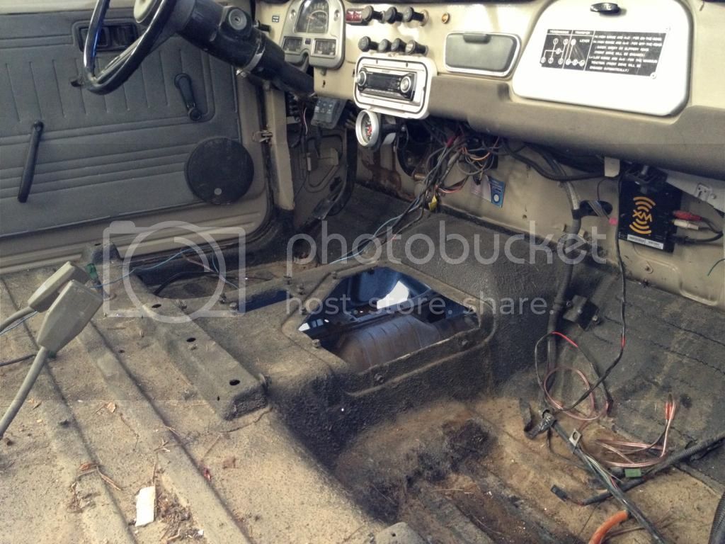

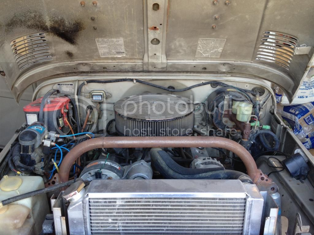

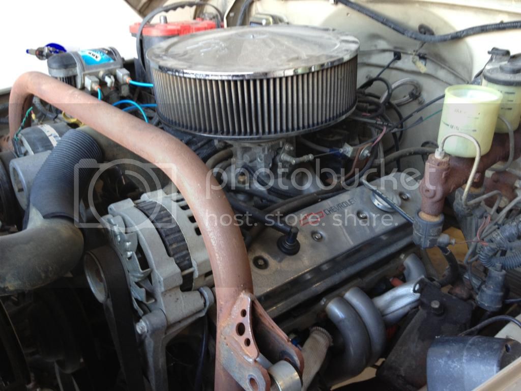

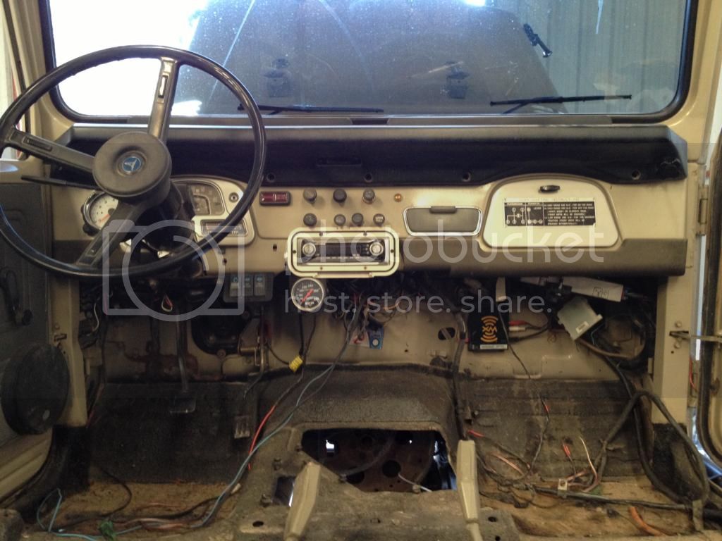

Here are a few details and pictures.
1980 FJ40
SBC 350 TBI (from a 1995 chevy pu)
Th350 automatic (mildly built as stated by PO)
Orion Transfer Case
ARB's & Chromoly Front and Rear
3 linked rear with RaceRunner coils

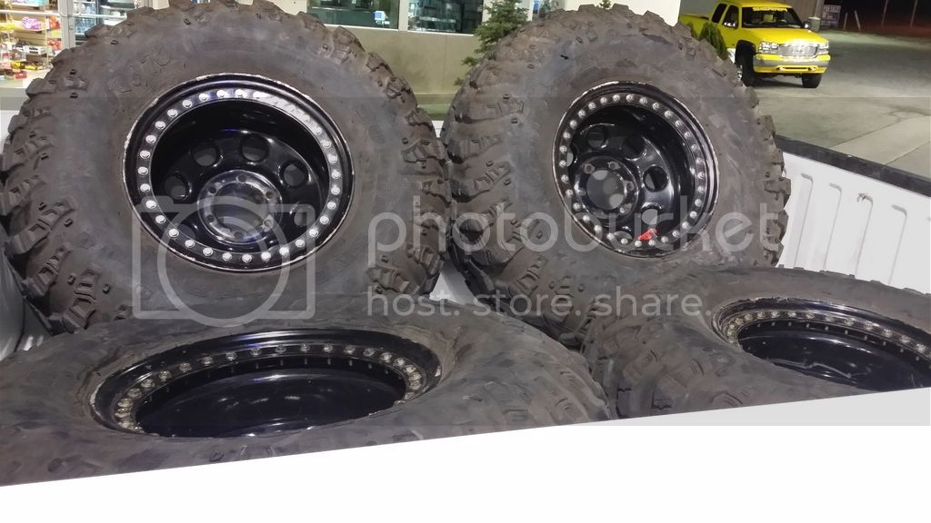

37"x14.00"x16 Iroks on Allied Beadlocks
Its a work in progress that Ive got a very slow start on but Im now trying to get going and get it done.
Ive found this forum and members to be very helpful with spec details and advice.
Just as i bought it.

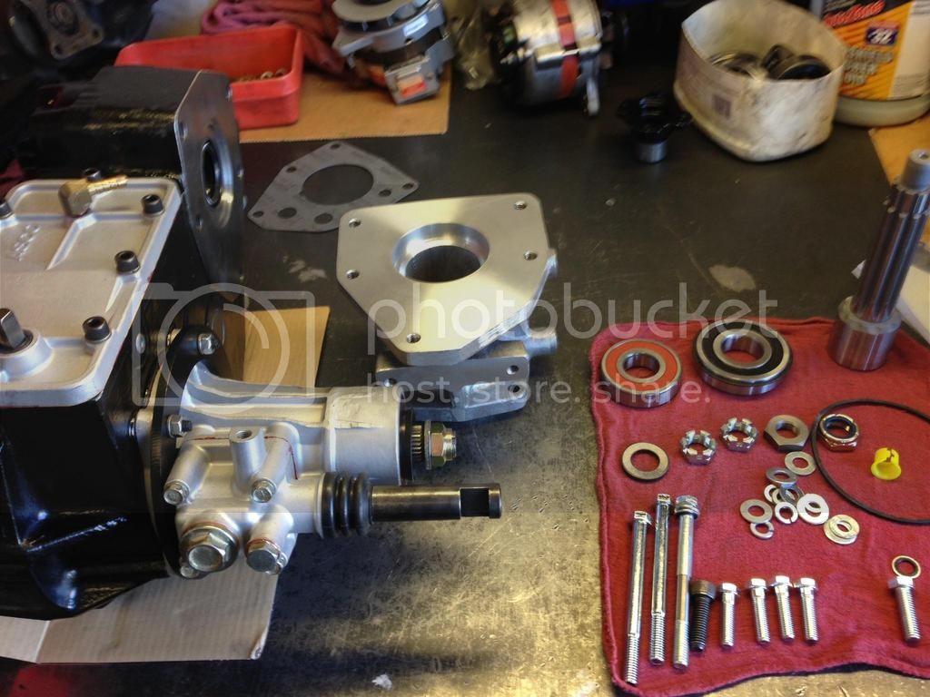

I will be researching crossmembers for both the transfer case & TH350 as I dont have either. Ive seen a transfer case crossmember from Advanced adapters that I really Liked but Ive also thought of Pros & Cons of a skid Plate rather than the crossmember.

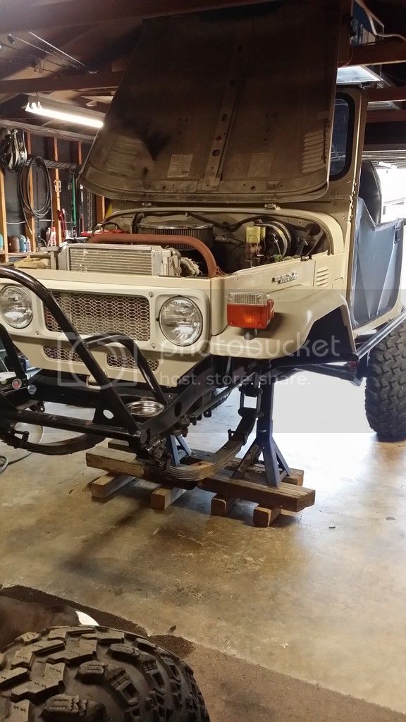

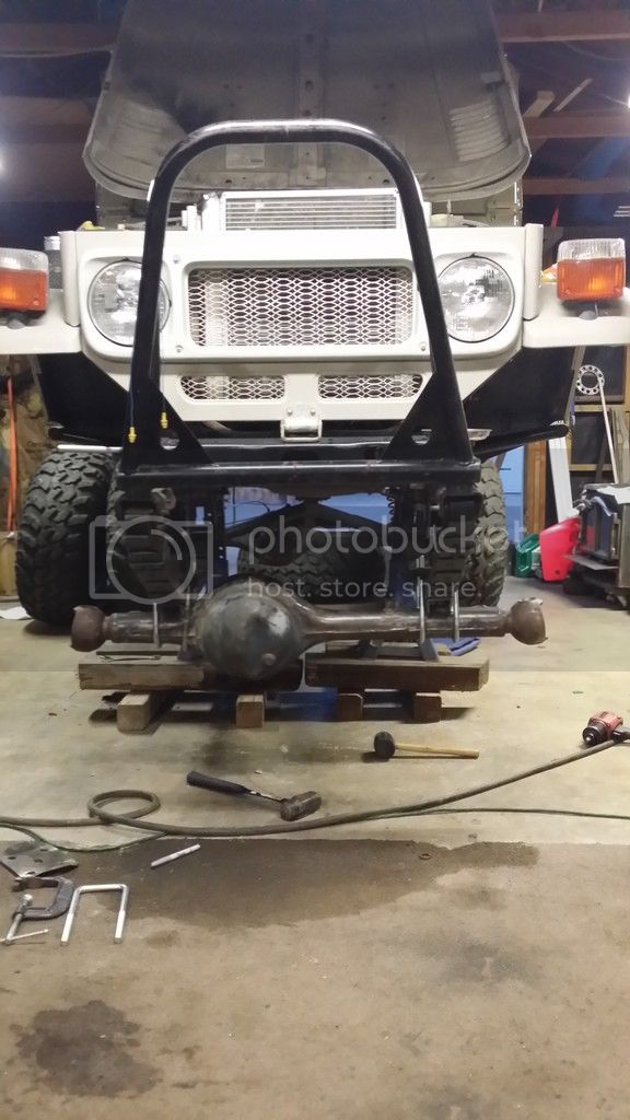

A friend of mine stripped, cut & rolled the knuckles on the extra front end (Im still not sure if it is the 1971 or 1980 front).
Got it rolled into the garage a couple weekends ago to finally get started making progress.
Out with the old
In with the new

On another note, I had previously found that I've run into a problem that the tie rod will contact the leaf spring before setting into the arm on the knuckle.

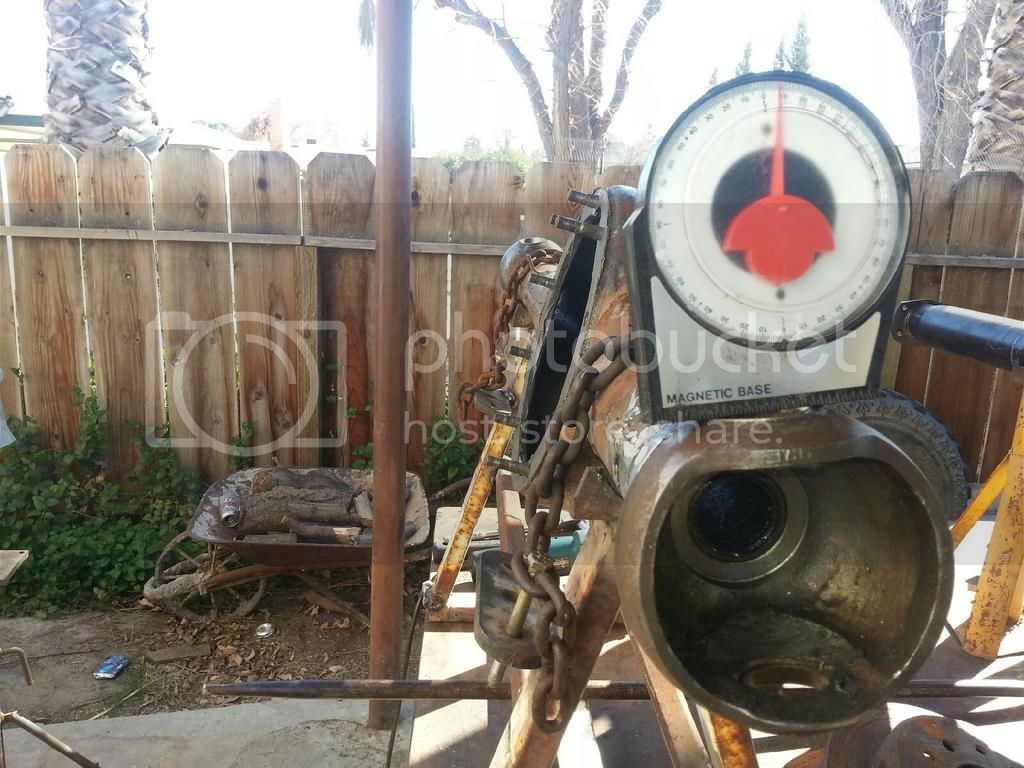

During all this fun we thought the best way to solve the steering & Tie rod issue would be to just pull the front end back out, grind off the perch's and roll the axle. We didn't have to roll it very much, then welded them back on.
