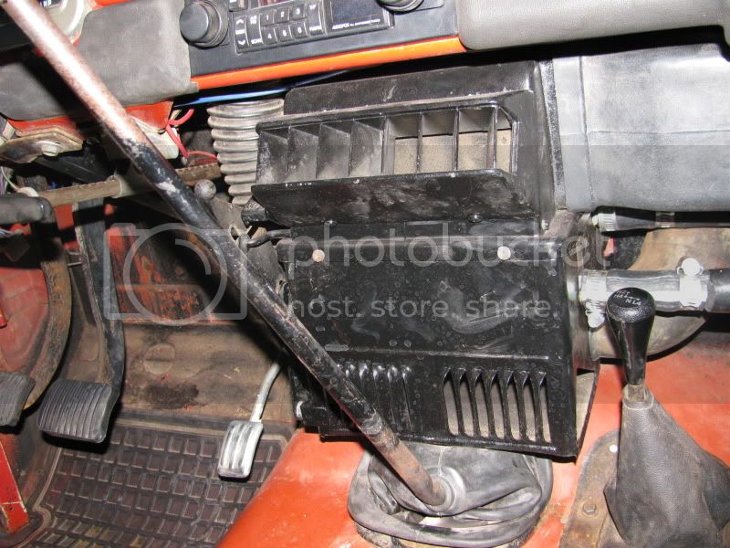

Installed a heater I refurbed (cleaned and painted). I get much, much better heat now! Looks a bit dirty from my hands... need to wipe it down again!

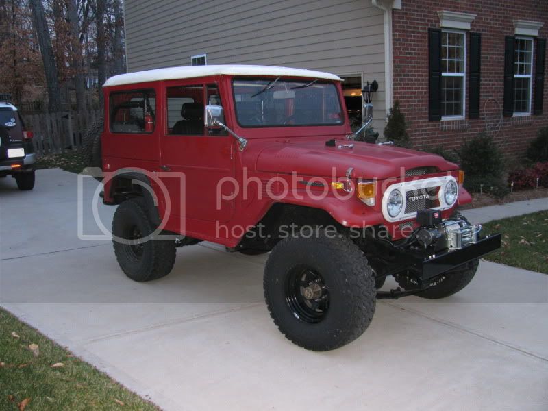

Finally got my Warn M8000 winch installed. For now, I have it off my main battery. I have an isolator kit to run a dual battery system, but I'm going to hold off on that until I replace the passenger side fender.
As it sits now:

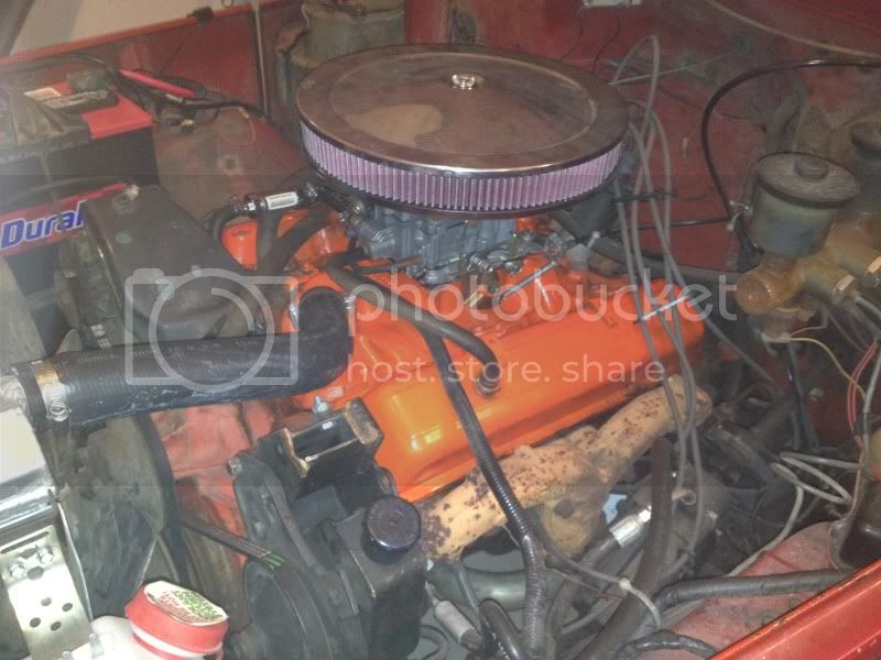

I had the carb off to fix a leaky fuel insert, so I gave the top of the SBC400 a little paint. Nothing great, but looks a little better:

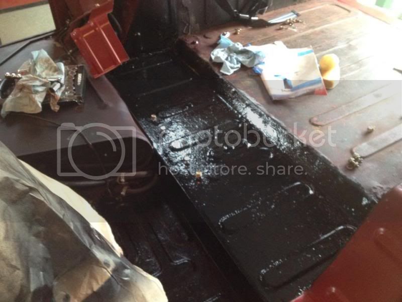

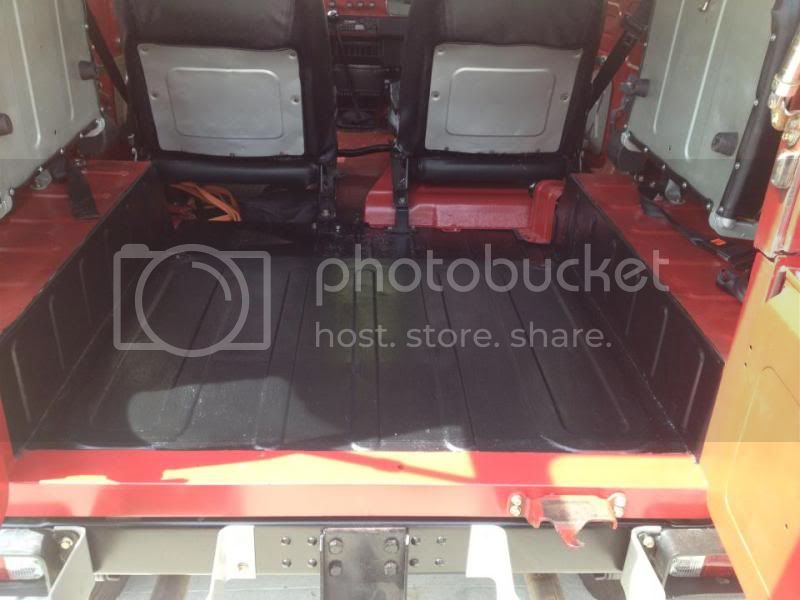

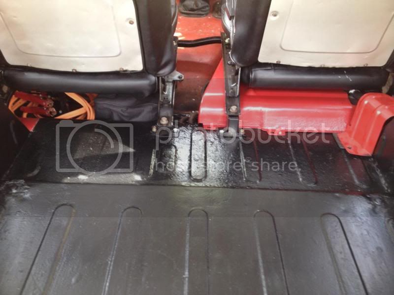

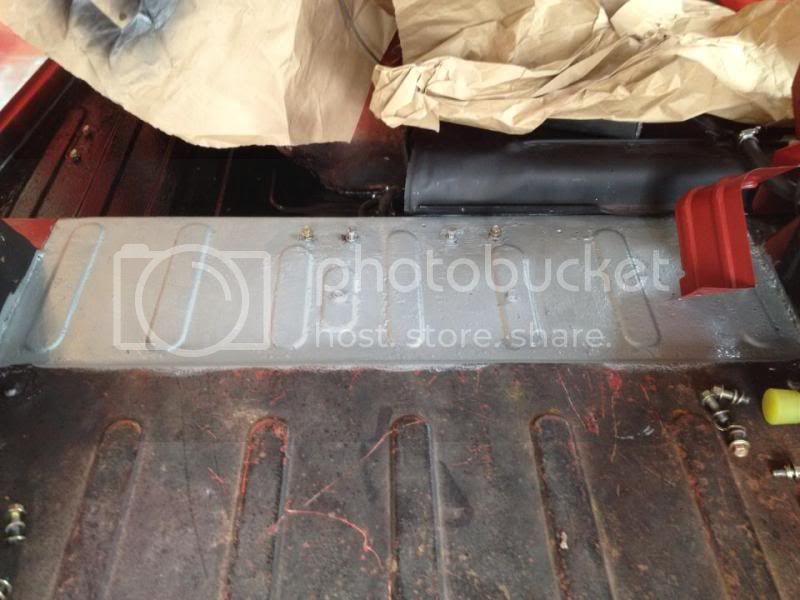

I also cleaned up the floor, put down a layer of rust bullet and then painted it with Rust Bullet chassis black. Turned out ok I think. Some before and after:

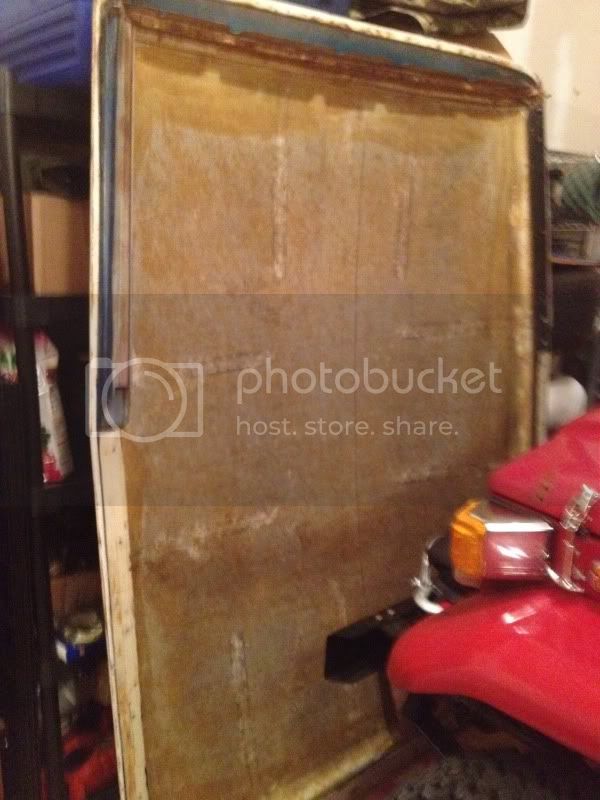

My hard top is beat up and is sort of a Frankenstein of sorts, so I bought one off a Mud member and I'm slowly refurbishing it. Some pics of it:

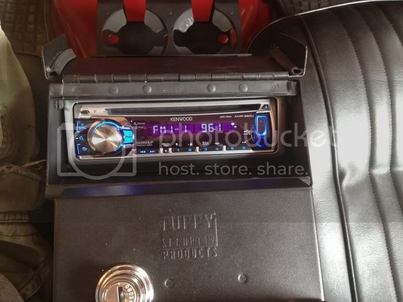

Finally got some tunes in the 40! Kenwood Marine stereo (cd/ipod) plus Pioneer speakers. Mounted the stereo in the tuffy console. Mounted the speakers with velcro behind the seats for easy removal. Installed RCA jacks in the back of the console so I can unplug the speakers quickly and easily. Turned out well! Also took out the old cheap tape deck from the dash (uncut dash) and will get a delete plate for it. Not a bad set up overall!

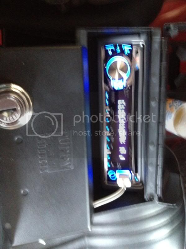

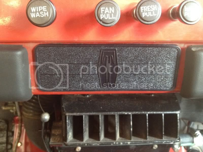

Radio delete plate in! Plus, a better pic of the radio.

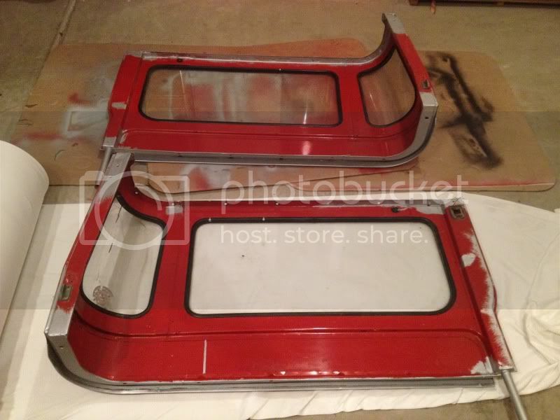

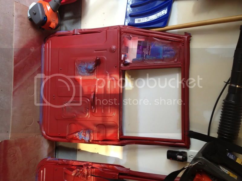

Working on painting the doors while they are off for summer:
