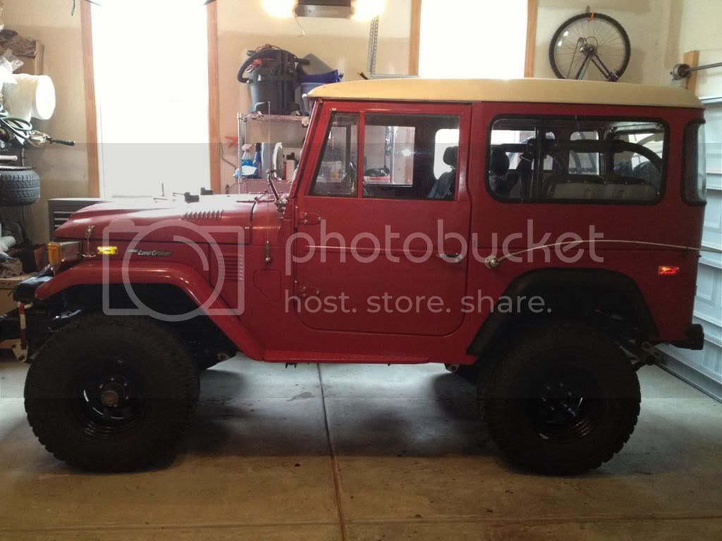

Update: knuckle rebuild done. Aussie locker in the rear. New shackles, bushings and spring pins, although shackles will be replaced by straight greasable shackles since the tri-shackles don't work right with aftermarket lift springs (put on backwards for now). New fan shroud installed, new rag joint. New apron emblems and underseat jack holder installed as well.

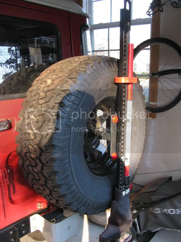

I replaced my good barn doors with some great barn doors. The good ones had no rust, but have extra holes drilled in them. Bought doors from a mud member that are as clean as I have seen: no rust or extra holes. Cleaned them up, put some freeborn red on them and installed. I'm happy with them!
Sorry for crappy cellphone pics.
