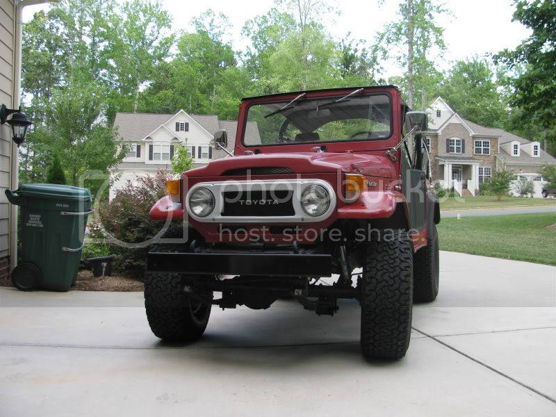

Couple more updates:

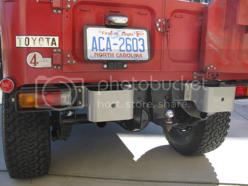

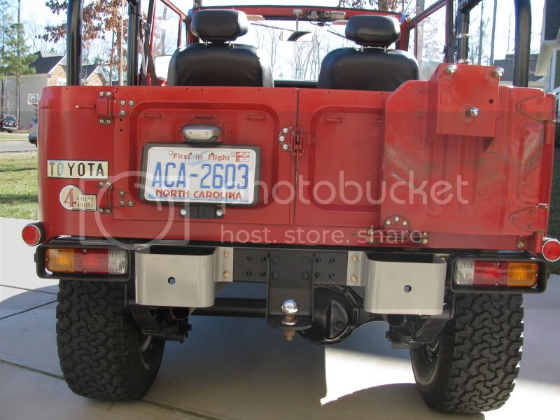

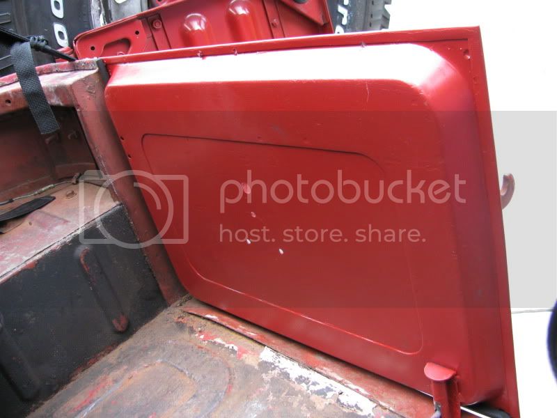

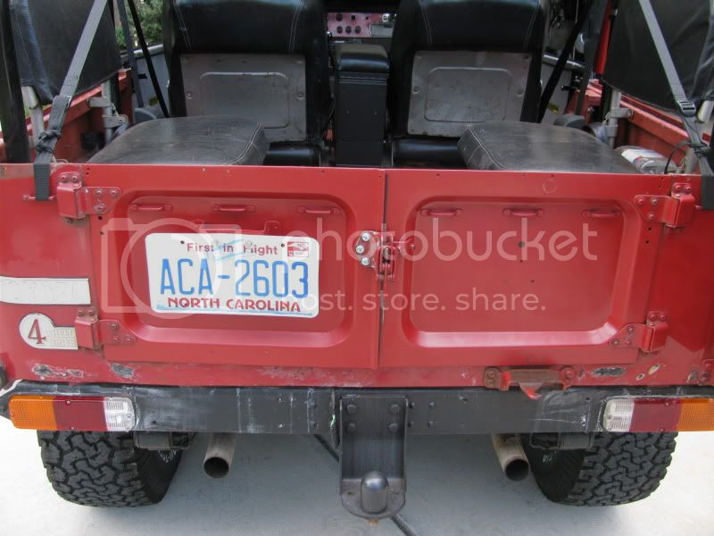

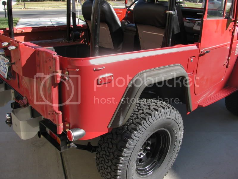

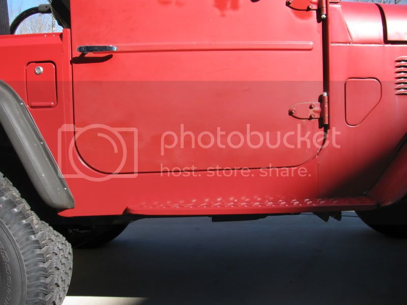

Replaced old barn doors with some rust, with some clean ones. Primed and painted with Freeborn red. Not bad, but certainly not pro quality!

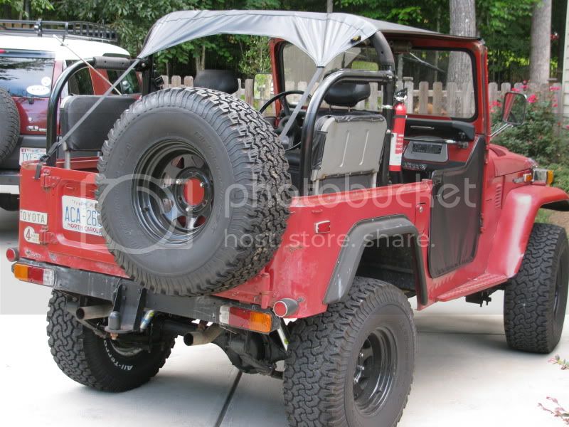

Had some slight overheating issues. Remedied with new 3 Row aluminum radiator. The big 7 blade fan and this radiator were the magic combo!
The carburetor never quite worked right, so I replaced it with a remanufactured Quadrajet from Jegs. Runs much, much better now.
Needed to get the hardtop off the garage floor. Accomplished with the $125 Rancor storage lift from Amazon. Works great.
As it sits now:

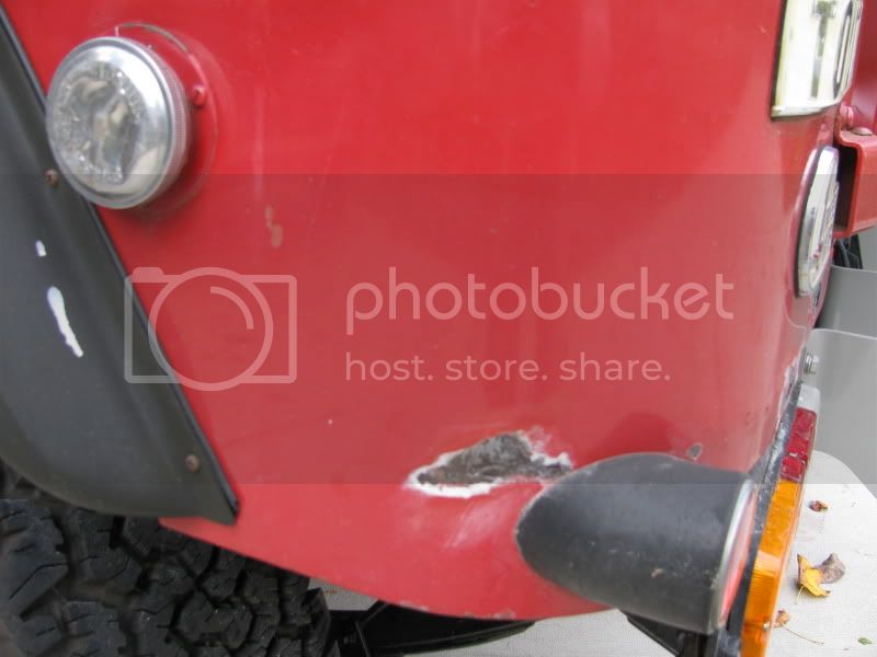

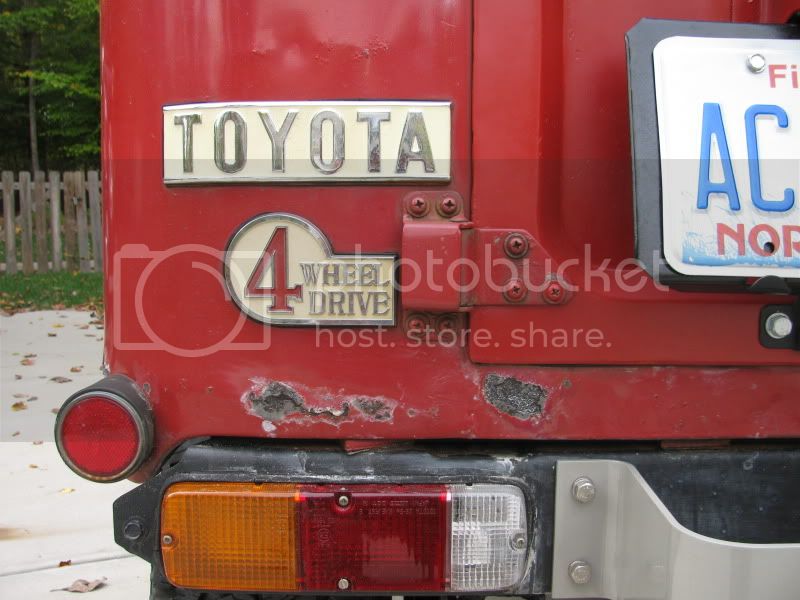

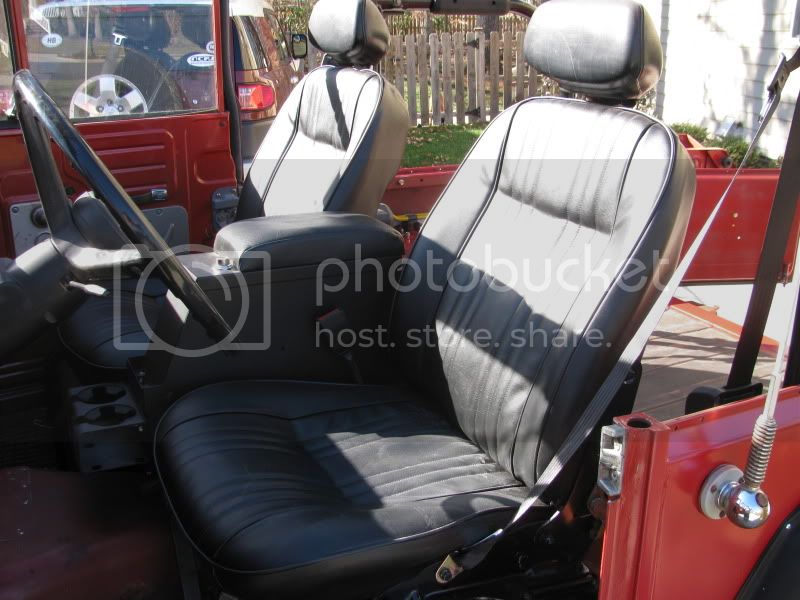

Latest update: new roundeyes! Very much improved night vision now. I've also updated all the inside bulbs to LED's (cluster, dash lights, etc), as well as, the reverse and brake lights and the side marker lights. I noticed the inner part of my tail lights are badly rusted, so I have new OEM ones on the way. Next week it's off to the body shop for the rust panel replacement.

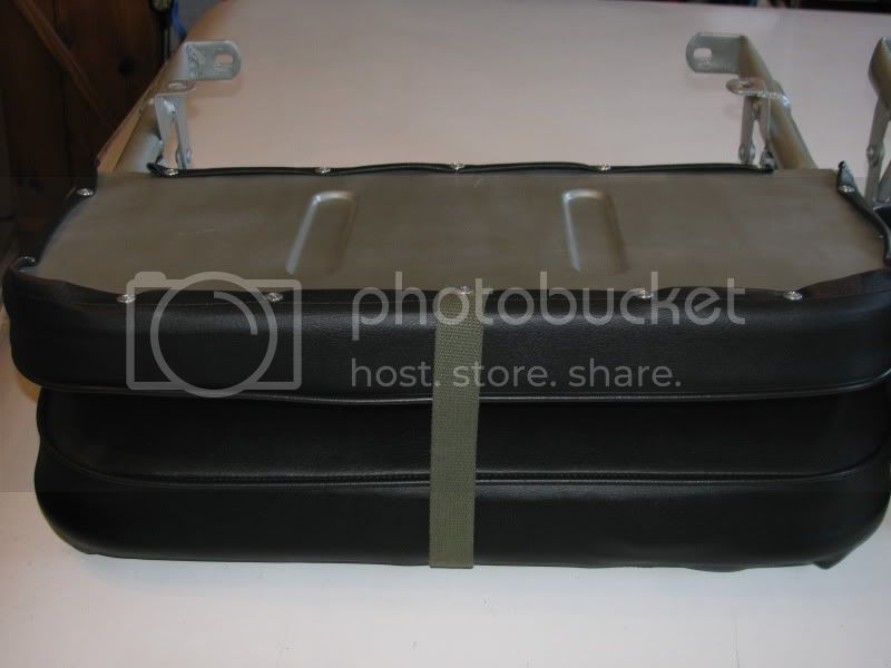

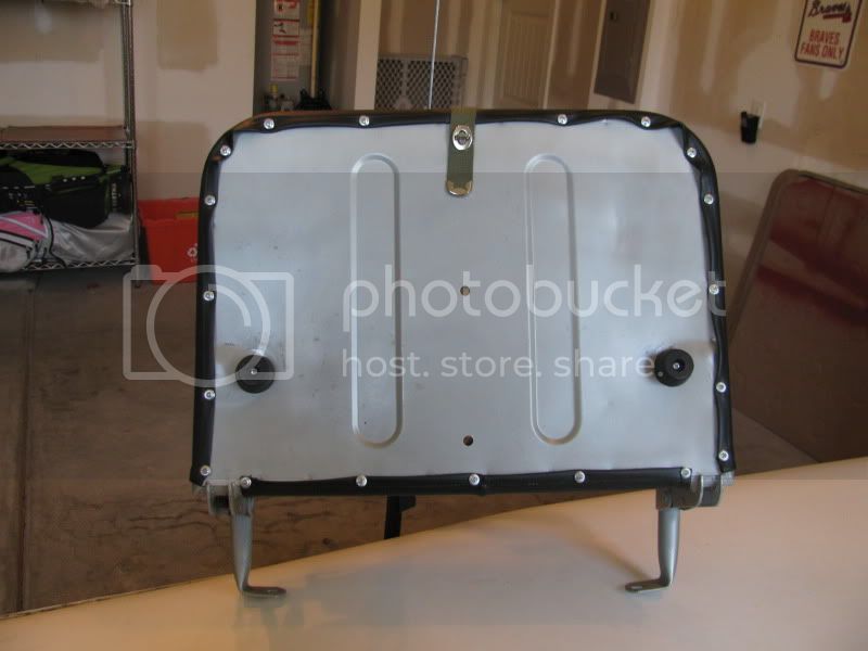

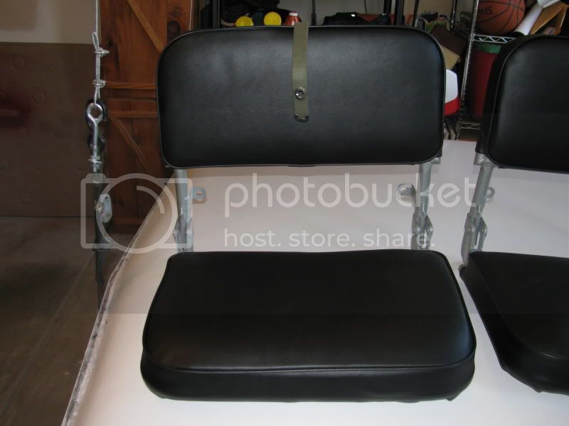

"Restored" jump seats. Stripped off the old covers, wire brushed some rust, primed, painted (Pewter from Cruiser Corps) and then re-covered them with the black seat covers from Cruiser Corps. These covers are very nice and easy to install. Also installed seat straps and fasteners, as well as, new bumpers on the bottom. Seats look 100% better now.

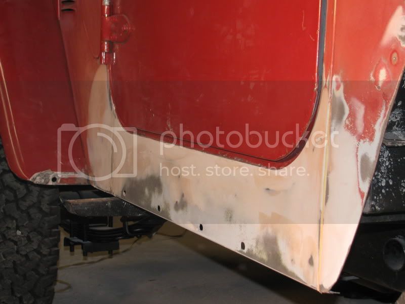

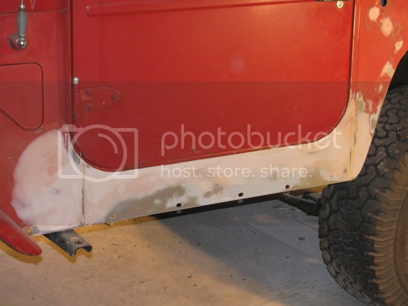

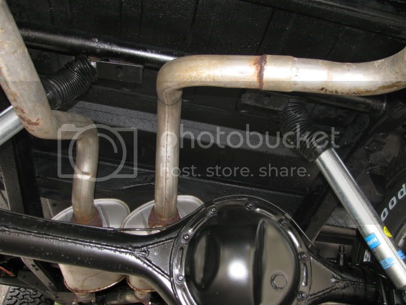

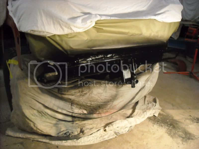

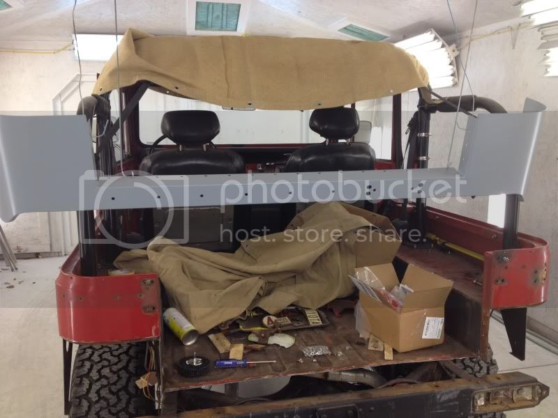

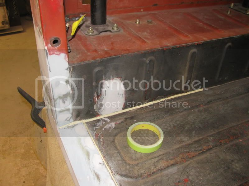

Updates on the metal work: panels have been cleaned, etch primered and epoxy primered. One rocker has been cut out. Going to replace some of the metal underneath and behind the rockers. Couple of places patched in the bed. Going to paint the bumper while everything is off. Slowly getting there!
Almost there! I should be getting the truck back next week. Much, much better shape now.

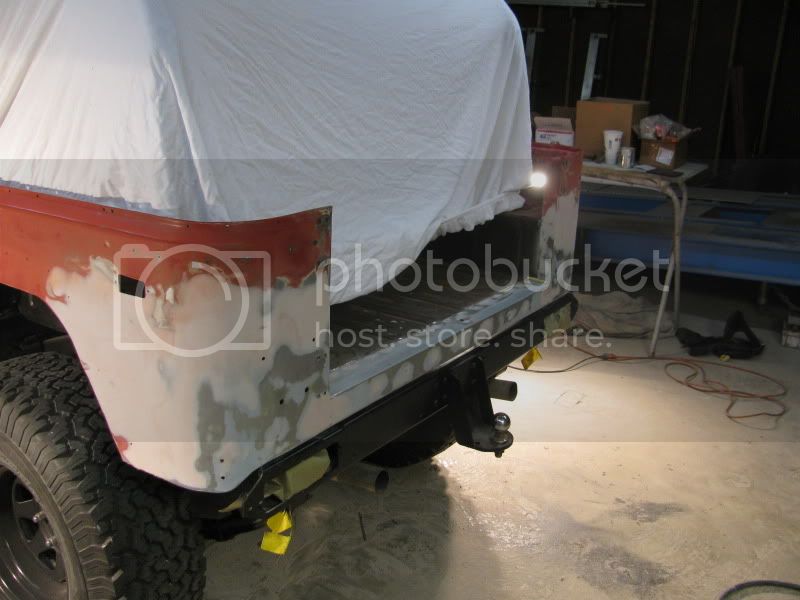

All panels have been etch and epoxy primed. Everything welded in and a skim coat of bondo applied. Being primed and painted this weekend. Little holes here and there patched plus some rusty areas in the bed area.
EXCELLENT repair work! Thanks for posting pictures!
Thanks! It has been a fun project thus far. Some frustration mixed in (broken bolts are time consuming!), but mostly fun. I will probably go through the rest of the truck bit by bit and paint, put down some rust prevention, that type of stuff. I'm not 100% restoring it, but want to treat/replace rust and make it last.
