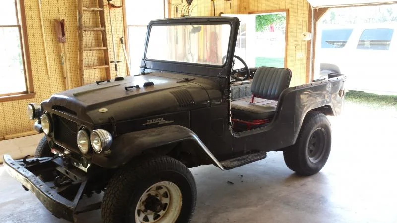

Well, I bought my first FJ40 project. I've been planning to do this for years now. Luckily, a guy in my area (about 2 miles from me!! ) is an expert, so I will hopefully get some great direction this next year or so. The truck ran when it was last parked, but I've got gas tank and electrical repairs to make. Once it's safe, I will drive it until Winter, then begin tearing it down for a 100% full restoration. I'll post pics and hope to get community advice/suggestions as I go - I've got a long road ahead of me - much of the truck is stock, and there's not a ton of body work, but like everyone else I've read - there's a lot to be done to get back to original.
Please post your VIN NUMBER. Thanks. Looks like a fun summer time cruiser. Good your getting it safe to drive. You might think about just keeping this one for good fun, banging around town and restoring a newer year FJ40 sometime in the future. Original Parts for a 1962 are extremely hard to find and then buy and unless your hiding them somewhere out of the sight of the photo it appears you have a bunch to round up. You could do a modified build of course but going bone stock on an fj40 is a pretty cool way to go. Welcome to the party and go to the Fj25 section. Those guru's really helped me out a lot.

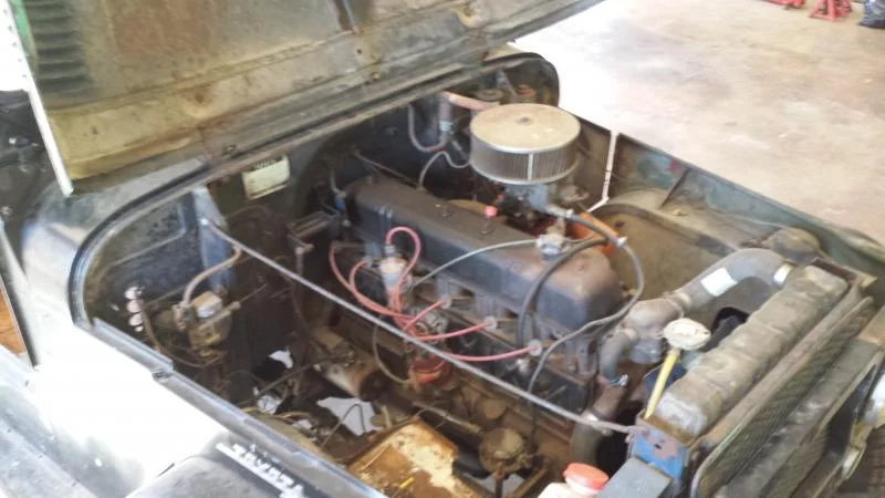

Sweet! Love the old soft top door 40 series. Looks like a great resto candidate. Not the original F engine, but amazing she still has the 6!
Nice KC lights.... :-)

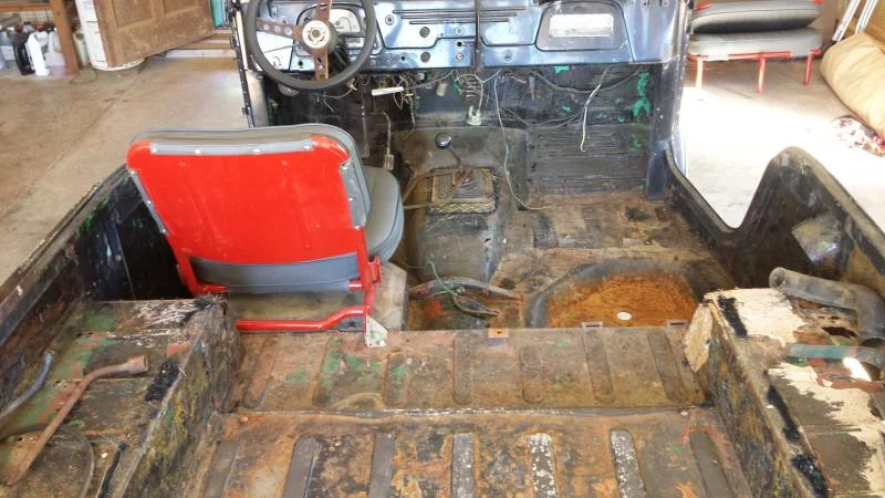

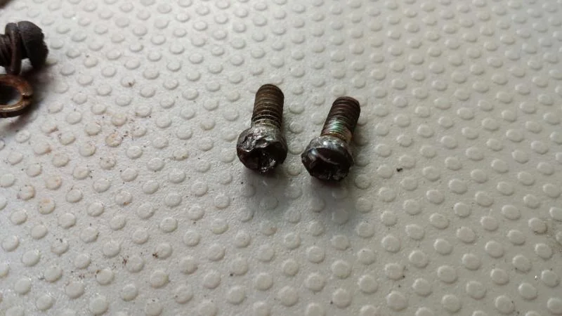

Took the gas tank out to clean and re-line it. I figured removal was a 10 minute job :doh: 2 hours later, I was able to remove the last two rusted-in bolts that secure the sending unit. Not sure this qualifies as record time, but I'm learning. Pretty cool that the sending unit is in perfect shape and the interior of the tank was not too bad. Have decided to use the Volcanic Beige paint code, and fit it with the brown SoftTop (some day). For now, it's a small win not having to re-tap holes for broken-off sending unit bolts. Was going to post a pic, but I'm limited to like almost NOTHING for attachments (Rookie). UPDATE: bought the Silver-Star thingie just now .... BOOM all kinds of pics coming. Ahahahahah.

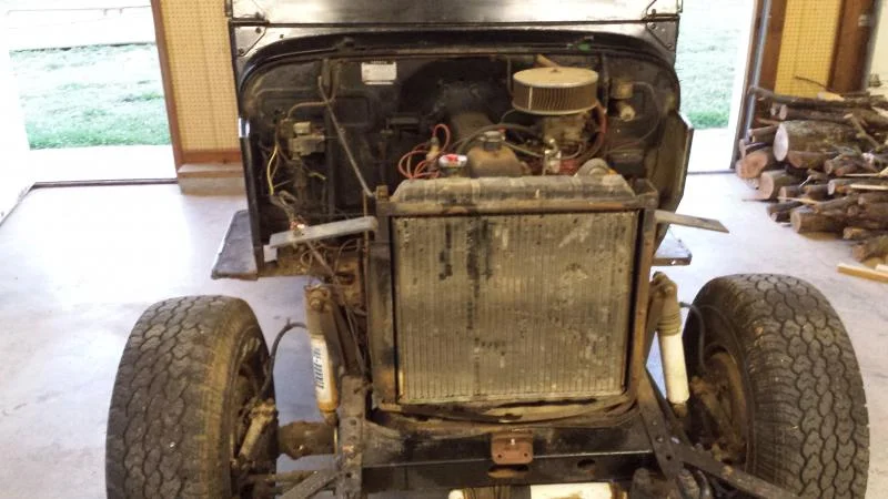

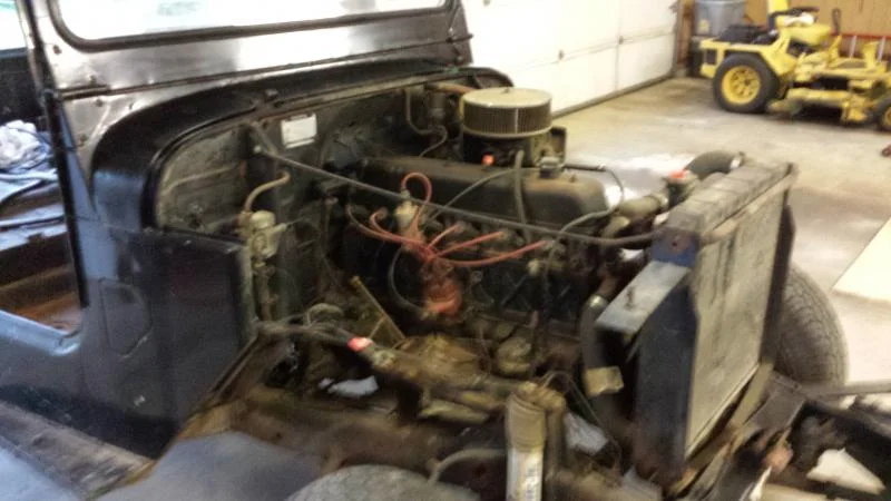

Has anyone ever kept track of how many bolts they twisted off in a 2 hour stint? I just counted 8, and I was being careful. Got the entire front clip off today - my first good look at the engine compartment. PO had a funky coolant setup and some brackets welded to the radiator core - not sure why. I'll be cutting those off and will prepare the way for a shroud. Lots of wires that don't belong. Otherwise, the truck is really solid. Not a bad spot on the bib, fenders or skirt pieces. Will blast and prime the correct '62 windshield frame when I do the rest of the front clip. Anyone know if the later model rubber w/s mold will work if I use it on the '62 model w/s frame? It's in good shape - I might use it if I can.

Unless your grill has been swapped, yours is an fj40 soft top, not an fj25. What does your vin say?

might just be missing bars and headlight rings. hard to tell in the pic. the rear quarter cut is correct for an fj25. is the fuel filler before or after the seam (no passenger side pics)
as for your bolts, get a couple cans of loctite freeze and release and lots cans of pb blaster or kroil.

Because it has wheel wells that are not round and a vacuum shifter on the dash with a vacuum control on the firewall it is a FJ40 not a FJ25.
