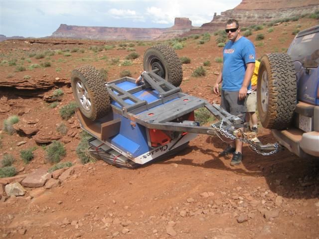

Yes, I got it throw AT when I picked up my Chaser.... works like a charm... But don't try this at home:o

So, you are saying it rotates? I don't believe it! :D
Wow, thanks for sharing. Were you on White Rim?
Rezarf <><
Rezarf <><
Almost but not quite... Lockhart Basin
