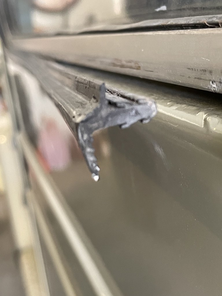

Thoughts? it's just a flat edge on glass side and frame side.

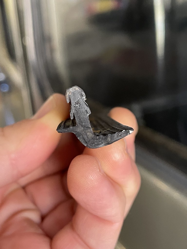

Can you take a picture of the inside of the gasket? Hard to tell but that may be an offset type gasket. Original probably won't fit this.

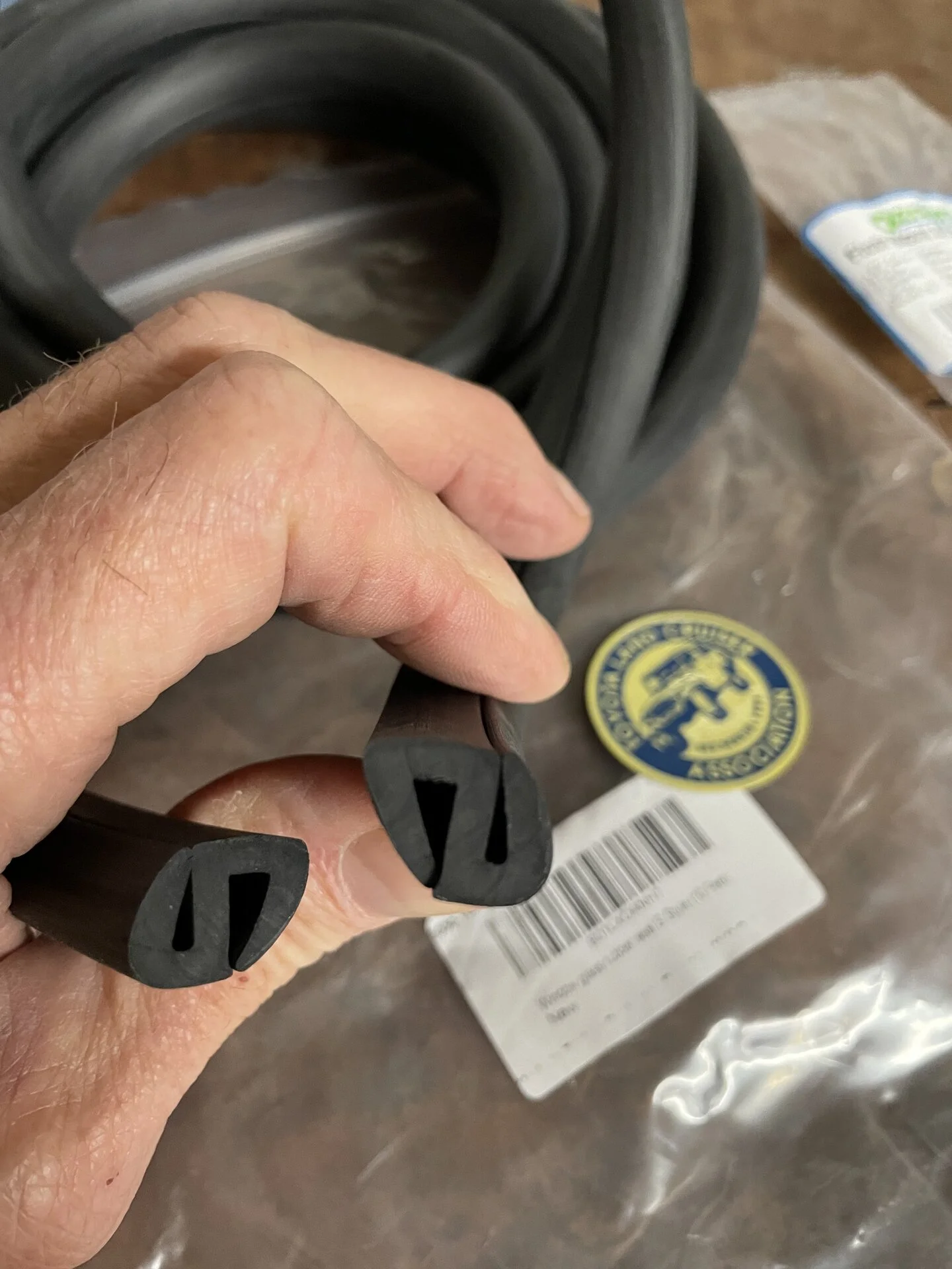

Okay @Storm Ranch this what my back door glass seal looks like. It is S shape with the small channel 2mm fits the fiber glass door and the large 4mm channel fits the glass…..
this is the old gasket in the photos

Theoretically, if the seal was cut somewhat long and squeezed in it wouldn't later open up. That said I'm not an expert glass layer and I've only got what I've read to go by. I'm thinking an extra 1-1.5" so that the seal is as tight as possible.
If you read up on using auto glass gaskets/seals it will say to add 1-11/2” to the over all length.
The gap in that gasket was cut out so I could see what shape and the channel size for my replacement gasket. The gasket did not “open up”. It’s the same rule of thumb to add length even when replacing door seals.
You have to be careful ordering gasket material. If the channel is not sized correctly the glass and body seal may not be tight enough and will not hold in place.
This would be correct. Straight cut for the joint. Urethane windshield adhesive can be used on the seam after install.
I just wanted to let y'all know that I had some recent correspondence with the company that does 3-D printing (to include rubber gaskets) and they said they were somewhat confident that they could reproduce what's needed for my project (FJ43 MPR hard top slider window gaskets), but quoted a price of $1000 per seal for the gaskets on my MPR hard top. That's way too rich for my blood, so I'm continuing to look.
This is the gasket I'm in need of, which seals the slider window from the outside.
