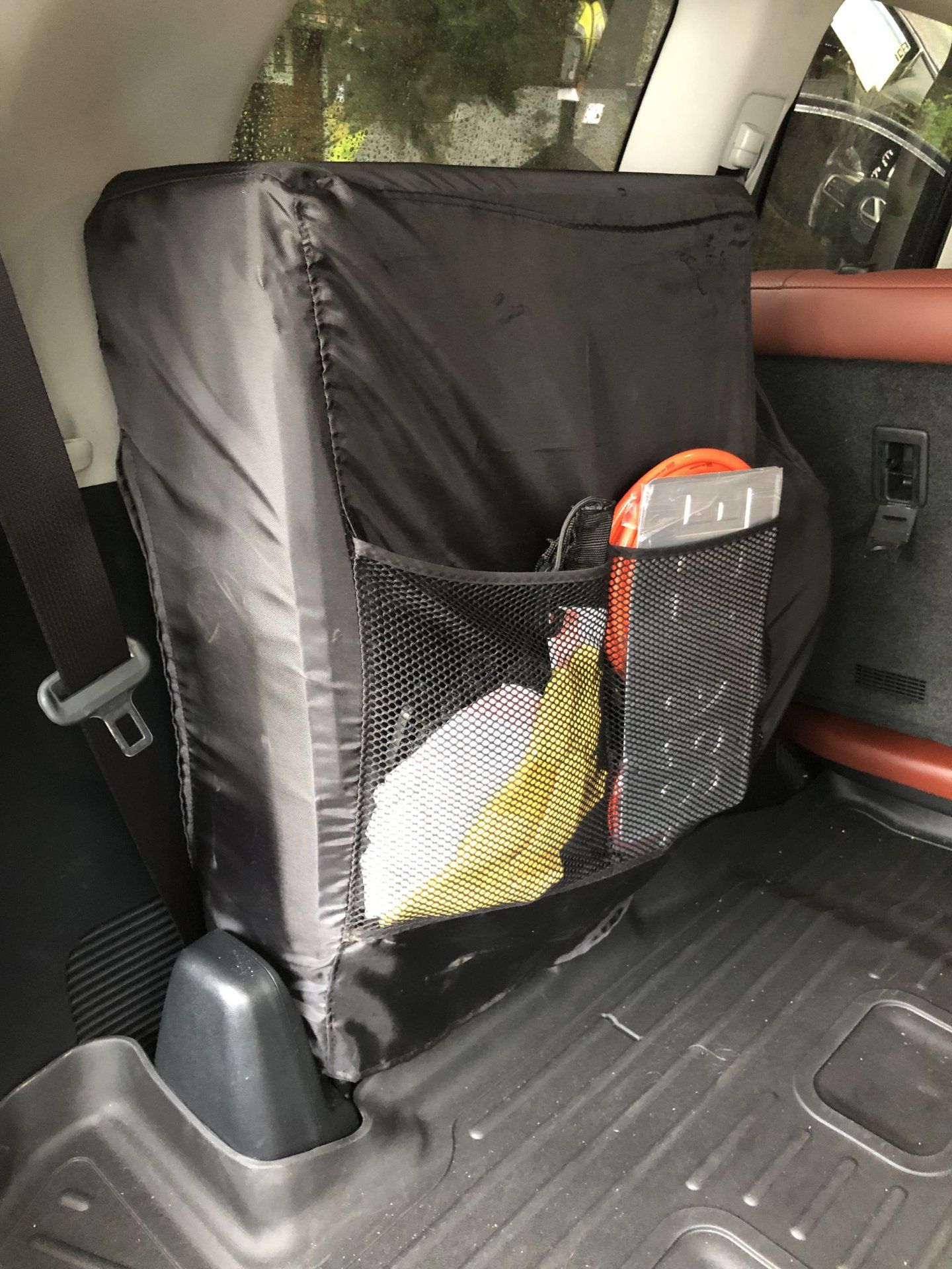

Not sure if I ever posted these, but the third row seat covers are great. Easy to install/remove, protects the seat, and has large storage pockets! The license plate gives you an idea of size.

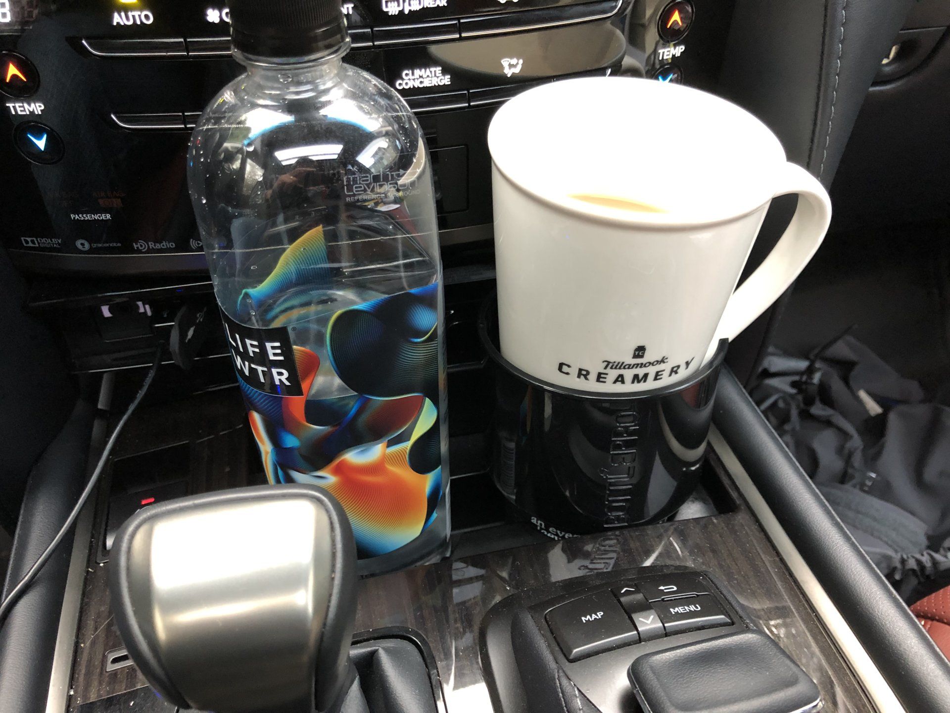

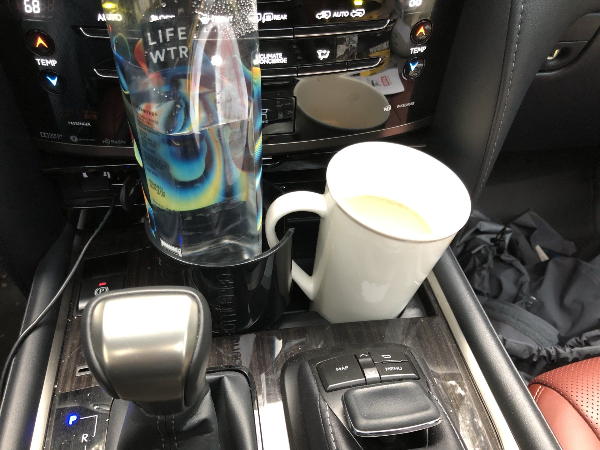

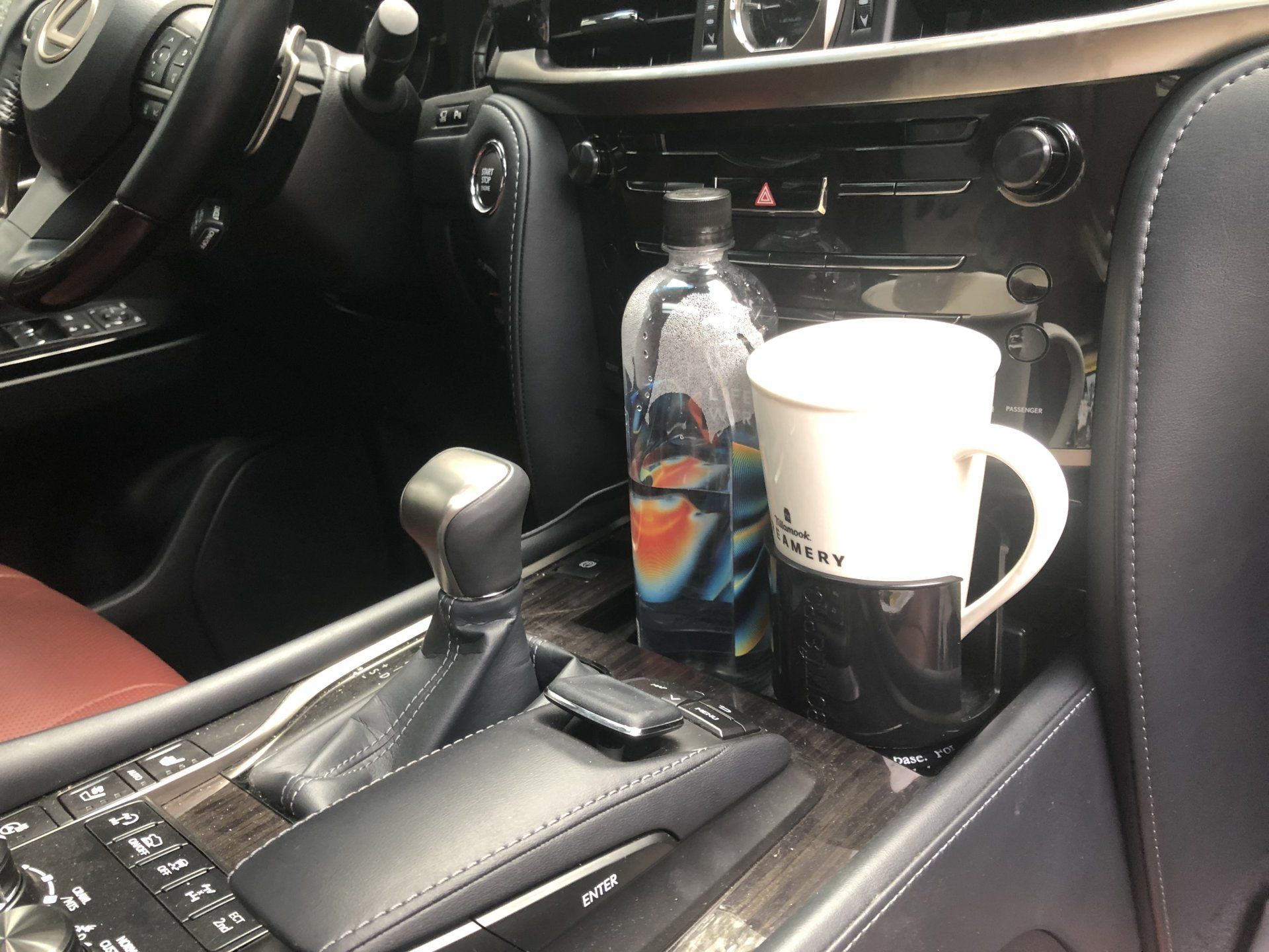

There is a lot of talk about the small cup holders. This insert from amazon is awesome. It accommodates the large 40oz bottles as well as odd shaped coffee cups and leaves the other cup holder fully functional.
View attachment 1951508View attachment 1951509View attachment 1951510View attachment 1951511
Where did you get the seat covers?

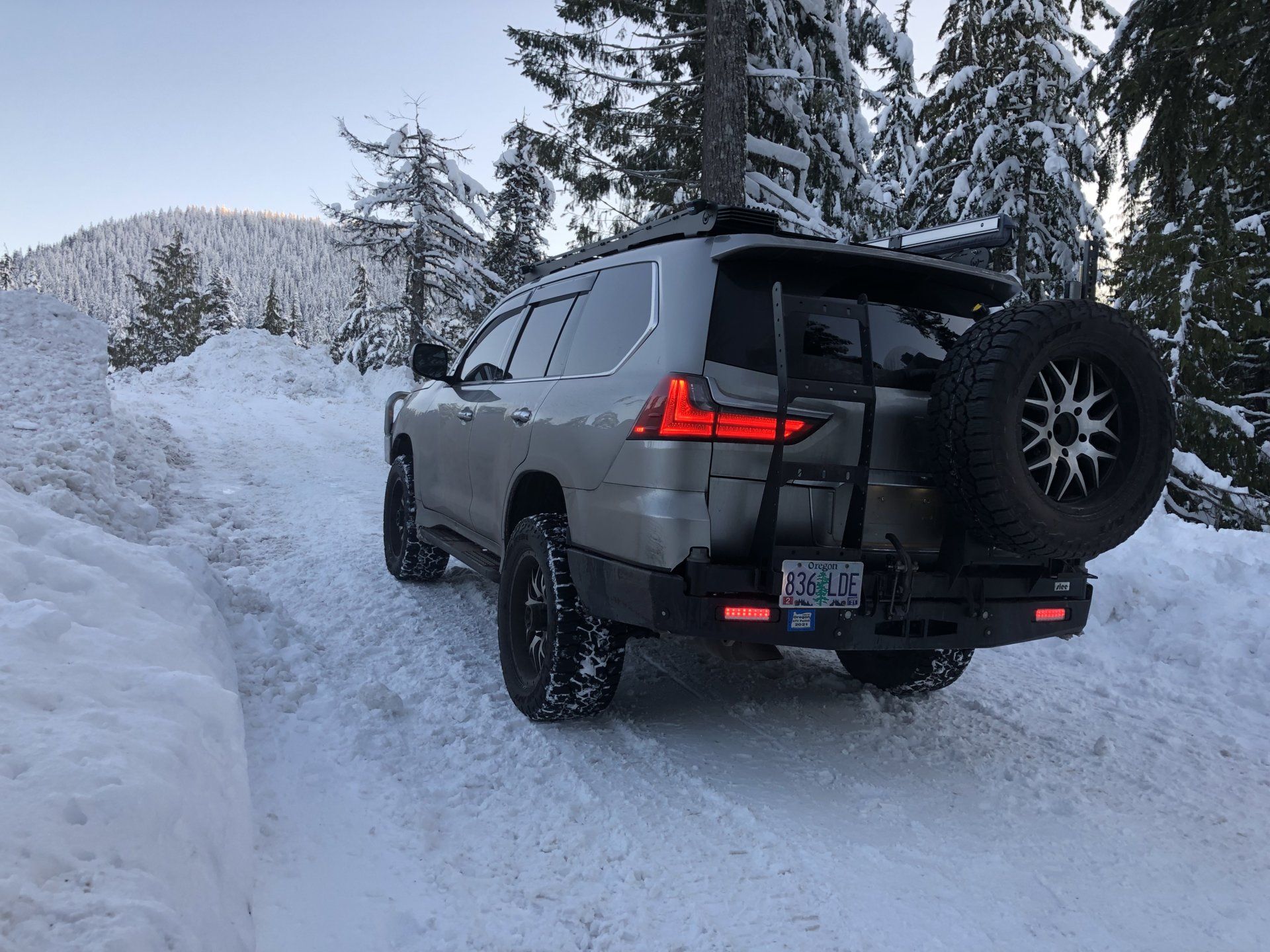

Had some fun with the Slee rear bumper. I went up to Timberline Lodge and when we came out, the pull/release pins that you pull vertically to release both swing outs were completely frozen. I poured some water on them and with some thick gloves was able to pull them loose after a couple of minutes. It was about 20 and the wind was at about 20mph, so it seemed like I was working on it forever!
Had some fun with the Slee rear bumper. I went up to Timberline Lodge and when we came out, the pull/release pins that you pull vertically to release both swing outs were completely frozen. I poured some water on them and with some thick gloves was able to pull them loose after a couple of minutes. It was about 20 and the wind was at about 20mph, so it seemed like I was working on it forever! View attachment 2218096
Keep a can of deicer spray in the interior.

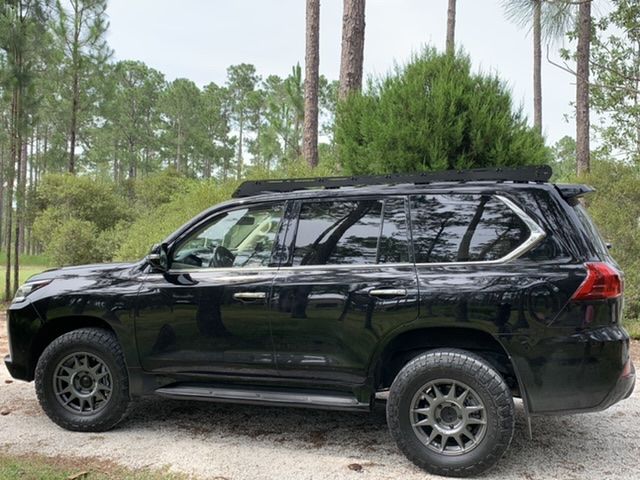

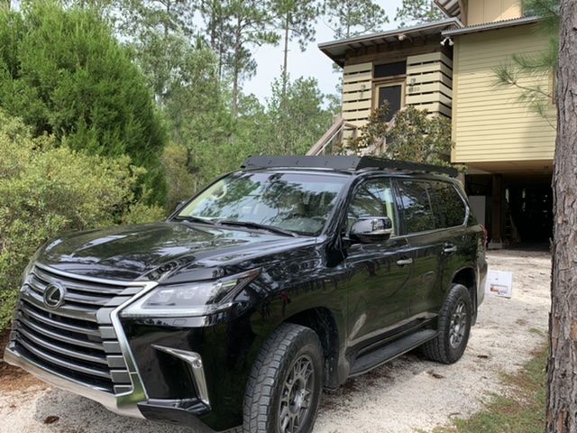

In case someone picks up on this thread. I installed a Prinsu on a 17 Lx this weekend. All the holes match up perfect. Paid an upholstery place 285 to lower and put up the headliner. We used his parking lot to install the rack. LX holes aren’t threaded so we had to add some nylock nuts and washers. Easy except for the front 2 each side. Took a finger contortionist. In hindsight I should have just gone home to grab rivnut tool for those 4. Thank god my 20 year old is more patient than I.

Definitely worth the hassle!
Looks great! I just ordered one for my '16 LX. Going to give it a go ourselves too. Was hoping I wouldn't have to mess with the headliner. Oh well. Any advice on dropping the headliner from the upholstery people? Tips/tricks? Any additional install pics?
