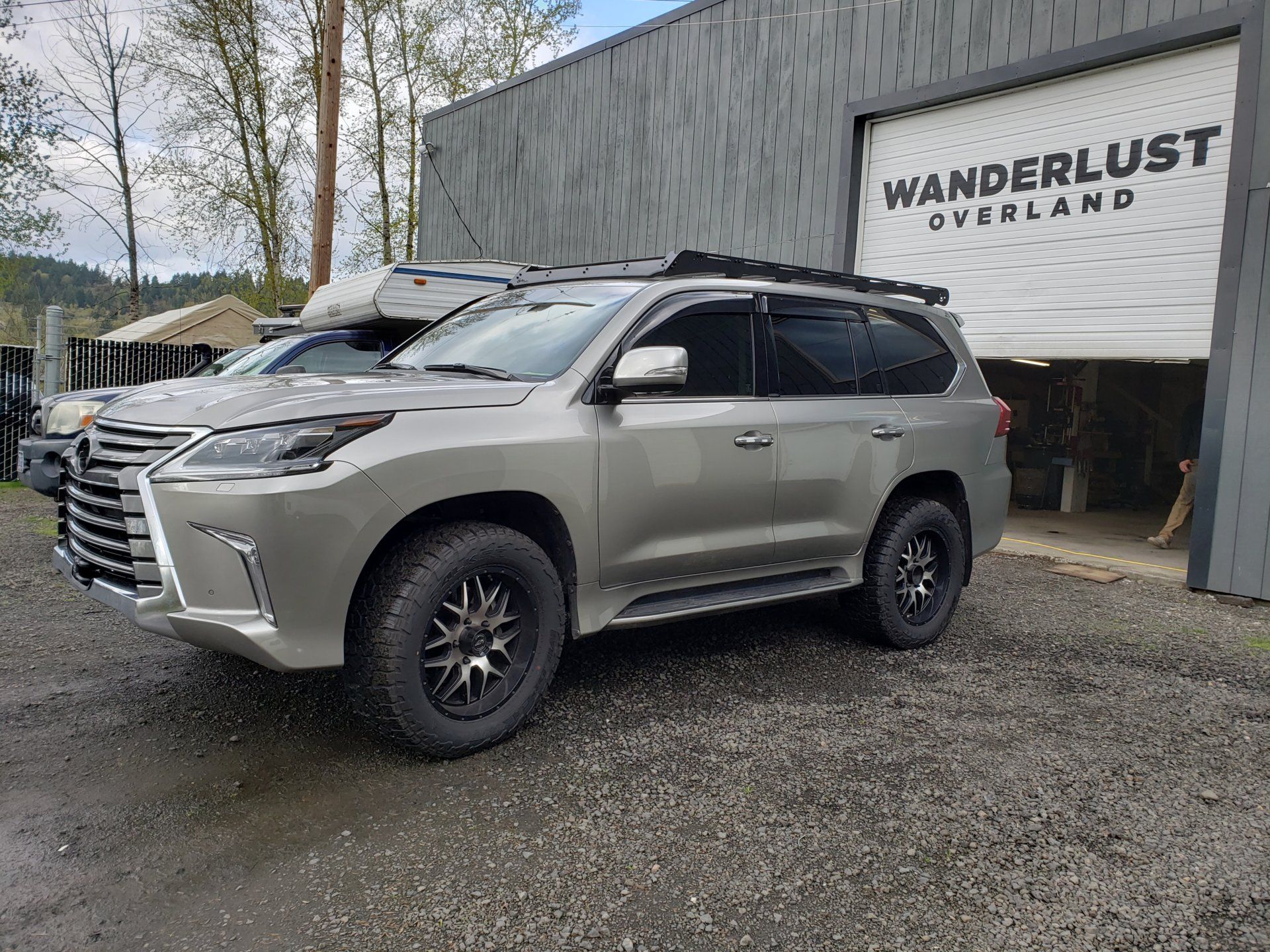

Well, I guess there was some miscommunication at some point, the Prinsu Rack does NOT bolt right up to post facelift LX570s. It is a custom job that is shown here in this post What's going on in the ACC Garage. . .
I had a feeling it wouldn't work. The only system I see that currently bolts to the 2016+ factory side rails is from Frontrunner and even then the stock photos don't actually show it installed on an actual 2016+ LX 570.
I contacted Rhino about their rack as well and they haven't touched the newer LX either. I haven't messed around with ours much so I am not even sure what all is involved in removing the side rails. They sort of appear to be molded in to the roof line but I am hoping that they are in fact removable.

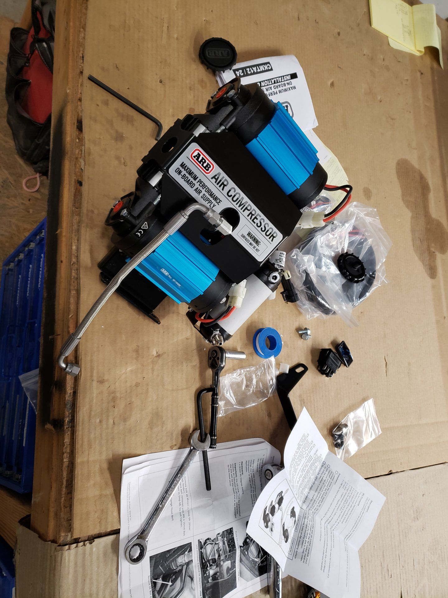

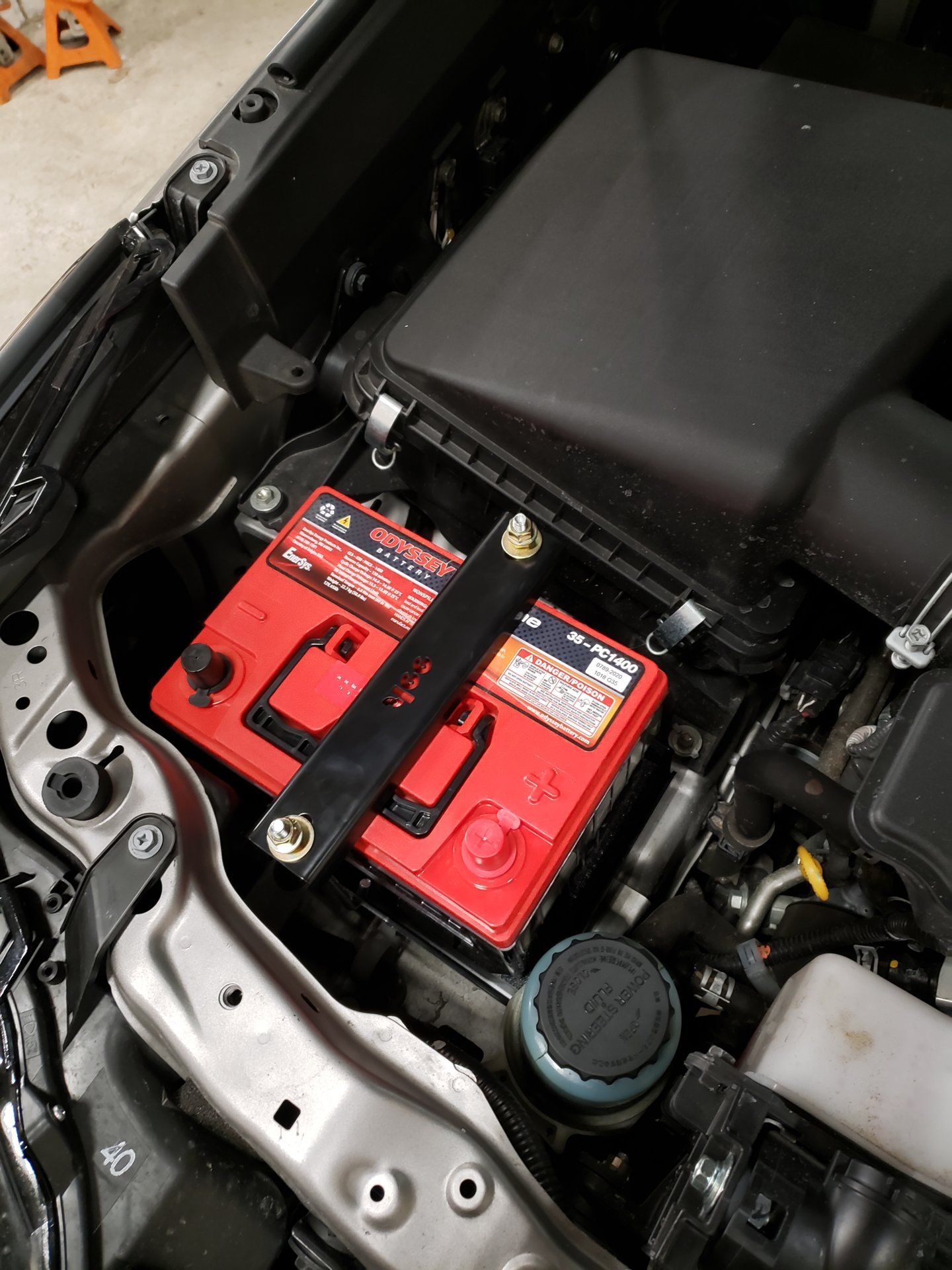

  • Second Odyssey Battery using Slee Brackets Installed
  • ARB Twin Air Compressor 90% installed
  • Prinsu Rack assembled only to find out it doesn't work without a lot of modification

It looks like you have the Slee battery bracket in reverse? That way the pressure can be spread on to a bigger surface area?
Good eye! My tech had, in fact, installed it upside down initially. Caught it after I took the photo yesterday. Sent him home early to get some rest as he was a bit foggy from fighting a cold. It has since been remedied!

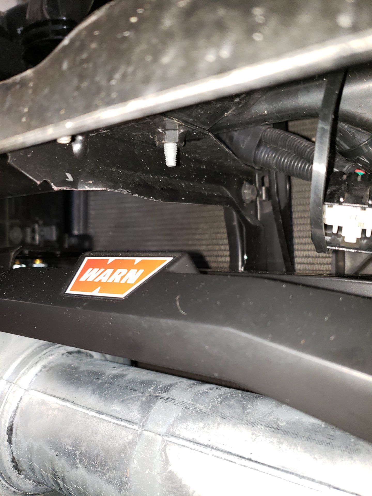

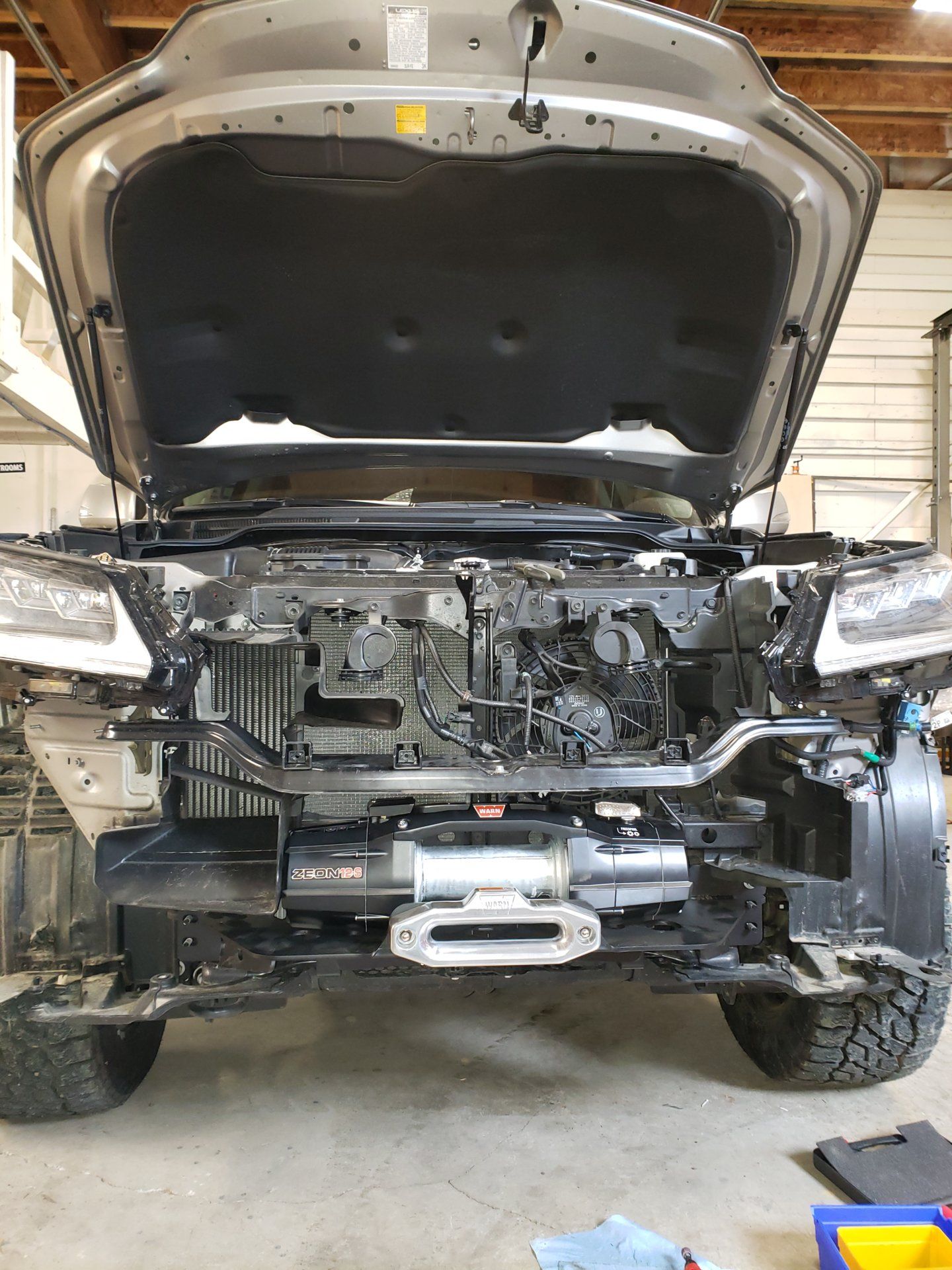

- The Trail-Tailor hidden winch mount did bolt right up with no issues! There was some minor trimming necessary on a brace from the core support to the grill to make the winch fit and we had to relocate the Warn Zeon Control Module to above the grill cross-bar. After taking the grill/bumper off and putting it back on probably a dozen times, we were able to cut just enough opening to make room for use yet still be pretty aesthetically pleasing and keep as much grill/bumper integrity as possible. We did throw a Warn Epic Sidewinder hook on to better fill the gap between the front of the grill and the recessed fairlead. In a direct comparison, the LX grill sticks out about 3" further forward than the 200 series grill.
1942524
1942525
1942526
1942527
- ARB Dual Compressor is a great addition, however we did run into some issues with some of the added features we were trying to integrate with the LINX system. There is an inflate/deflate module that is supposed to allow you to dial in your pressure on the LINX, press a button and air your tires back up to the requested pressure and the compressor will shut off. However, the aluminum air distribution block that you are supposed use for the valves, pressure sensors and coupler does not allow enough space for the ARB supplied coupler and valves and sensors to all be plugged in at once. Also, the block has smaller ports than that of the coupler so reducers would need to be used, possibly negating the extra flow you get from going with the Twin Compressor. Trying to work through this one with ARB as well.

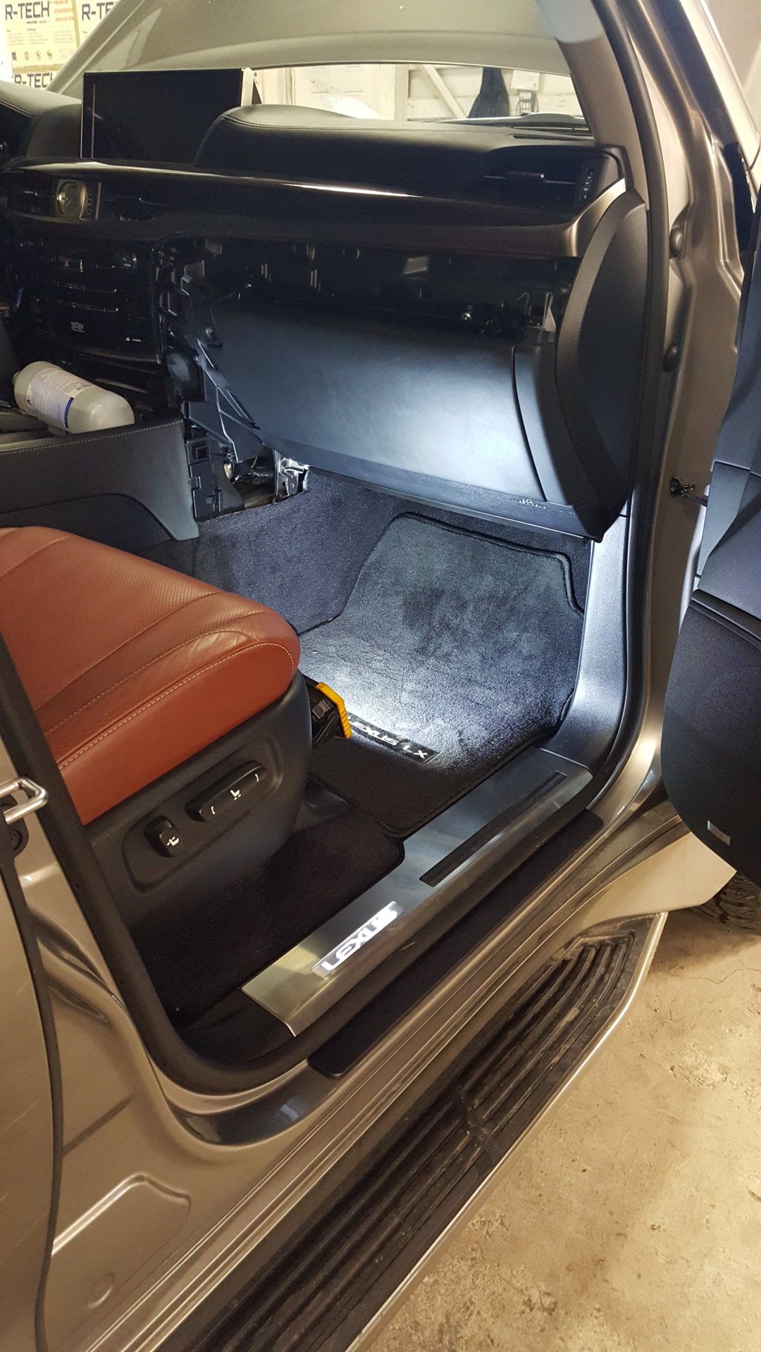

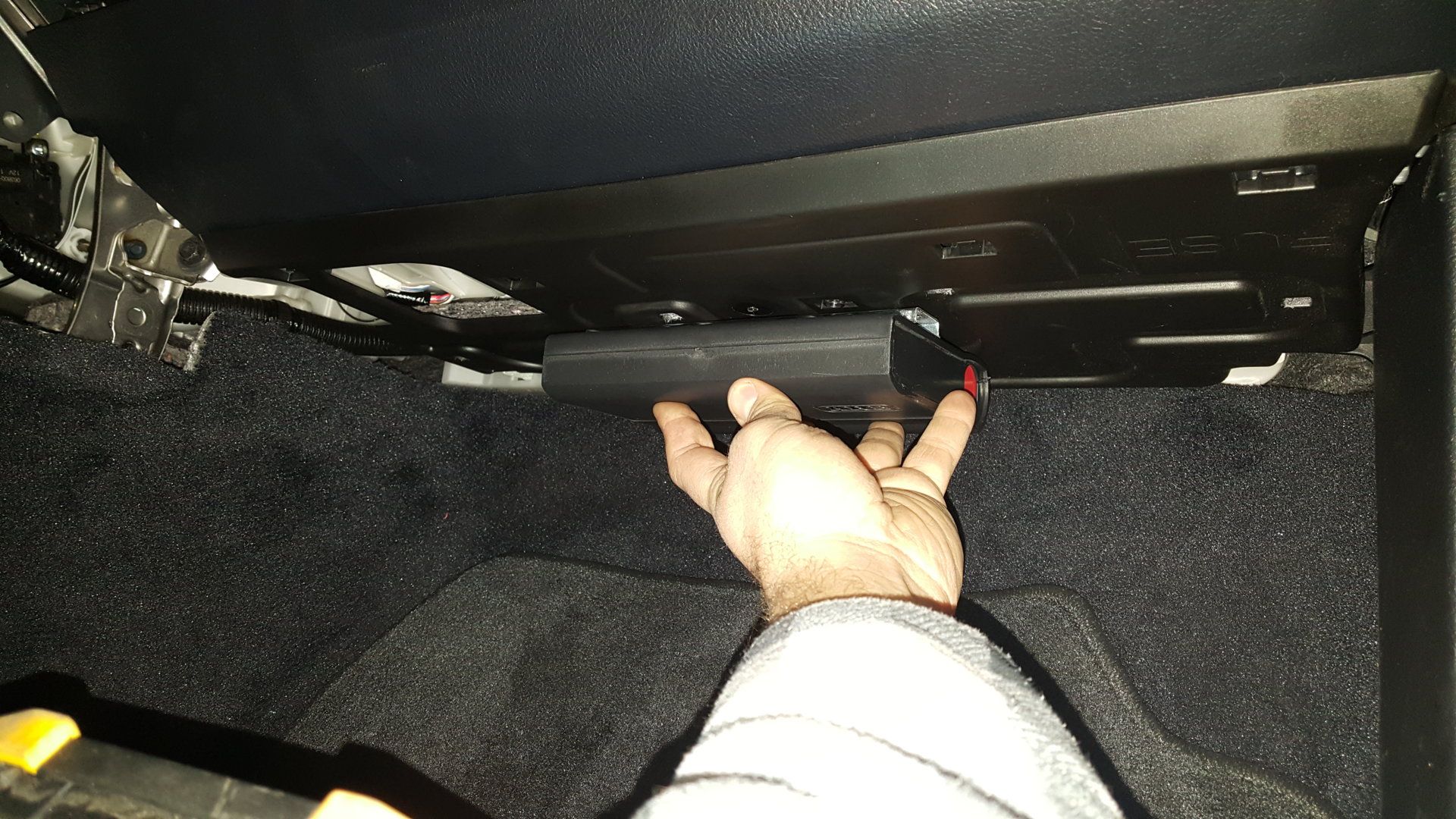

- LINX system is all up and running. There was difficulty finding a place to put the "brain" distribution center as it is quite large and cannot be installed in the engine bay. We tore the dash and console apart looking for a spot, to no avail. Ultimately we ended up mounting it under the dash in the passenger side footwell. It tucks up nicely and really is only noticeable if someone were to point it out. Full review of the system to come later after some more time dialing it in and playing with it. Also, the 200 series bracket to mount the control unit itself on the A-Pillar worked just fine on the LX.
1942537
1942538
(Pic with the module mounted, cannot see it unless you bend WAY down and look up under the dash)
1942539

- The Prinsu roof rack also took up quite a large amount of time and there is still not a solid answer on if it is going to work. The flush rails on the LX are bolted to the roof from the INSIDE of the vehicle. We started to do a similar modification to the rack that was done by another shop where they cut the feet off and mounted the side rails inside of the Lexus factory flush rails, however we realized that what we thought were drilled and tapped locations we could bolt right to on the inside of the flush rails were actually just divots for locating pins for factory cross rails. Without much information out there on how the rails are constructed, we opted to not drill or tap into them to support something as important as a roof rack that could see hundreds of pounds of cargo in extreme situations. Next time the rig is in the shop we will be pulling the headliner and comparing the mounting locations to the Prinsu feet to see if we can pull the flush rails and the rack will bolt right up after doing so.

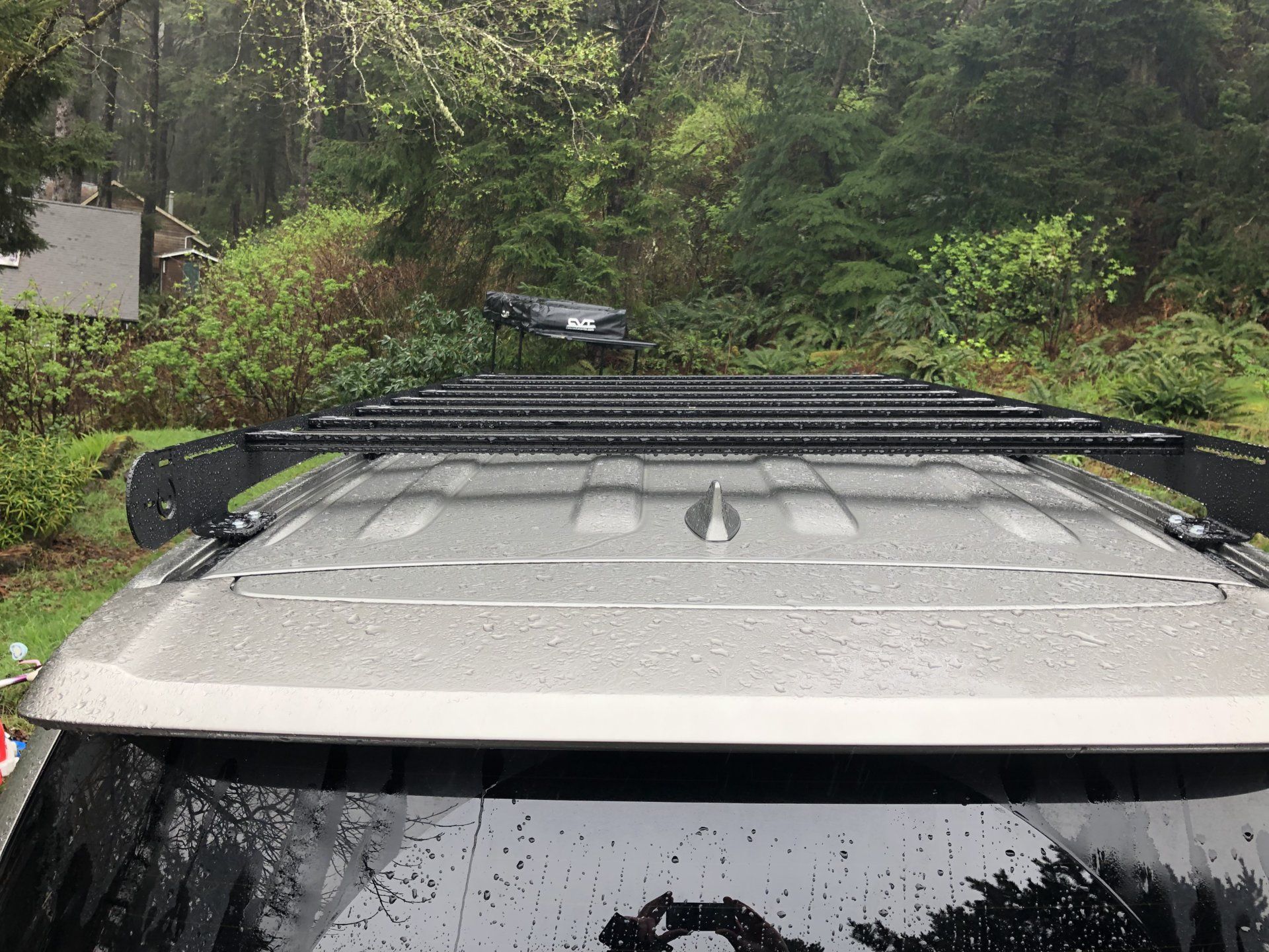

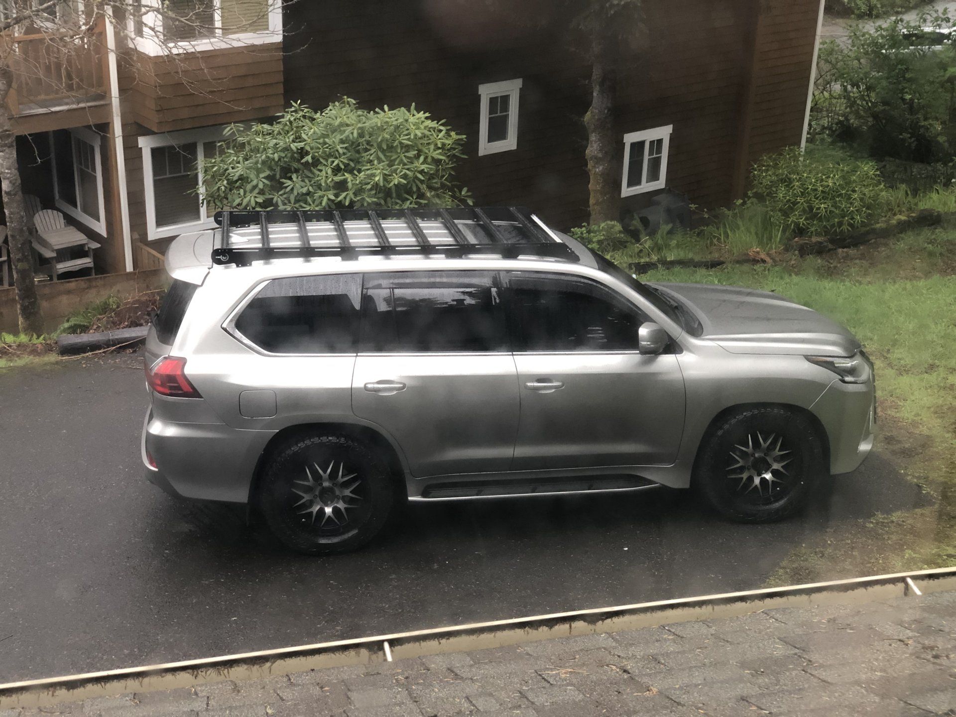

I really like the Prinsu rack. The sales/service support is disappointing, as seems to be usual with many of these vendors, but the product “seems” excellent. Very sturdy. It’s nice to have full length coverage.
I removed the rear most cross bar as I felt it was hindering the satellite radio.

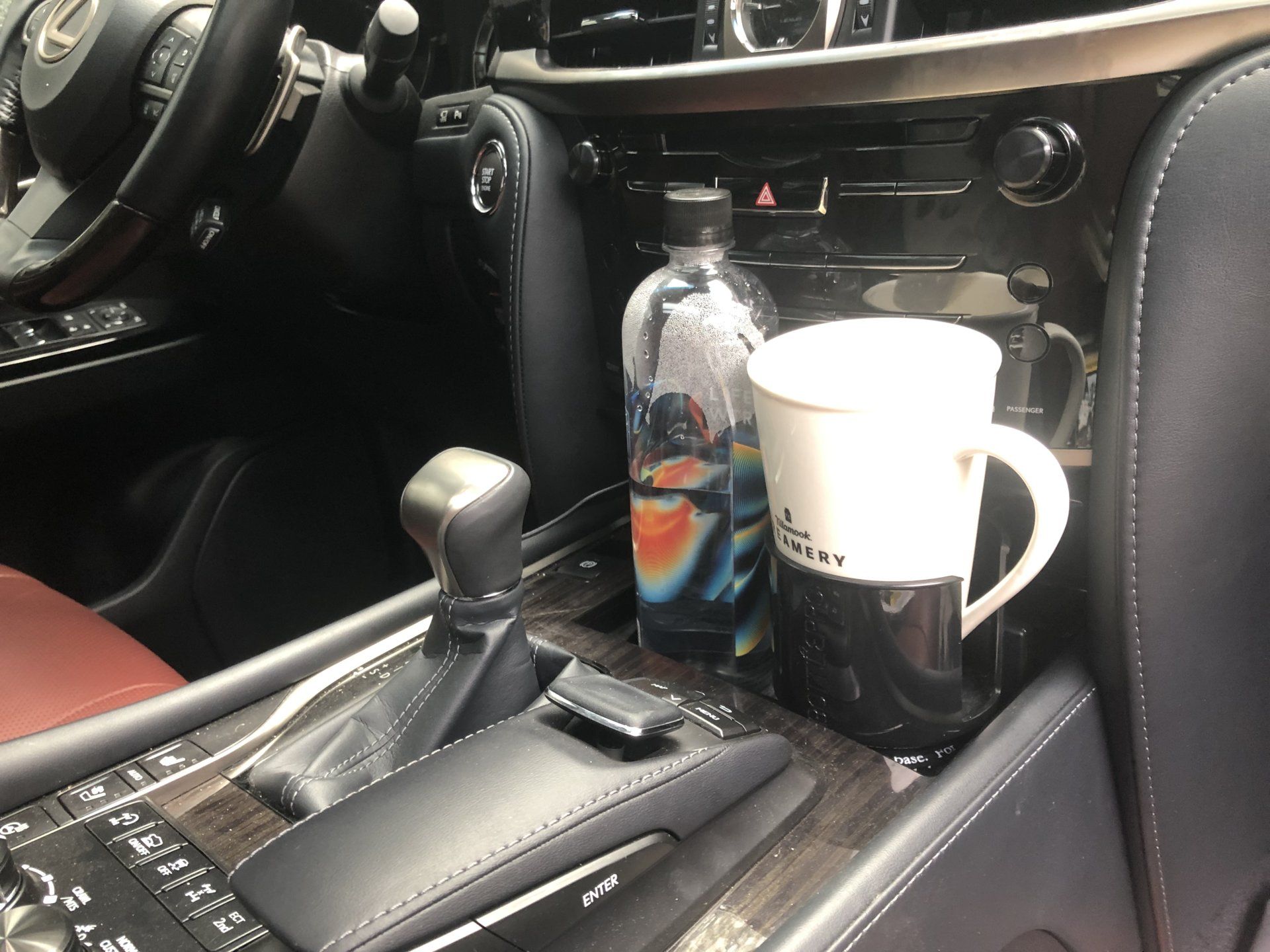

There is a lot of talk about the small cup holders. This insert from amazon is awesome. It accommodates the large 40oz bottles as well as odd shaped coffee cups and leaves the other cup holder fully functional.

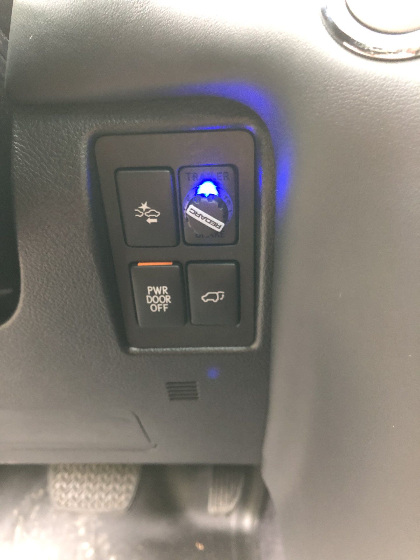

RedArc trail brake controller. Very clean and accessible. Offers auto and manual control.

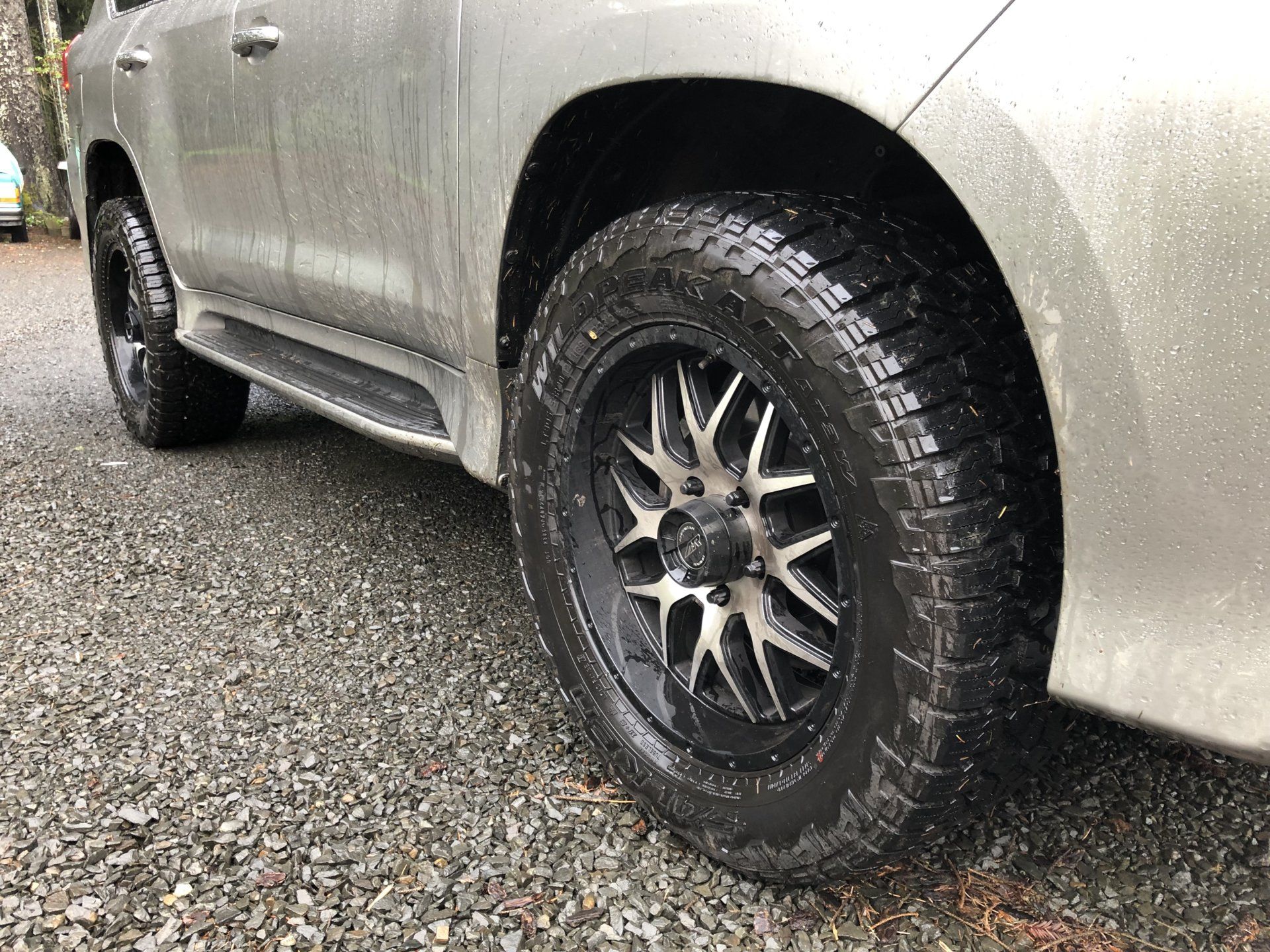

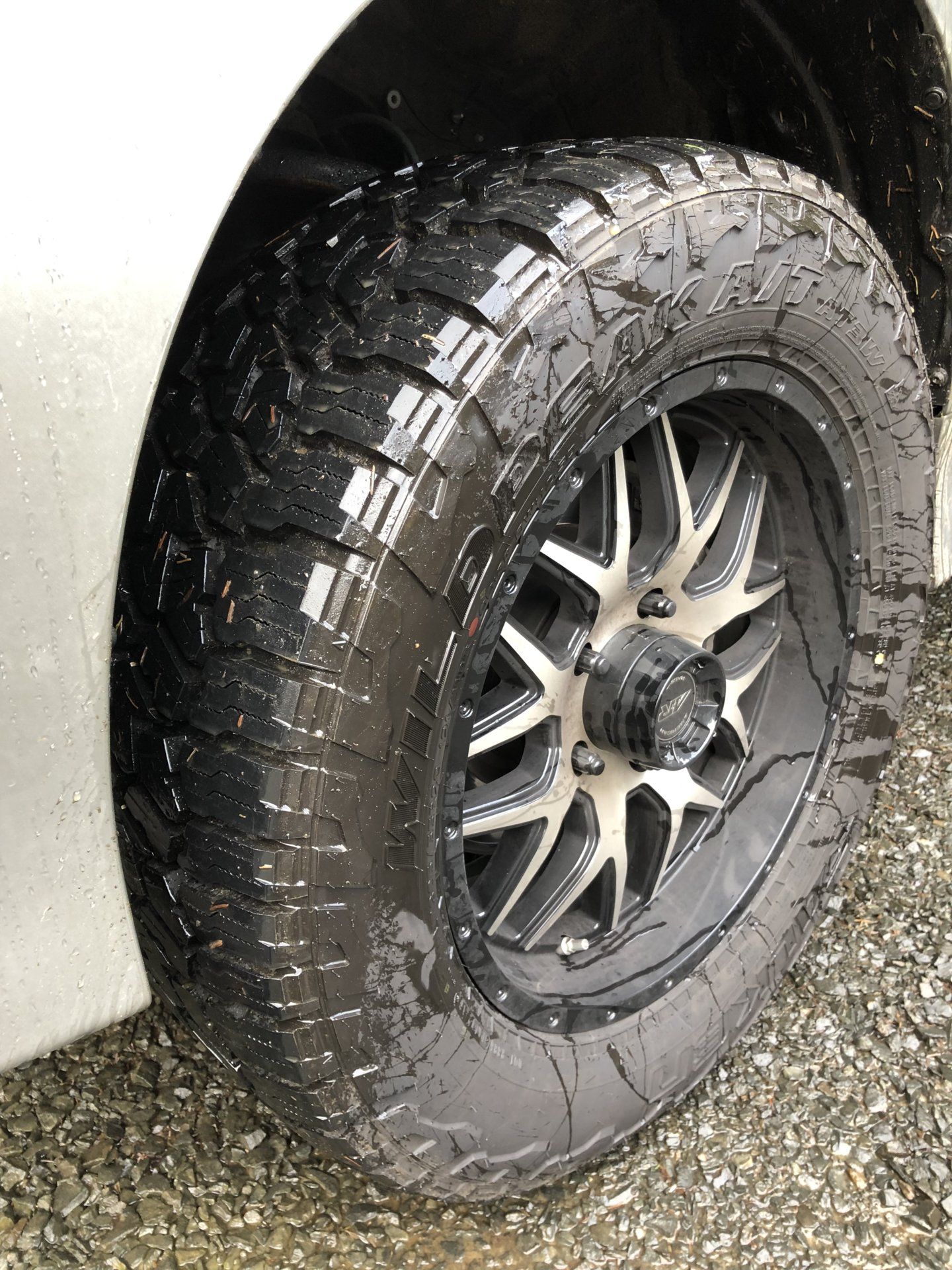

Finally, a few comments on the Falken Wildpeaks.
I’ve now made several trips over the pass between the Oregon cost and Portland. Very wet and twisty with many off camber turns. Snow and ice at elevation. And I love these tires. The traction is excellent. The combination of these wide tires and the wider stance of the wheels really added stability. I push the LX hard, and it responds really well with this configuration. Most of my driving is on pavement, so I’m overjoyed. Hopefully I’ll get more off-road time soon, but I have very high expectations as I haven’t been able to find a single bad review of them off-road, other than mentioning their shortcomings in serious mud, which is to be expected.
