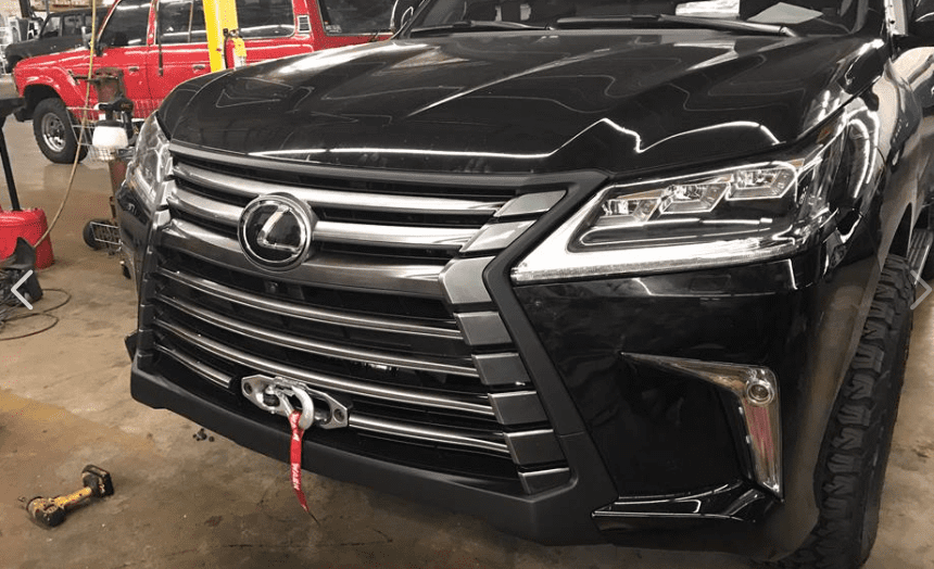

Trail Tamer hidden winch mount and winch (will look like the attached pic)

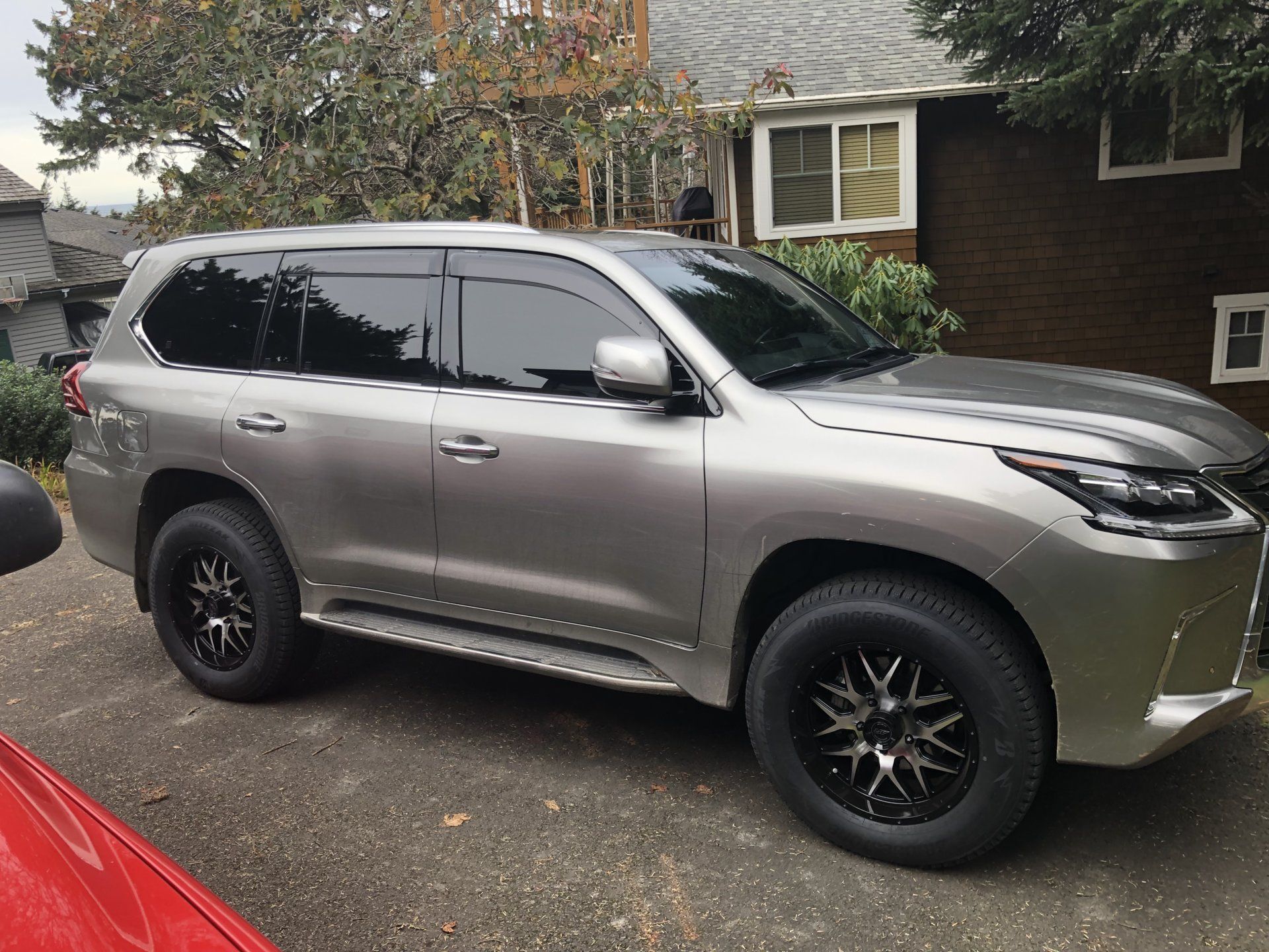

Might as well add a few pics to track the progress.
First is stock when bought new.
Second is as it sits now with tint, AR910 wheels and the Land Cruiser rain guards/window/vent visor.
