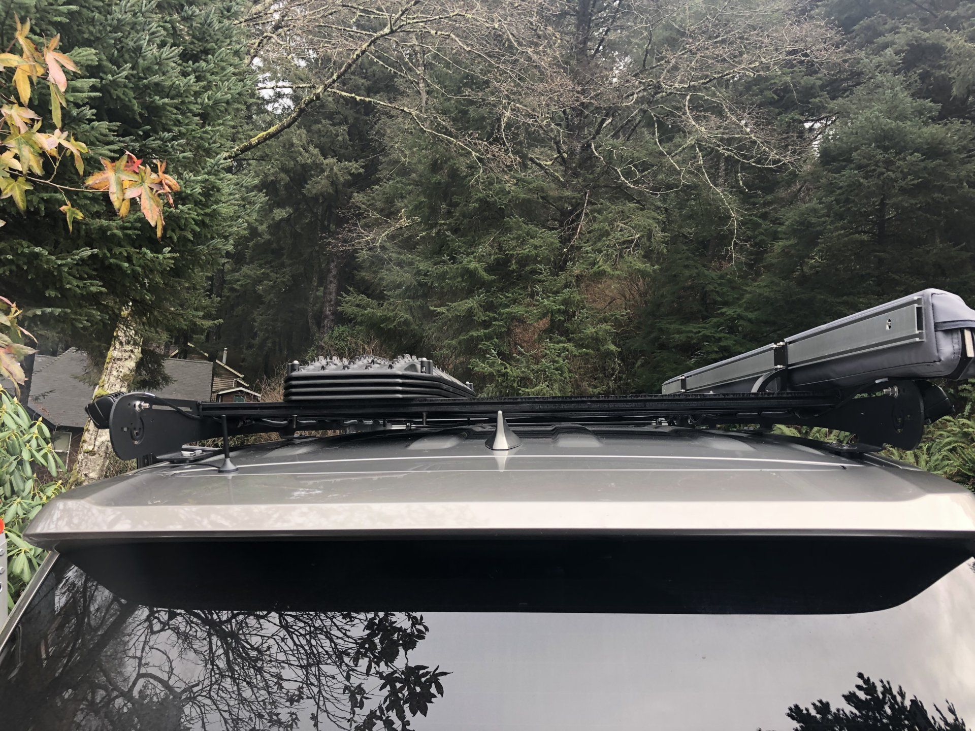

Wanted to recommend the WeBoost antenna.
It does not create signal, but it will boost an unusably low one to usable levels.
I presently have the exterior antenna router in through the rear hatch to the main box which is just sitting next to the 3rd row seat.
The power cord and interior antenna run under the second row seat and floor mat, to the 12v outlet on the rear of the center console and the antenna on the side of the console.
Now that I’m sure I will keep it, I’ll hide the internal antenna under the dash somewhere and then run the power through the ARB linx system so that I can turn it on as needed, rather than sitting next to amplified signal the whole time. I presently keep it unplugged except on dead spots.

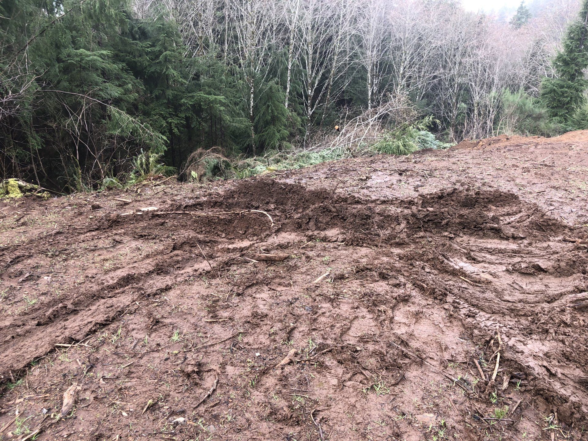

I got stuck in some DEEP mud yesterday, and had to winch myself out. To be honest, I don’t think dedicated mud tires would have made a difference.
Without anything for perspective, the pics dont really do any justice. But you can see the width of my tread, which is just over 12 in, and here I was aired down under 10psi. So the mud was 6-18 inches deep, depending upon how much I sunk myself down.
The pics don’t show that there is a slight grade away from where I am standing, and to the left side of the pic there is a steep drop off, and every move I made brought me further down the hill and closer to the steep drop.
I was just out on a short explatory drive minutes from the house, and ended up being covered in mud and burning more than half the day with getting myself out and then getting the rig and myself clean again.. Good lesson though!

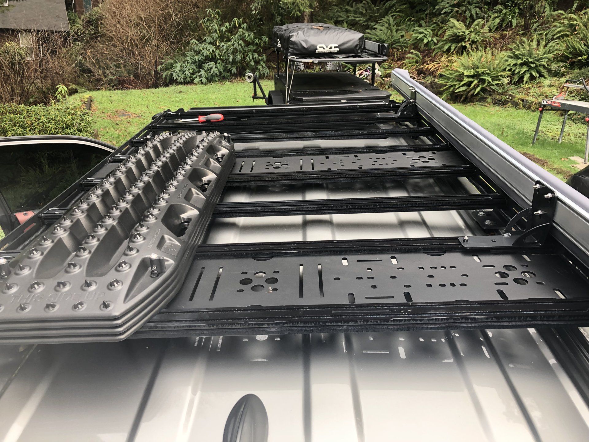

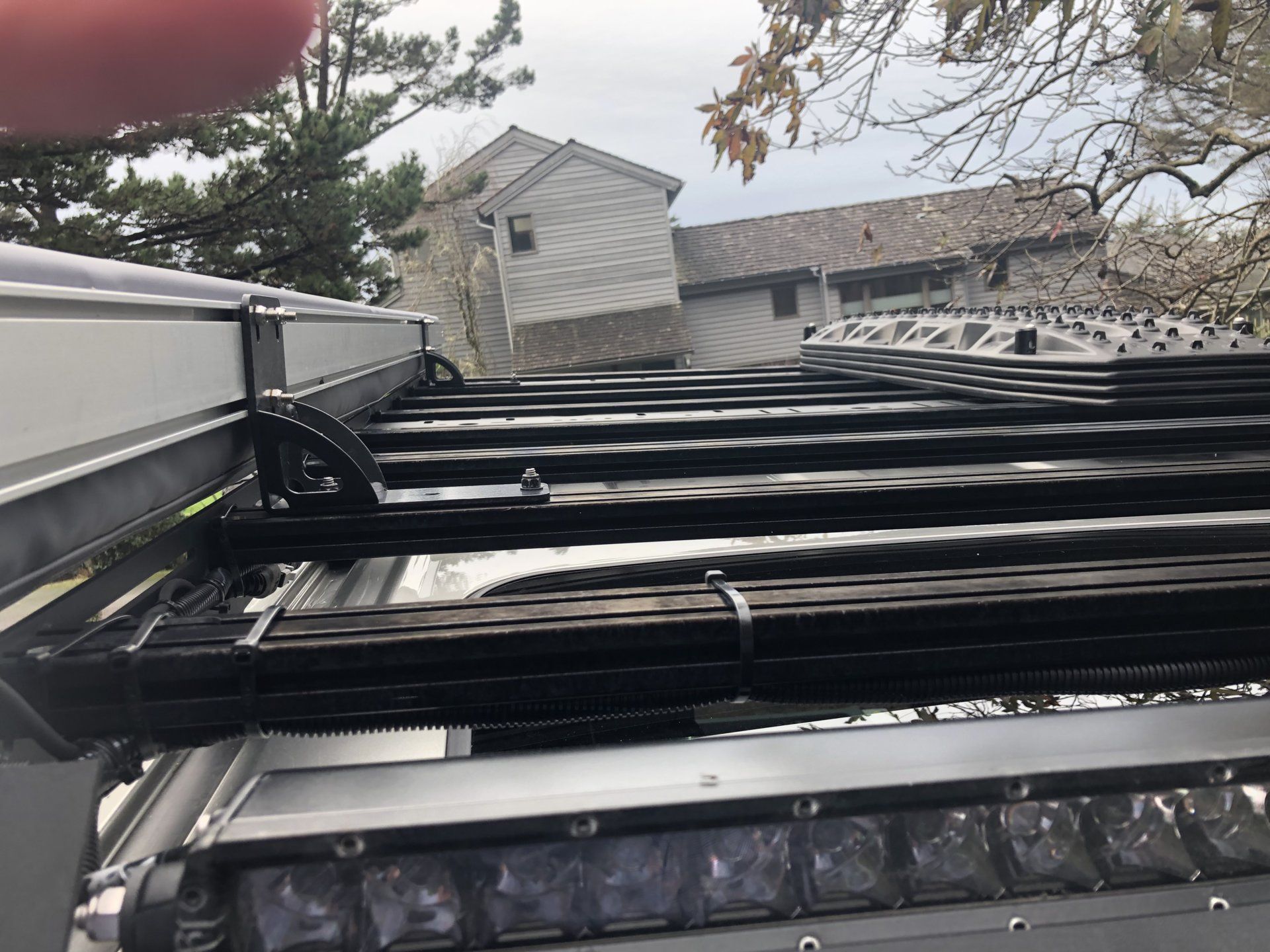

I finally pulled the trigger on Prinsu load panels to mount my Maxtrax. I thought about installed them on the Slee bumper but then decided that I didn’t want to block my rear window any more.
The panels were a fairly easy install, however, then sit a touch lower that the top of the cross bar. The maxtrax pins have a protrusion on their base that goes into the bottom of the maxtrax and then the pin goes through. The protrusion on the bottom goes up into the bottom of the maxtrax and then the entire pin assembly is prohibited from rotating. But the pin assembly mounted on the panel is lower than the cross bars and so the maxtrax are blocked from coming all the way down onto the protrusion. Not a huge deal, washers will raise the assembly up.
The (4) maxtrax stacked up sit a bit lower than my ARB awning, so it all worked out well.
I had the WeBoost wired into my LINX system and so it and all my lights are operated from the controller, all of which is tied to my secondary AGM battery.
I relocated the interior antenna to right behind my magnetic phone mount so that I can set my phone up there and it’s close to the antenna, and the antenna is mounted a bit away from me.
looking good! Are you worried about flex near the sliders? Seems a bit close?
Not really. If I get some damage in the front or rear, I can always cut back further. I guess its always possible for a crack to go all the way past to where I'd cut and in that case I might have to replace the rocker panel...
