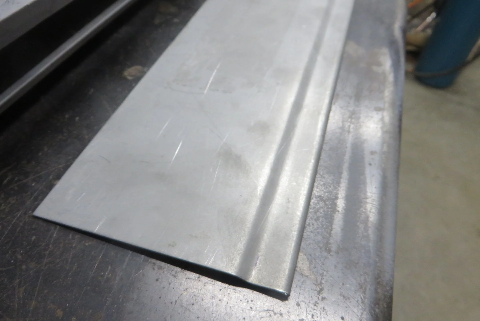

Rooted Windscreen Panel 1: This it the original windscreen panel, it was straight but had a serious rust issues. So I had a local sheetmetal place fold me up a piece that I could cut up and use to make patches out. The only problem was that by the time I had welded in 5 or 6 patches, I had managed to warp the panel, so it looked like it had a series of waves across it. This might have been repairable by a professional, but was on beyond my skill set. So I picked myself up a replacement panel that apparently had a bit of 'surface rust'.

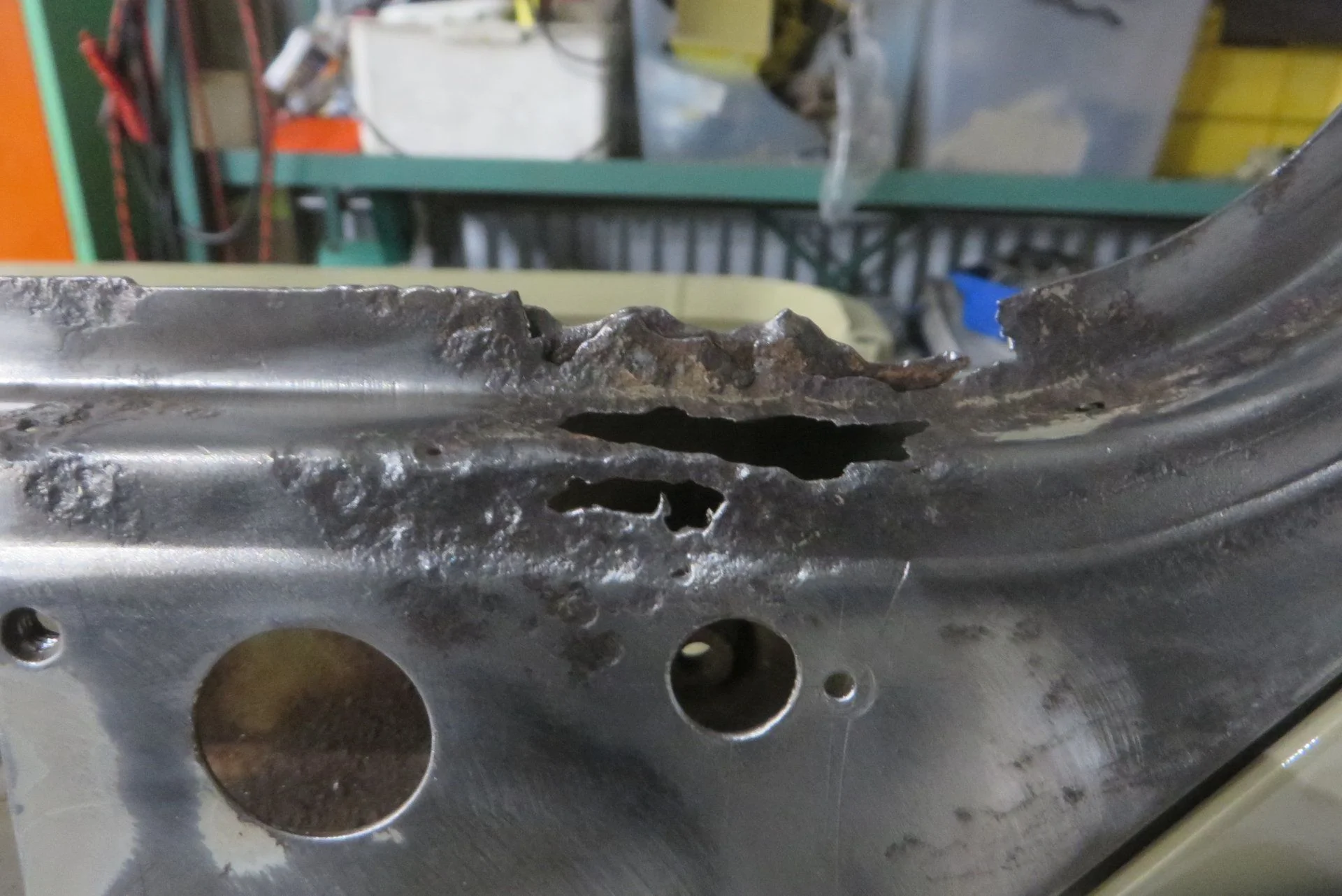

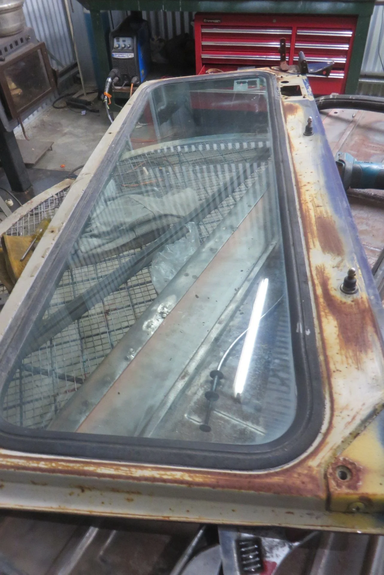

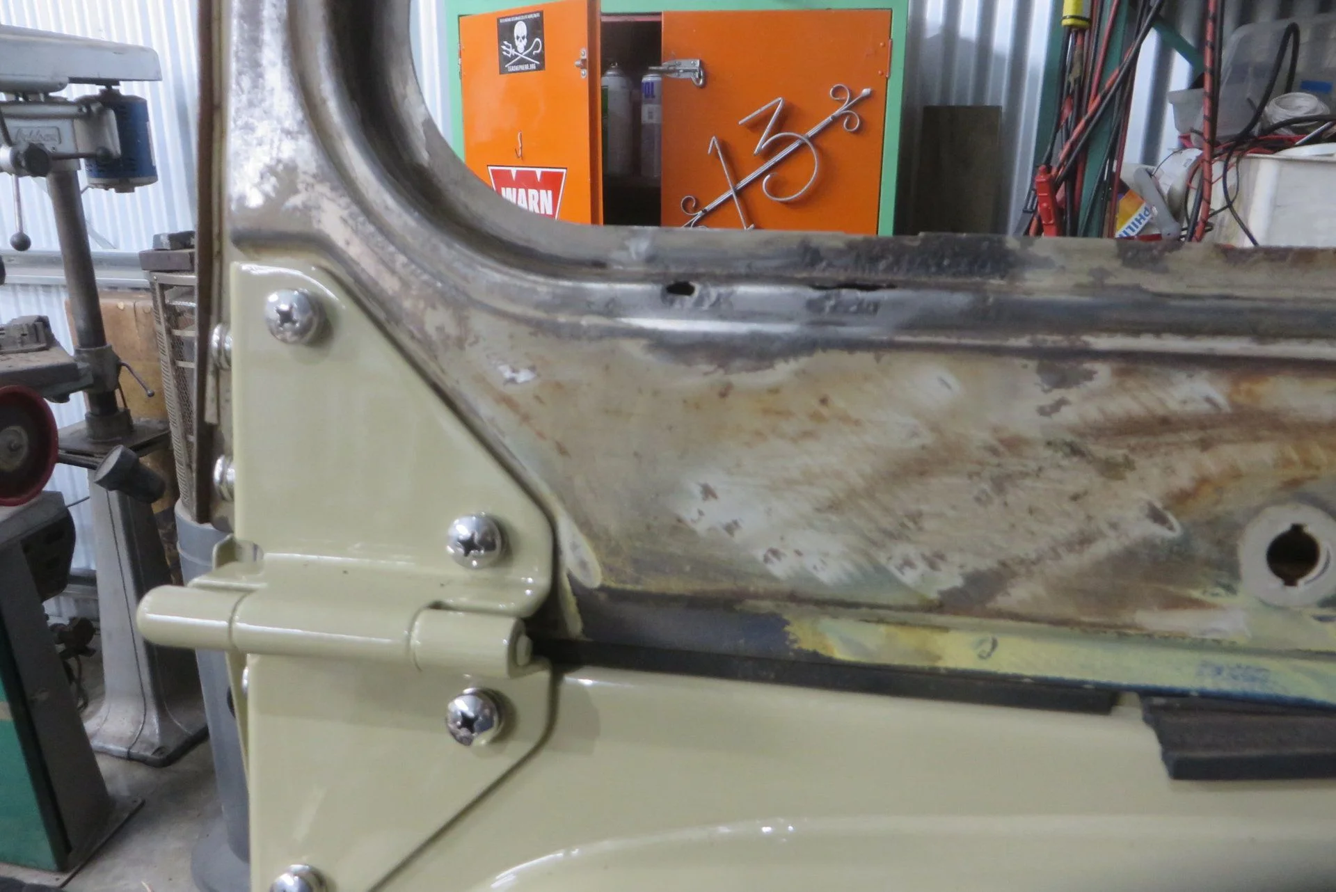

Rooted Windscreen Panel 2: Enter stage left. Windscreen panel 2, with 'surface rust'.

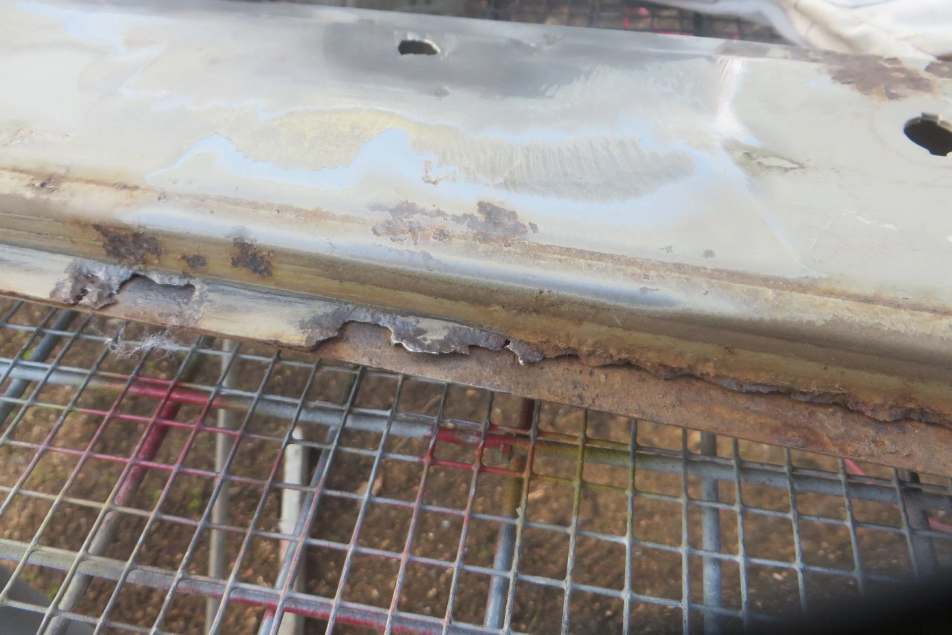

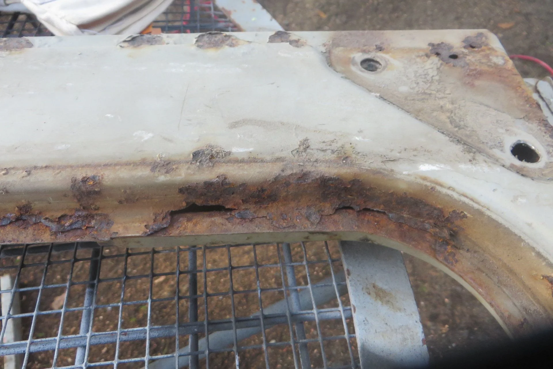

Things were looking very promising. That was until I removed the glass and the rubber seal and the cover over the windscreen wiper motor. Damn and blast, rust as far as the eye could see.

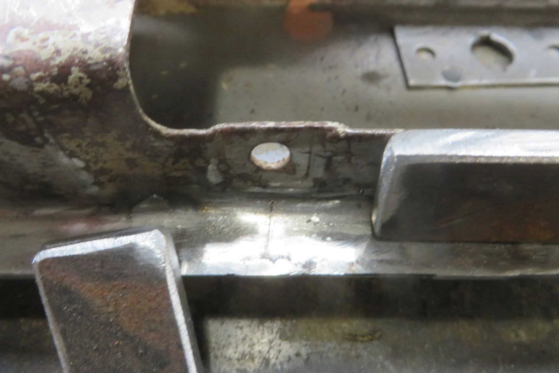

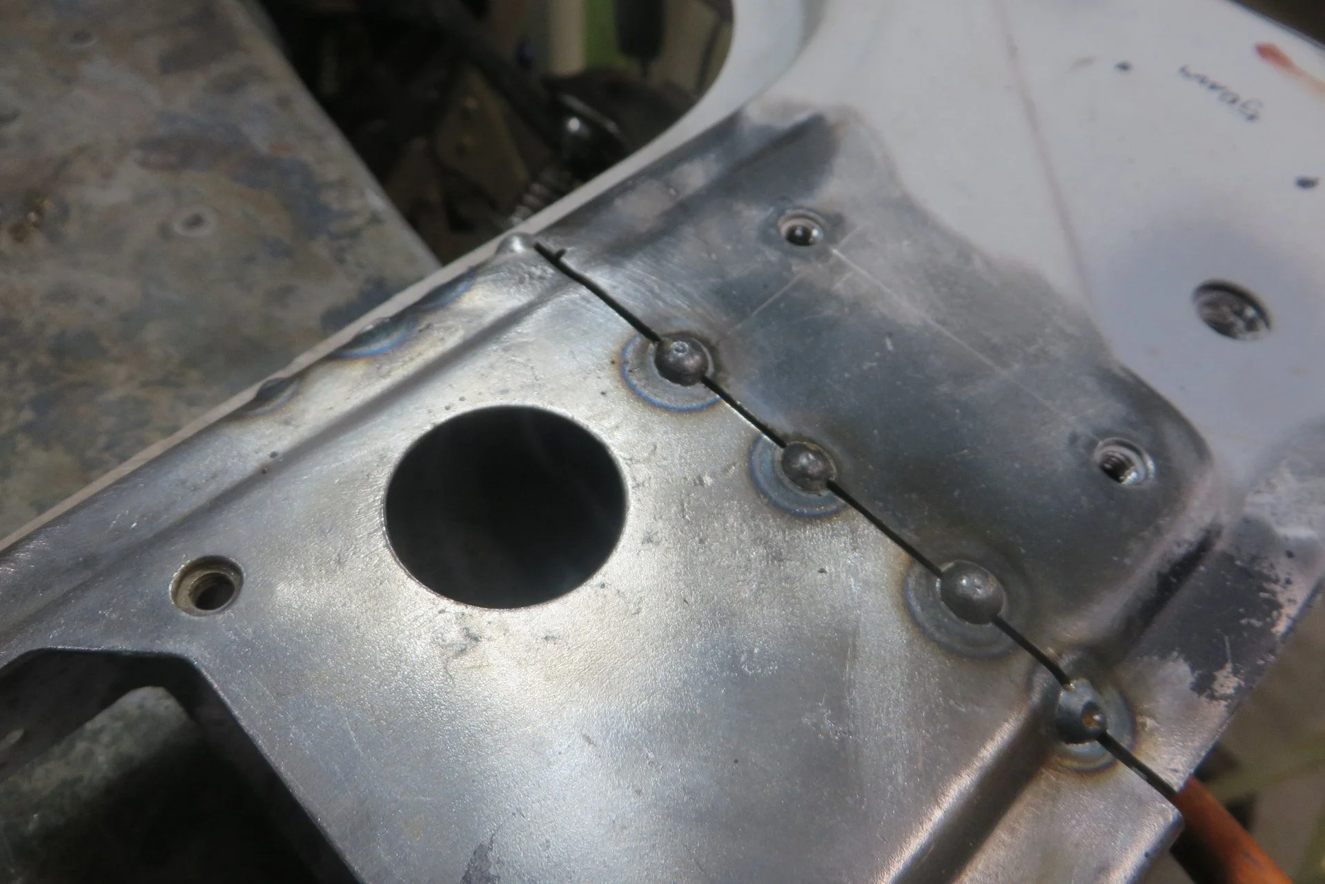

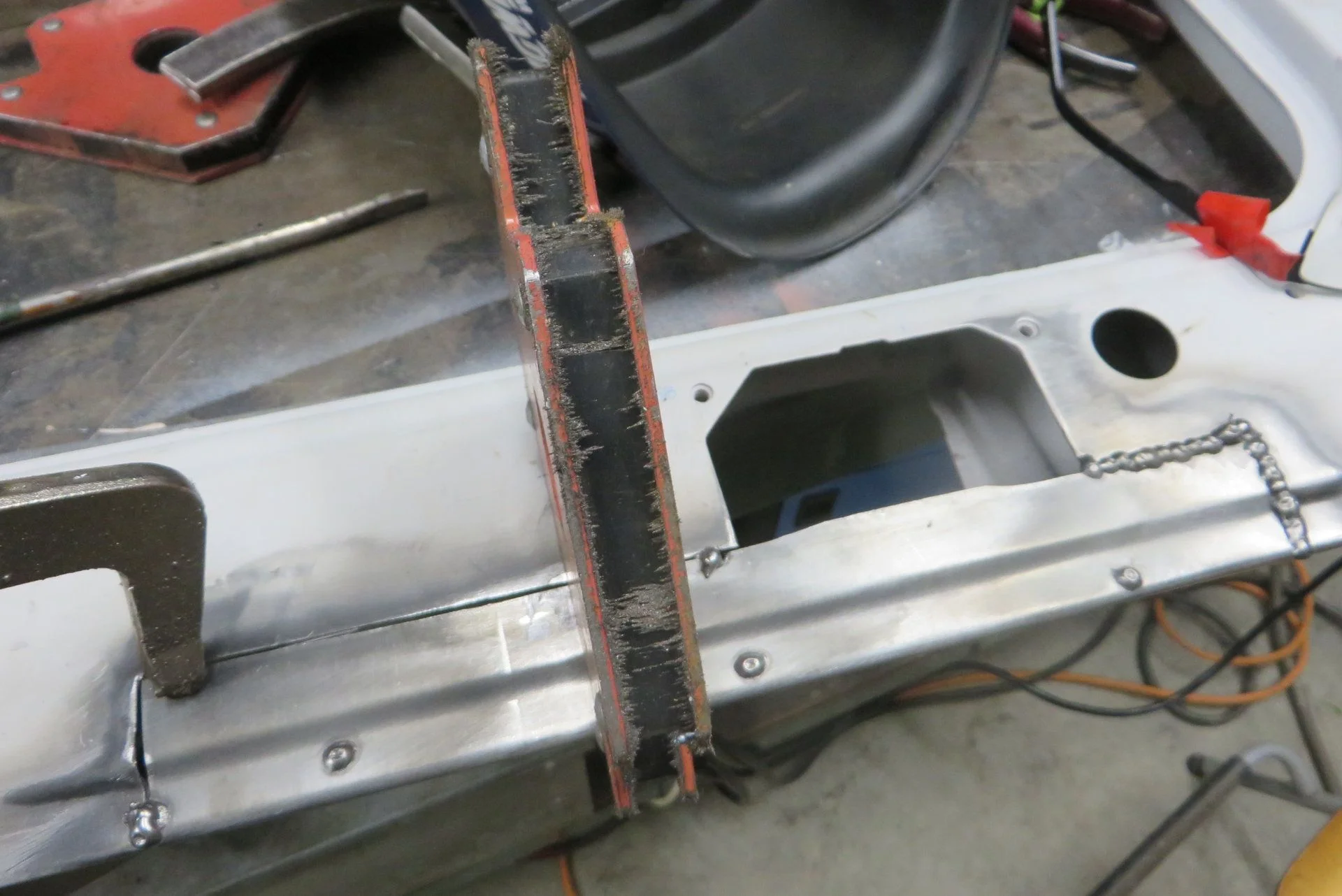

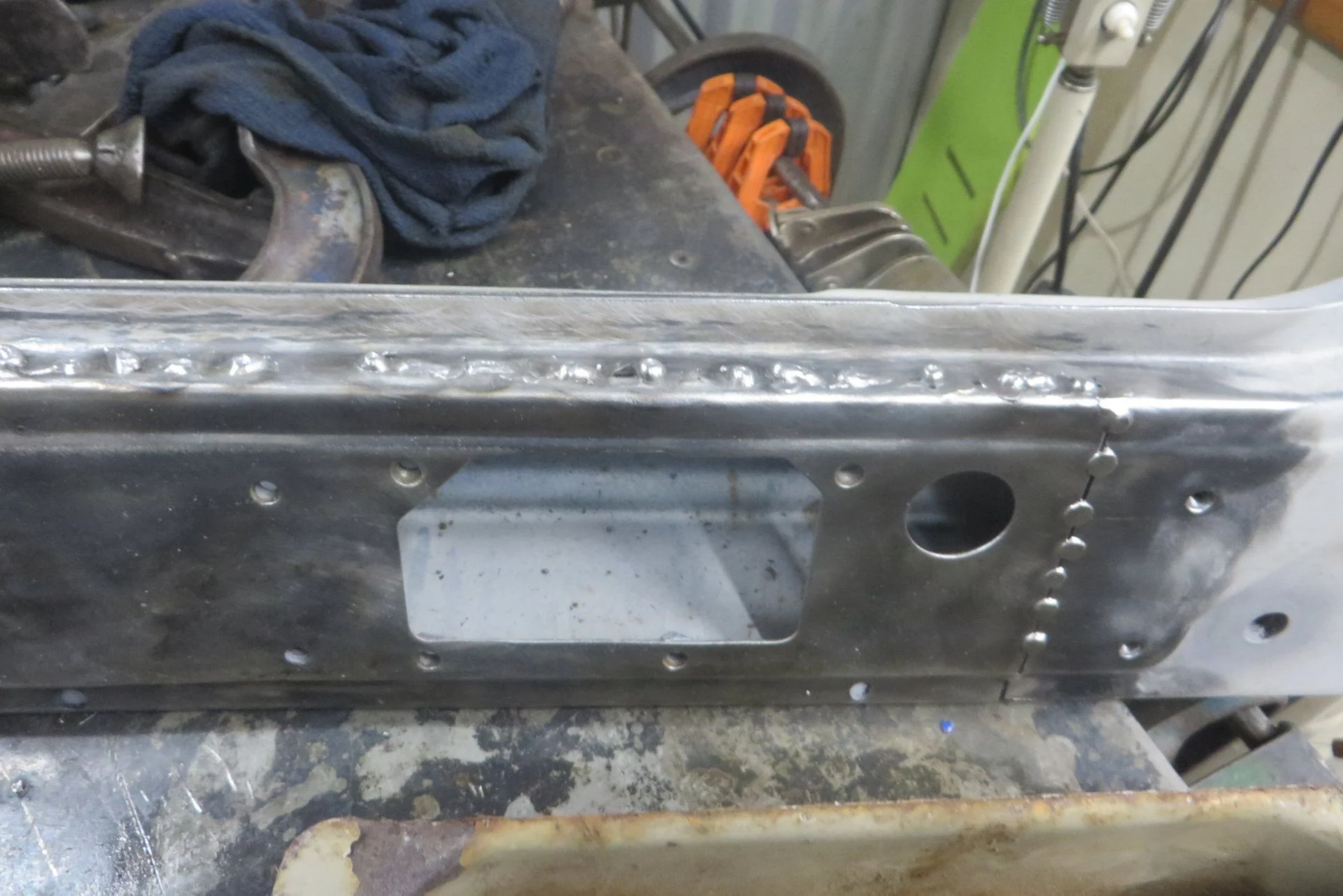

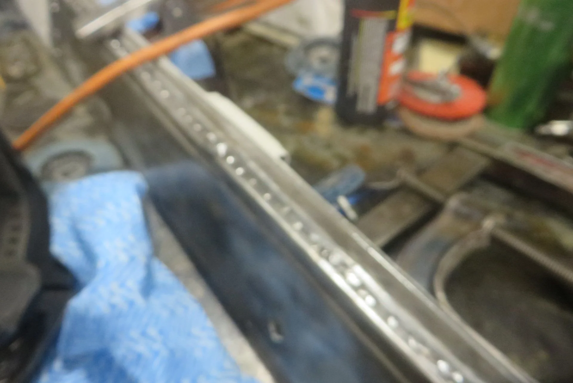

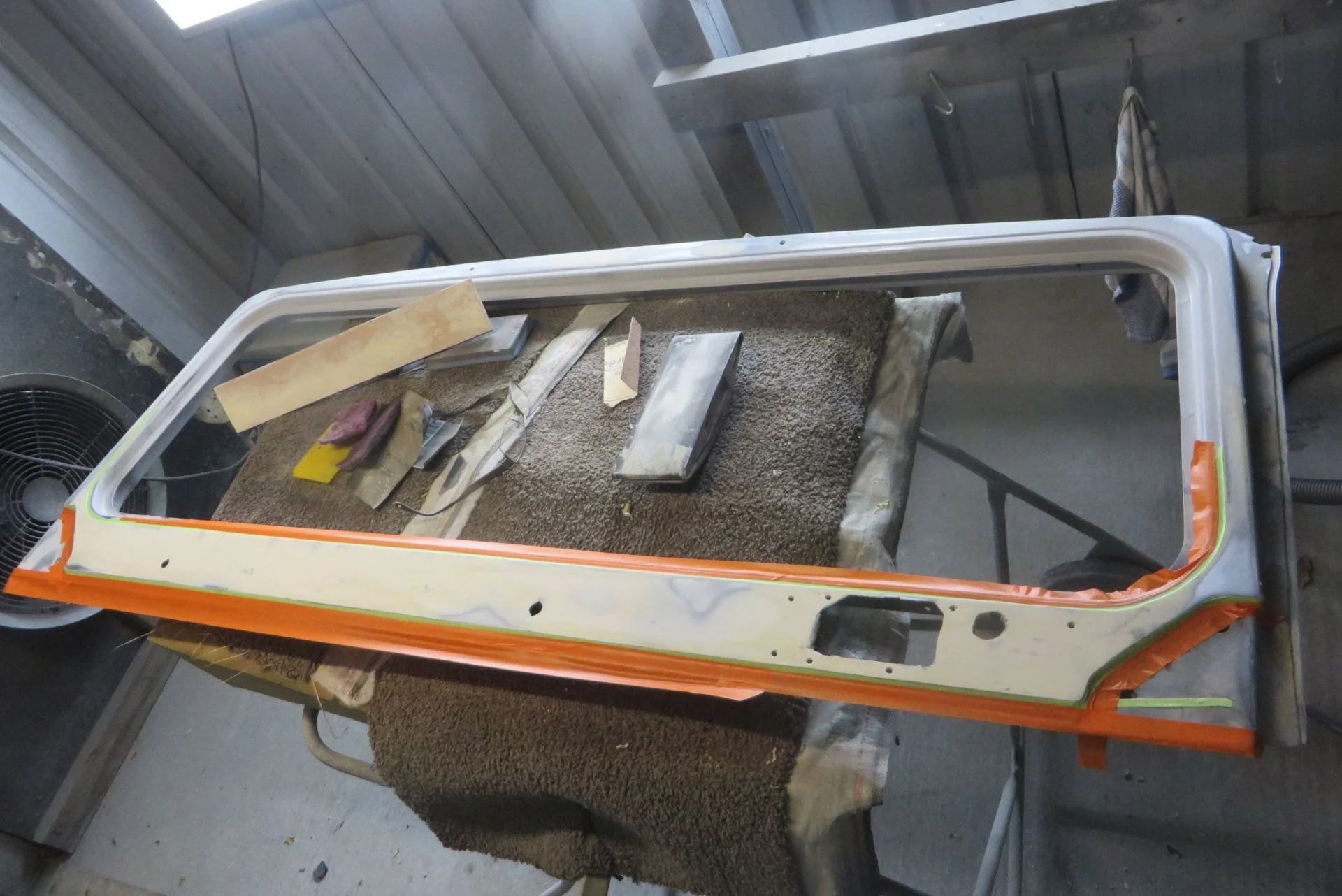

So after a moment of quiet contemplation, I came up with an ingenious solution. I would cut out the front of the new panel and stitch weld it onto the original panel. This seemed like a pretty straight forward plan...............what could possibly go wrong?

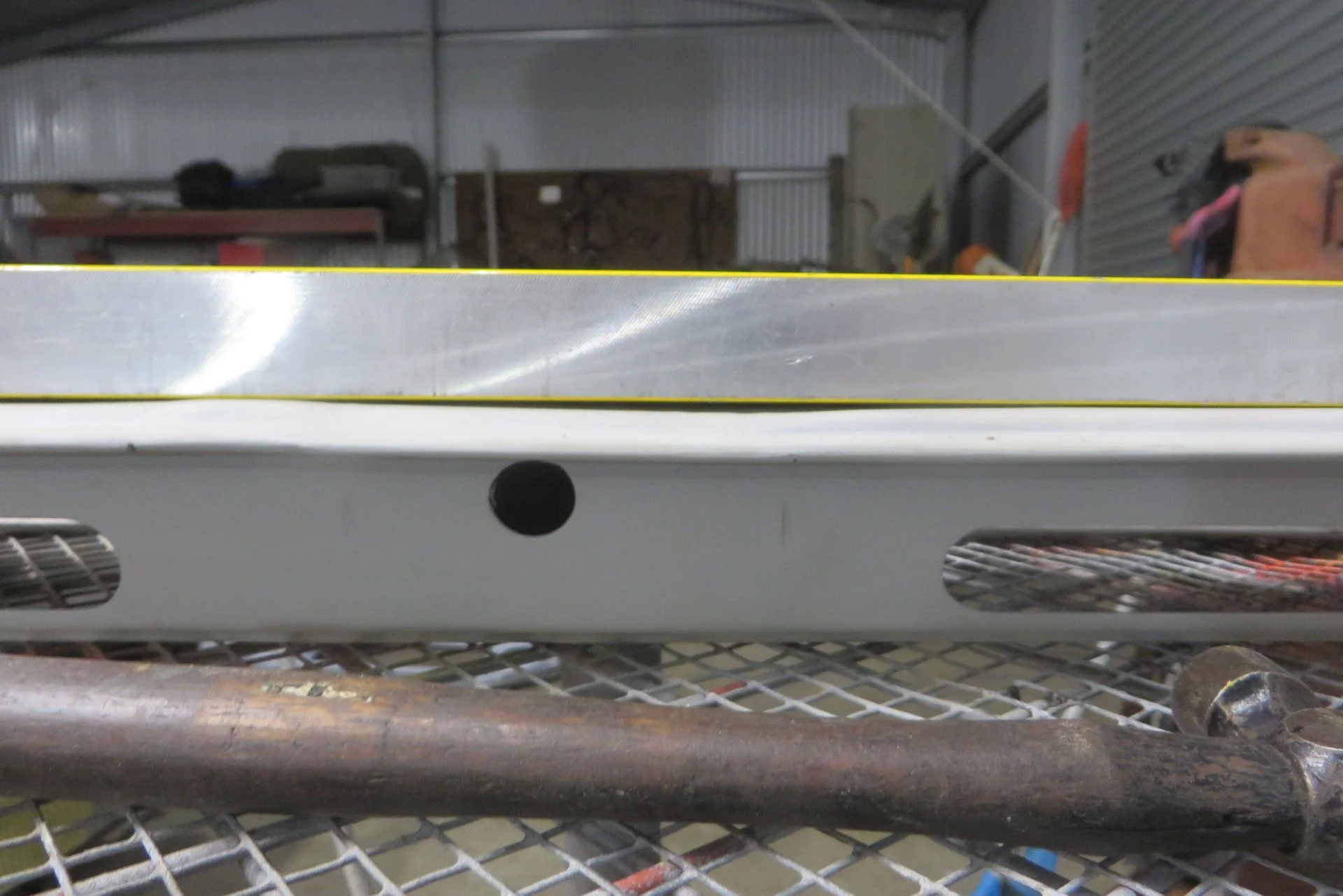

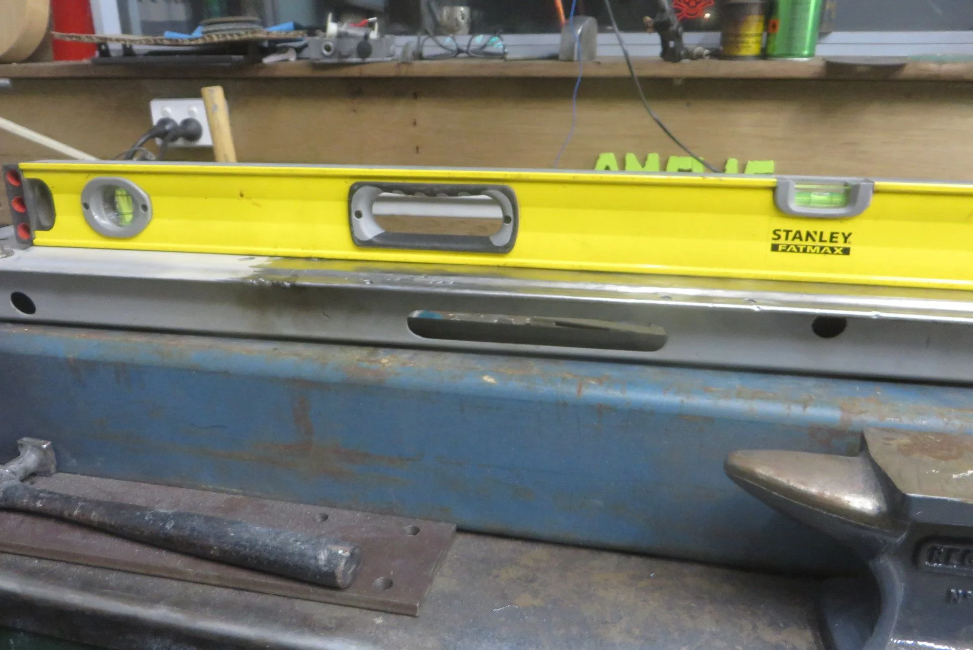

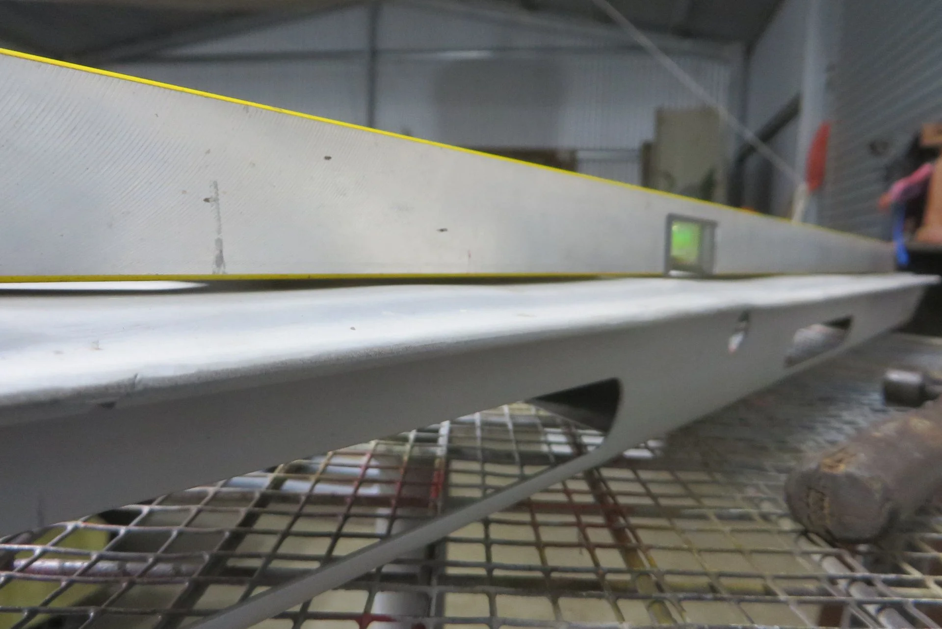

So, I took my time and slowly stitch welded the two panels together and then hoped into it with the grinder and cleaned up the welds. At this point I heard the panel creak. Like an audible groan. Sure enough the whole panel bowed. It's hard to pick up on the final image, but there is a 5mm bow across the front of the panel. I test fitted it to the cab hoping that the once bolted into place the bow would disappear but it didn't. Bugger me.

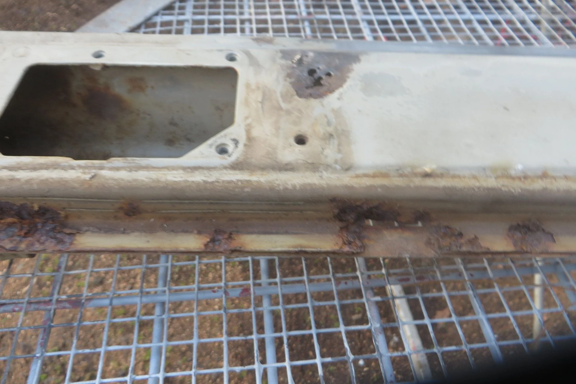

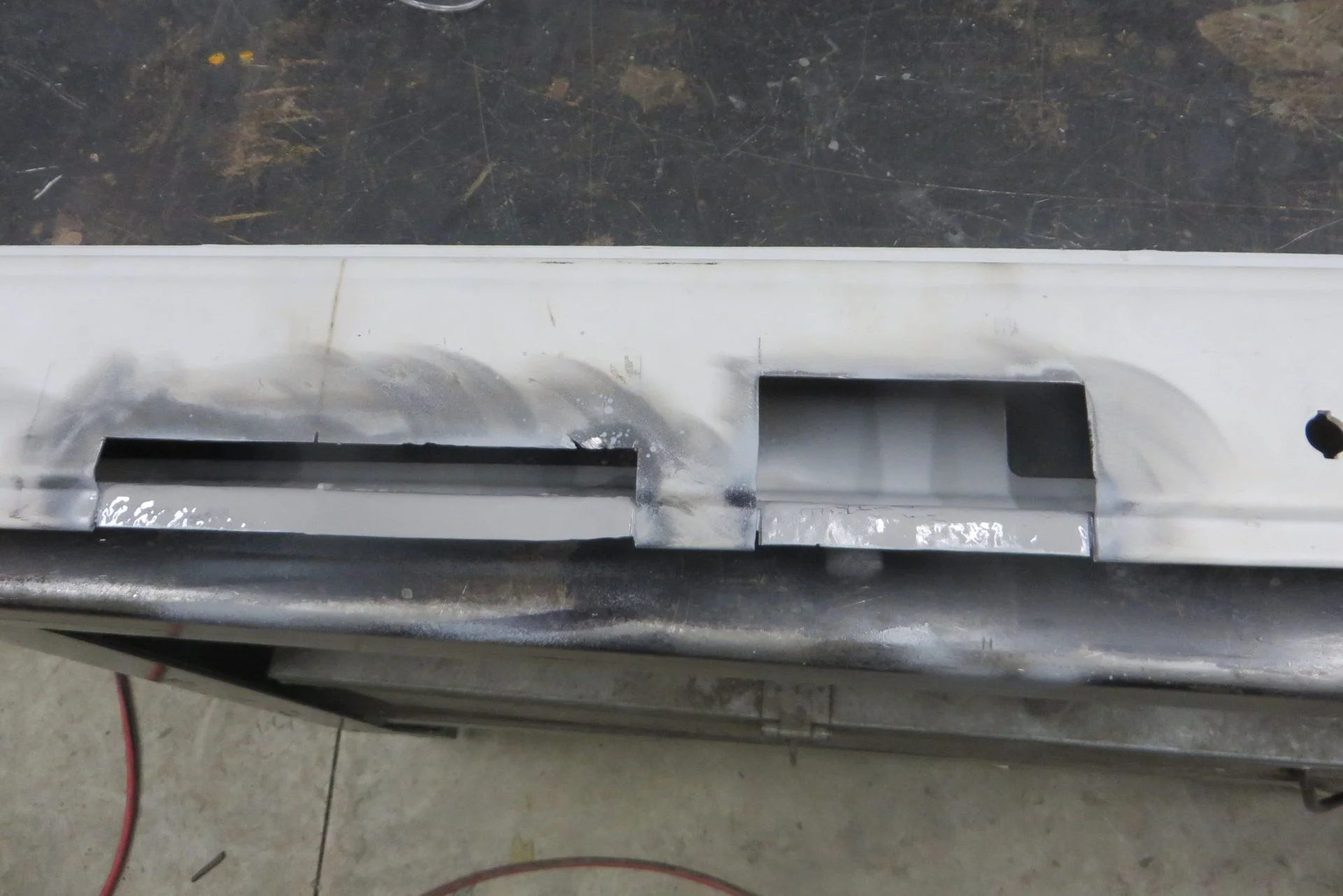

Rooted Windscreen Panel 3: At this stage, I picked up my third windscreen. It had a few issues and some 'surface rust' . Once again when I removed the glass and the rubber seal more rust. What's more, I didn't realise it at the time but the third windscreen panel was from an earlier model (more on this later).

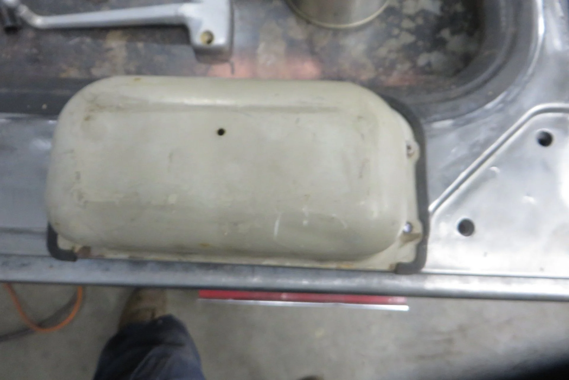

Windscreen Panels Difference Between Years: I was of the impression that the only difference in years was the earlier model (1903 to 1974) had the windscreen motor mounted at the top rather than the bottom. However it seems there are differences between the '75 and '81 and late '81 to 84.

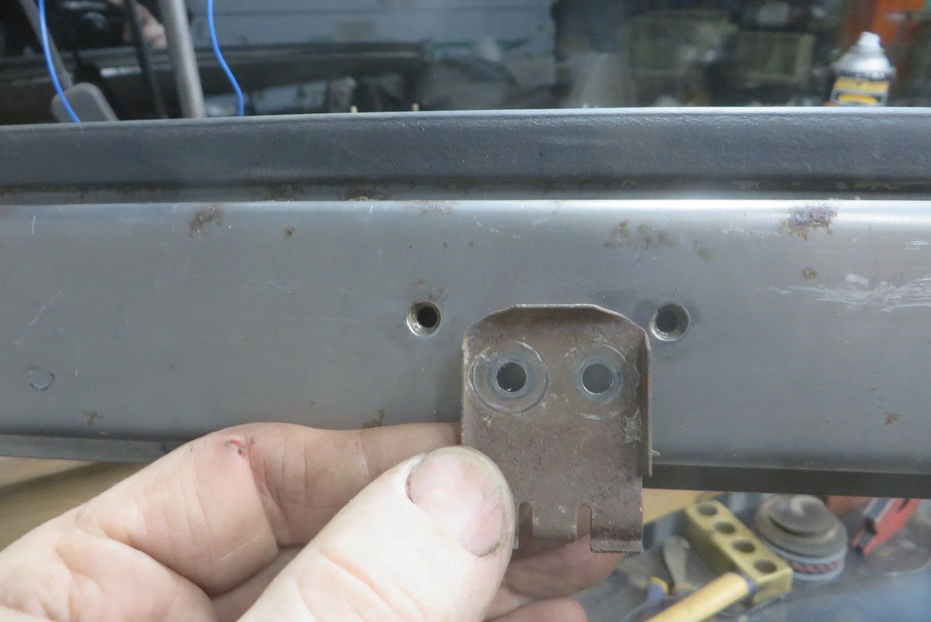

1. The windscreen motor cover holes do not line up. The cover from the 81 to 84 is longer.
2. The holes for the rear view mirrors do not line up. The holes for the 81 to 84 are narrower.
3. There are little recesses for the dempster vents on the earlier model that a not present on the later model.
I apologise if I have made an error with the manufacturing dates above. Please let me know if I have screwed this up. Also, if anyone is aware of any other differences please let me know.

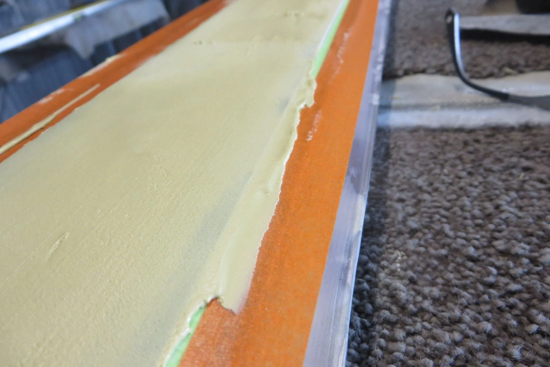

I haven't been following this thread nearly as closely as I should. You're doing beautiful work Ben! I really like your trick with using tape to create crisp edges on your seam sealer. I'm definitely going to employ that going forward on my own builds.
Do those edges need to be sanded or something to make them flush with the painted surface or do you just leave the little ledge in place?
Yeah, meant to say in my last post great work despite the frustrations. If you want some more of that rust thingy there's still opportunities here in Idaho!
I've always just used a damp finger to "smooth" it out like I do caulking trim. Though I like Ben's method better it looks much more precise.

I actually picked up the 'tape/seam sealer' idea from some other threads on Mud. Occasionally, you get a small lip along the edge of the tape. But you can use an 'art' brush and some solvent to flatten it out. When I look at the job on the cab, the one thing I would do again is re-do some of the seam sealer that I did and made a bit of a mess of..........a wet finger will also do the trick.
