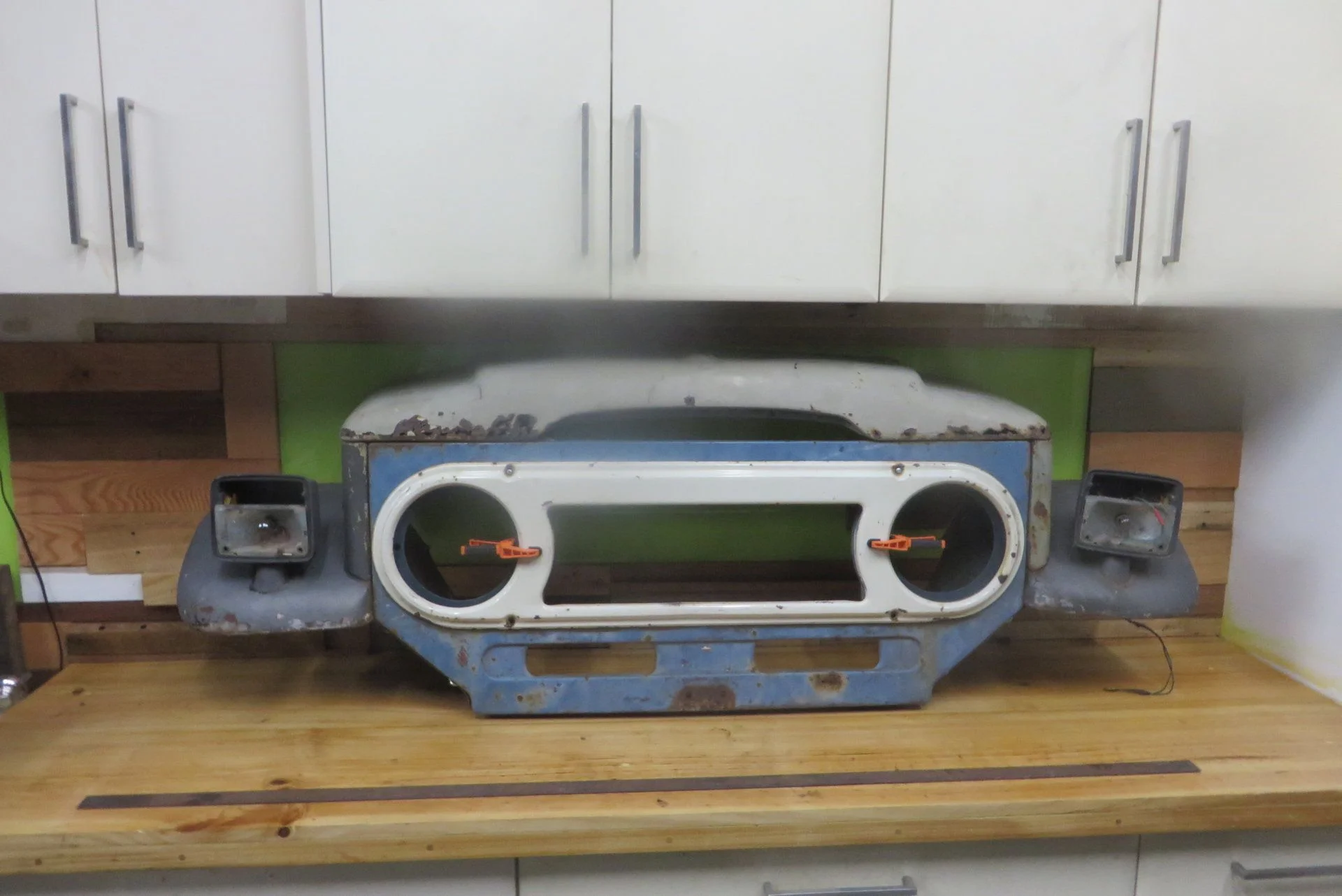

And before anyone accuses me of the heinous and wilful destruction of rare and precious antiquities. The front end bits were beyond repair, toast, cactus, stuffed, knackered and had the dick! Anyway, my wife requested a book shelf for our 10 year old son, so I thought I might include a bit of LandCruiser wall art into the build. More on this later.

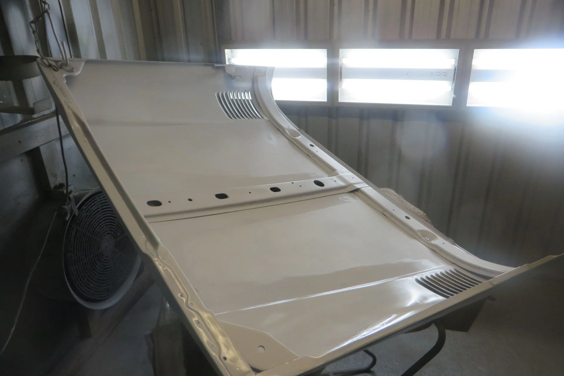

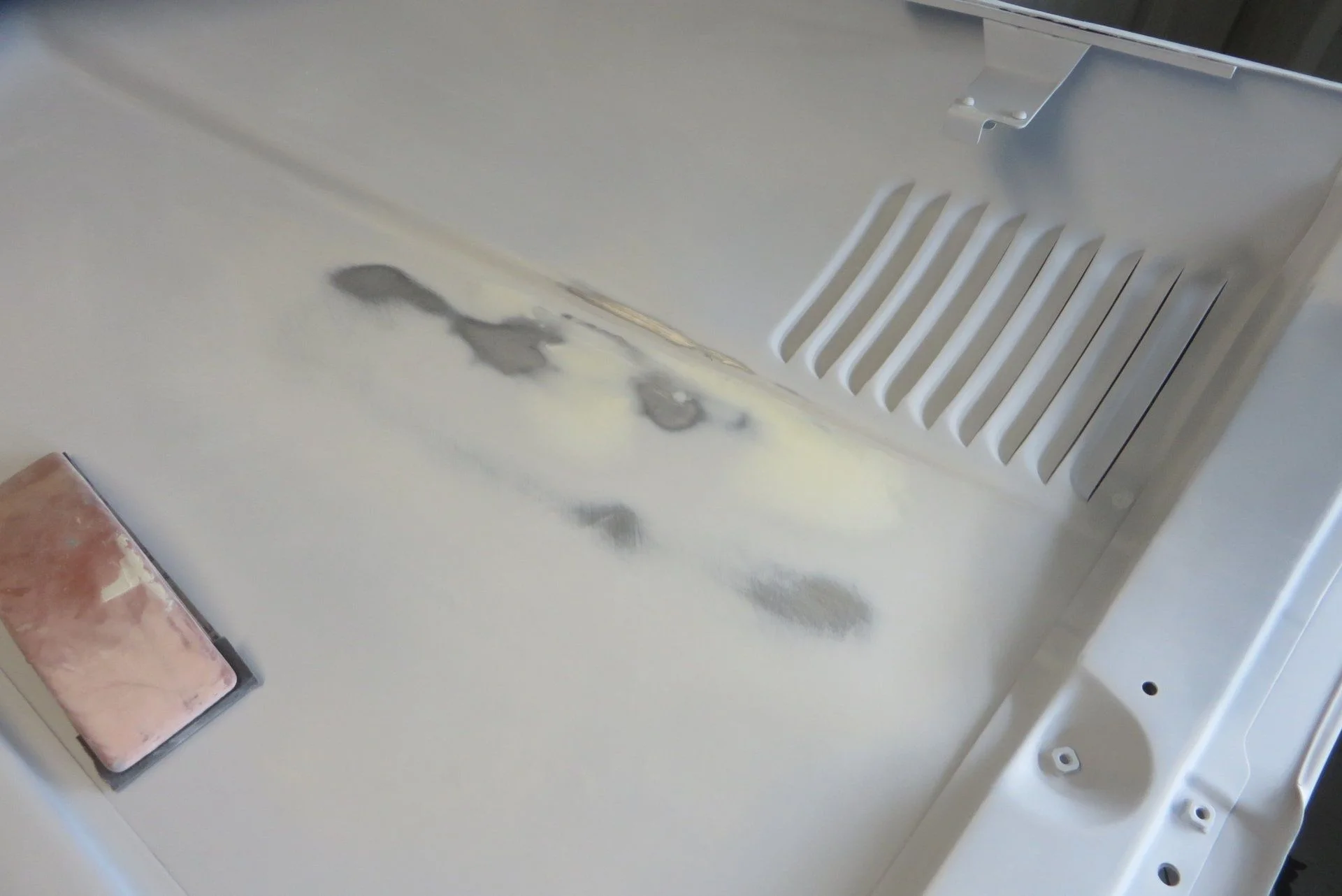

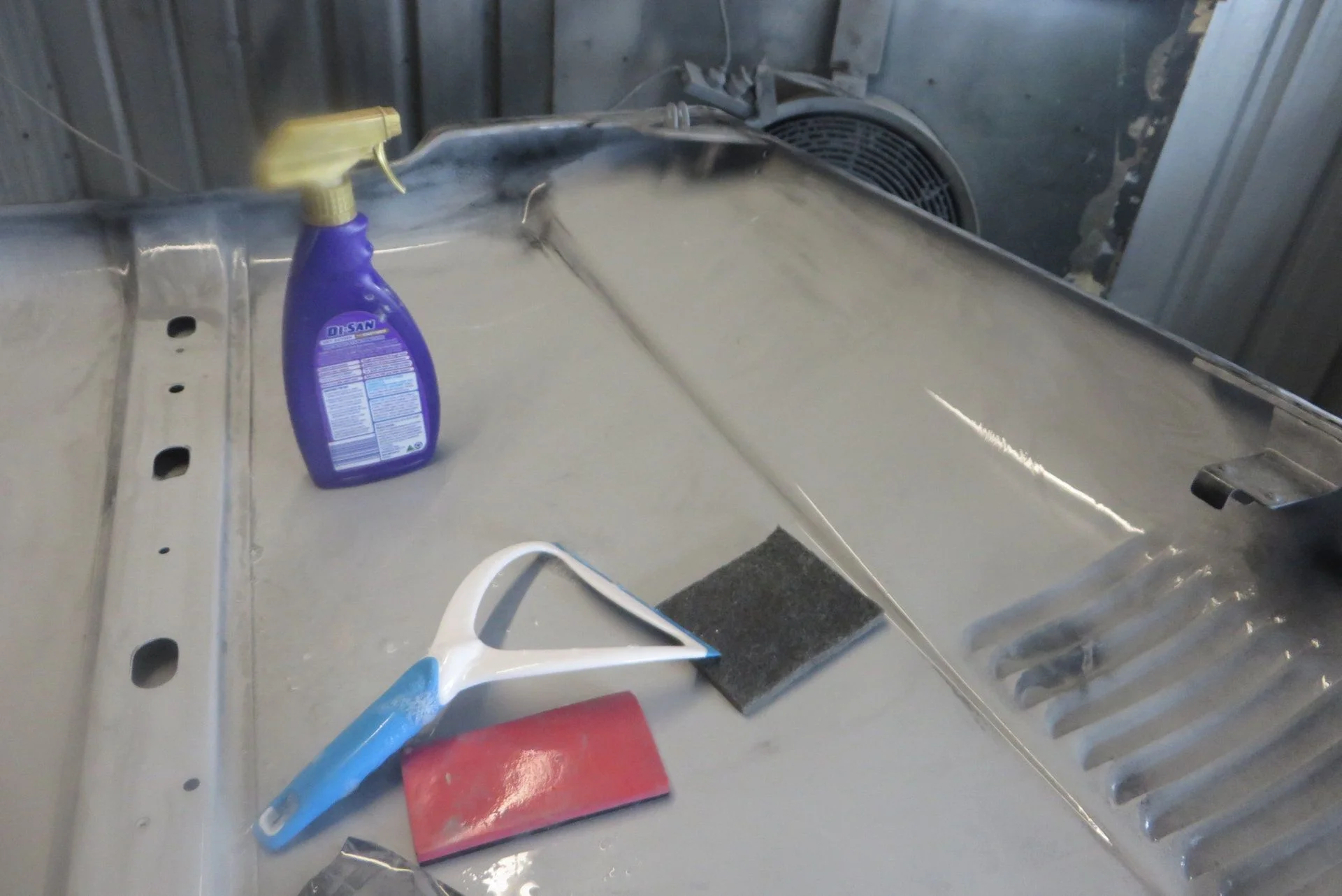

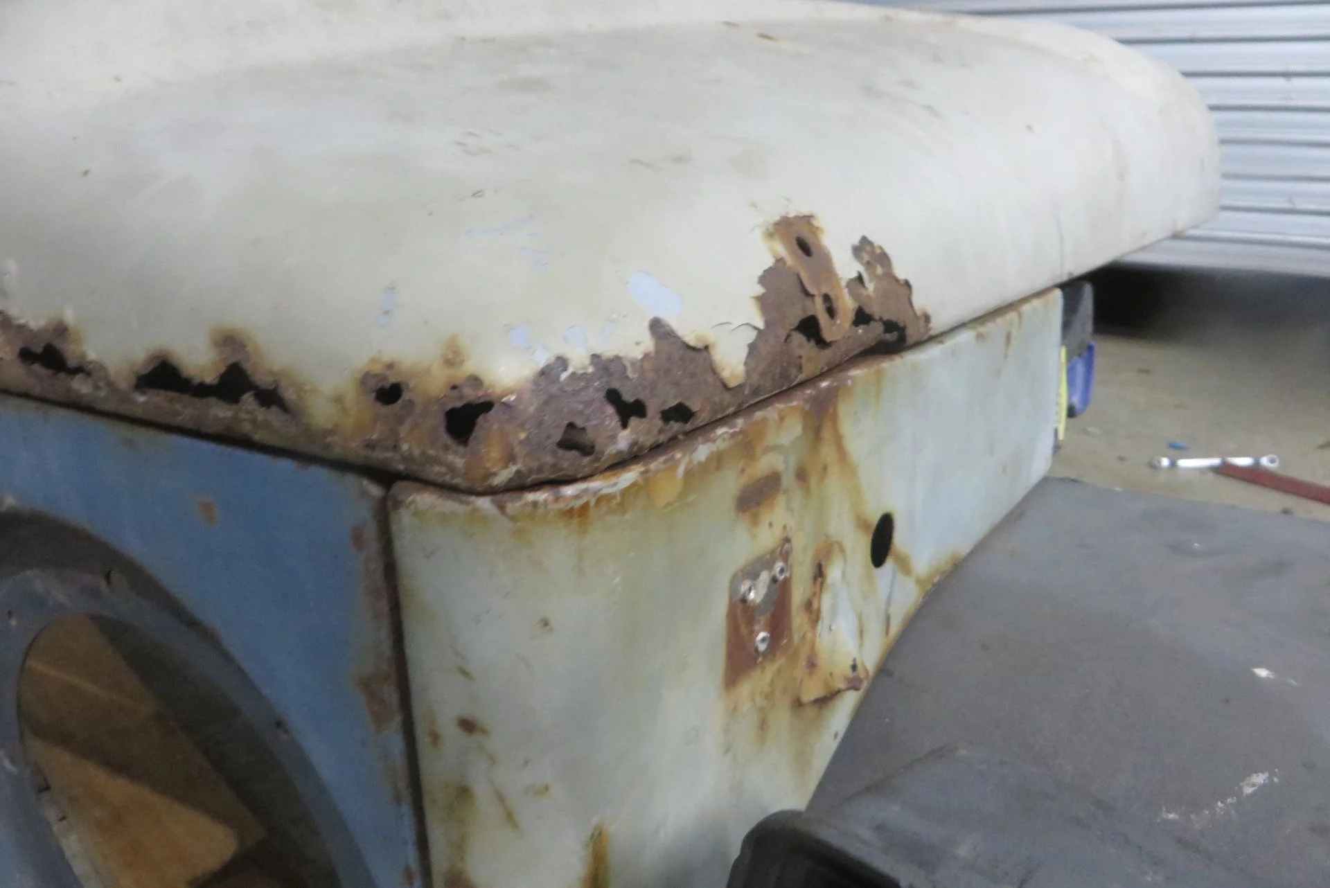

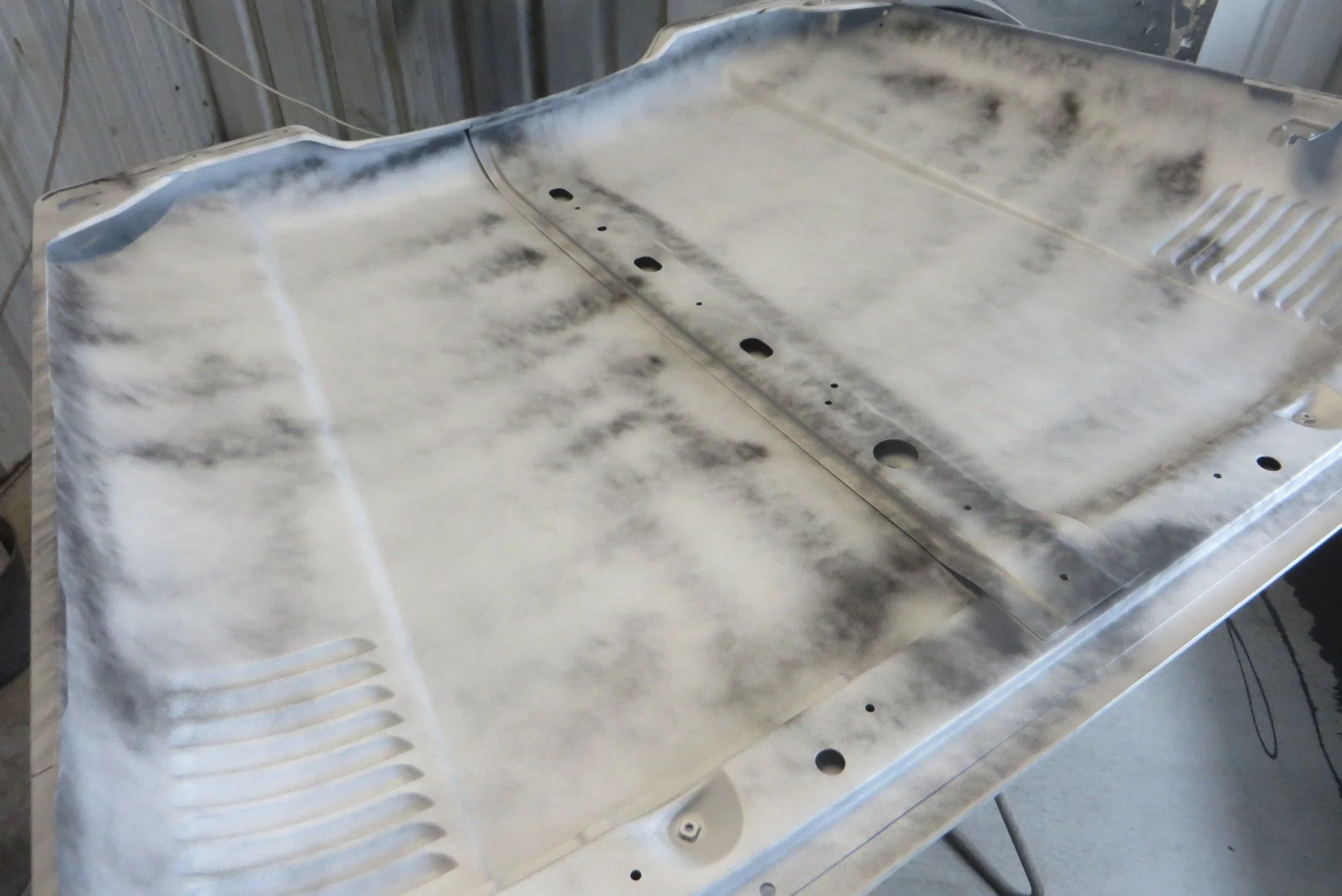

Now for a update on Mario. I moved operations into the little shed that I use for paint. I noticed the bonnet (I mean hood) had a large warp in it above the manifold. I assume over the years the heat caused it to bulge up. I tried to disguise it by spreading a thin layer of filler around it, but it was too obvious. Anyway, I wasn't confident enough to hammer and dolly it myself and took it down to my local panel shop. The warp is gone and I now back to wet sanding. I thought I wet sand underneath first and fill a couple of hammer and dolly marks.

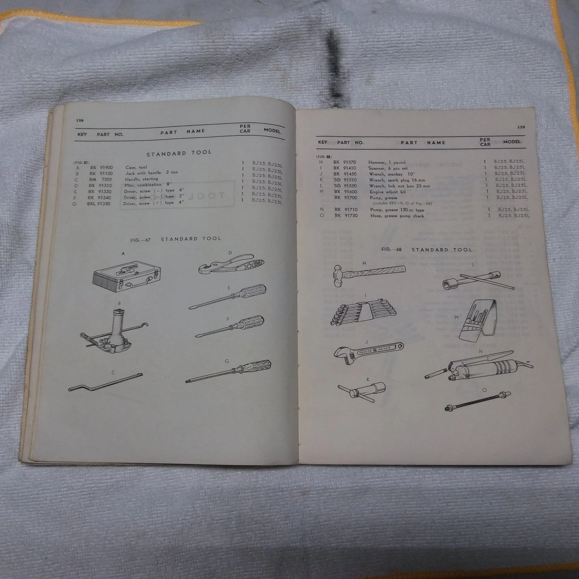

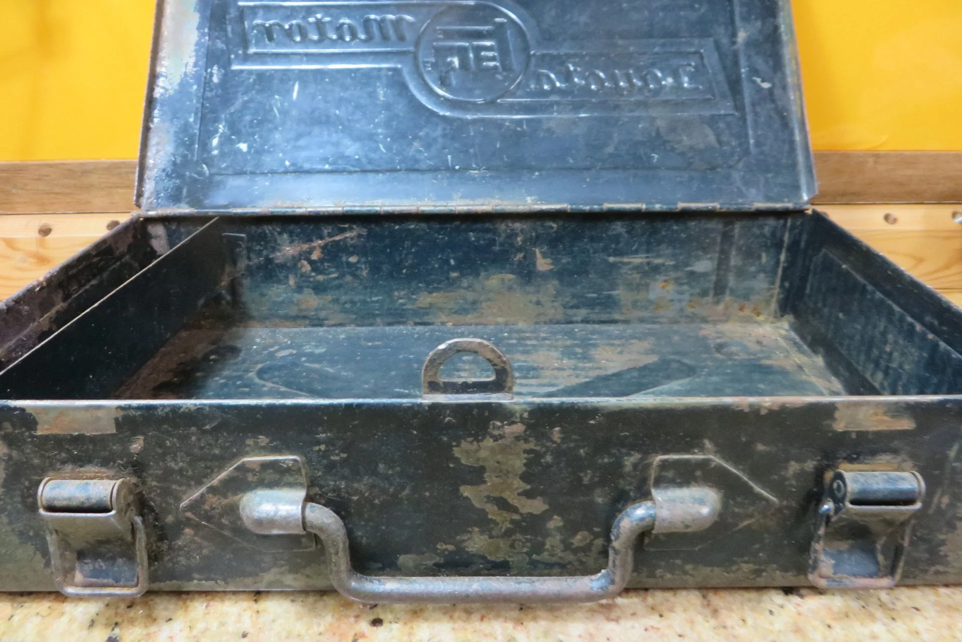

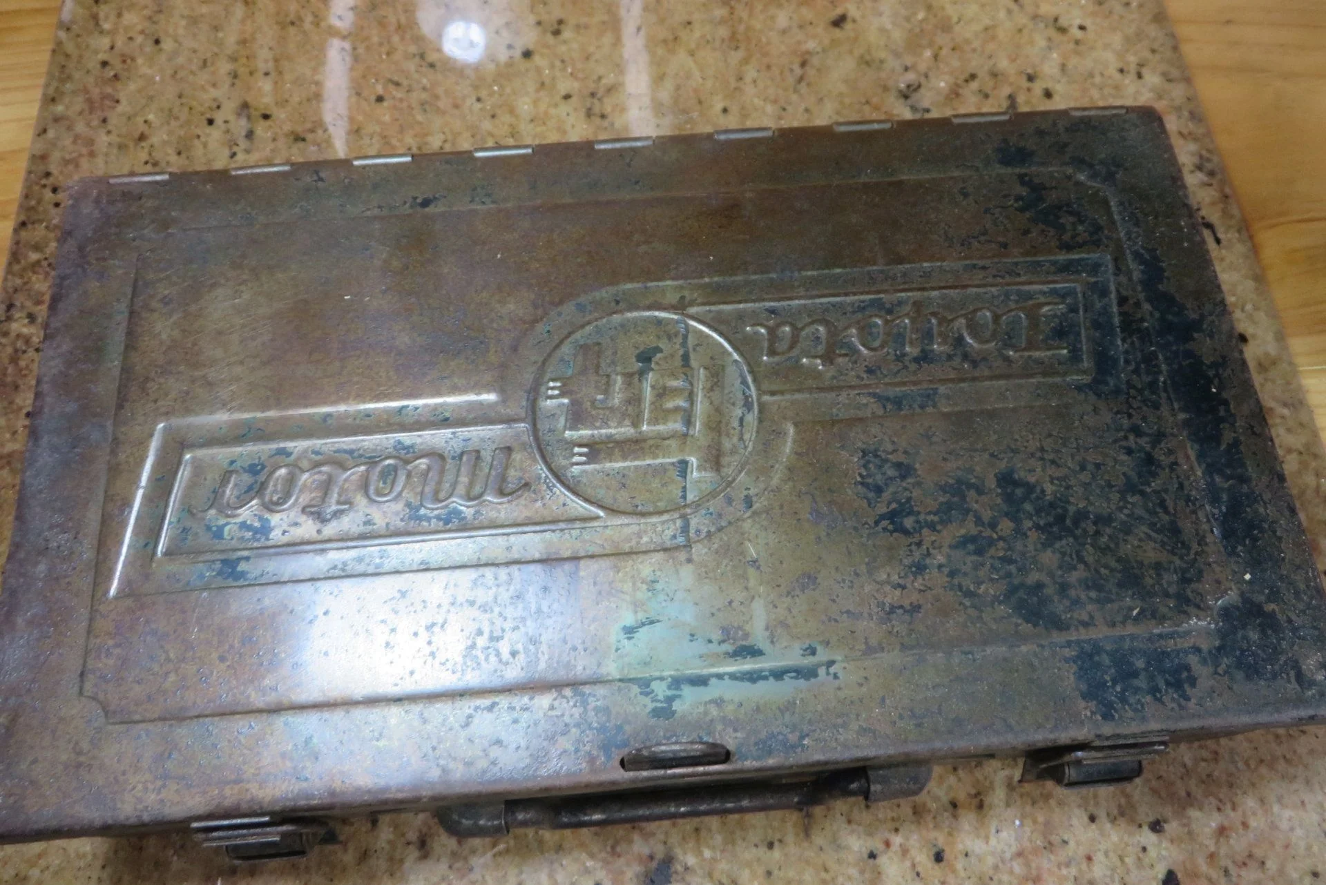

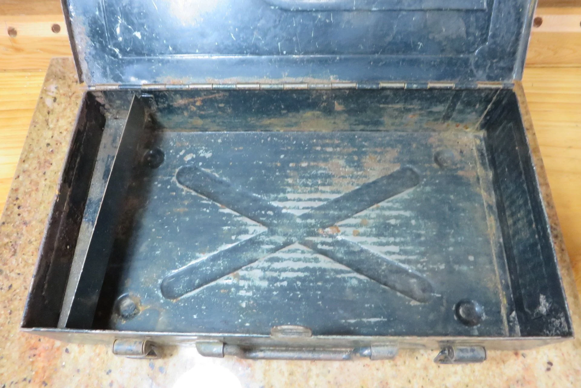

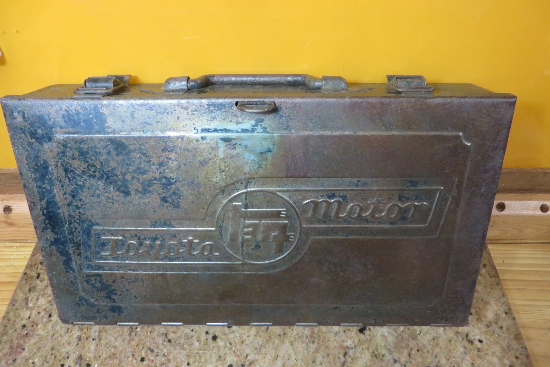

Those boxes are awesome. I'm in the school of thought that every Land Cruiser should have one, no matter what the year. They were made from at least 1956 to 1969. Here's a tool page from a 1956 BJ25 parts catalog that shows the box. I couldn't tell you if it was made any earlier than that. They were never included in Land Cruisers destined to the US either. They were also included in other non-LC Toyota models like the Stout and big DA trucks. Now ya gotta fill it up with Toyota tools!

G'day Dmamj, Thanks so much for going to that effort. I really appreciate it. That's the aim then, assemble the complete tool kit as per your diagram. It's in remarkable condition in some regards, the steel seems almost polished (Note - I couldn't bring myself to use the word 'patina'). I might give it a wipe over with some boiled linseed oil. Thanks again, Ben
I have a lot old cans , tools and boxes... all I did wiped the dust off.
Would never use any oil or similar products on them.
Have had an old 50`s first aid box similar to this ....
in the 45 ,used it for tools stored under the driver seat for 12 years...
All I did wiped the dust off
.... they last longer than you and me even without using boiled linseed oil, Sir.
