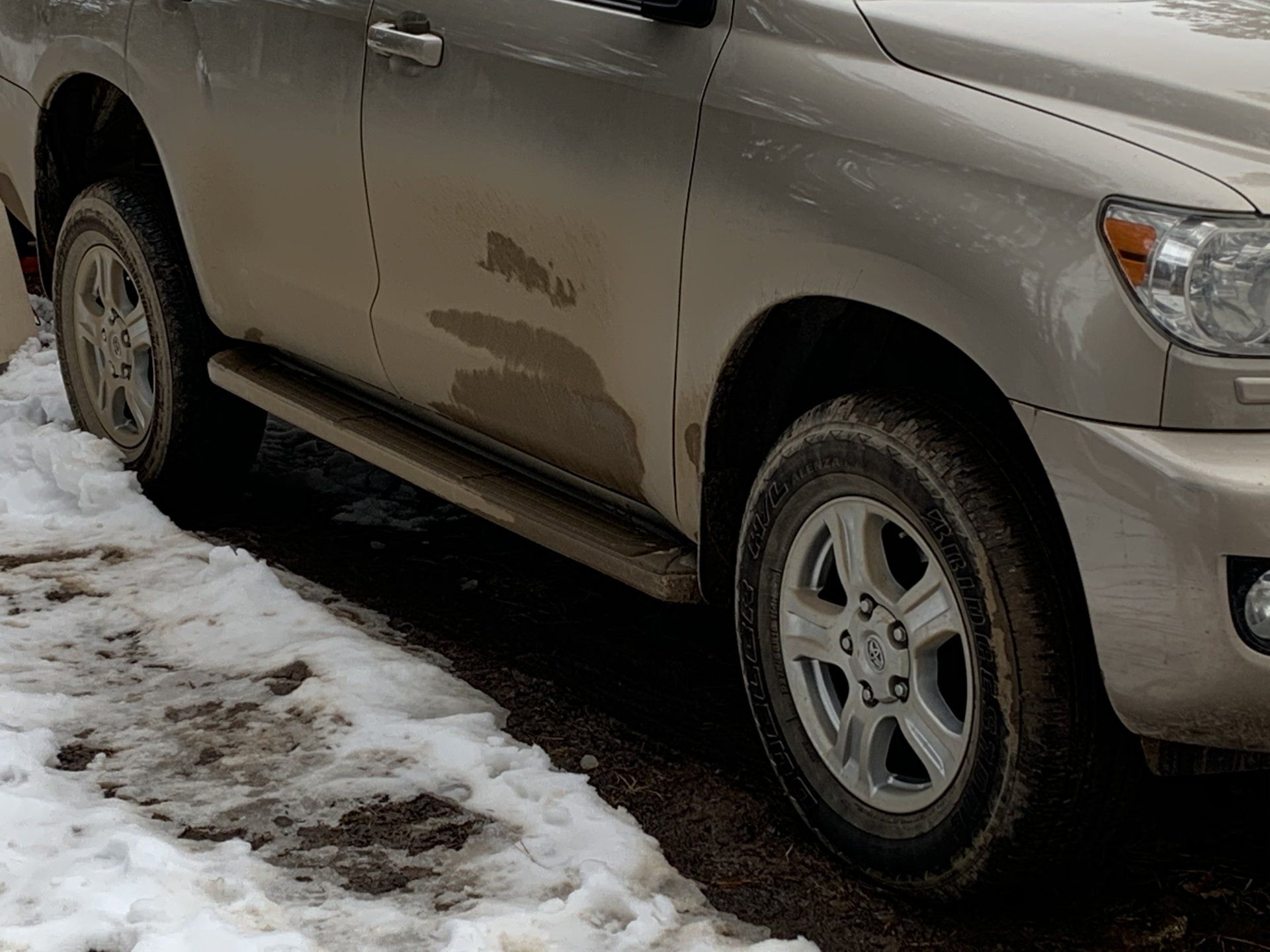

Posted are a few pictures of the exterior in chronological order.
View attachment 1275898 View attachment 1275901 View attachment 1275907 View attachment 1275911
