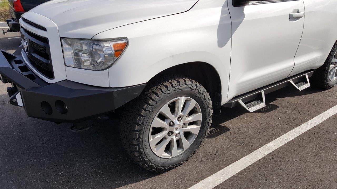

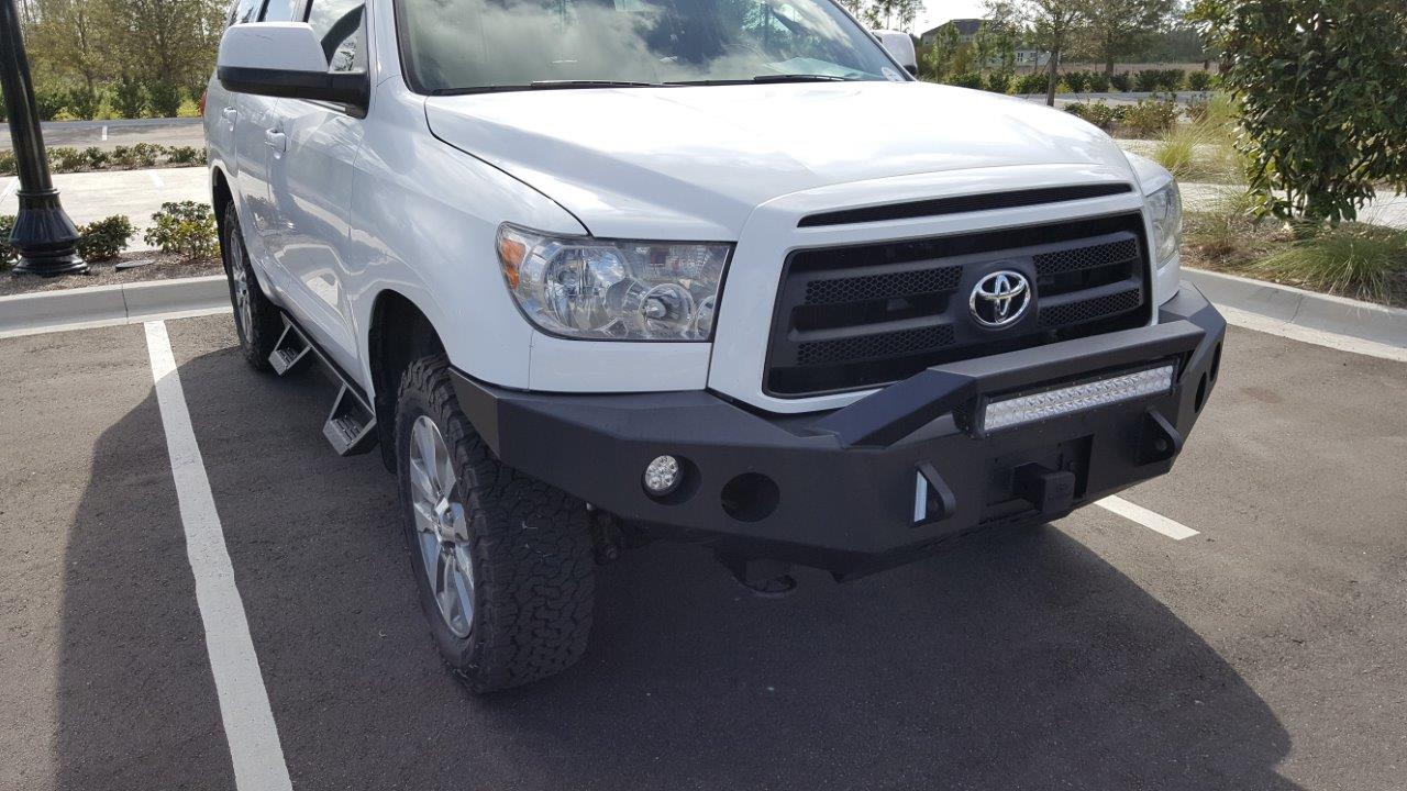

A few more photos. One showing how handy the front hitch on this bumper is and a few with new shoes. BFG AT- K02 - 275-60-20. I was debating between these and 275/65/20 and I'm glad I went with the 60s. Not bad on noise or ride - I can definitely hear the tires but the ride is nice and smooth up to highway speeds. I also ordered a couple of the spot lights from Magnum that fit into their bumper and wired them to the factory fog light switch. The only negative with that is I can't turn the spots on with the brights. I'll probably wire to a new switch, or to my LED bar switch, when I add two more. No more mods for me, at least nothing planned :). Thanks again for the original post Mo.

Your Sequoia is looking awesome! I have never even thought about using the front hitch like that. It's good to be innovative.

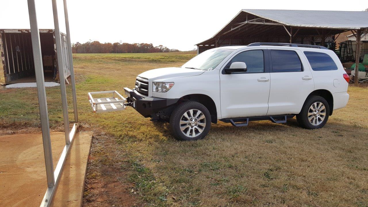

I added a D ring hitch receiver mount made by Smittybult. I spray painted it matte black and added some Daystar D ring isolators painted to match my front bumper D rings.

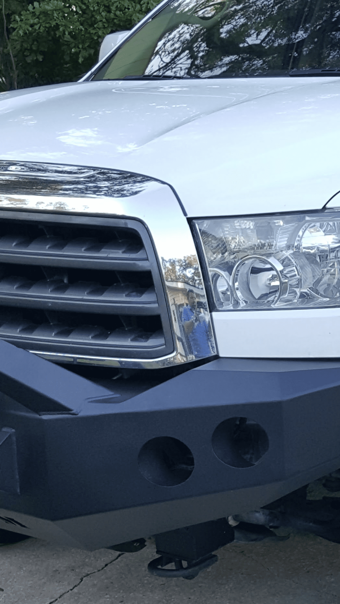

Yes, sequoia grille is a bit shorter than Tundra grille and leaves a bit of a gap with a Tundra bumper. See attached photo of chrome sequoia grill over Tundra bumper.
Yes, sequoia grille is a bit shorter than Tundra grille and leaves a bit of a gap with a Tundra bumper. See attached photo of chrome sequoia grill over Tundra bumper. View attachment 1422547
Thanks Mike for the picture, it speaks for itself!
Nevertheless being repetitive, the Tundra grill is shaped differently than the Sequoia's grill and because it is shaped differently, the difference is especially noticeable when you install a Tundra designed bumper (as are most aftermarket bumpers that will fit a Sequoia). The hood with a Sequoia grill may still securely latch after a Tundra bumper is installed, I just never tried it. I knew when I bought the bumper, I'd replace the grill. I found a rock warrior grill for $150 new on Craigslist. By the way, I think any 07-13 Tundra grill should work, you don't have to get a rock warrior specific grill.

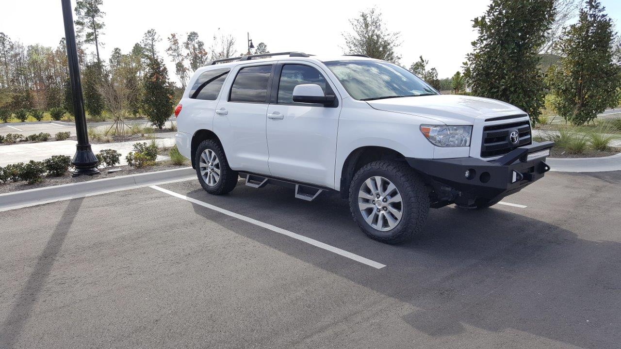

Suprisingly, the side steps are NOT made for a Supercrew Tundra, they are made for the Doublecab model. They do fit from front wheel well to back wheel well. If I remember correctly, there are four brackets per side, and the front three on each side fit perfectly. The final bracket on each side did not but I didn't rig a solution because I really didn't believe it presented a stability issue. I'm a big guy and I bounced around on the back step to test it without esperiencing any issues.
