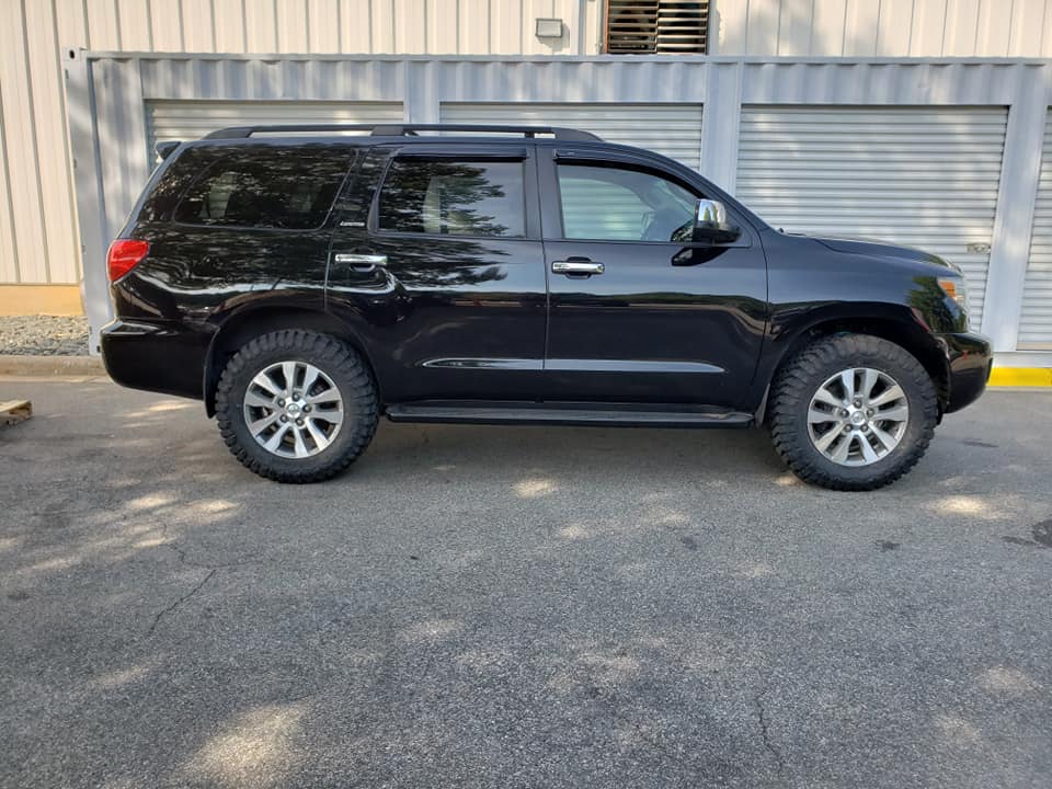

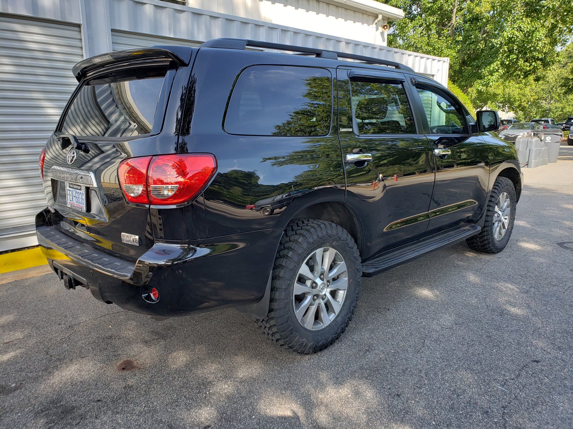

A few more photos. One showing how handy the front hitch on this bumper is and a few with new shoes. BFG AT- K02 - 275-60-20. I was debating between these and 275/65/20 and I'm glad I went with the 60s. Not bad on noise or ride - I can definitely hear the tires but the ride is nice and smooth up to highway speeds. I also ordered a couple of the spot lights from Magnum that fit into their bumper and wired them to the factory fog light switch. The only negative with that is I can't turn the spots on with the brights. I'll probably wire to a new switch, or to my LED bar switch, when I add two more. No more mods for me, at least nothing planned :). Thanks again for the original post Mo.

If the fogs goes through a relay, you can bend one of the tabs (forget which one) and it will keep the bright from turning off. Ive done this mod on a few other vehicles.
