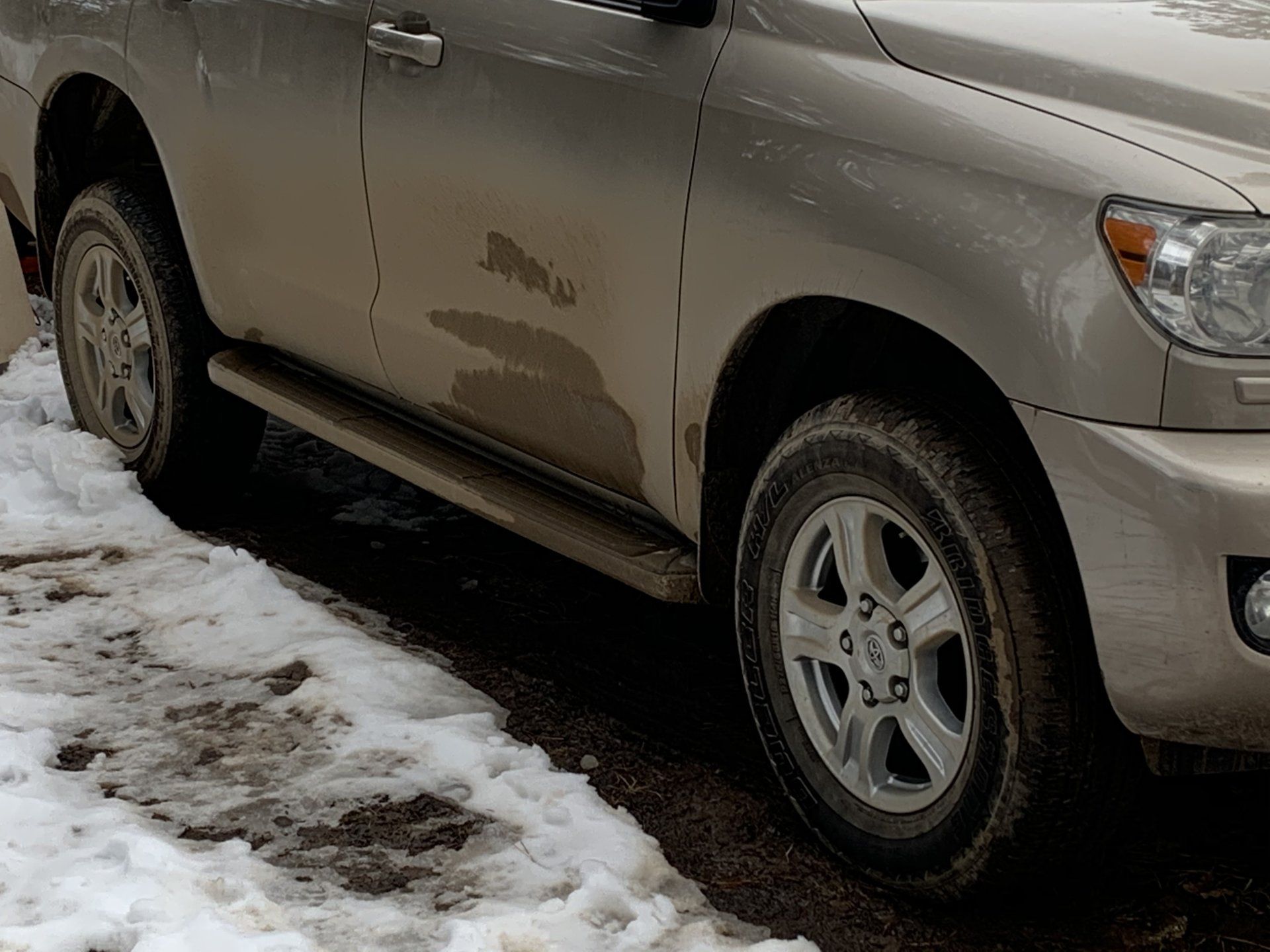

Your build thread is one of the few 2nd gen threads out there. It was here I saw @ADVFamilyHauler selling them. I just got an 08 SR5 same color as yours. Yours is way cooler looking. They are working out just fine but when
You get into it, as of now despite any kit you may see from Dobinsons, they do not have a rear shock that matches the sequoia. They themselves recommend the Bilstein 5100. Upon install the rake was rather huge and it could not be aligned. Dobinsons recommendation was to install, align,
Drive for two weeks for springs to settle, then align again. Turned out I was loading up heavy and towing a trailer to California the next day and the weight (I think) brought the “toe” into spec. I didn’t notice any abnormal wear the whole way out. I haven’t realigned it but probably will even though I think it looks ok now. The springs did settle a bunch and it looks way more normal. And yes I need beefier tires and am open to suggestions on size.
