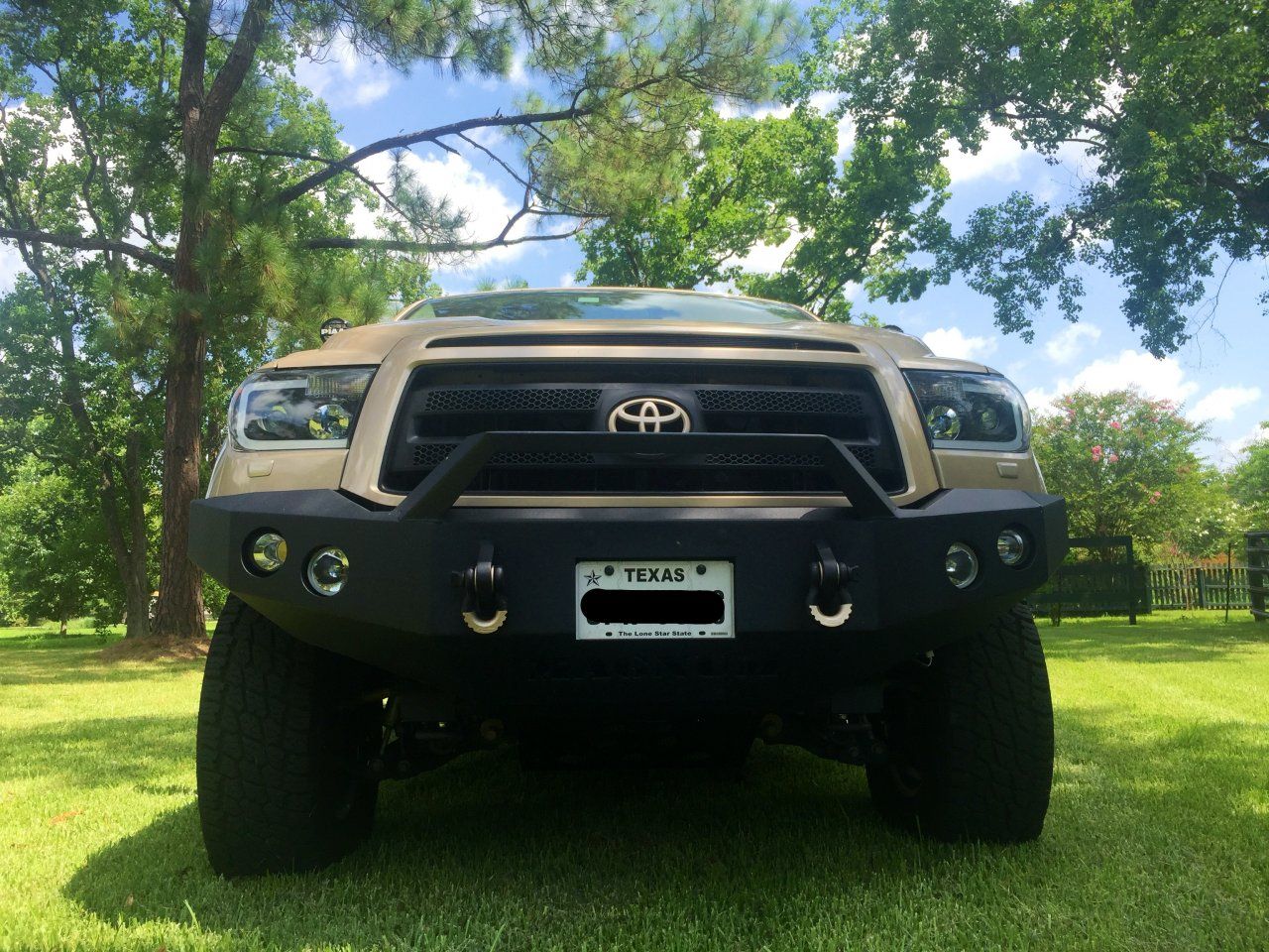

-ICI Magnum RT front bumper for a Tundra (fit like a charm after adding the Tundra grill, and I have had great experience working with ICI),
-Tundra color matched 2012 Rock Warrior grill (I did not have to replace the stock brackets to add this grill),

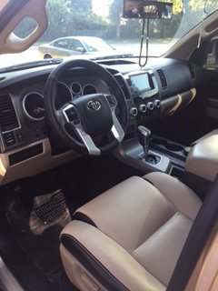

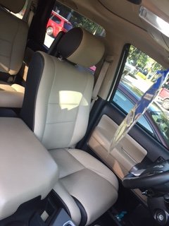

-Ivory leather seats and console lid cover with black borders from Leatherseats.com (installation is not for the faint of heart, my hands were brutalized while installing the kit),
-Seat warmers,
-White LED lights,
-TRD shift knob,
-Leather steering wheel cover from Aliexpress,
-Molded floor black leather looking floormats with white stitching from Aliexpress,
-Tint on front windows to match rear windows,
-Pioneer AVIC 8100 NEX head unit (definitely improved the sound quality),
-HDMI and USB extension to the console charger position,
-Monitors behind the front headrests,
-Rear hatch cover,
-Black lining in change holders and other nooks and crannies to reduce vibration held in place with double sided tape(my arts and craft project), and
-Ivory leather inserts for cupholders and other nooks and crannies (sounds stupid to add leather to an area which will get wet, but I had a couple round shaped leather samples lying around that fit perfectly there and some rectangle pieces for other areas).

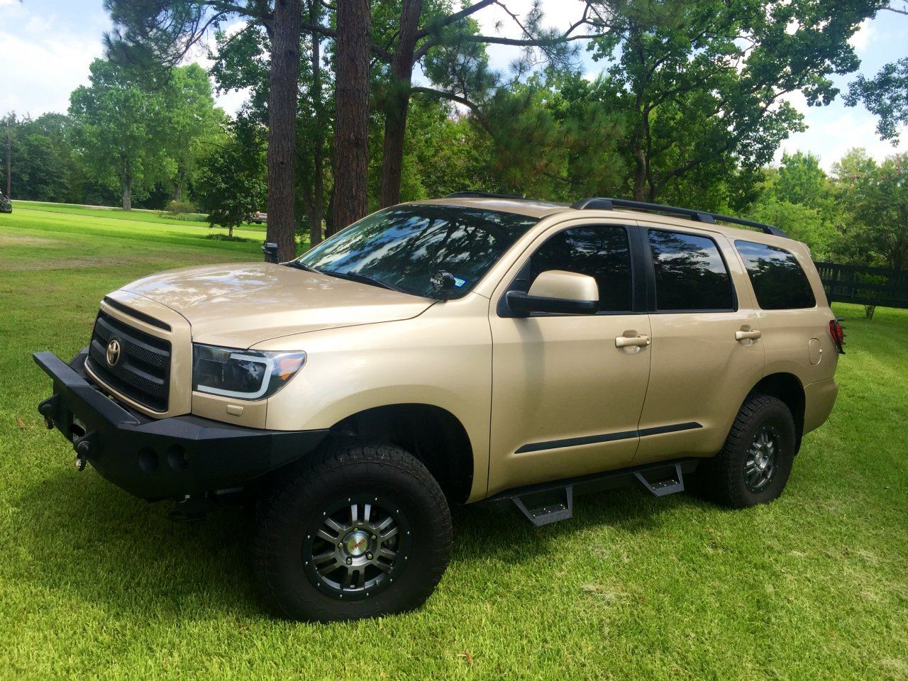

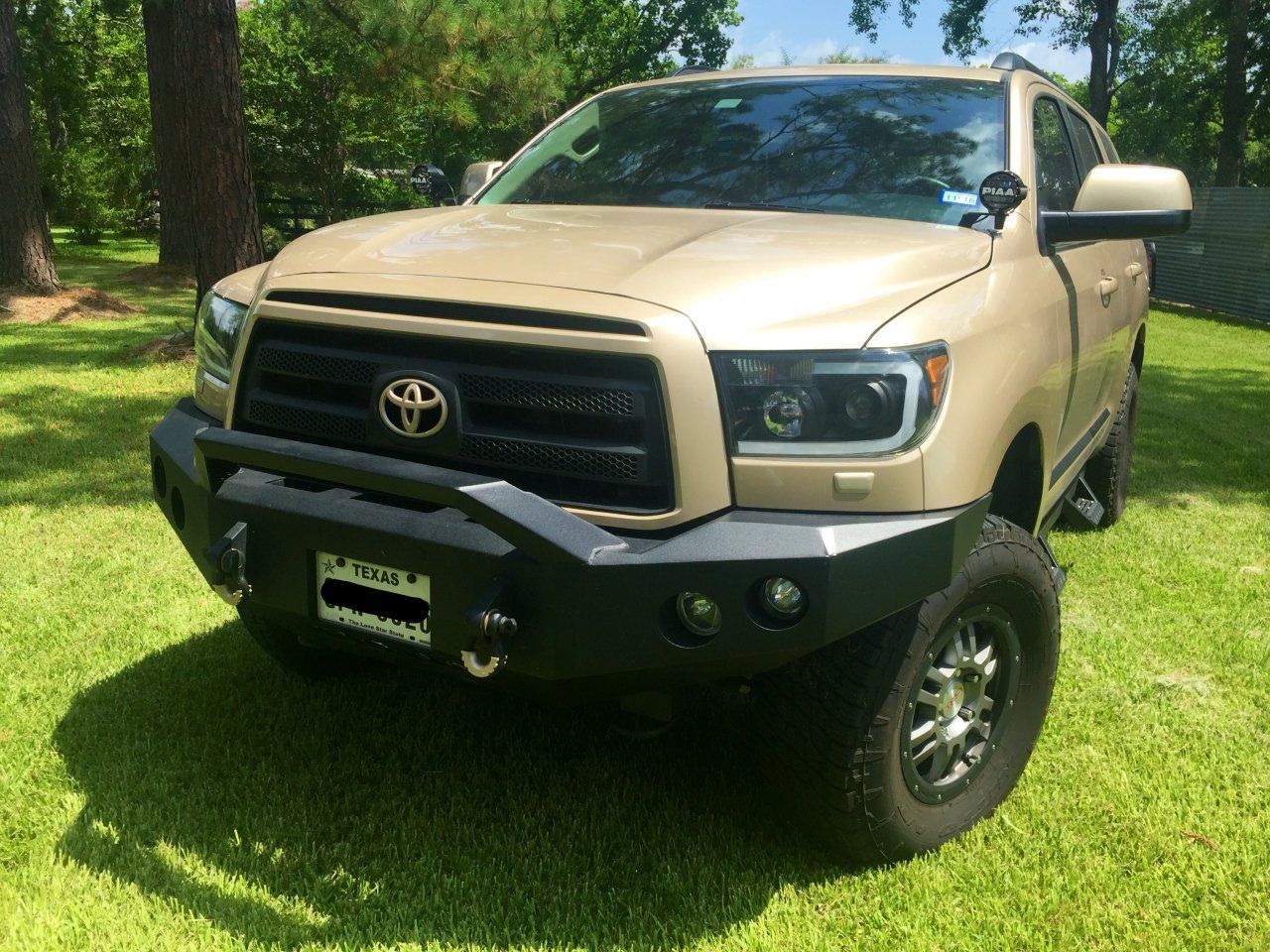

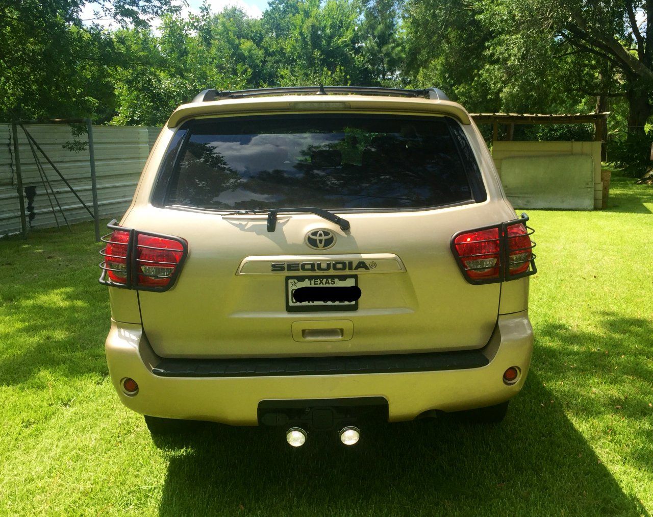

Posted are a few pictures of the exterior in chronological order.

I have been continuing to work on my truck, and attached some new pics. Recently I installed PIAA LP530 led lights on CBI ditch light mounts.

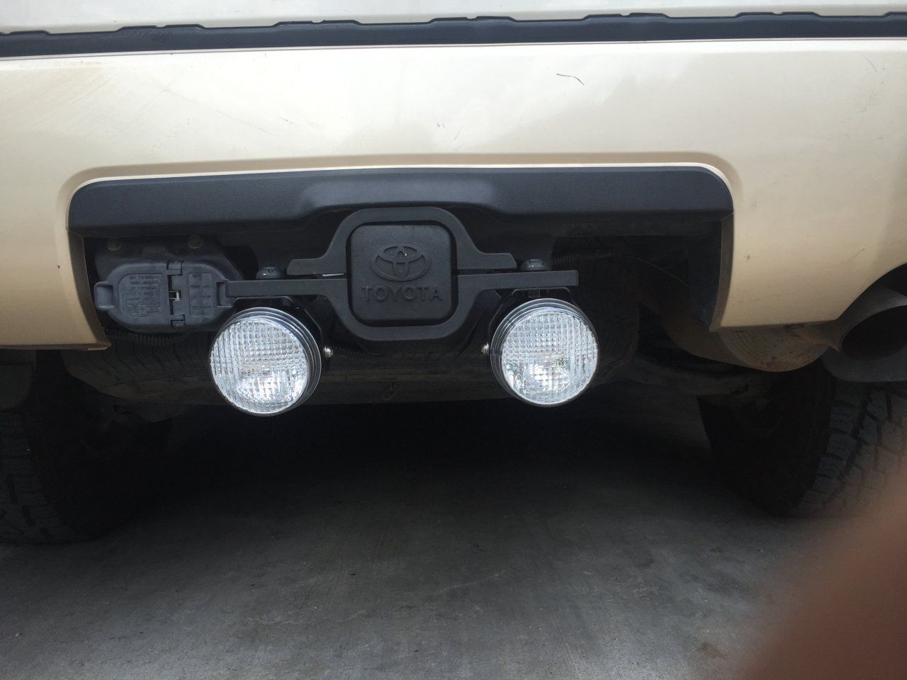

I also recently installed PIAA LP530 backup lights using a hitch mount I ordered from China, which I modified. I may even modify it more so the lights can rest flush with the bumper or recessed.

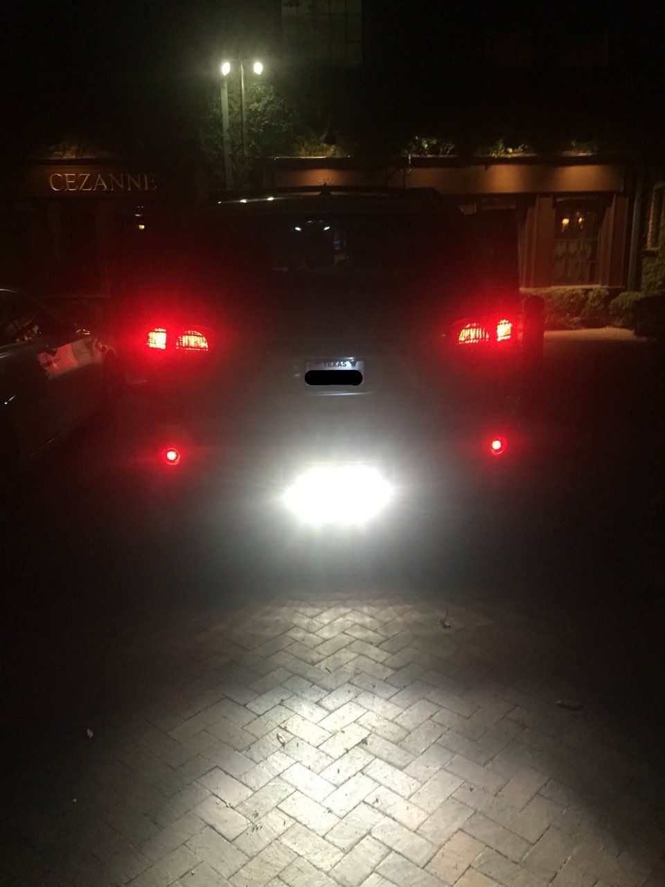

I installed my PIAA LP530 backup lights and bracket recently.
The install went smoothly but just took some time. I was pondering just splicing them into the trailer wiring harness under the truck to simplify the install, but if I did this, then they'd only turn on when I'm backing up. Ultimately I decided to install them as intended, with an on off on switch, so I can choose to have them turn on automatically when I back up, turn them off completely, or flip a switch and they stay on.

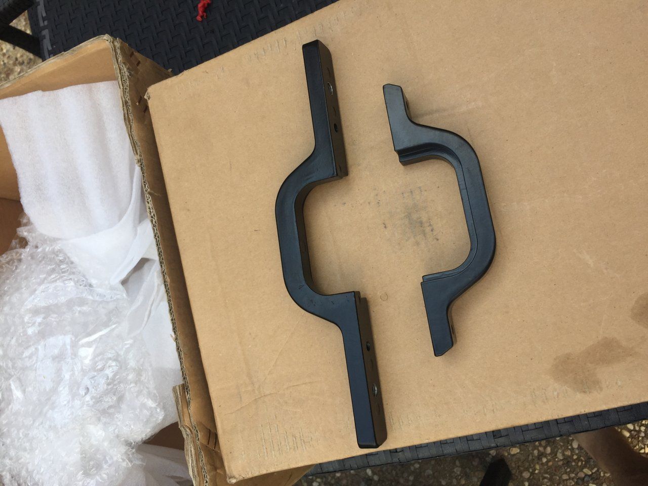

For wiring, I followed the PIAA included wiring diagram. I ran wires from the battery, through the conduit at the driver's side footwell into the cabin. Then up to the switch. I then ran the positive wire from the switch to the reverse wire leading to my radio. I then ran the wires to my lights under the plastic sill plates along the driver's side. I next removed the plastic bin along the back of the the cargo area attached by four bolts. I placed the wires up into this area, then chose to run the wires underneath the truck through the rubber round conduit on the driver's side in this cargo area after cutting a hole into it. There are three conduits to choose from. I then sealed the hole with silicone sealant. Now that I had wires leading underneath the truck, I grounded the wires leading to the lights on two different bolts attaching the bumper to the frame after sanding them down and adding a large washer. Afterwards, I added tubing around the wires for protection.
In regards to the mount, I purchased a Chinese hitch mount that you can find on eBay and Aliexpress. I had to widen the holes to fit the PIAA mounting bolts. I also spray painted the brackets with textured spray paint and matte finished paint, because I didn't like the glossy factory finish. I then mounted the lights onto the bracket using Lightforce keyed nuts for some security. I also added some supposedly tamper proof bolts to the lights.
With this mount installed, I believe I can still use the hitch. The spring loaded covers on the wiring harnesses for a trailer can still open and are accessible. As for ground clearance, I do not believe it is reduced any because these lights do not extend any further than the spare tire does already.
I definitely need to adjust the direction of the lights. They are bright! Right now, with them focused in the same direction, it looks like a white fireball when I look through my backup camera.
Regarding the position of the lights, I may change things up. Right now, they stick about a half inch past the bumper. I am not worried I'll back them into anything. If I did, then I would have bigger things to worry about, because that would likely have meant I probably hit something with my bumper too. But I am pondering adding some metal plates extending from the bracket, so that the lights will sit flush with the bumper or slightly recessed.
Regardless of having some more fine tuning to do, I like them. Well, at least definitely more than other backup light options I've seen.
Here's a picture with the backup lights on. I need to reposition them. They're really bright.

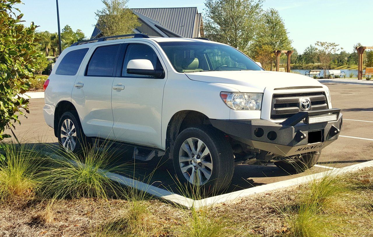

Mo, Just wanted to thank you for your original post. I found this a few weeks ago while searching for a bumper for my 08 Sequoia SR5. I just put on the same ICI bumper and steps along with a color matched tundra grille.
Toytec front coilovers - TTFCS-207AH-700RED (specs say 1"-3" lift, I adjusted almost all the way down)
Magnum bumper - FBM42TYN-RT
Magnum RT Steps - RTS73TY
Tundra 2010 Rock Warrior Grille
Tundra 2015 20" wheels
Genssi 21" light bar
Still need:
Tires
Spot and Fog lights to fill these 4" holes.
