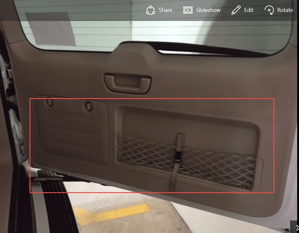

Before I start taking things off, anyone know what the space behind the plastic in the red rectangle below is like? I'm used to my WagonGear tailgate storage in my 80, wondering if a similar opportunity (of sorts) exists here.

There is no useable space behind that panel in my opinion. Just google replace backup up bulbs on a lexus gx470 and there is a video. You'll see what I mean. I replaced my bulbs. For the lift and garage door clearance just measure your space now and then see if the lift inches + 1/2 the increase in tire diameter gives you enough space. That will get you real close but not exact because I installed a 2" lift and got more like a 2 1/2. The retailers seem to advertise conservatively so that you are guaranteed the lift they document. As far as the lift is concerned, it more or less boils down to how much you want to spend.

  • Rear door, no interior space to take advantage of - got it.
