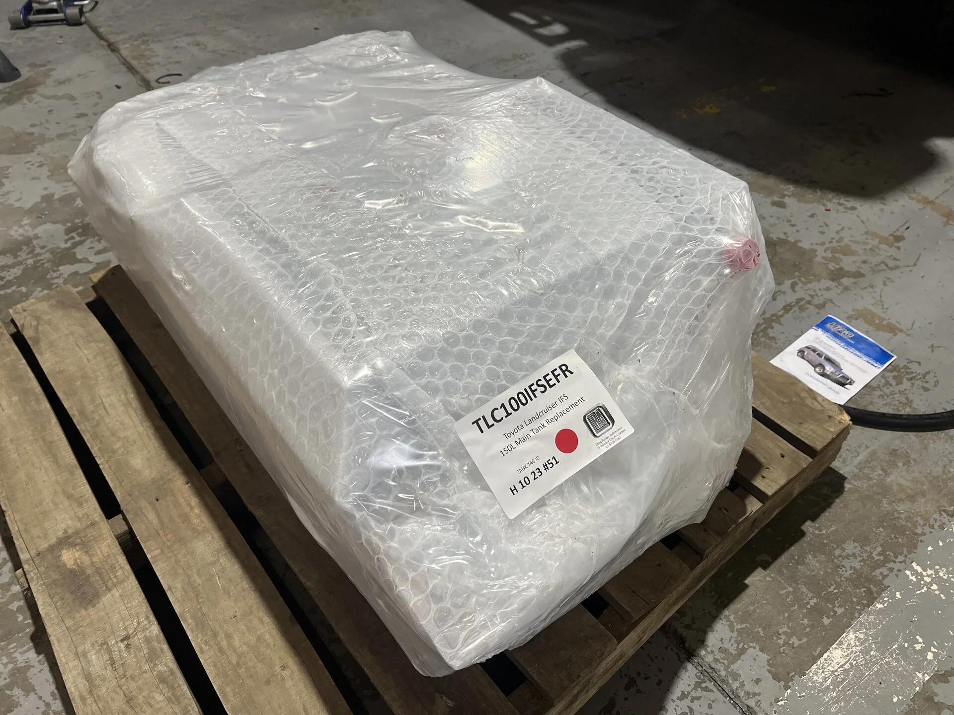

Just chiming back I got a 40 gallon main tank in my 2004 last year and did two laps of the country since. Absolutely love it, so many times before at 220 miles in I would get gas just to be safe. Now I pretty much go 250-350 with zero concern (can easily go 500+ miles). If the stock tank works for someone, by all means rock on. 40 gallons is a great size for me, and now has me thinking of the 40 gallon aux tank 🤪
tell us about the 49g main tank. does it intrude upon spare tire space?
40g (150L). No it does not.
gas tank is in the frront of rear axle and the spare tire mounts behind the rear axle. Never the twain shall meet

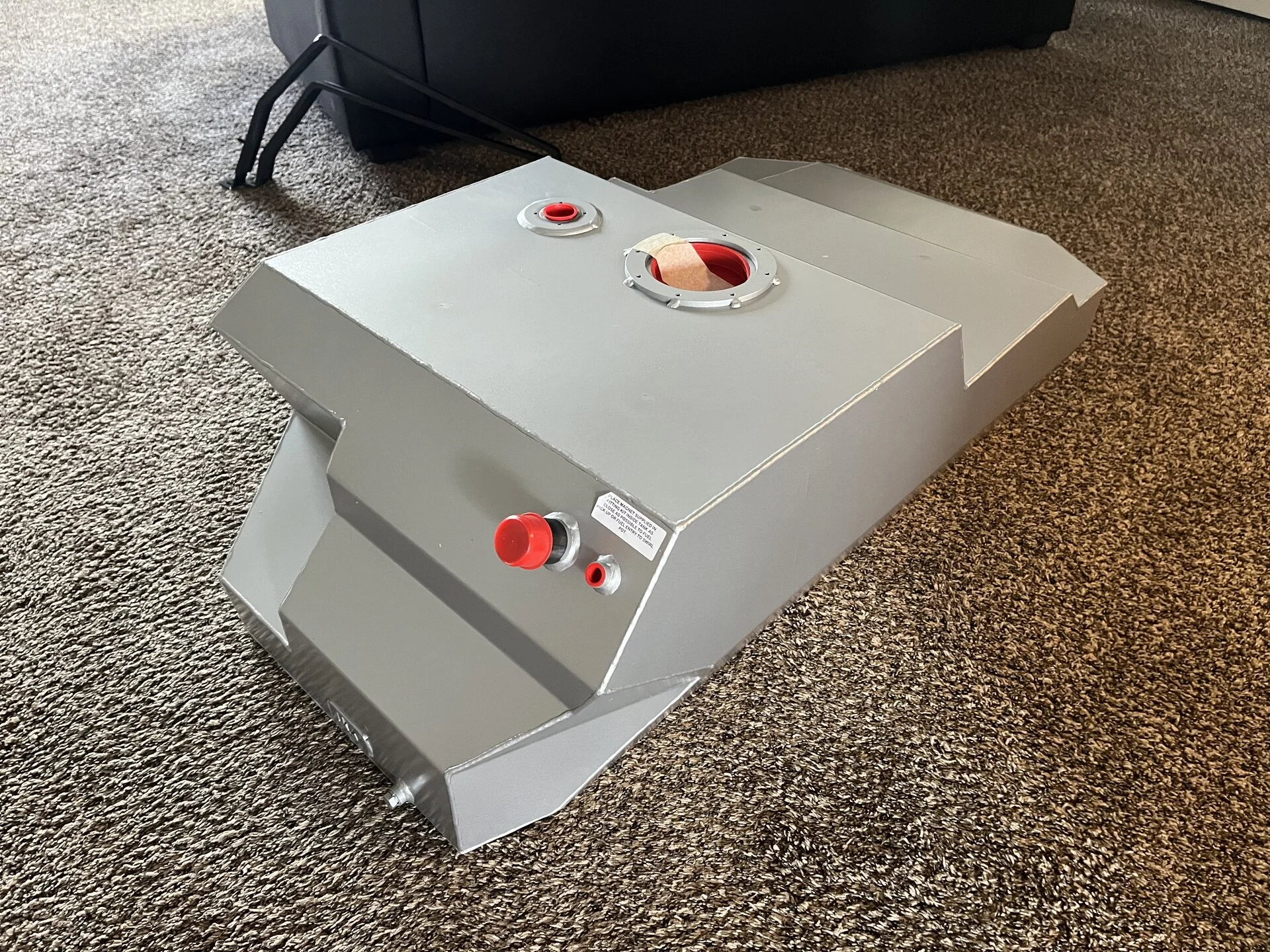

The tank is made from very thick steel, dry weight is claimed to be 120lbs. I wouldn't want to balance my whole rig on it like a skid/slider but it would take one hell of a hit.

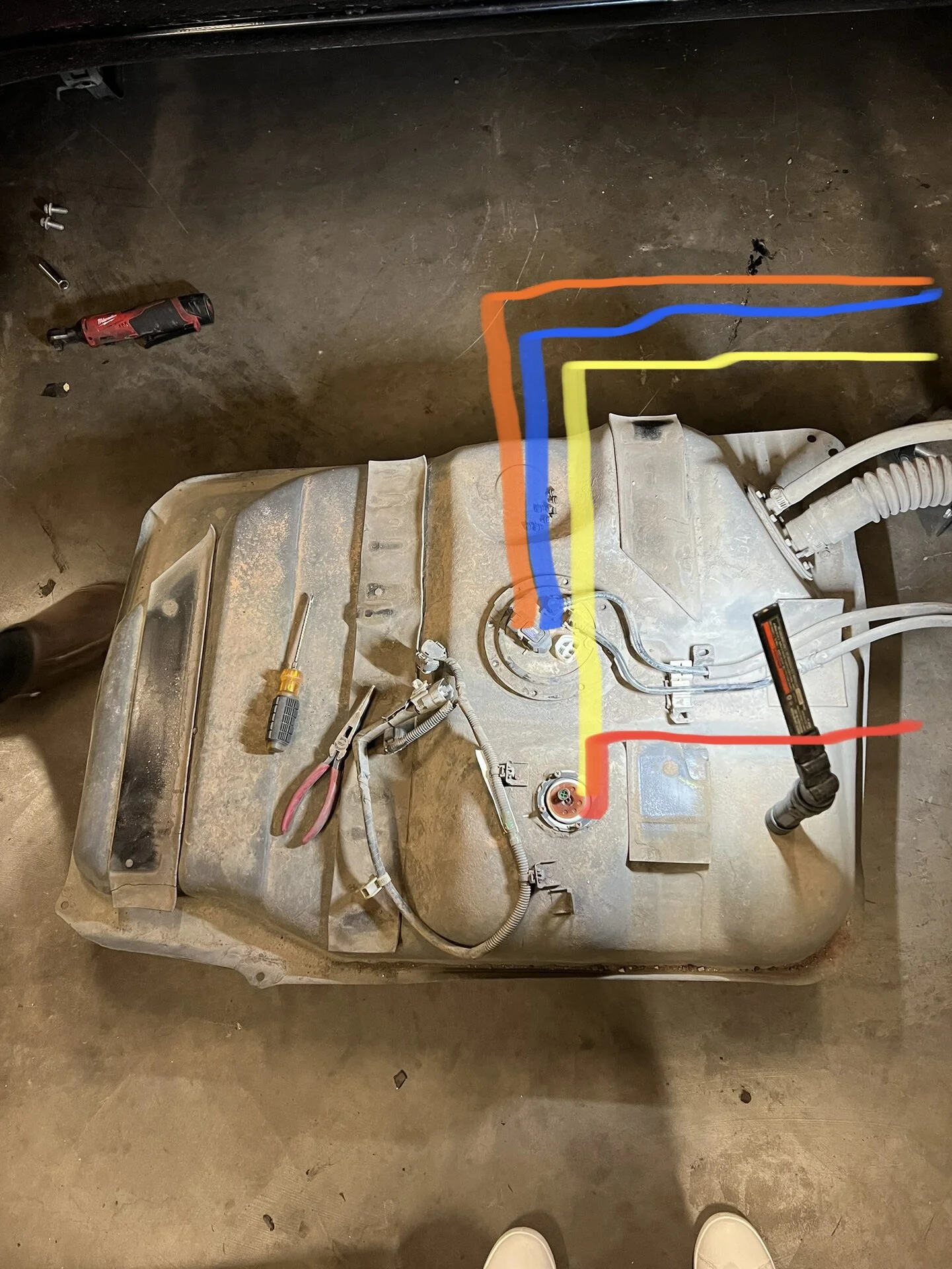

I recently finished this install in my ‘04. The instructions are more of a general guide. There is no mention of the differences between EVAP hose routing. The instructions state that the rollover valve hose is at the front of the tank, but on my ‘04 it runs towards the back of the vehicle. Additionally, the ring that secures the fuel pump assembly to the tank is cut to fit 98-02 models, 03-05 will require you to cut the opening to accommodate the vapor pressure sensor. I’ve attached a picture demonstrating how I ran the lines with the LRA tank, 40 gallons is great to have when you average 12 mpg.
Red line shows how the line for the rollover valve is run with the OEM tank. Yellow shows how this line is run with he LRA tank (same routing for supply and return lines.)

I’ve decided to go for it and document what it takes.
Any update or progress? You’re doing gods work for us 06/07 owners! I’d buy one tomorrow if someone verified it could be made to work. Willing to do some modification/fabrication up front, just don’t want to be stuck chasing spillage problems and EVAP codes after install.
