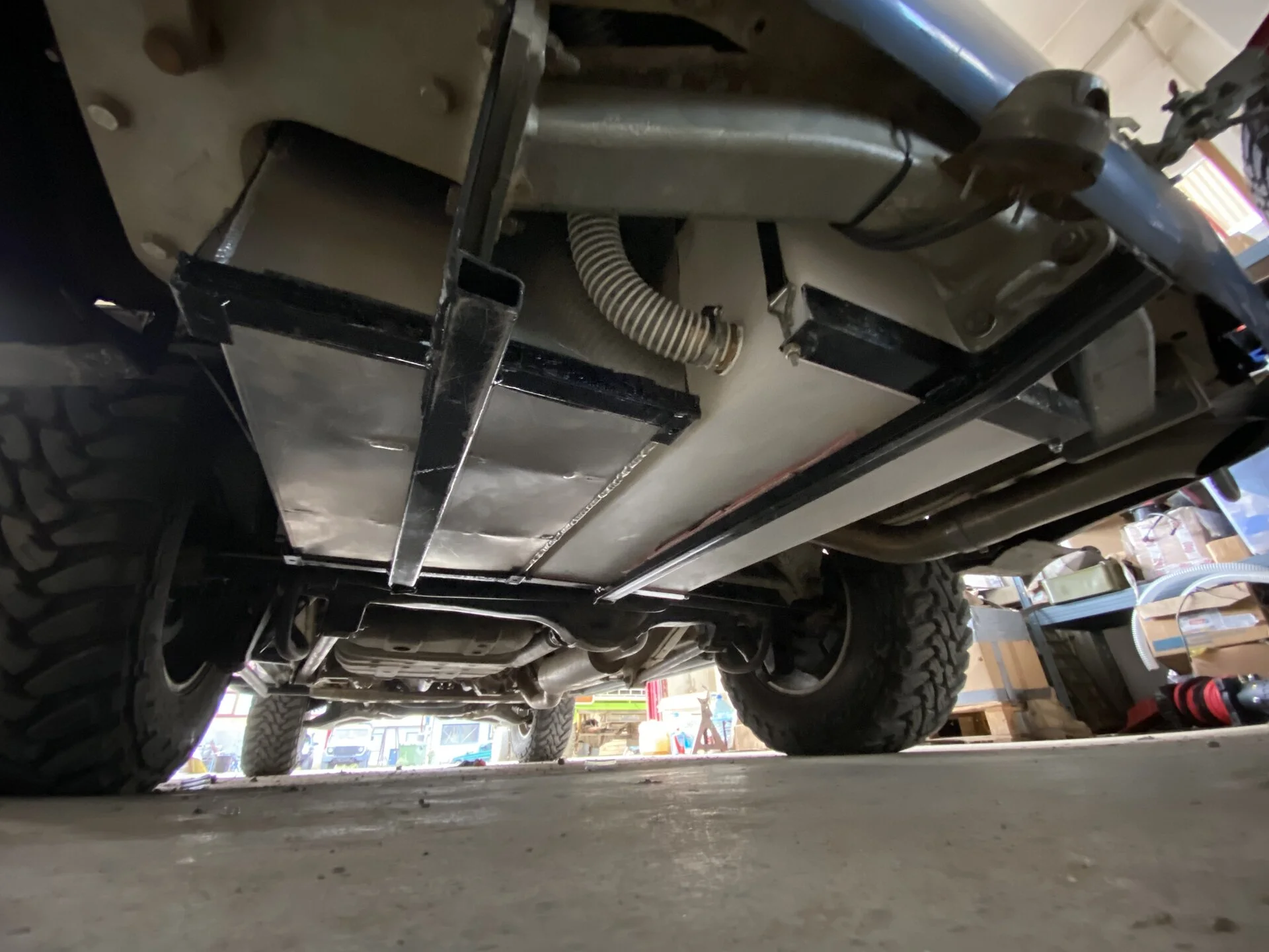

Mine is only 60L volume, 50L usable (10 gal or something like that imperial) as I also have a 68L water tank down there, but that's fine as mine is diesel and it uses much less fuel. You can use as much space as you want. There is plenty. I think the biggest external tank available is 180L.
Fuel transfer is super simple - old fuel pump from an Opel or a VW from a scrap yard that pumps into the OEM tank breather on the flick of a switch. I wanted to use one that has a fuel level sensor, but couldn't get one before my big trip so that would be an upgrade for the future.

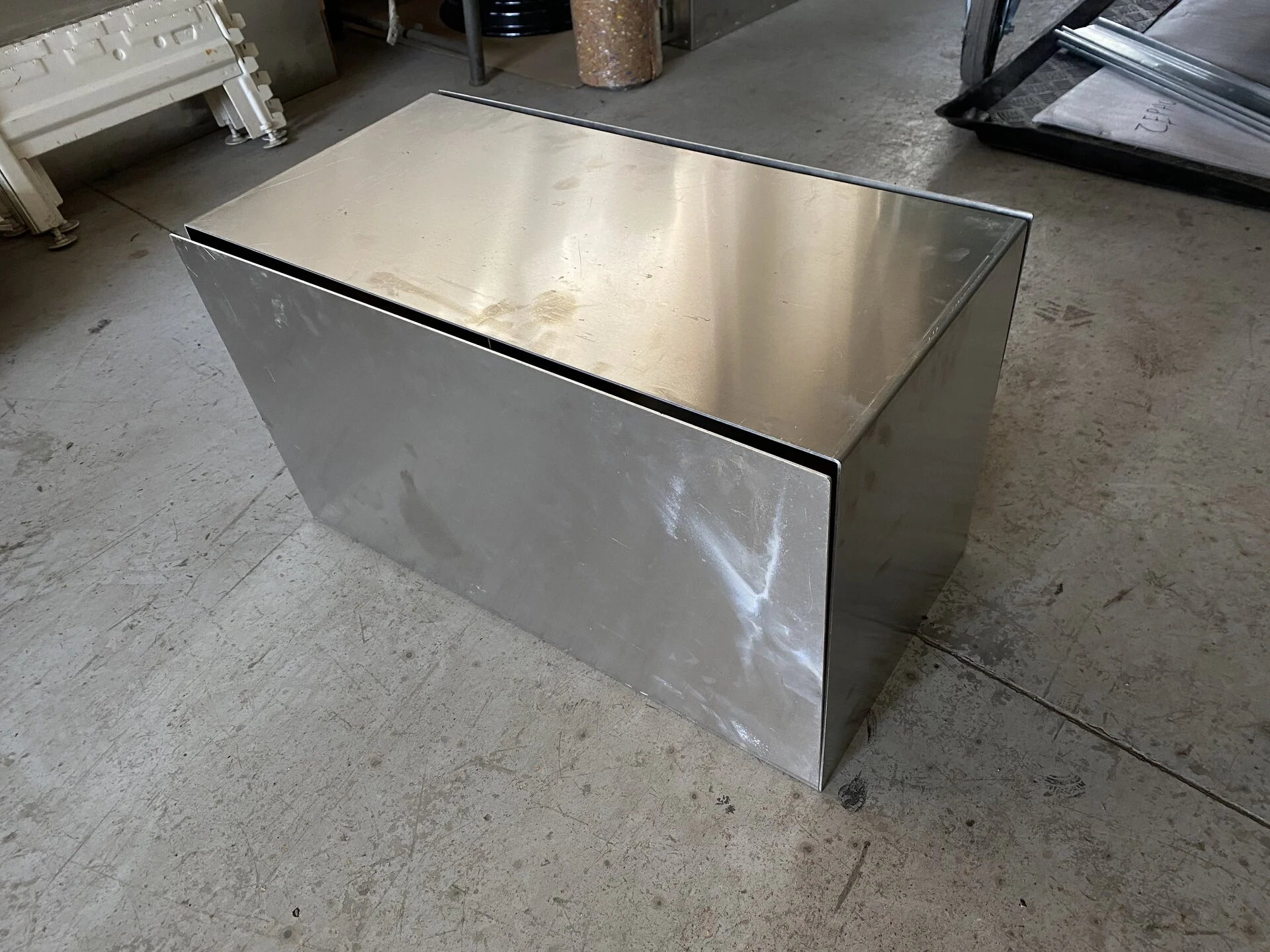

Used aluminium sheets that I had a workshop laser cut and bend, then a local guy welded them. Some scrap pieces for a bracket to hold it in place

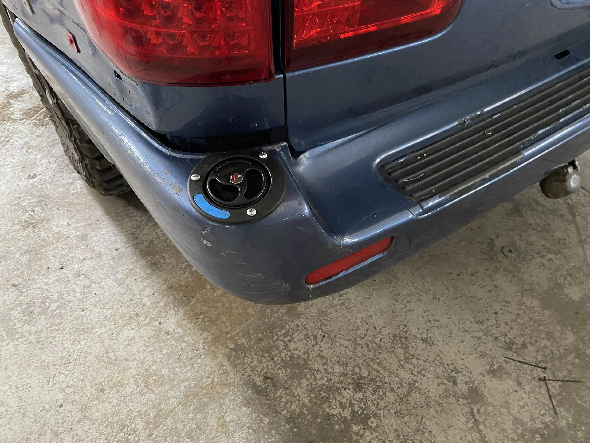

For filling I got the OEM dual tank fuelling neck that I ordered from Amayama.
All in all it was about $100 for aluminium, cutting, bending and welding and then about $100 more for the dual fuel neck.
You can save on the dual neck. I have a filler for my water tank on the bumper, that would work for fuel too.
Fuel tank as I got it from the laser/bending. It's a rectangular box, no fancy shapes. You can squeeze quiet some more fuel if you play with the shape, but I didn't have the time or the nerves before travelling.

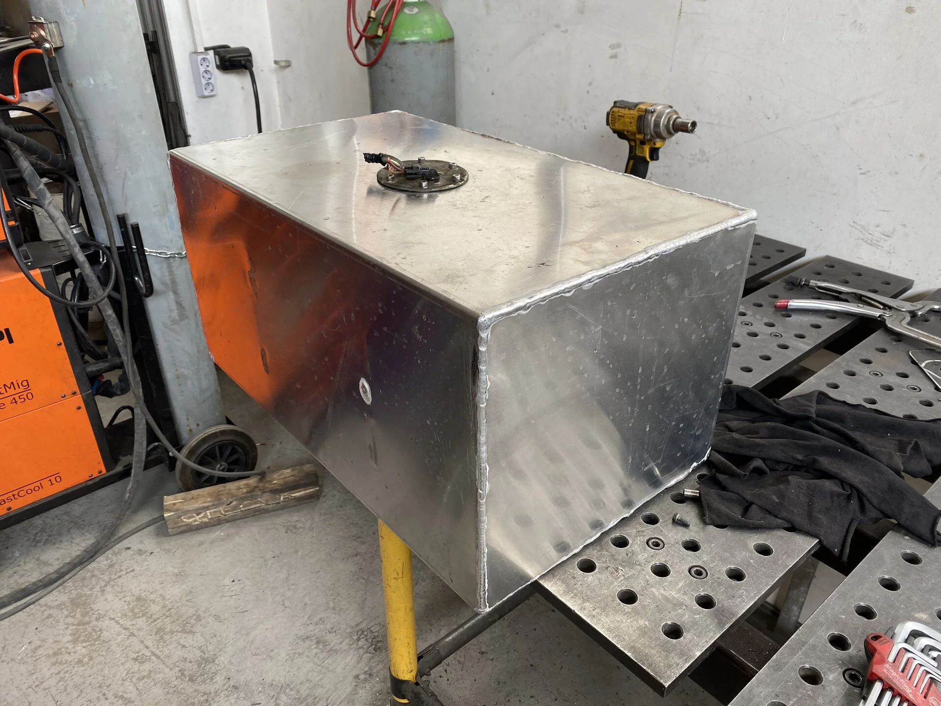

Welded with the pump. It's an extremely simple pump with just two wires and an outlet hose. I wish it had a fuel level snesor, but that would be an upgrade for the future. For now I have timed it how long it takes to transfer the fuel. Ran it dry once for about 40 minutes - still working fine. Not on this photo - breather and filling unions added later.
The two tanks. They sit a couple of centimetres above the differential sleeves and the towbar crossmember, so departure angles should be unaffected. Also visible the water tank hose. I drove 25km through Patagonia and now the Bolivian and Brazillian jungles - they are still fine. I HATE rock crawling though.
Water tank filling cap, which could work for fuel too
