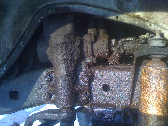

Did a bunch of work today. Applied my fluid film, so we'll see how it protects over the winter. Not gonna lie, didn't think that fluid film would be the color of cold maple syrup:meh:
Here are a couple of reference photos for the rust condition as it was earlier today. I'll take some more after the winter to see how much this stuff really helps.

Old box:
Cleanest spot on the frame, bar none:

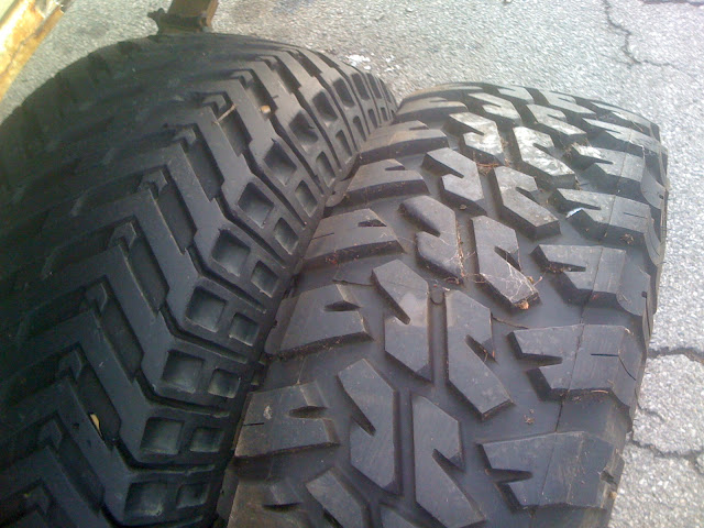

This was a most productive vacation. Accomplished all of my goals, despite the weather, and Moonshine now drives better than she ever has during my ownership. Here's a pic of the new meats:

Is it just me or do the tires look small?
Meats look good on the rig. Do they handle like you wanted in the snow?
So far, they have exceeded my expectations. The northeast is getting hammered with snow right now so the highways yesterday were all coated with snow. She never felt loose when changing lanes nor when driving straight. I took it out for a little drifting last night and it had almost no understeer. It was also hard to slide on anything but ice, but nothing a little skinny pedal can't fix:steer:
I am ecstatic and will not be siping them simply because I don't feel there is a need to.
