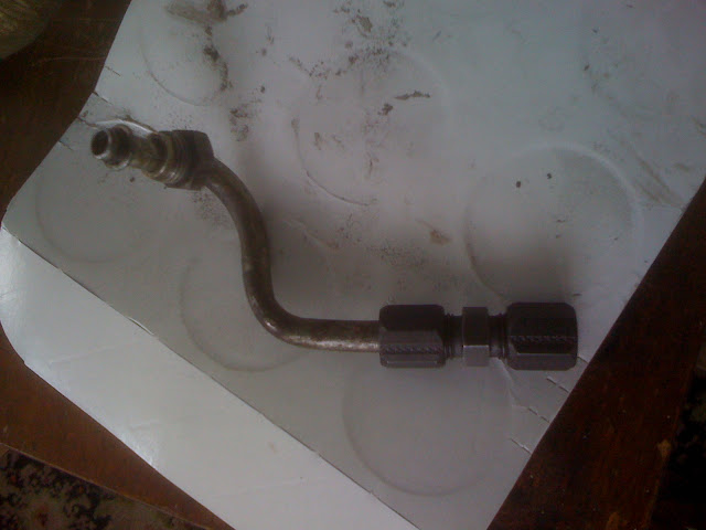

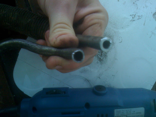

Instead of having a custom high pressure line made ( expensive? ) I decided to try a suggestion from one of the techs at NAPA. I picked up this 3/8" compression fitting and figured I could splice the two lines together to make it work. Cutting the high pressure line lynchmob sent me was a piece of cake as the tubing was thin, but the Toyota line had a much thicker wall diameter. The OD is also slightly larger than 3/8" so I ground down the tube until it would fit, trying to make it as uniform as possible. After grinding I was able to slide both ends in and tighten the fitting. So far it has served its purpose without leaks.

Size difference between Toyota PS line ( thicker one ) and US line.
Finished compression fitting adapting the factory line to Saginaw compatible line. You can see on the factory line where I ground it down to fit.
