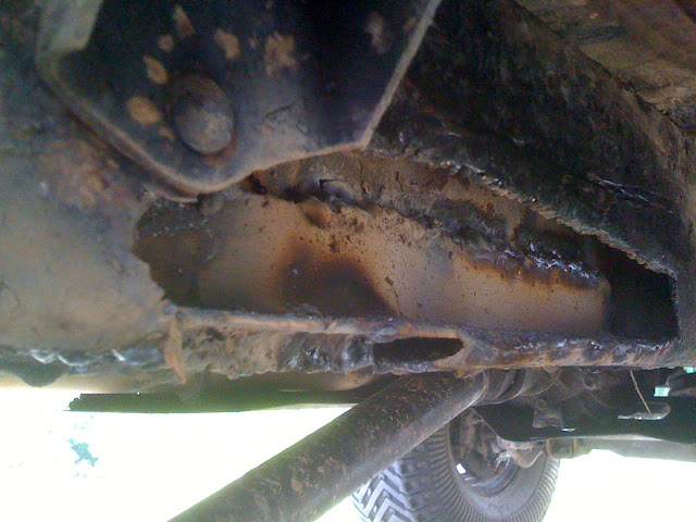

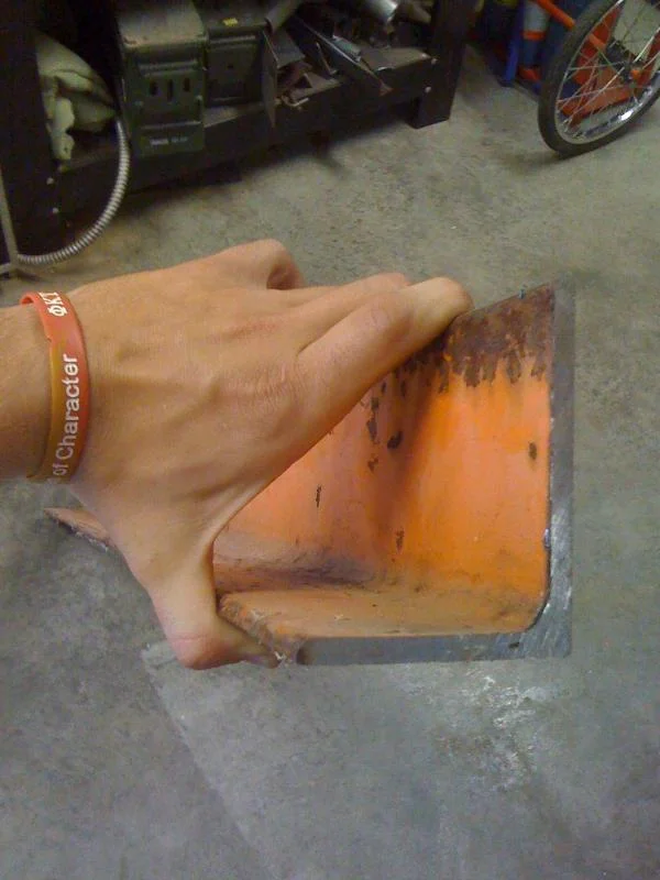

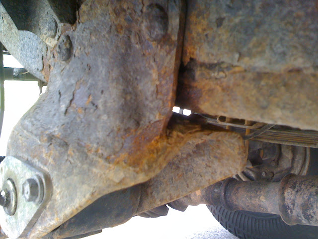

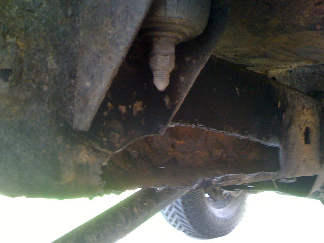

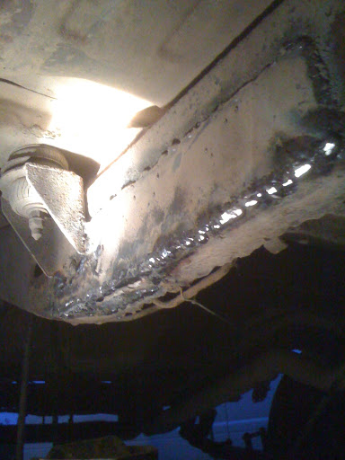

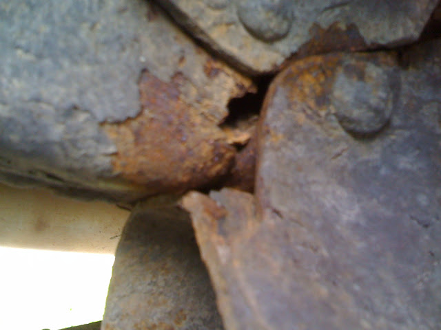

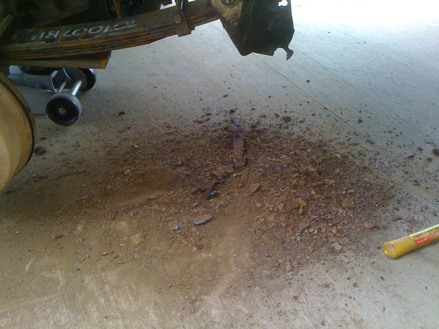

How to loose 5 lbs of mud and rot in 4 easy steps!
First step, neglect your frame until it collapses on itself.
Next, cut off the spring hanger and a large, rotten section of the frame. Remove all mud.
Weld in an internal support ( angle iron ) after you realize that the other side has rusted through as well:doh:
Weld on the outer plate and finally the spring hanger.
And you're done! It's solid, for sure, but the frame needs to be replaced. That will be Moonshine's next big project.
Yuck.
Send a PM to Orangefj45, he had a perfect FJ62 frame/body. Shipping back East might be a killer, though.
Actually D'Animal might have one too.
Yuck.
When I get one I only want the frame. My body is going to get beaten up by rocks / trees anyway, so why bother swap it out.
Rust free frames only seem to exist on the west coast. Every once in a while I find one here but they are few and far between. Either way, my bank account is completely empty, so the frame swap will have to wait until next summer, unless some ridiculous deal falls in my lap. Then again that's how the SOA happened, so who knows.
Don't waste your time on replacing the frame on this truck. Buy a new set up or like Drew said a solid body frame and do a drivetrain swap.

If I do a drivetrain swap then it won't be Moonshine anymore.

That is some BEAUTIFUL frame rot.
Gotta love the corrosive protperties of salt, water and steel.
It never ceases to amaze me! SERIOUSLY!

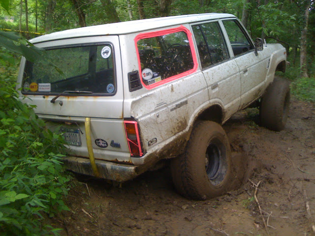

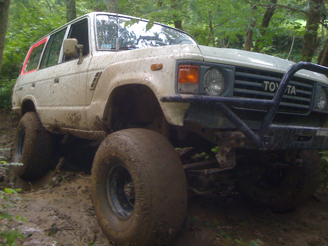

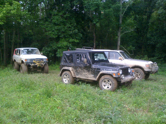

Went wheeling yesterday to a park really close to home. It's pretty new so there weren't many trails, and all the trails there were strictly mud. Due to the massive amount of rain we've had in the past month and my sand tires, I got stuck a couple of times. Really embarrassing when you've got one of your friends with you, going through everything pretty much without a problem, in a stock Rubicon with cheap mud tires:mad::mad:
Slicks:
