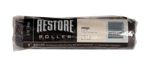

And fwiw, I did find these rollers at Home Depot that could work in a pinch if you run out in the middle of the project. They're $5.
