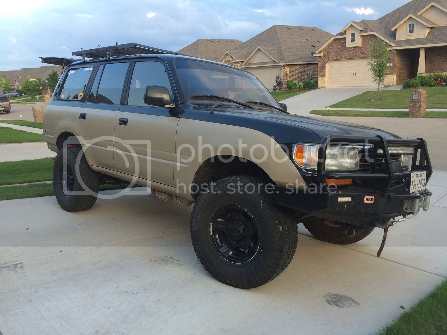

Well, here it is. I didn't remove the front valance would've had to remove the bumper and I'm not going to do that till I do the top half this fall. I was paranoid 1 gal. wouldn't be enough for this so I think I inadvertently put the first coat on too thin. I could still see some places where the green was spotting thru after the first coat. I did the second coat extrathick but still had about 1/4 of the 1 gallon mix left over. Anyways, here's a pic.
Well hell. I finished the 2nd coat last night @ 7pm & it started raining ~4am this morning. When applying I had to start 2nd coat ~30min after I finished 1st coat due to 90*temp & 70% humidity so it was drying/curing super fast (flashing). I know a "gentle mist" after 12 hrs. helps speed curing process but rain is not a "gentle mist". It isn't raining hard but it's more than a sprinkle. Think I'll have any problems from the rain?

Finally had weather in Denver to allow me to get it done. Need to clean up the glass a bit from some roll over. Painted the rear wiper just to see if it sticks. Have black on the way to tough up trim around the door. 2 full days. One prep one paint. Product was thinner than I expected and started to cure up and get temperamental after 2 hours. Had about 1/3 of a gallon left each time. White did not easily cover the previous paint color of Grey had to run a light third coat. s*** is a pain in the ass to get out of your beard.
Nice! A hundy Monstalined! I love it.
Nice man! I'm starting to lean towards white on my beige metallic 80
Planning on plastidip to finish up the trim like the grill, window supports etc. Will use white plastidip to do the interior door trim, didn't want to risk bedliner on the interior.
