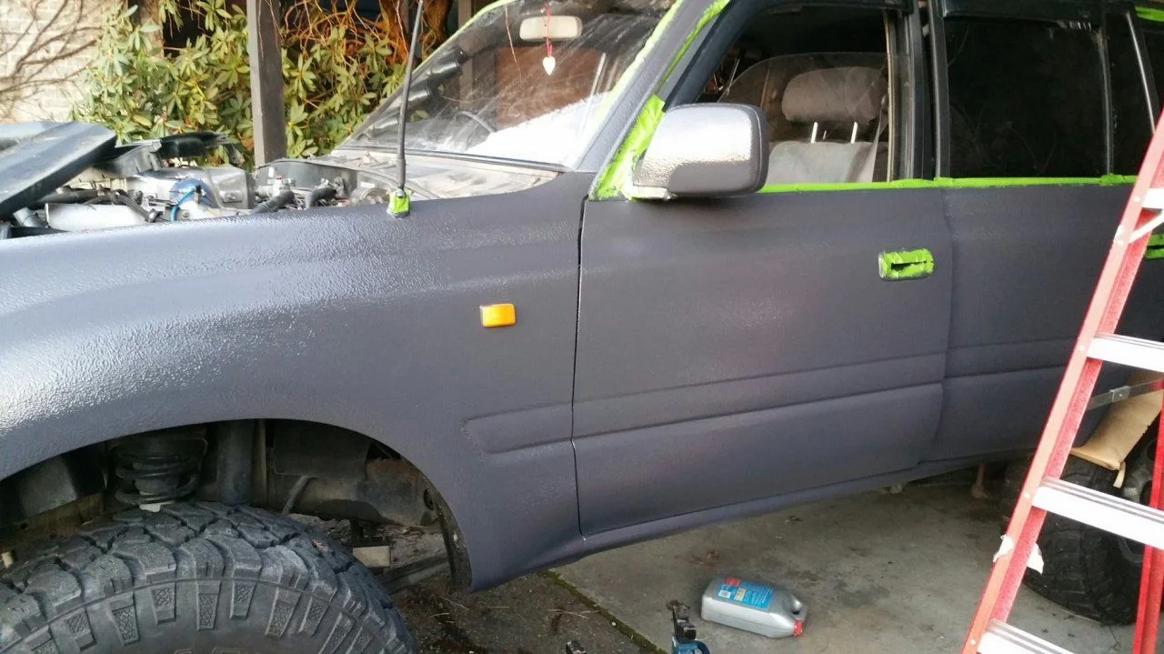

Well I finally did it. 2 gallons of Coppa Feel for the exterior and 1 gallon of black for trim. I let my wife pick the color and I'm glad i did. Came out really nice and has a retro vibe. Would do it again in a heartbeat. Hope it lasts a solid 10yrs. We shall see?
Veggie80, how'd you get the line between colors so clean? Mine is black Monstaliner now, but I have some serious body damage to repair then I'll be doing some sort of dark green, maybe army green like #mryanangel 's Dirty Koala build. I would like to do this bottom half trim effect with Pyroclastic maybe, but want it to be really clean break. I'll probably be thinning it out good and spraying it high pressure. that gave me a nice smooth texture the first time around. Anyone know what prep I need to do before going over the old black coat? i saw something about phosphate wash on the FAQ but that's for applying over Rhino liner and the like...
Got any pictures of your texture? I'd like something more on the smooth side...
Used frog tape for the lower black trim line over top of 2 coats of the coppa feel. I wanted it to look like the raised trim. Think it worked out pretty good. Did 3 coats of black and let it sit for 45 minutes before I pulled the tape. Some parts wanted to lift with the tape, but it is still soft enough to push back in place. My texture is very much like orange peel, with a good amount of shine. If you lay it heavy and don't roll back through it to much, you could get a much smoother finish.
Good to know. That's the texture I will be going for with my black or pyro trim.
