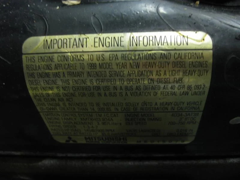

Thanks for the EPA Tag shot. It shows the engines BSFC at rated power (145hp) is 275 g/kwh.
Honestly this is a lot higher than I expected. You might have an engine that has the injection timing retarded for emissions reasons. The 3 degrees BTDC timing compares to 8 degrees BTDC for an Isuzu 4BD2T and 13 deg BTDC for an Isuzu 4BD1T.
Is this engine IDI?
Exact same EPA tag as mine.
The Fuso 4D3 is direct injected and heavily EPA regulated. IIRC Nox limits are prescribed here. This is also the exact same engine as the Euro 3 Canter, which is a fairly recently offered driveline.
The pump is a Zexel TICS. Although you set the base timing in a conventional way, the computer will actually alter the injection timing and duration of injection through the prestroke actuator. At idle, it utilizes a very steep portion of the injection cam profile, for a rapid high pressure injection. At speed, the portion of the cam having a longer, gradual ramp is used, so the injection is spread out over a longer period, reducing Nox, and the injection timing is advanced. A possible side effect may be increased fuel consumption due to a longer burn time, but I also think that the engine is timed retarded for emissions.
When I first got mine going, it smoked blue and generally acted like the timing was badly retarded. The manual has a very imprecise method that is used to check timing based looking down into the pump after removing one of the sensors. It is not accurate and I am trying to find a better method, but there is a huge amount of adjustability in the pump drive, so advancing is easy, but I suspect the timing is done through pump set-up and verifying with accuracy might be difficult without Bosch test stuff.
I advanced mine a few degrees and it now runs fine, but I think it might still be retarded as it seems a tad lazy.
The computer gets its engine position based on two sensors (redundancy) in the pump. I was surprised to find out that there is no cam, crank, flywheel or other sensor that monitors actual crankshaft position, so it would be easy to bump the timing and not have any side effect in the engine control department. I am just concerned about what advance the prestroke mechanism generates. I am pretty sure it does not advance timing at all at idle, as with the system disconnected the engine runs and sounds the same.
It appears that in 1992 that maybe the US must have increased emission requirements? In 1992 The Mitsubishi 4D34-1AT3 went to using the electronic controlled prestroke injection pump, but stayed direct injected.
That same year Isuzu went to IDI (4BD2T) but everything stayed mechanical.

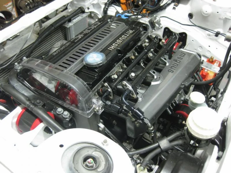

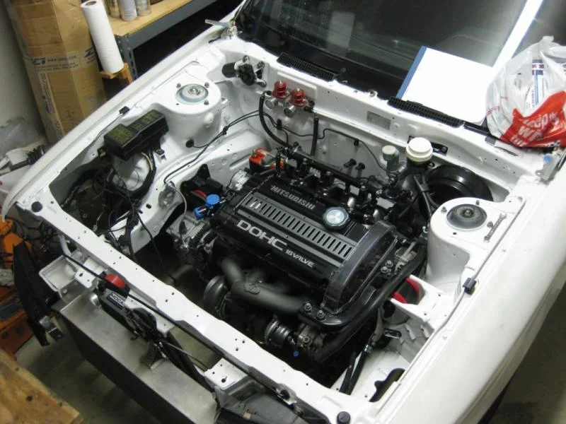

Is that a Galant VR4 in the background?
I always wanted to stuff a 4G63 into a late 80s 4x4 toyota pickup.. that thing would be wicked fun..
Yes it is, customer's car, good eye!! (Not many people know these cars) It's in for coilovers and big brakes... I've done all the work on this car since it was stock, been fun to see it evolve over the years.
Fully built 2.0L, 35R, all supporting mods. Expecting 600+WHP at the next dyno session.
Couple pics from a year or so ago when I did the refresh on the engine bay... not quite as clean anymore but I'll tidy it up a bit before it leaves.
This motor would be wicked in a Pickup!
Is this engine IDI?
