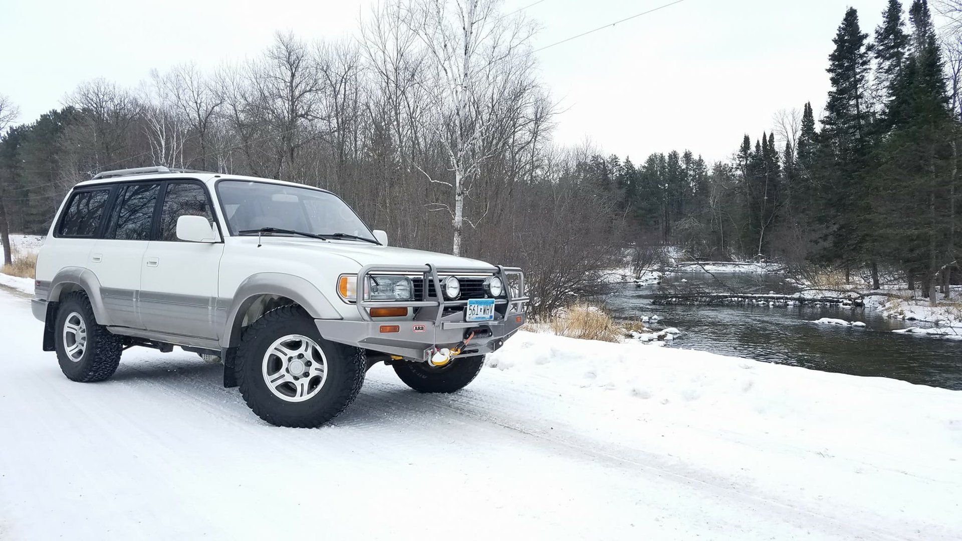

Took the LX450 out of hibernation up north for the day Saturday. The thing is a tank going throught snow. Wish i was not scared of salt.. i would love to drive it more in the winter.

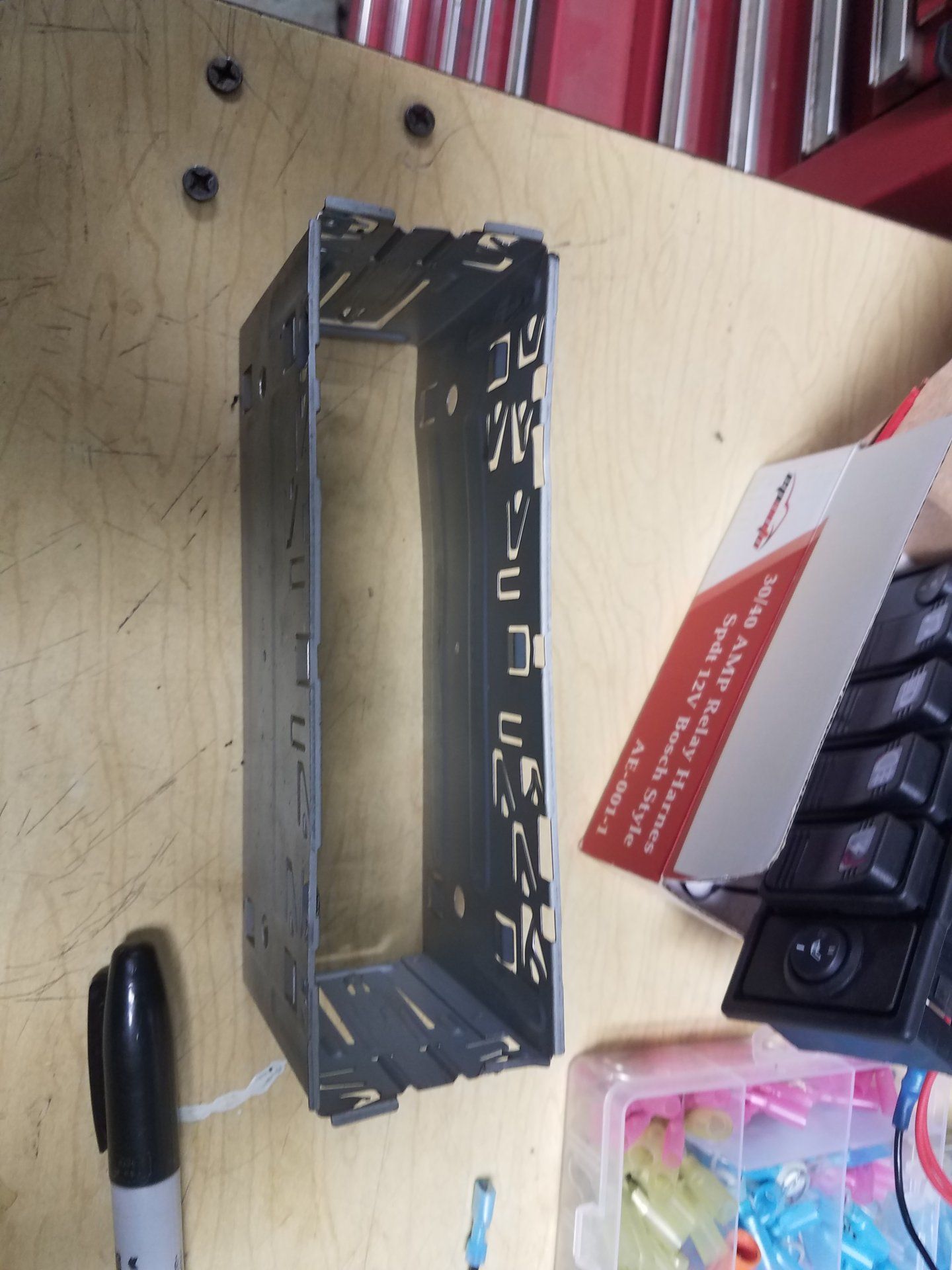

I used a single din radio metal sleve, the switches fit in fine and tight. I then made a kydex cover pannel to cover the difference. This pic shows it not cut to proper size yet.
The problem is, there is no good way to mount the metal sleve. The intended tabs dont secure it strong enought so there is movment in the pannels.

Soooooooooo... the trick is to use 7 switches.. i thought of it but only ordered 6 holders originally, poser also suggested it. I had to order more, put a blank in there for now. Some day i will use it... took about 30 sec worth of sanding with a dremel to fit. Nice to have an empty if i want to add.

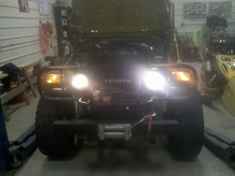

got the headlights installed today.... here is a pic of one new one (drivers side) and one old one. not sure how good they show up on pics but they are def. birghter. It was an easy install and I would recomend to anyone.

I bought them at the parts store in town. Sorry it's been too long now i dont remember the brand.

Yes. Thats exacty what i am using. On an uncut truck 6 will fit exactly. However the po cut the dash, so 7 must be used.
