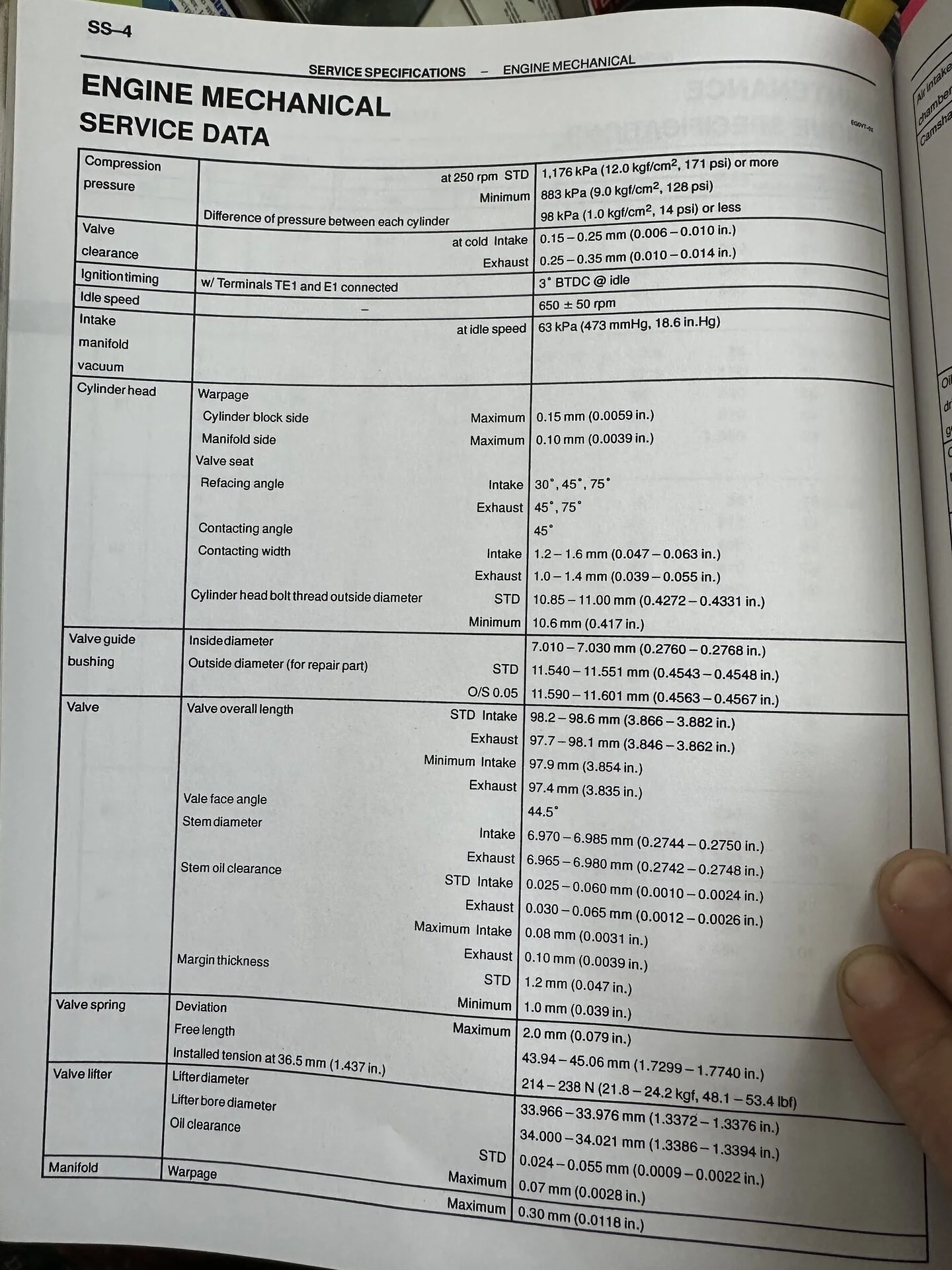

FSM seems to say compression in each cylinder is 171psi > 128 psi and they don't want a variance larger than 14 psi.

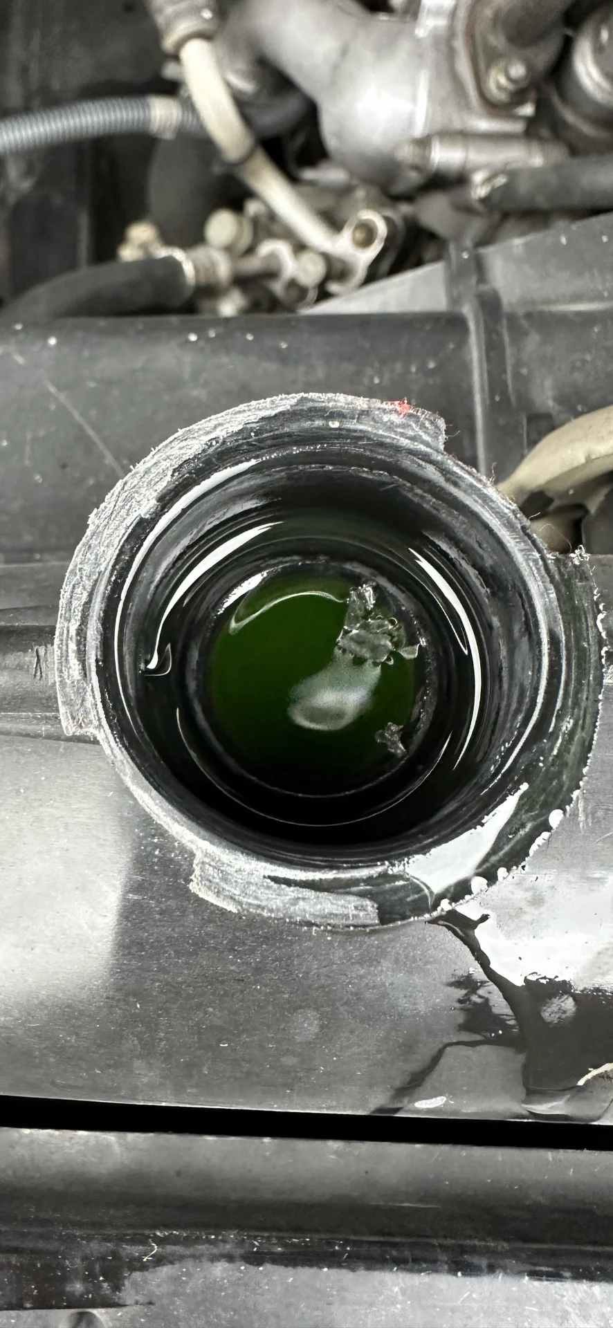

the radiator doesn't leak and i tested it once before but here is a pic. there is some weird distortion in the image but it's clean aside from some kind of small film thing.
can i just ask if compression/leak down comes back hood and if i am doing s new radiator anyway it's basically an "elective" in terms of doing a tune up with plugs and wires versus going ahead and doing valve cover gasket and spark plug tube seals?

here is FSM on plug gap (0.81mm) and compression numbers but not sure if i should have anything else handy?

Compression should be 171 OR MORE.
