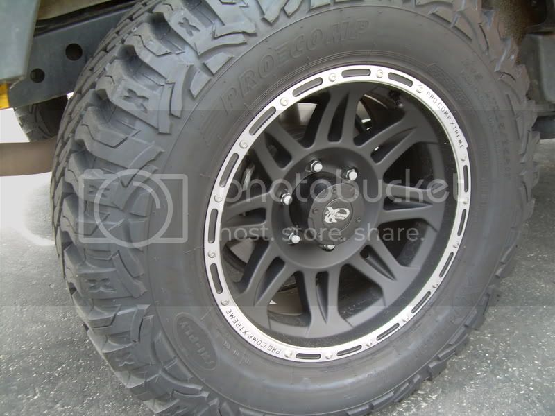

I have Procomp 7015 17x9 (-12 Offset) rim with 315/70-R17 Procomp Xtreme MT tires
